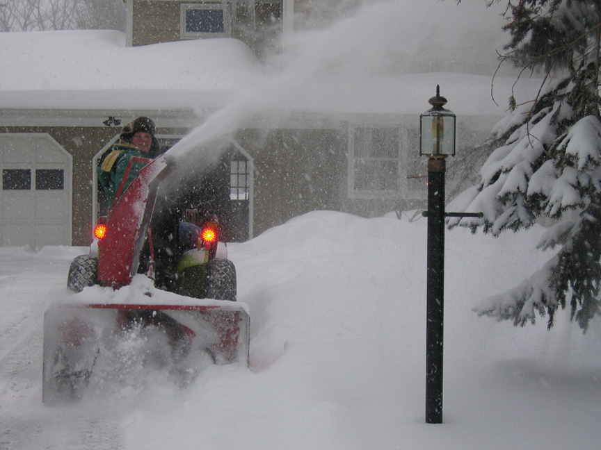

Although I don't have any experience with a blade, I don't think you'd have a problem with even a very small Yanmar tractor especially if it's 4wd. My Yanmar is smaller than those mentioned so far and it does fine on my 65' two lane driveway. I use the FEL to cleanup anything 4" and less and the rear blower for heavier snowfalls. It's a YM155D and my driveway is fairly flat and paved. In my area we average about 75-90 inches of snow a year.

Thanks for very helpful responses! Does the snowblower scrape the ground or is it possible to hold it above the surface to avoid picking up gravel?

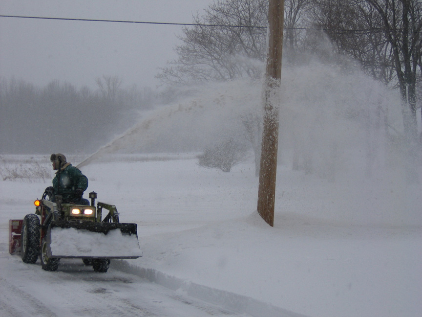

In my case, there are some times I wish it would scrape more for when I clear the driveway after having driven on it with the car. The FEL helps with getting down to pavement if I really want to. If you have a gravel drive, and want to leave a layer of snow, I think you'd have good luck adjusting the toplink which has the effect (at least on my model blower) of rocking the scraping edge up and riding more on the skid shoes.
/ Yanmar for snowplowing....How big? #8
Wow, that blower looks neat! Now how am I going to justify buying one to my wife??? :D
