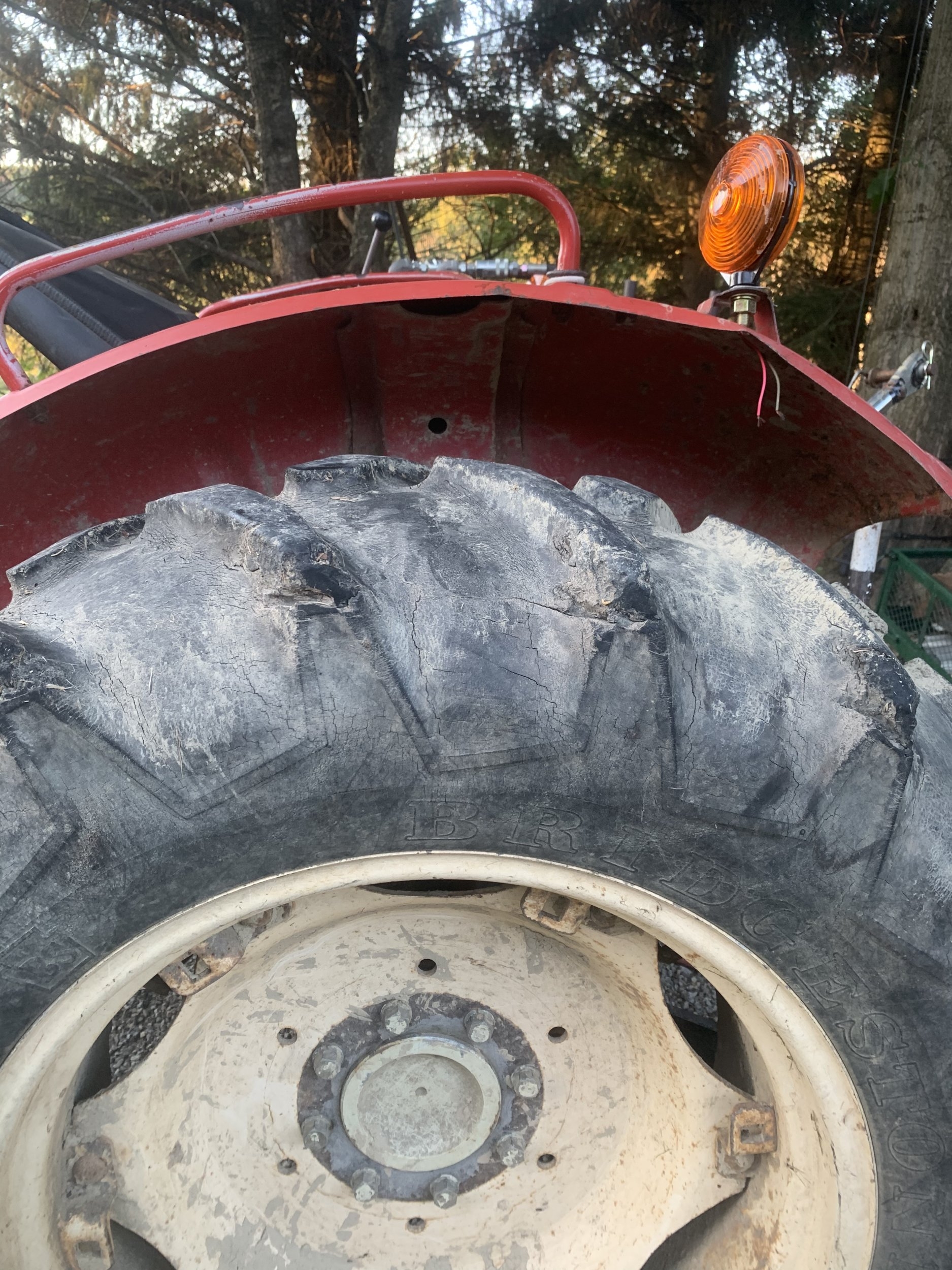

original tire bridgestone 13.6x26 (ag style) is dry rotted and split open . tread is very good i’d say 1” or deep . it’s inflated overall height is about 48” tall . local tire shop found me a replacement, it a speedway tire “gripking “ and is a nice replacement, BUT is 51” tall ((mounted and inflated) . first question is is it mechanically safe to run this tire , which is plus 3” tall on my tractor . i was surprised on overall measurement and was considering buying a second tire but not sure it’s ok to run without damage to tractor internals… help !

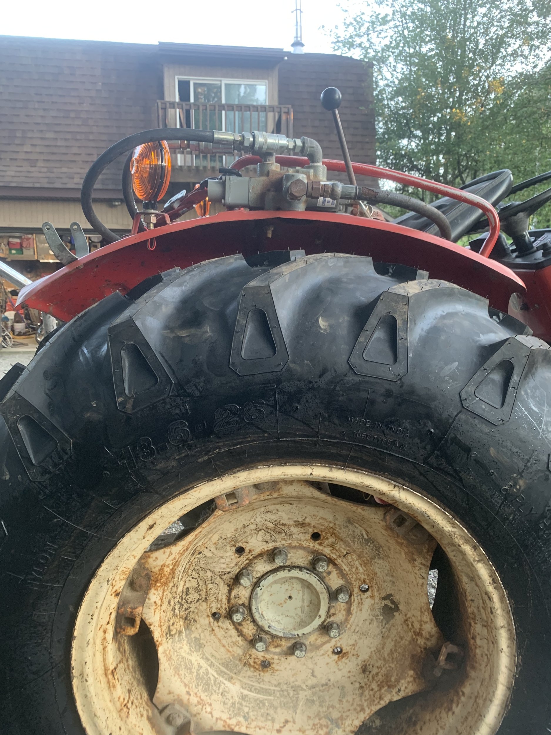

pics of tires on tractor for comparison…

NOT mechanically safe. It will overwork the differential in 2 and 4wd, and will also create some serious torsional stress i.e. "shaft windup" in the gear and driveshafts when you are in 4WD.
Replace with a pair of matched rear tires and check the tire catalogue specs to make sure the new ones have the same "loaded circumference" as the tires they are replacing.
That requirement is not peculiar to Yanmars, it goes for every sub, compact, and utility 4wd tractor on the market - and most of the full size ag tractors as well.

my tires are the bridgestone 13.6 x26 . i measured the rc to be just shy of 48” . i have purchased a set of deestone replacements (8 ply ) , which measures about the same before mount and inflate . i also bought a set of deestone 8x16 fronts to match . hopefully it all works out when there mounted …. i will post results . i am looking for to completing this tire saga . kinda why i did all four ….should be a long time before this tractor needs tires again ….
