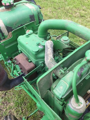

There is a guy in Monticello, Ar.(Eldoark.com) that has one forsale w/brush hog $2500(again i think) painted JD Greene, sharpe.

id buy that JD yanmar. But why paint a non JD tractor Green??
/ Yanmar 2210 Engine Seizing... #17
I hope there is an air cleaner housing that that air intake tube hooks too!!:eek: I haven't paid much attention to the 2210 to see if its like the 2000 and has the round filter housing sitting on top of the engine or has a side cleaner option year?
