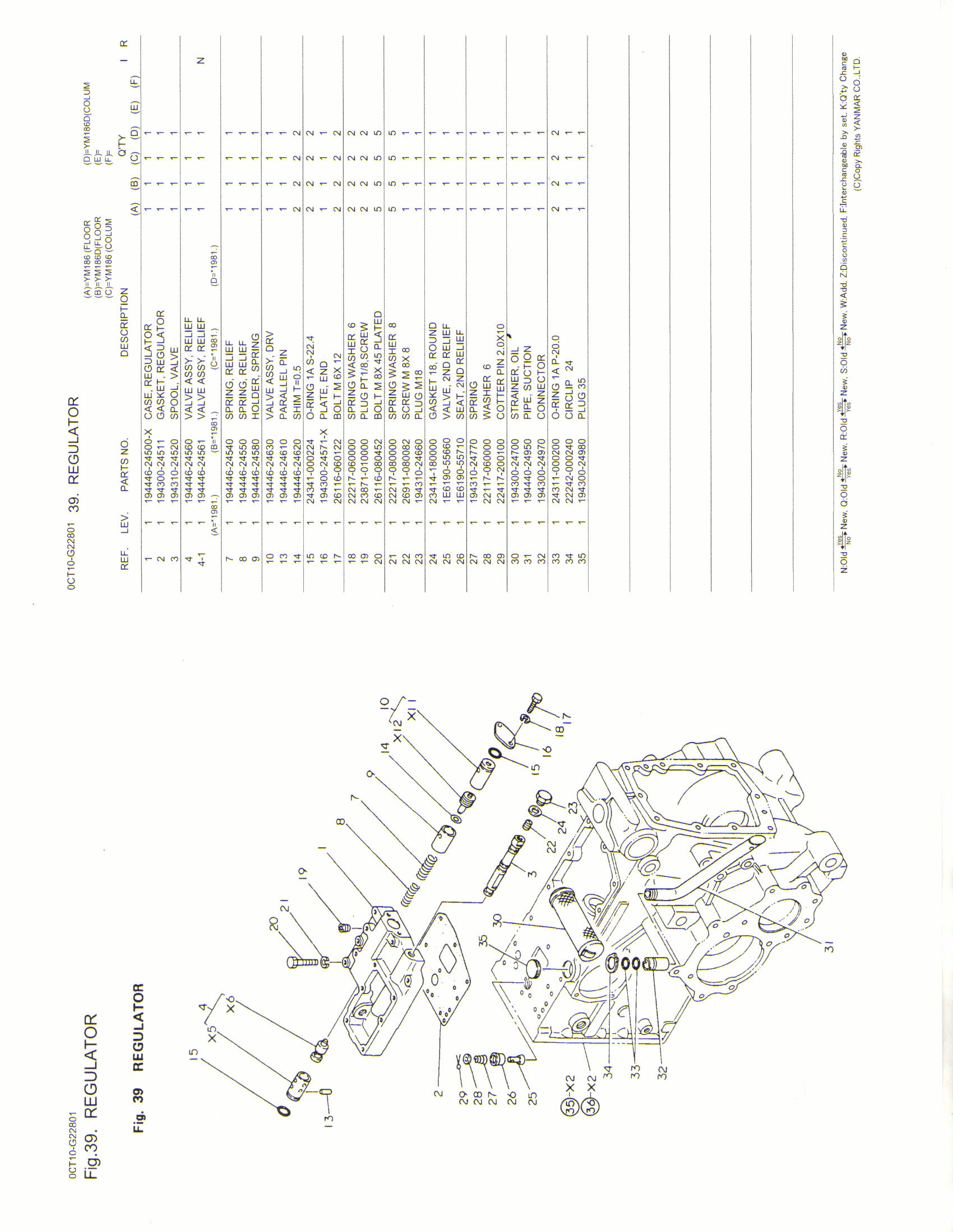

See attached. and especially sections 15 to about 20.
Wish there was something better. It's all I have on this hard to get info machine. :2cents:
  • YANMAR YM186 Parts Catalog - older models.pdf

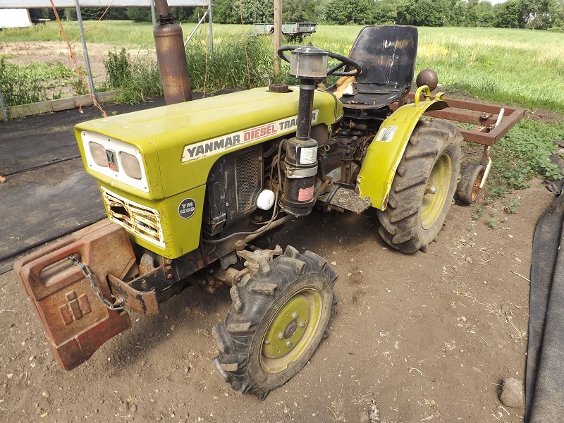

3 miles down the road from me is a YM155D in GREEN.
/ Yanmar 186D broken shaft #67
Yes, that's the famous lime green of the early Yanmars. As far as I know all the Ym155s were green. I lot of folks don't know that the YM155 became the YM165 when the models changed to Red.
What I was saying is that Yanmar made their early line of green Hi/Low range sliding gear tractors from the YM135 right up to the YM330s. But none of those was a powershift, and as far as I know, ALL of the YM186 were powershifts - 3 fwd+1 Rev. with a sliding gear range selector.
rScotty

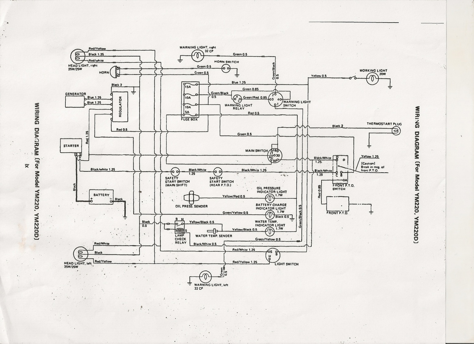

I found the schematics for a 220 in the internet, I guess this is the most close to the wiring on the tractor.
Is this correct? :
The temp sensor is NO (normally open) and the lamp gets tested during cranking as a result of the relay which is activated as it is connected to the switch which also activates the starter solenoid.
The oil press sensor is NC (normally closed) while the key is in the ON position the lamp is tested/on because there is no oil pressure. As soon as the engine cranks or runs there is oil pressure which opens the switch (in the sensor) and turns the lamp off.
/ Yanmar 186D broken shaft #74
Is this correct? :
The schematic I attached earlier confirms that.
Not unusual for me, I erred earlier when I said the temp light only comes on when overheated. There are models that operate that way but you are right, the lamp check on the 186 does allow that light to come on insuring it works correctly.
