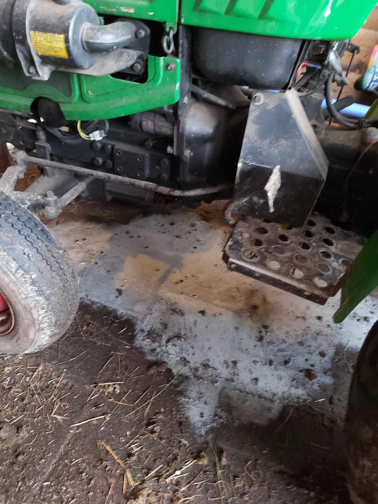

Today I received this picture from the girls driving the Yanmar 186D :
Not good for 2 reasons: Oil leak and also, that is not the right color for oil at all!

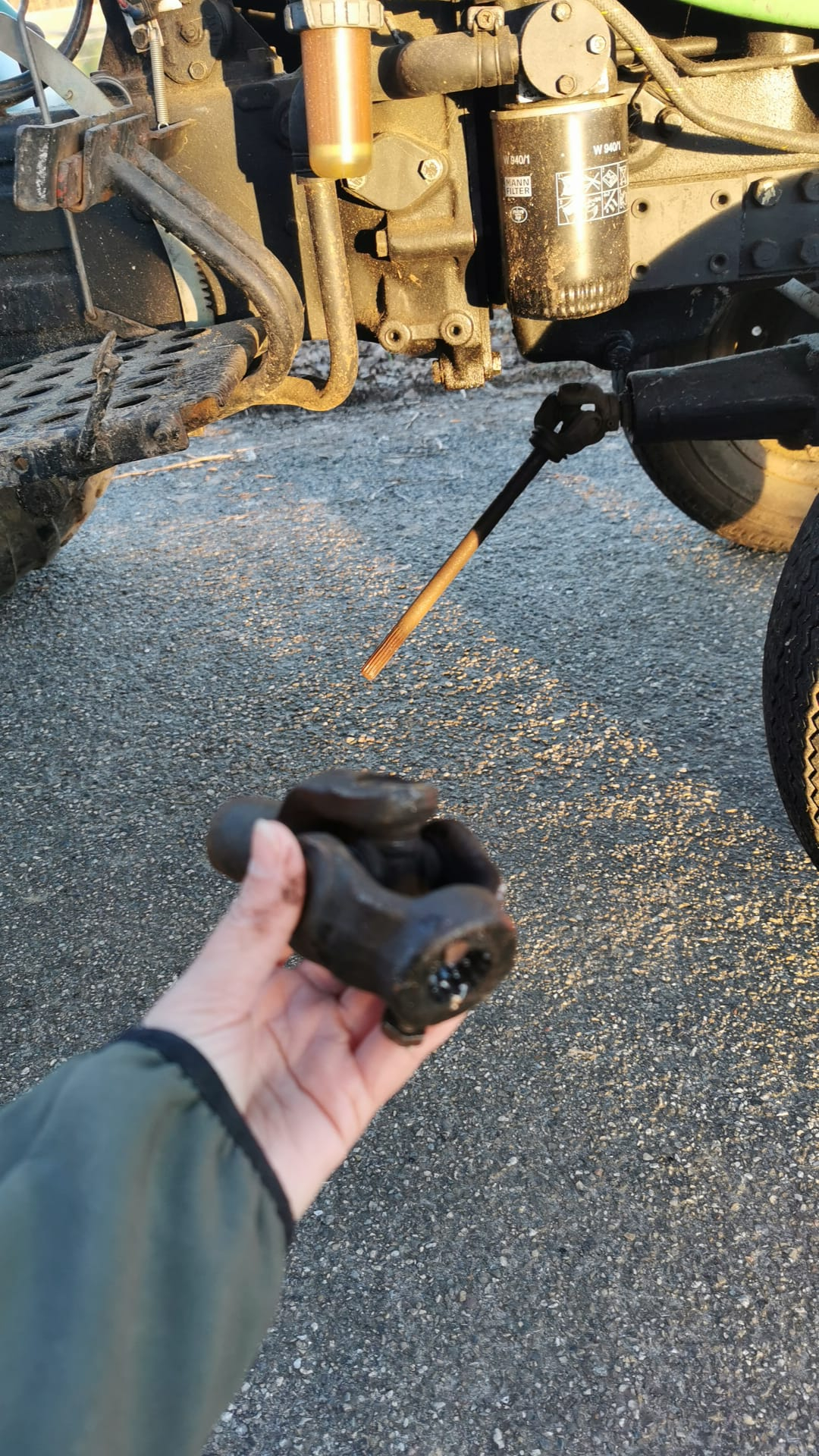

A couple days ago I was told the 4WD axle went loose and fell of:
Because of Covid quarantaine I wasn't able to fix it myself, but someone else did it and so far so good.
But the oil mess today cannot be coincidence if you ask me....

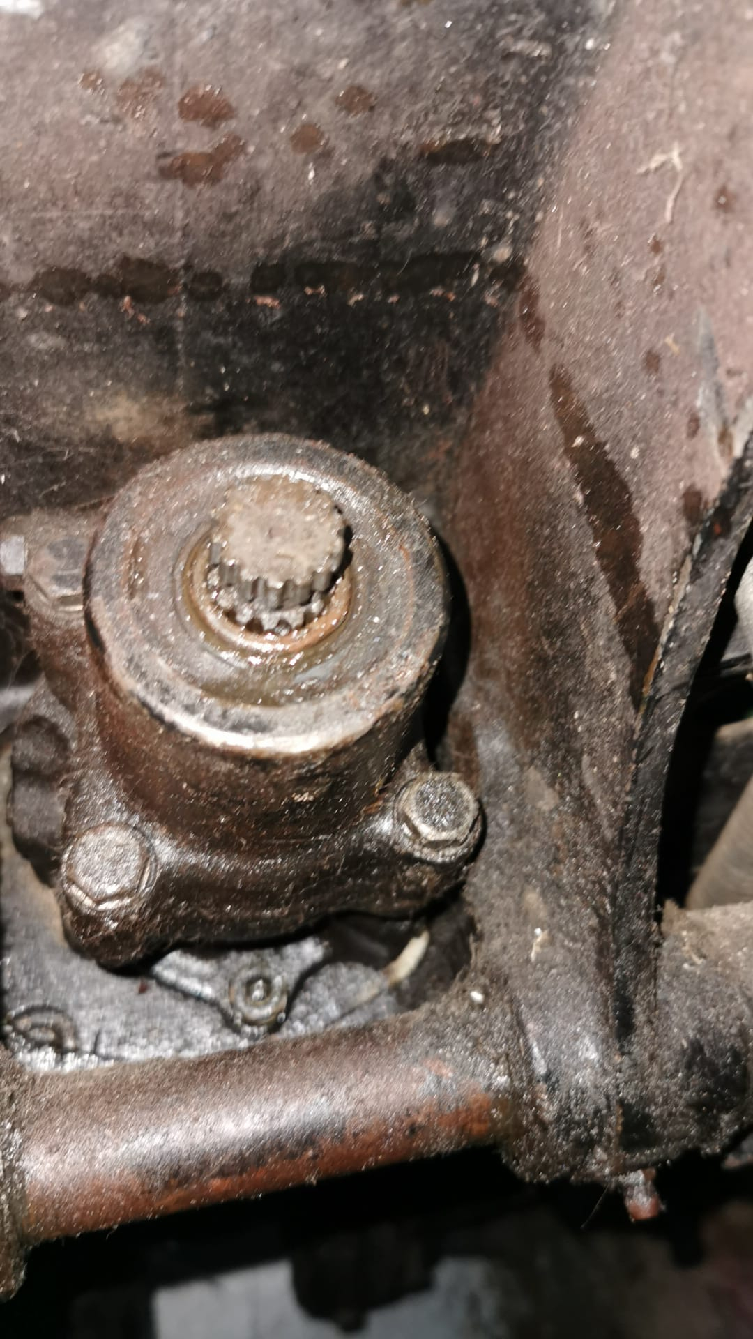

I also got a picture of the axle stub from earlier this week:
I see 2 things, the stub has gone a bit inwards the housing and also there is oil splash on the casing around.

Whatever that "spill" is, I don't think it is oil. I can't decide if it is mold, or frost.
I agree that the drive spline looks too far in, so I fear that you have some bigger issues inside.

If you were to ask my opinion that looks like oil and antifreeze mixed together. And the causes for that are multiple
