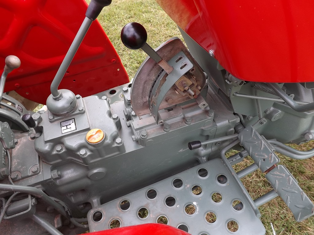

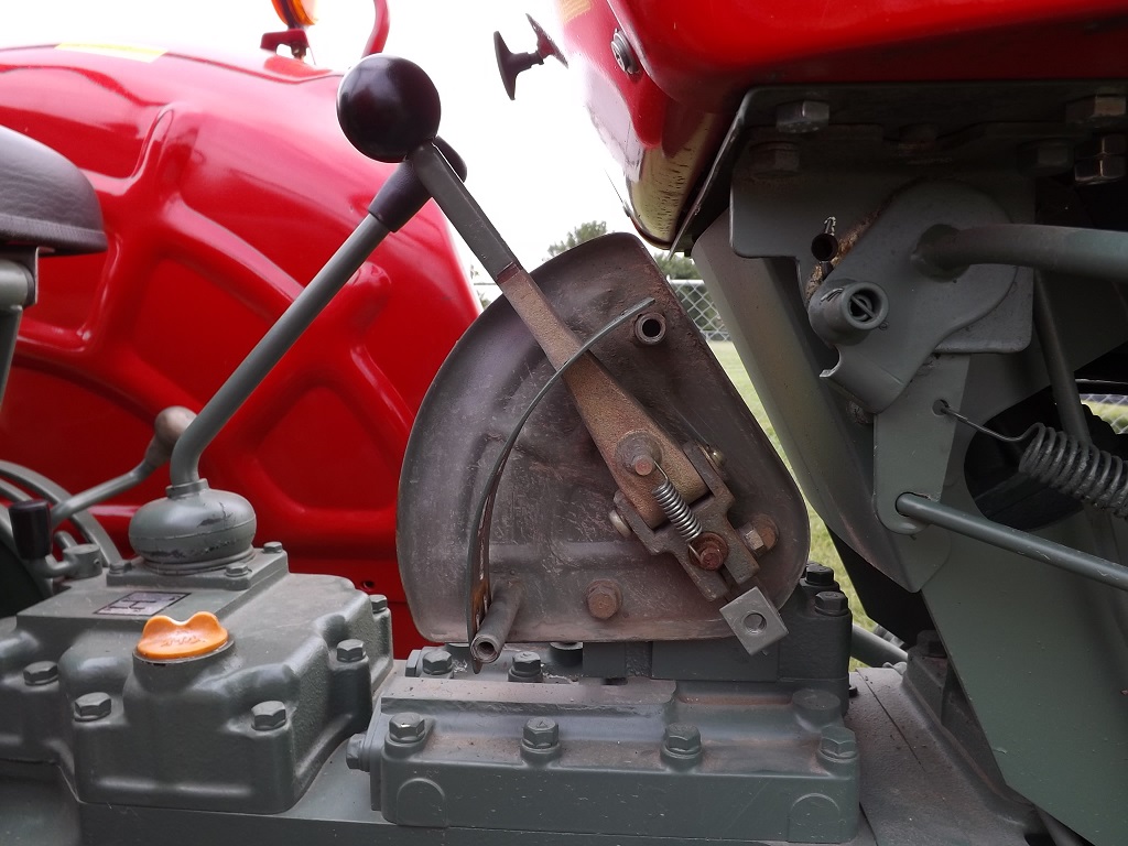

On my YM2610, the PowerShift is down below. I've been doing massive amounts of land clearing this past summer and realized the shift selector actually wearing a groove from the the cover plate. I took the cover plate off and smoothed it out some on the grinder. WOW, that cover plate material is thin, but hard like diamonds. My grinder had to work hard to remove even the slightest steel. Then I took a hand file to remove the burrs and slightly round the pointed corners. Remarkable. The PowerShift is sooooo smooth now.
With all that said, behind the cover plate and the side access cover taken off, there is a pivot and spring mechanism. Look at your machine to see if adjustments can be made.
Hey, I found pixs on my computer when I tweaked this. See attached.
