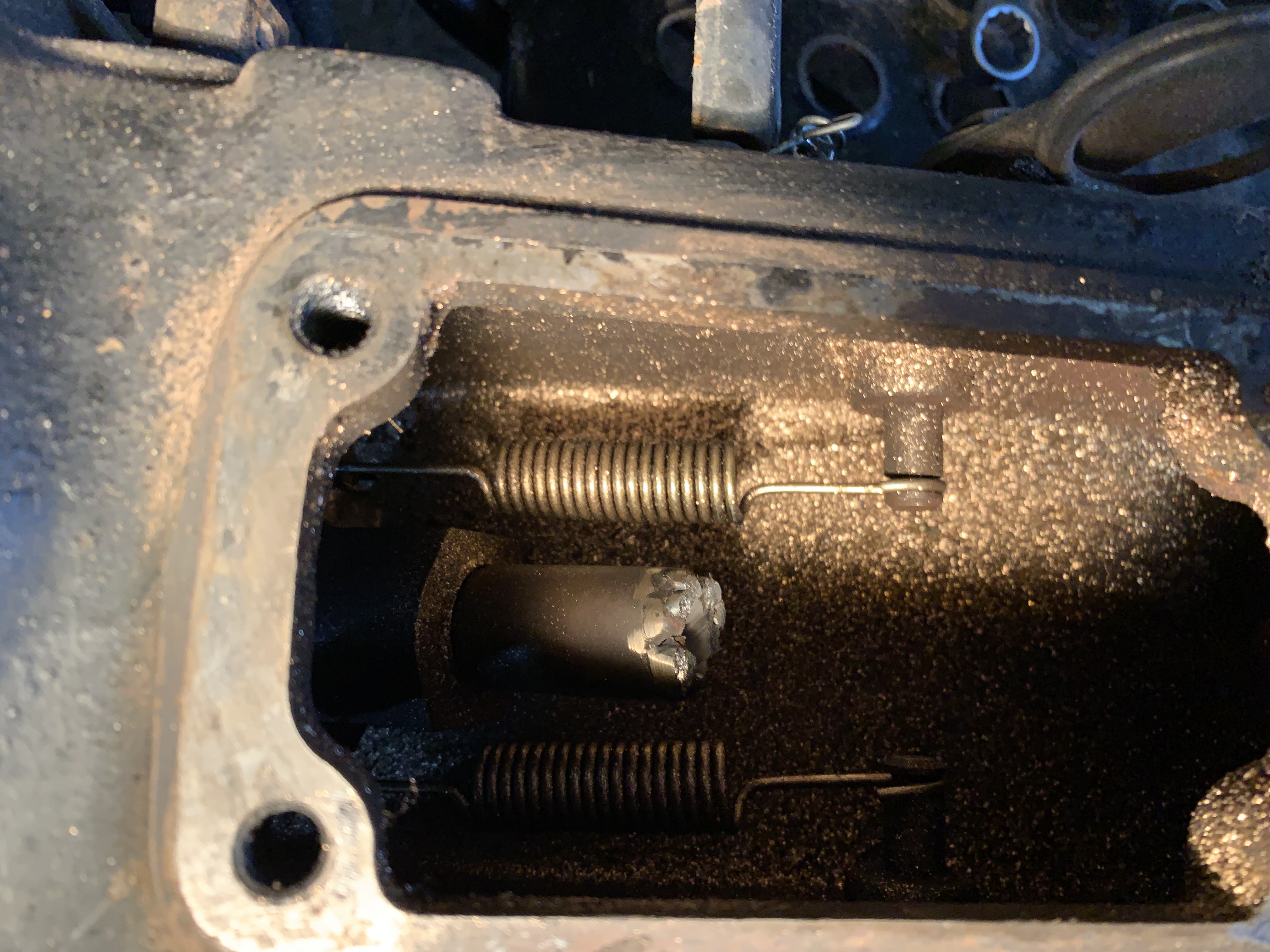

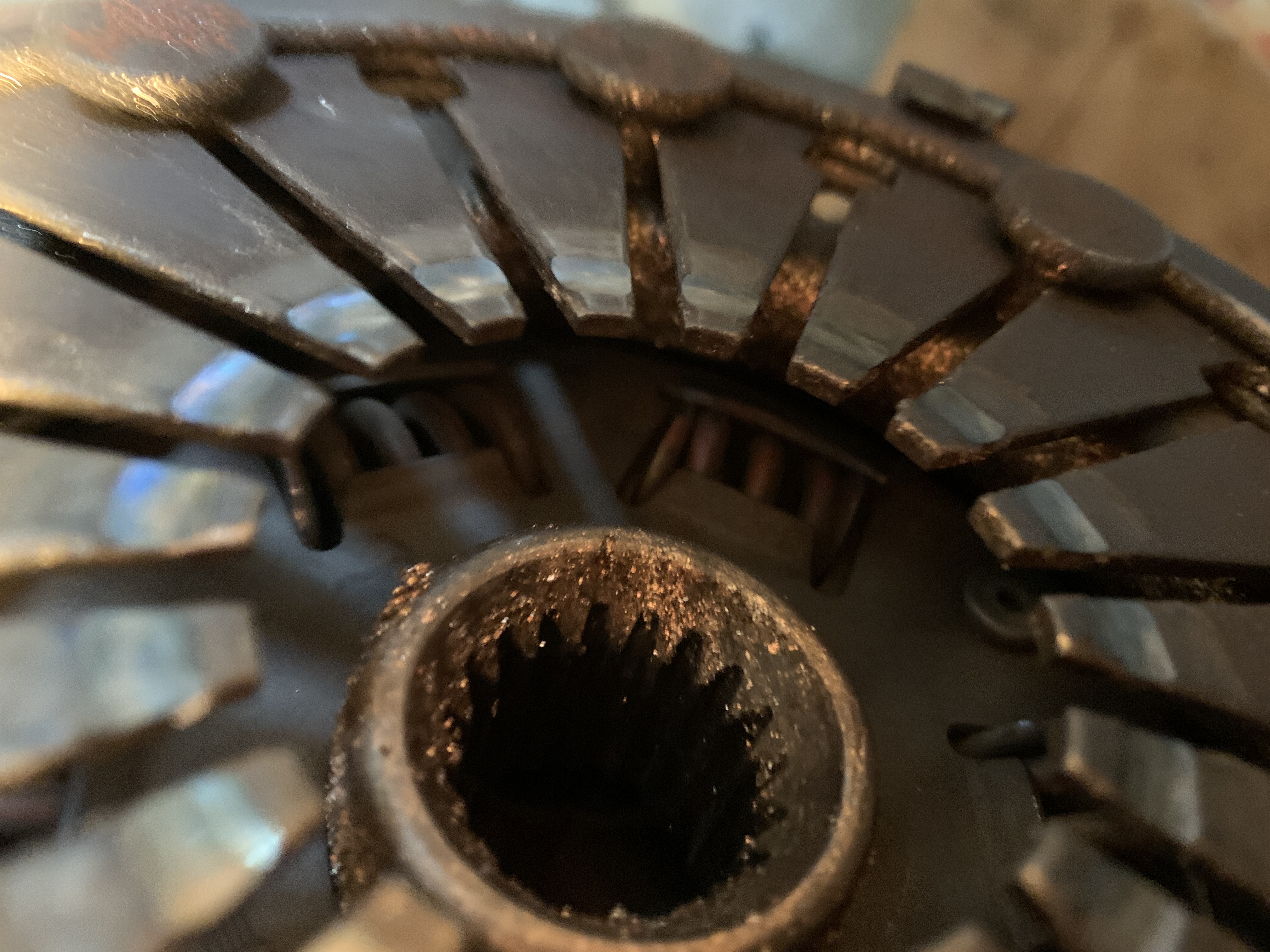

Hello,
Our YM186D has some issues, the most important: the shaft between the clutch and the gearbox is broken.
It has happened before, a mechanic has welded it previous time, now it is broken again.
Im really surprised how in the world its possible to break such shaft.
Does anyone have an idea for what reason this can happen?
Ordering new parts I can fix this, but just want to be shure it won't happen again, any ideas?

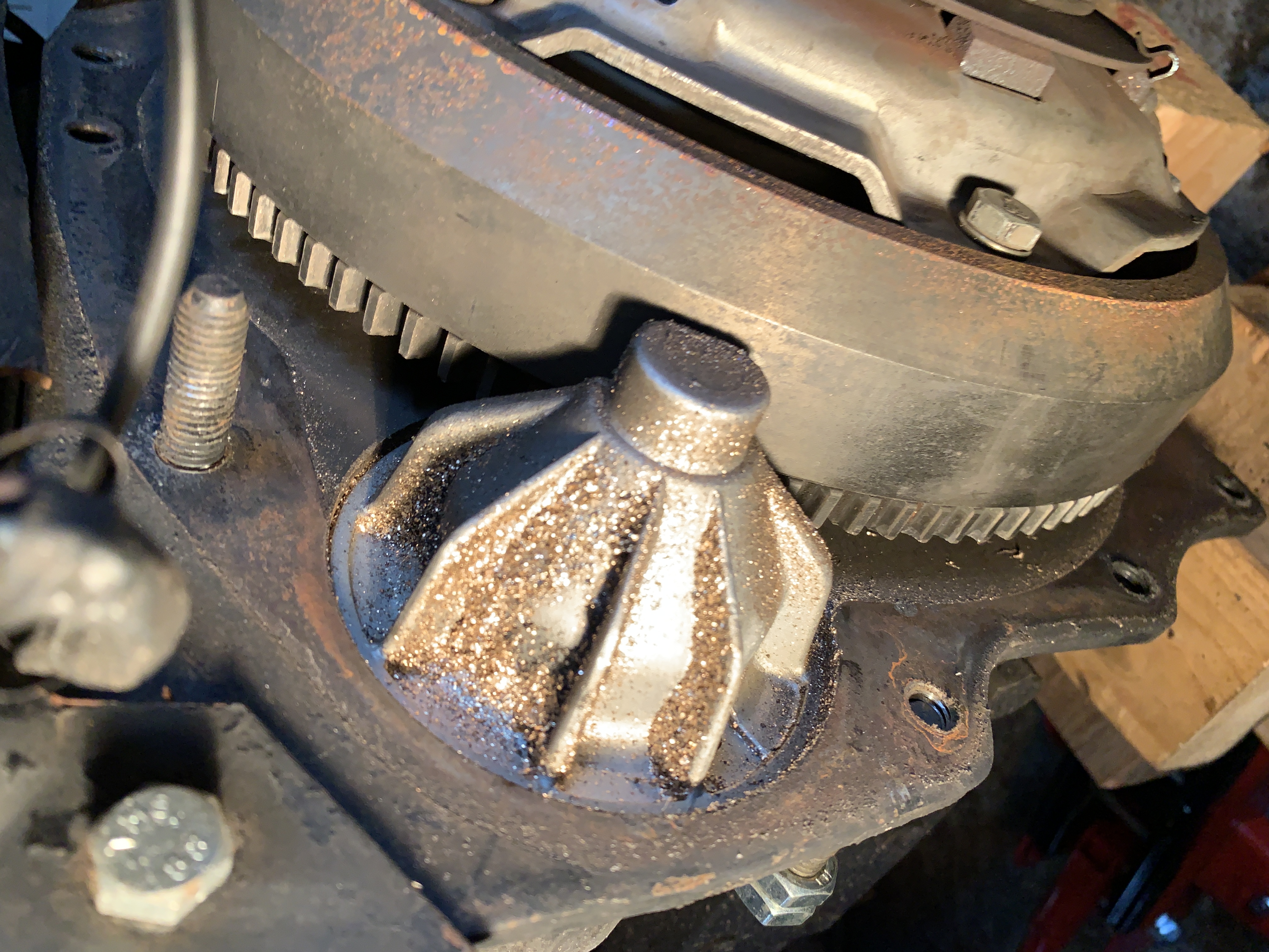

The other thing; a lot of copper coloured shred inside the housing, any suggestions what causes this mess?
Regards,
AJ
/ Yanmar 186D broken shaft #2

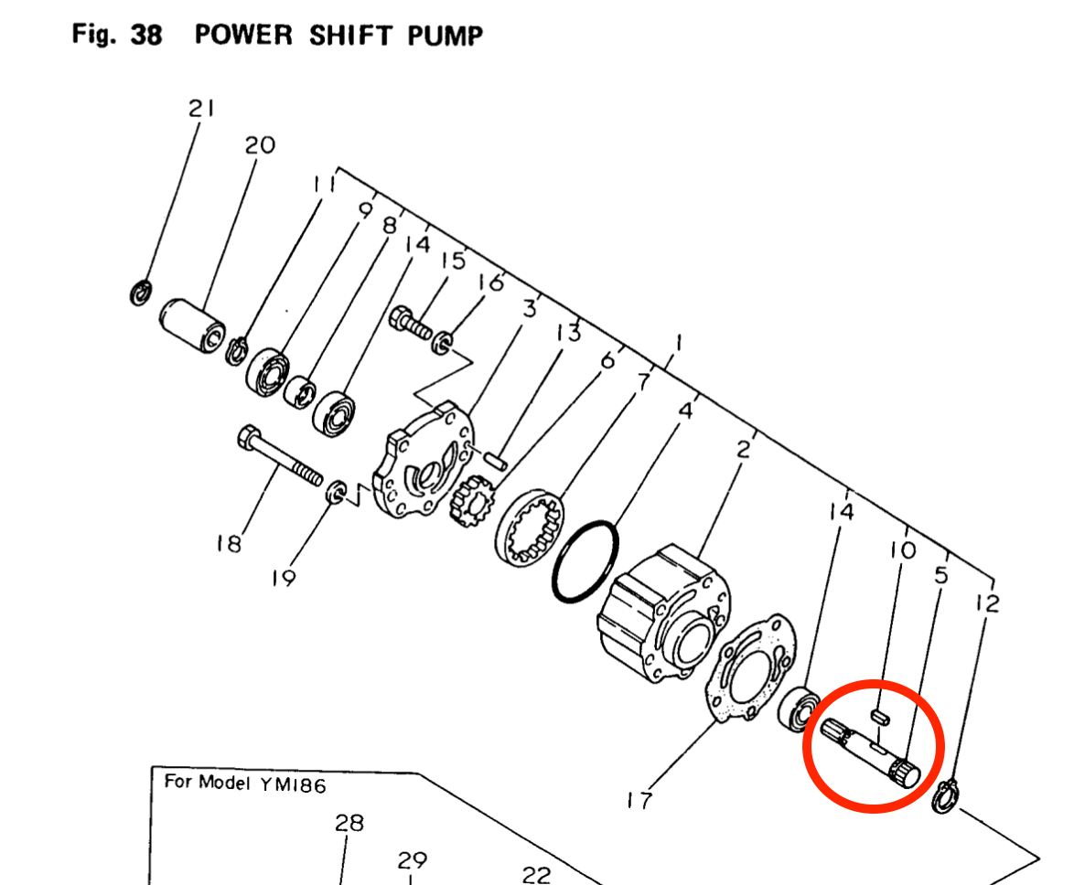

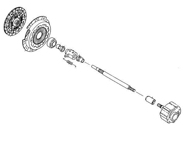

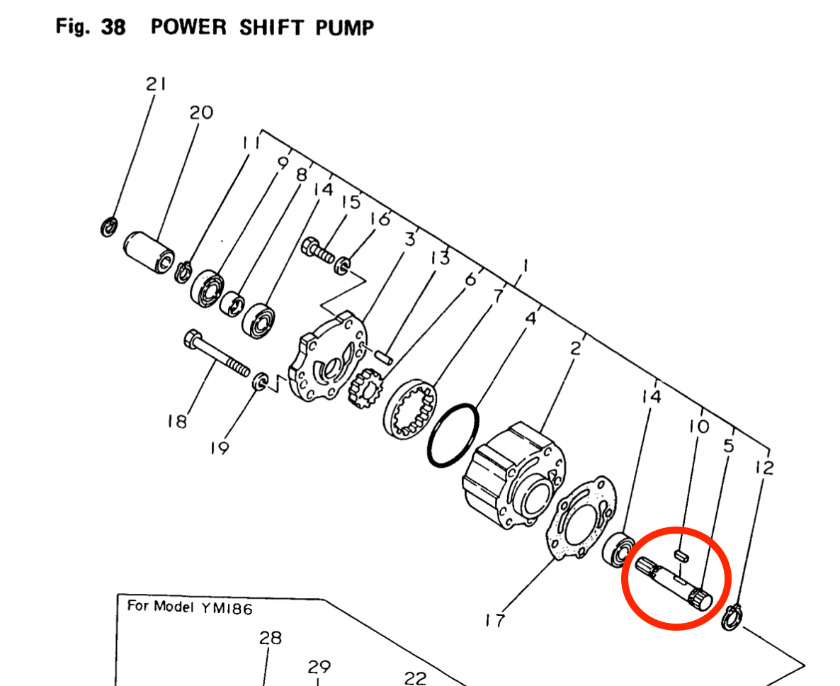

I don't think I have ever seen one break in the middle like that either. Usually the splines just get wore out. The brass looks like either your pilot bushing or the bushings inside your throw out bearing carrier but that is a lot of shavings! Maybe combined with shavings from when the shaft broke? That shaft spins at engine speed (relatively fast) so if it was not welded perfectly straight it could have caused the bushings to wear out quickly. Is the circled shaft (powershift pump shaft) in that last picture broken also? Hard to tell in that picture.
Edit: After looking at the pictures again... was the clutch shaft welded straight to the powershift pump? There should be a splined coupler there.
Tomorrow I will break down the tractor further and want to find out how de powershift and gearbox is doing.
I think its imaginable that the shaft wasn't 100% straight after the welding, but we will never know ;)
The brass looks very fresh and shiny to me, so maybe it was created just after de shaft has broken and dit some oval like rotations.
To answer the question, yes it is welded together, which wasn't the best idea in my opinion :(

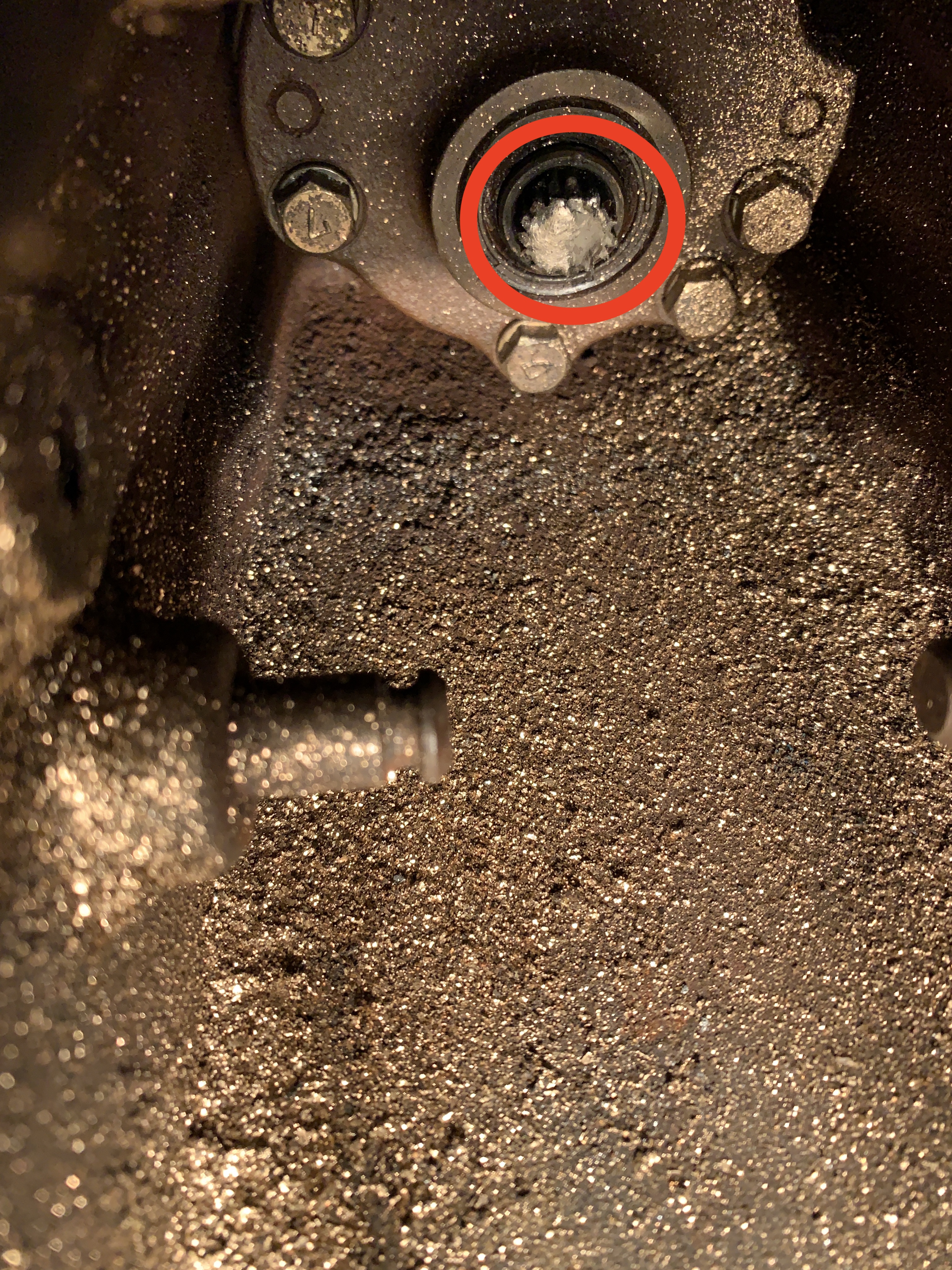

I added some pictures, the space around the shaft is this normal/ok?

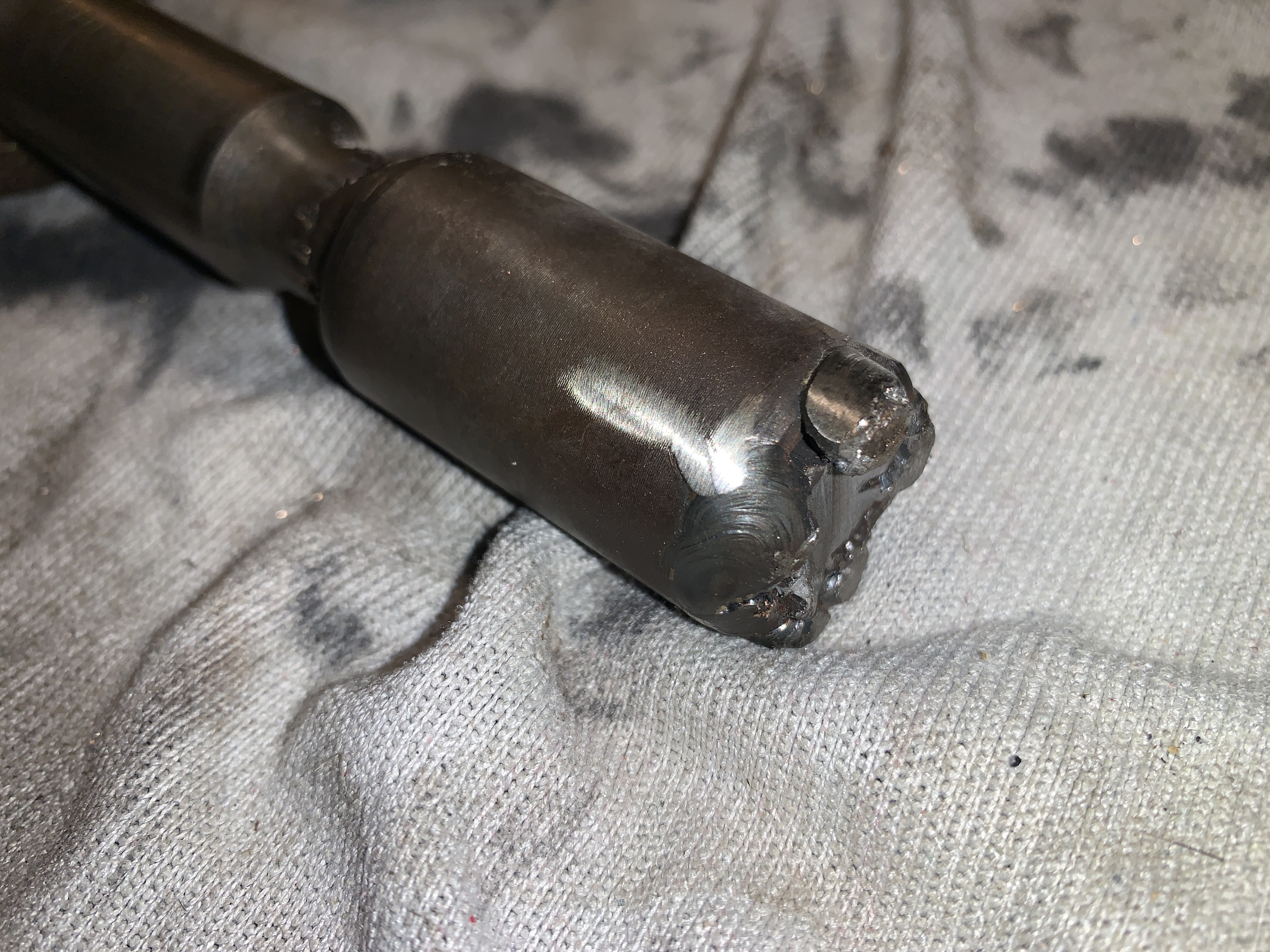

The break after it got welded was to be expected, but why it broke the first time is indeed strange.
That spline coupler also allows for a little bit of play and misalignment between the shafts. If it's welded solid, something will break.
Did it break both times after you own the tractor or just this time?
/ Yanmar 186D broken shaft #6
Good point. Welded solid, the slightest misalignment would thrash the throwout bearing liner. Probably the pump internals too.

I'm afraid it broke already before you own it and the previous owner just did one of those "fixes" just to get it sold.
Either it broke before or just stripped the splines then someone welded the spline coupler.

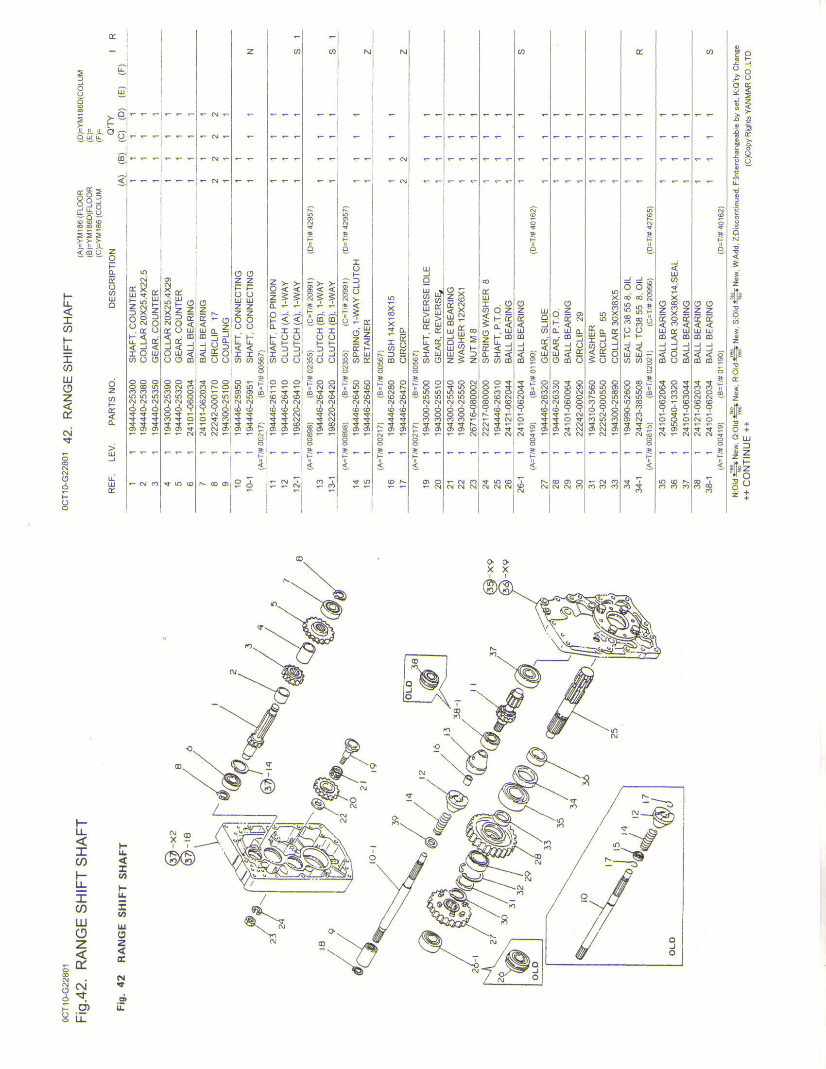

Anyway, looks like you'll need to take the input shaft of the transmission off to replace it. I'm not entirely sure on the availability of those, hopefully not too bad.
#9
Talking about this one right?
/ Yanmar 186D broken shaft #10
Yes, the one that broke the end of.

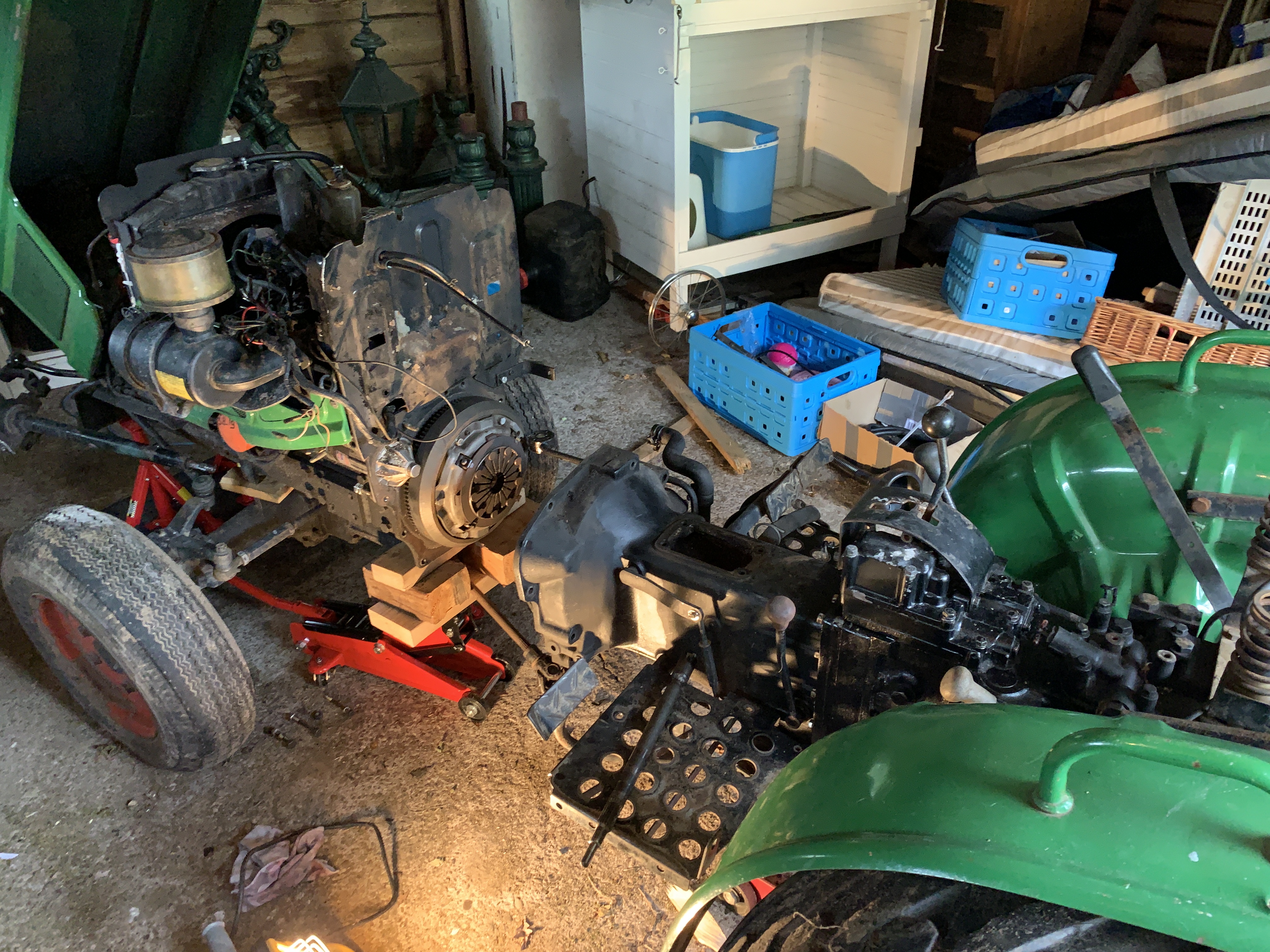

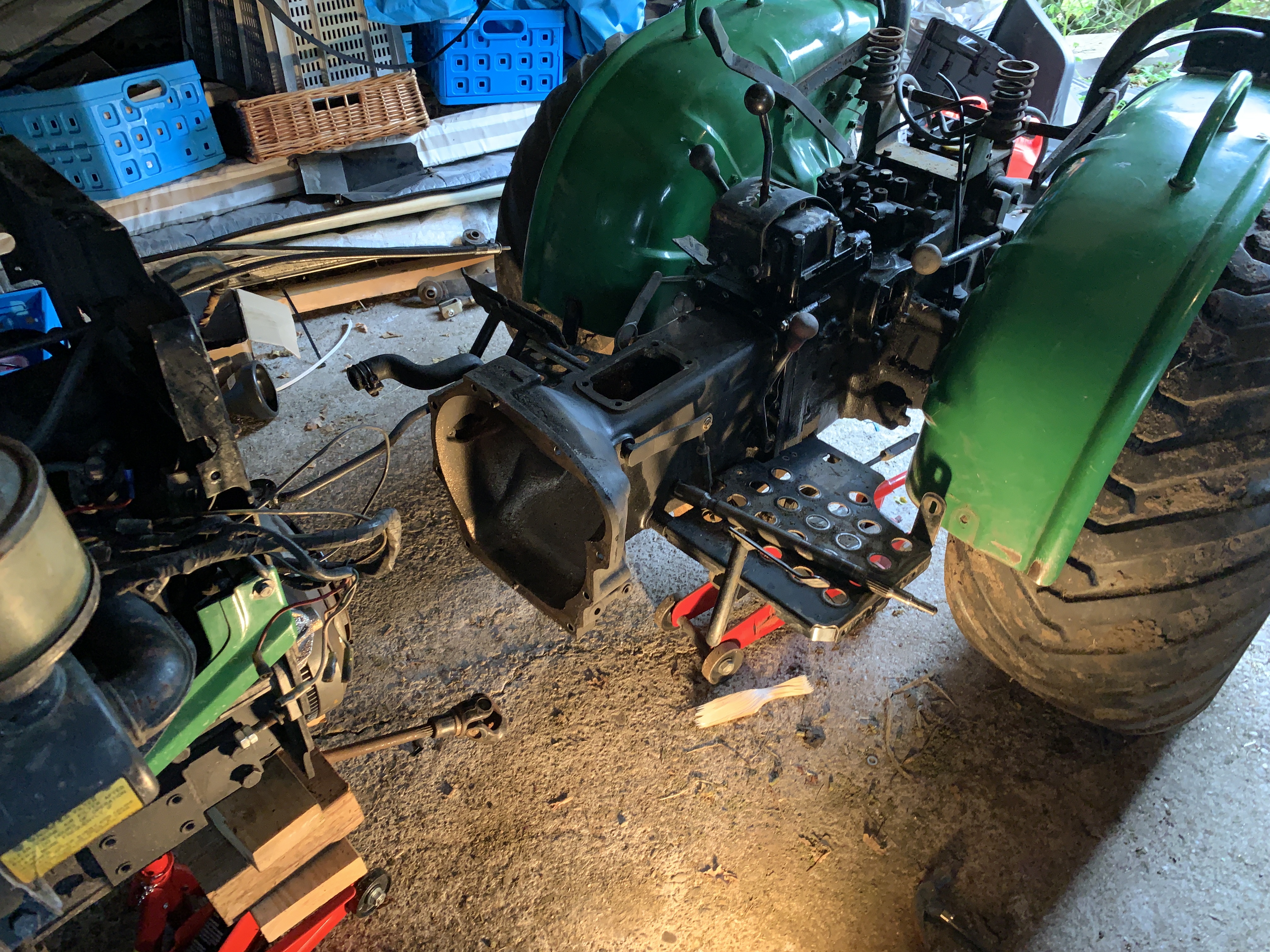

#17
I got some spare parts from a 1510, which was only few minutes away :)
Shaft and coupler seem to fit, now i have to get to de PS pump.
Now Im stuck removing the middle part from the tractor.
Removed all bolts and nuts, but it looks like the shaft for the 4WD lever needs to be removed as well.
The lever is off, but no idea for the next steps.
Any who knows how to do this?
#19
Finally I made it:
Ive got another pump from a 1510D, sadly the splines on the backside don't match :(
So have to spend some more time on finding spare parts....
