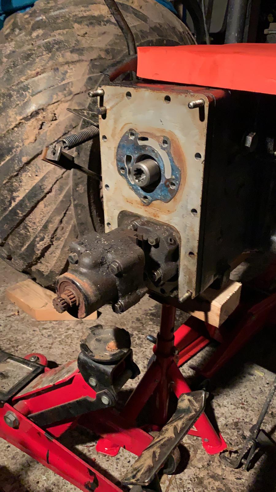

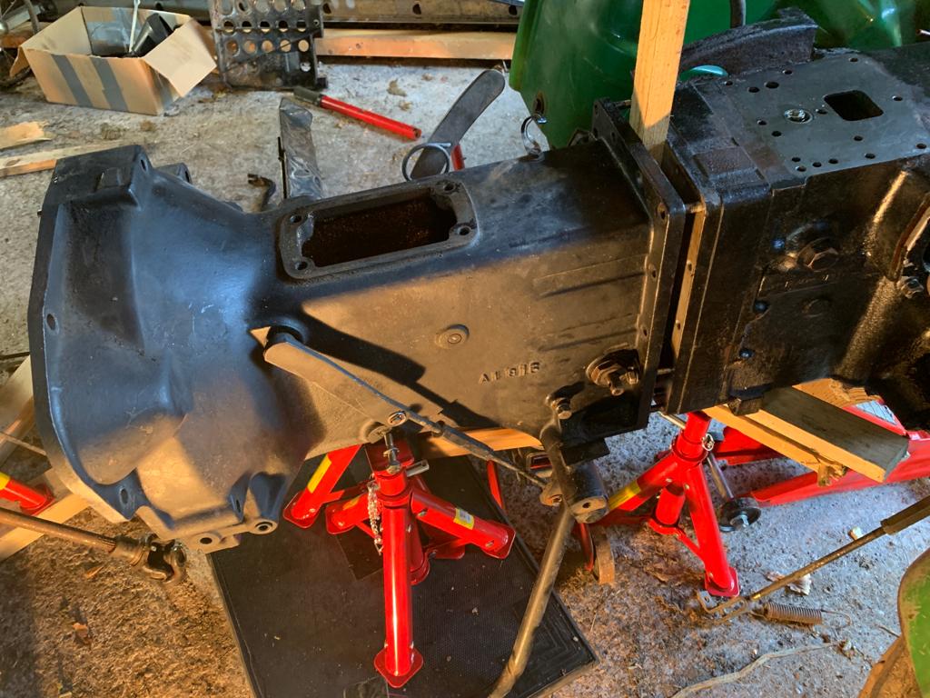

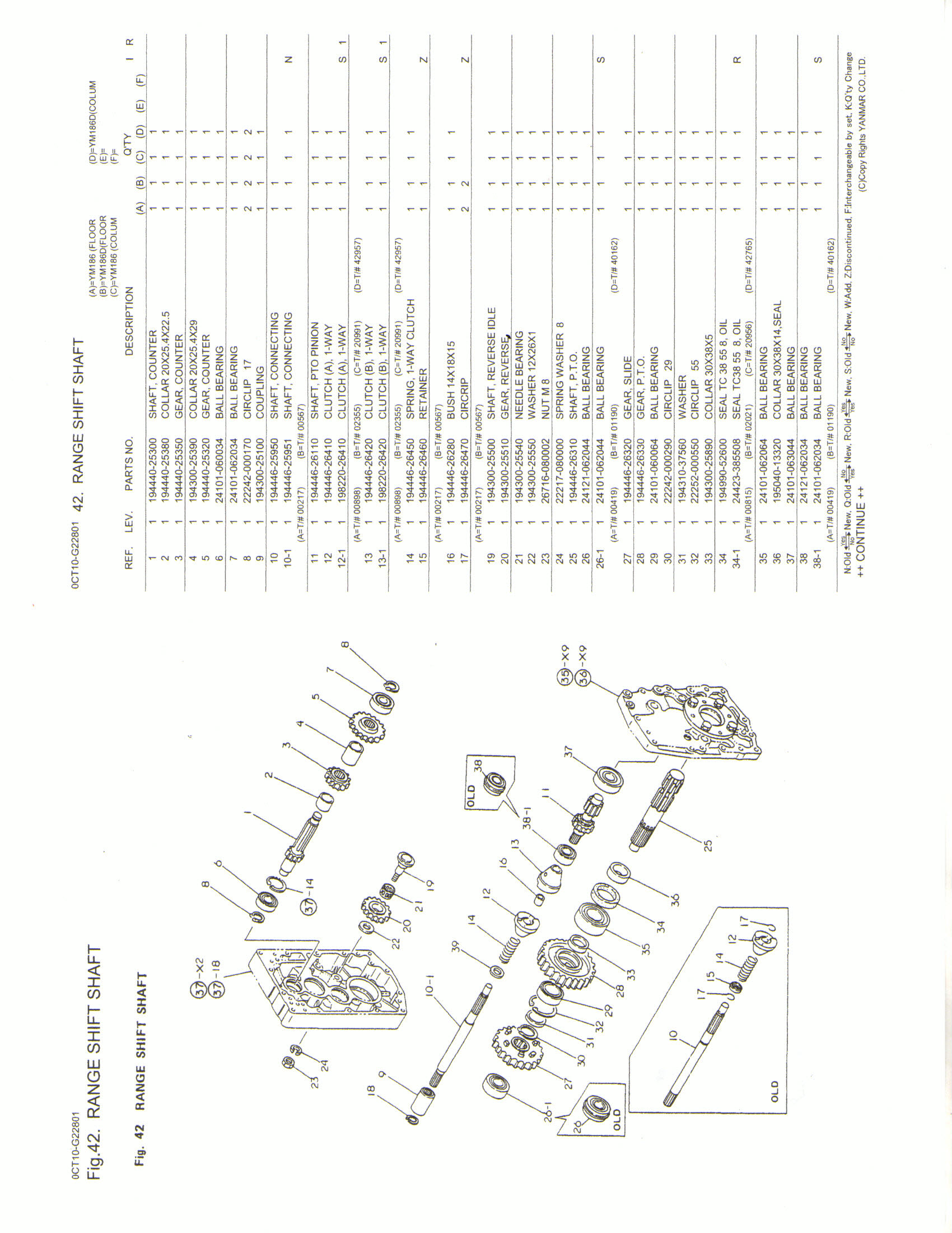

Im working on 2 scenarios:
1:) replace the main shaft, splined coupler and PS pump shaft, but hard to find this parts. I asked hoyetractor, not shure if they ship to The Netherlands.
2:) I got a clutch disc, main shaft, splined coupler, PS pump from an 1510, almost identical but sadly different splines.

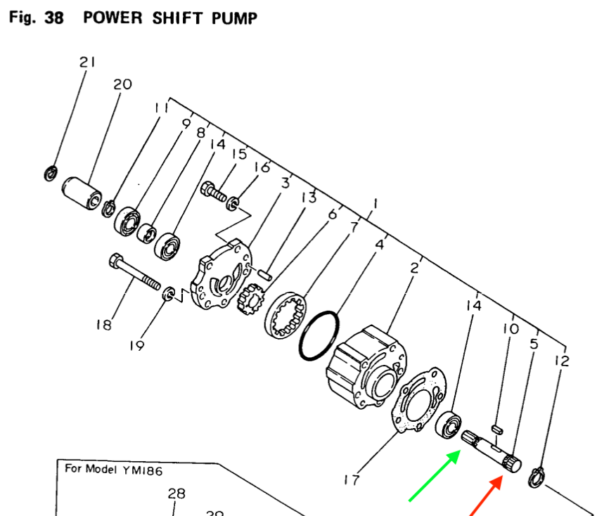

The idea I have is to have a custom shaft for the PS pump which has 186D splines on the output and 1510 splines on de input side.
Green arrows = 1510 parts
Red arrow = custom, 1510 splines
Blue arrow = custom, 186D splines
Or a splined coupler after the PS pump which has 186D splines on the output and 1510 splines on de input side, not shure if that is possible to produce...
What do you guys think?
Any ideas how to open the PS pump? I removed the 2 bolts and the circlip on the output side, but it doesn't open much further than a couple of mm.
Are some steps missing, or does it need more force?

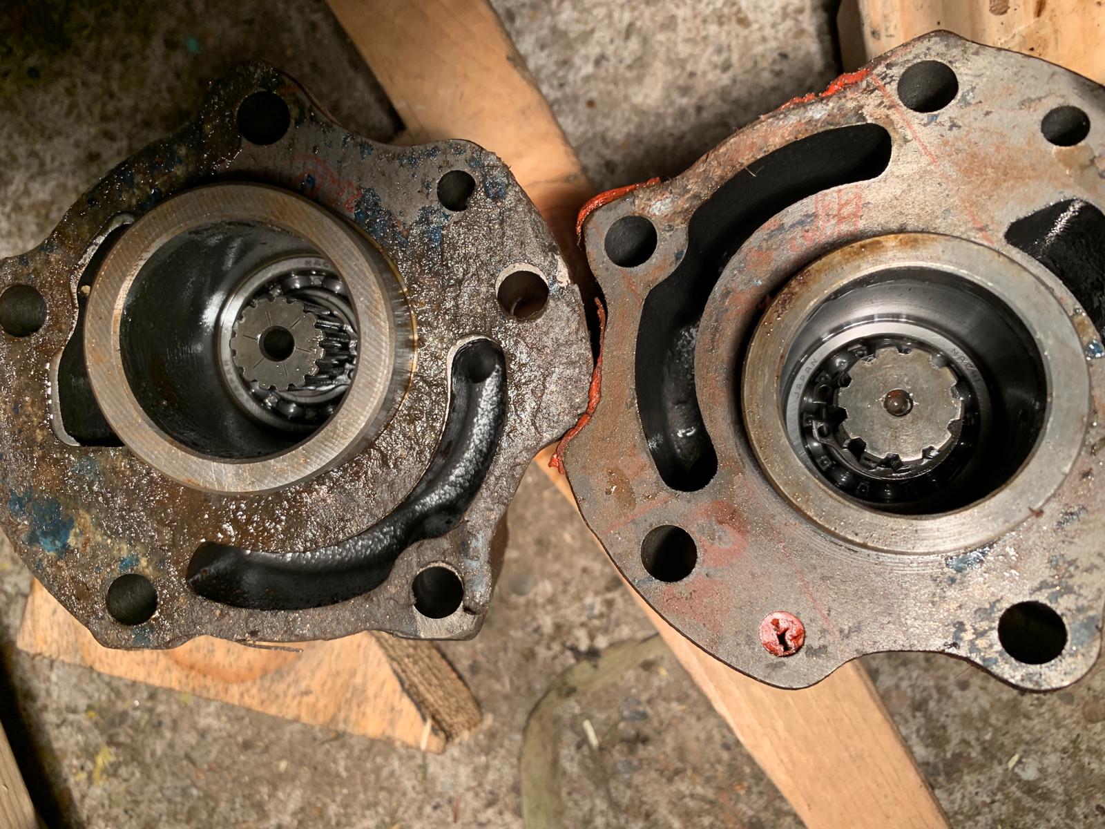

What about using all 1510 parts, including the pump clear up to including the clutch disc? Even if you have to shorten the shaft, this might be simpler.
/ Yanmar 186D broken shaft
#28
Sadly not possible because the splines on the output side of de PS pump 1510 don't match on the input side of the 186d gearbox.....
So de idea is to have a custom shaft for the pump:
The green side needs 1510 splines, the red side needs 186D splines

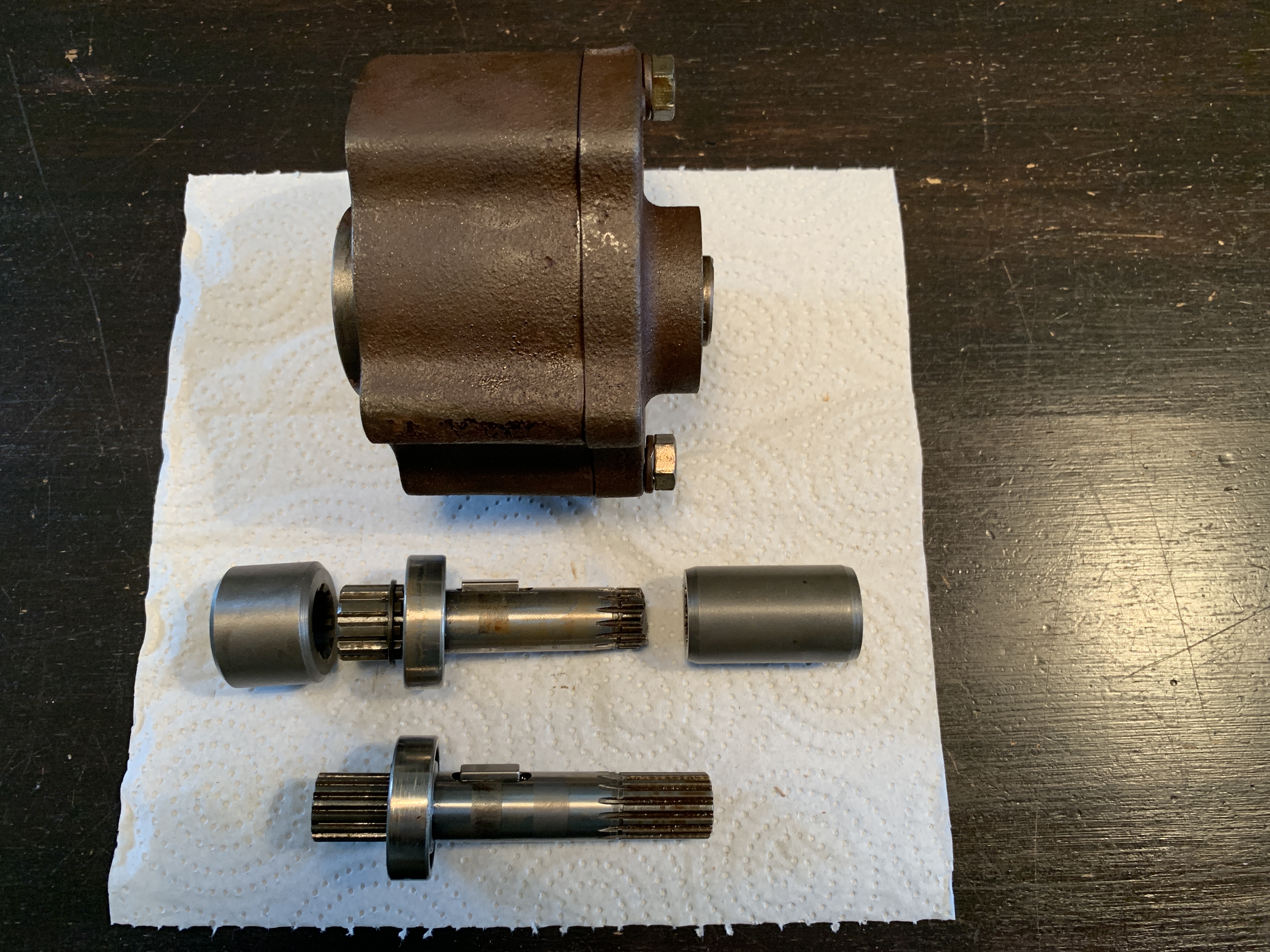

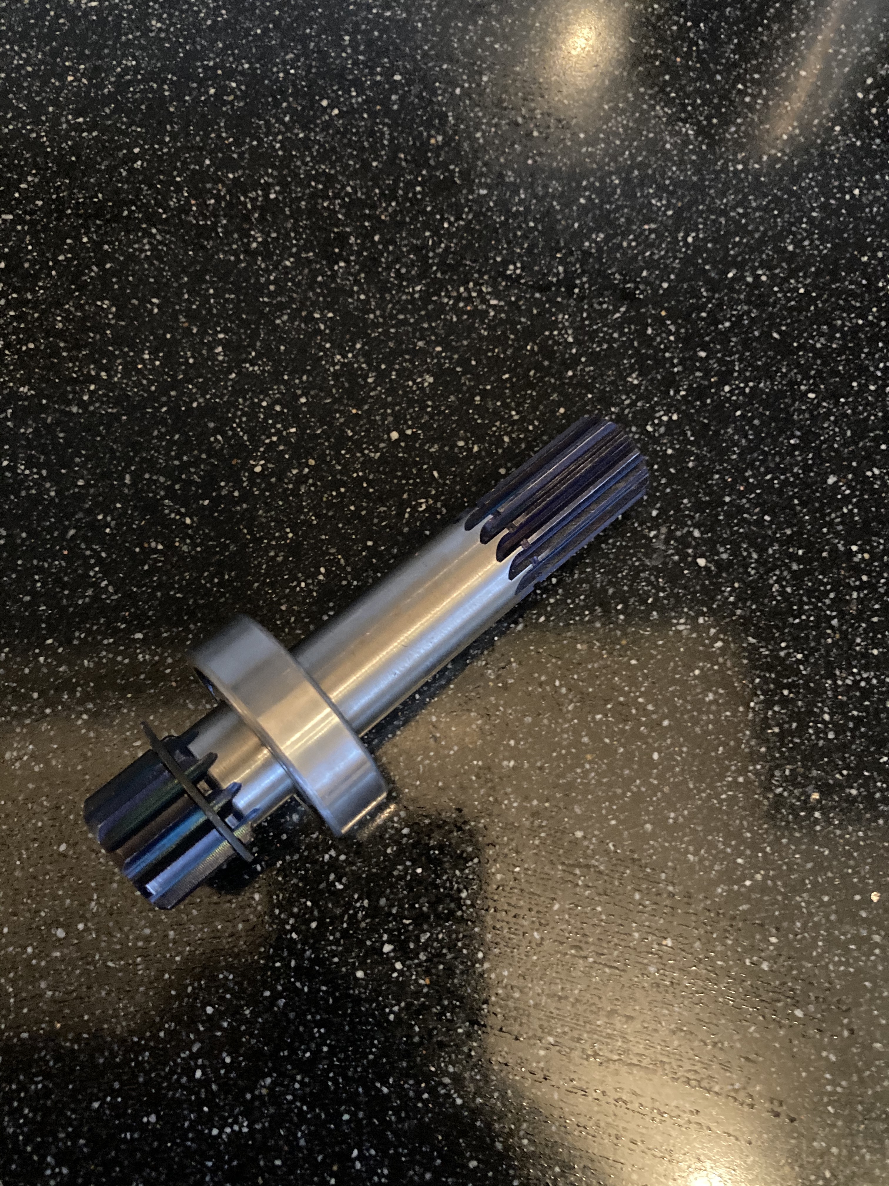

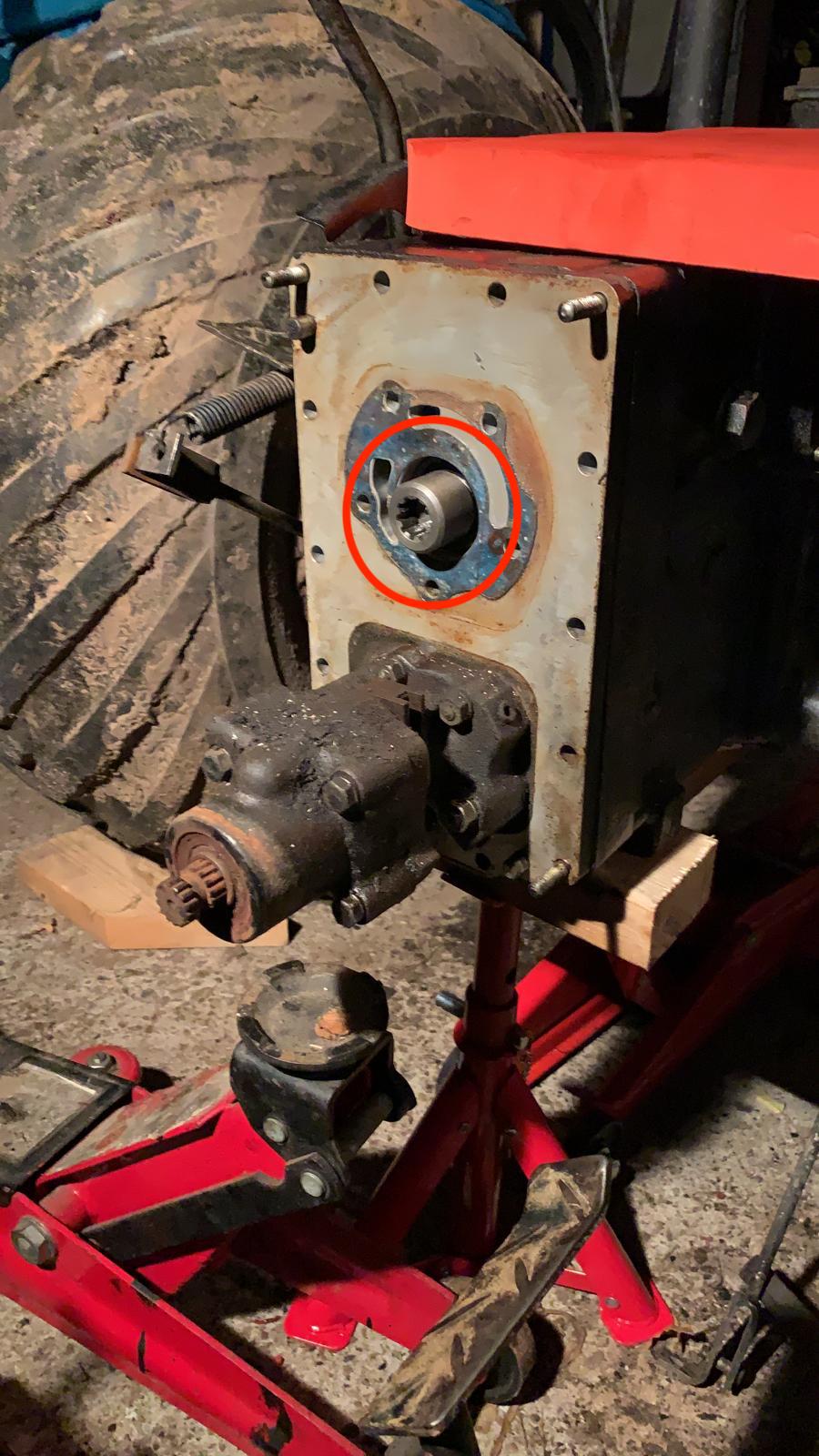

Last week I got the new shaft for the pump:
From this:
To this:
I rebuild the tractor, put a new hydraulics filter on it and added new oil in the transmission/hydraulics reservoir.
At first the tractor seemed to work 100%, but after a while the powershift give some issues, it wont shift in the reverse and 1st gear.
Sometimes it won't shift and sometimes it takes up to 30 seconds and then it shifts into gear.
I suspect it has too little oil in it.

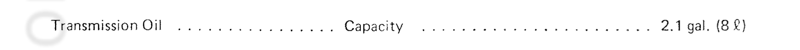

Got 10 liters, filled the filter first and the put the rest in the reservoire.
The manual says it need 8 liters, but I think it needs way more.
Anyone over here who knows how many liters oil this tractor needs?

I would be looking for a suction tube leak. That pump is setting up pretty high so there must be a tube reaching down into the fluid. A leaking connection or hole in the tube might be close to the normal fluid level and under use it sucks some air. The previous "fix" might have been to add fluid until it quit sucking air. Is there no sight glass or dip stick?

Did you clean the suction filter that is inside the reservoir? This is in addition to a screw on filter. If it is restricted, hydraulic fluid flow will be affected. It is low in the reservoir, so fluid loss is a given with its removal (drain first). If your fluid is caught clean, you can reuse it. Access plate should be on the opposite side of the transmission housing from the suction tube going to the spin on filter and pump.

8.4qts, 7.95 liters according to tractor data info.
