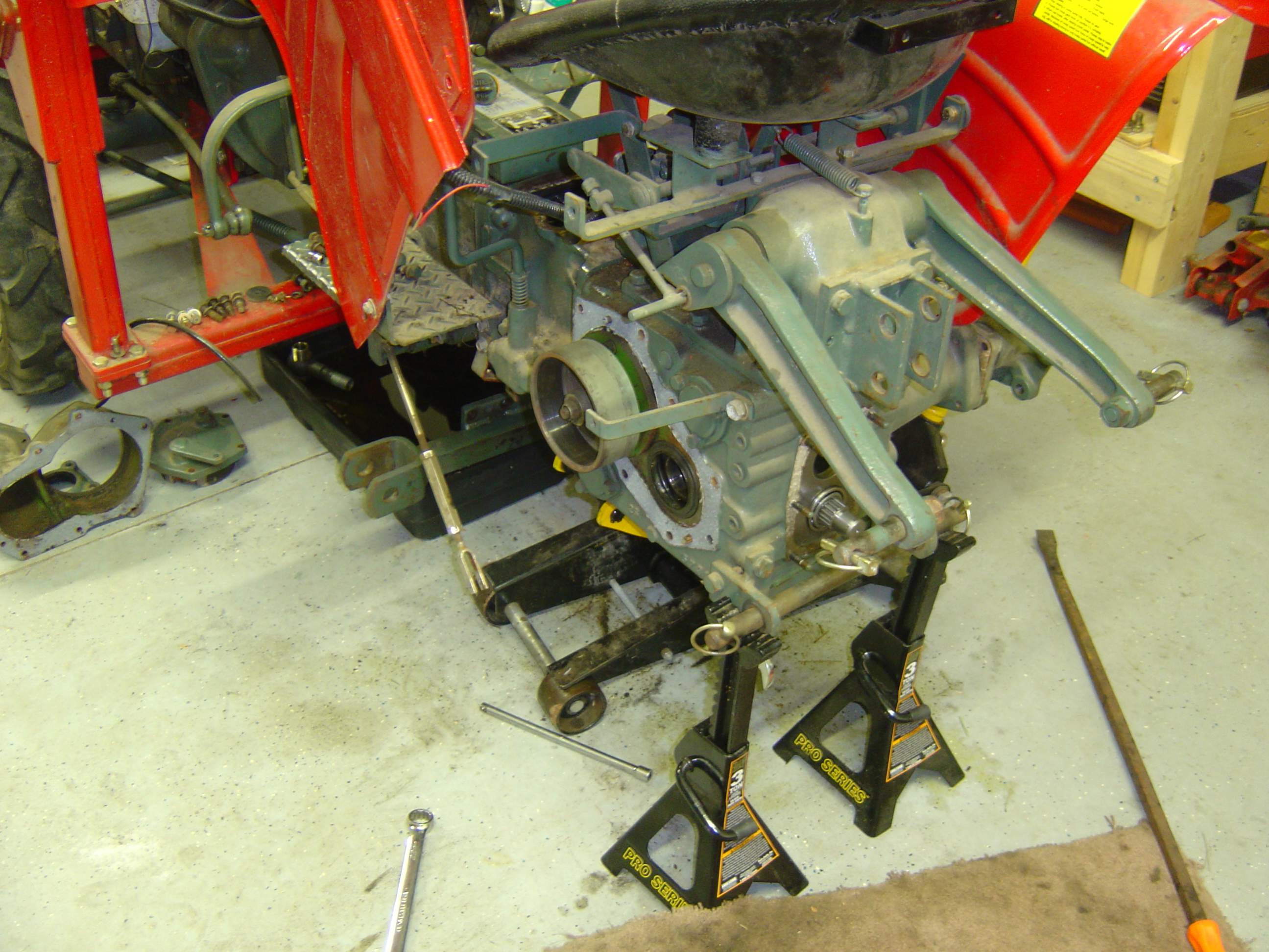

Well I did enough damage for today. I loosened the left side cover hoping it would come off.
NO LUCK. I also took off the PTO and I can see the bolts in the end of the axle but thru the two inch whole I don't see getting a wrench on it. I know I could never get it back in.
You mentioned a plate in the bottom but the only bolts are for the pin hitch.
I noticed you had yours removed.
There has got to be someone who had brake problems on a Green
Have a nice evening Y'all

Relhogh, how is your pin hitch attached? Is it on a flat plate? I'll take a picture of mine. Tell me if it's the same. I had a heck of a time getting the axle housing off. There were alignment pins and 30 yo gaskets holding it all together.
/ Yanmar 1500D Green #25
Best picture I can get right now. The plate the hitch is on is the plate that seals the axle housing.

I took the 8 nuts and bolts off the pin hitch and beat on it.
No luck. Then I noticed somone had welded it on.
#29
Winston 1
I took the hydralic lift off and got a great view of the bolt. Not great access but a great view.
I was able to get a wrench on it thru the pto hole and used a large pipe wrench on the axle and about 40 turns later the bolt came out.I was then able to pry the cover off. The large gear stayed pretty much in place. I can't wait to see what a hassle getting the bolt back in.

For future reference, there should be two threaded holes in the housing which aren't used. These are meant to thread the bolts you just removed into. These holes are through holes which allow the bolt to push the cover away from the tractor. Makes easy work of the separation.

The bolts you remove from the housing itself. You just re-insert a couple of them back into those threaded holes and "tighten" them (although you are really just screwing them through the housing, as there is nothing to tighten them against). As you screw them in, the bolts go through the housing and push off the transmission, thereby separating the two. After that, you just scrape off the gasket and pull it off.
I used a strap to support the housing and simply pivoted it aside, that way I wouldn't have to lift it back in place. Was much easier that way.

The housing I speak of is that big plate looking thing through which the axle protrudes and has about six or eight bolts. If you wish to remove the axle, that housing must go with it.
