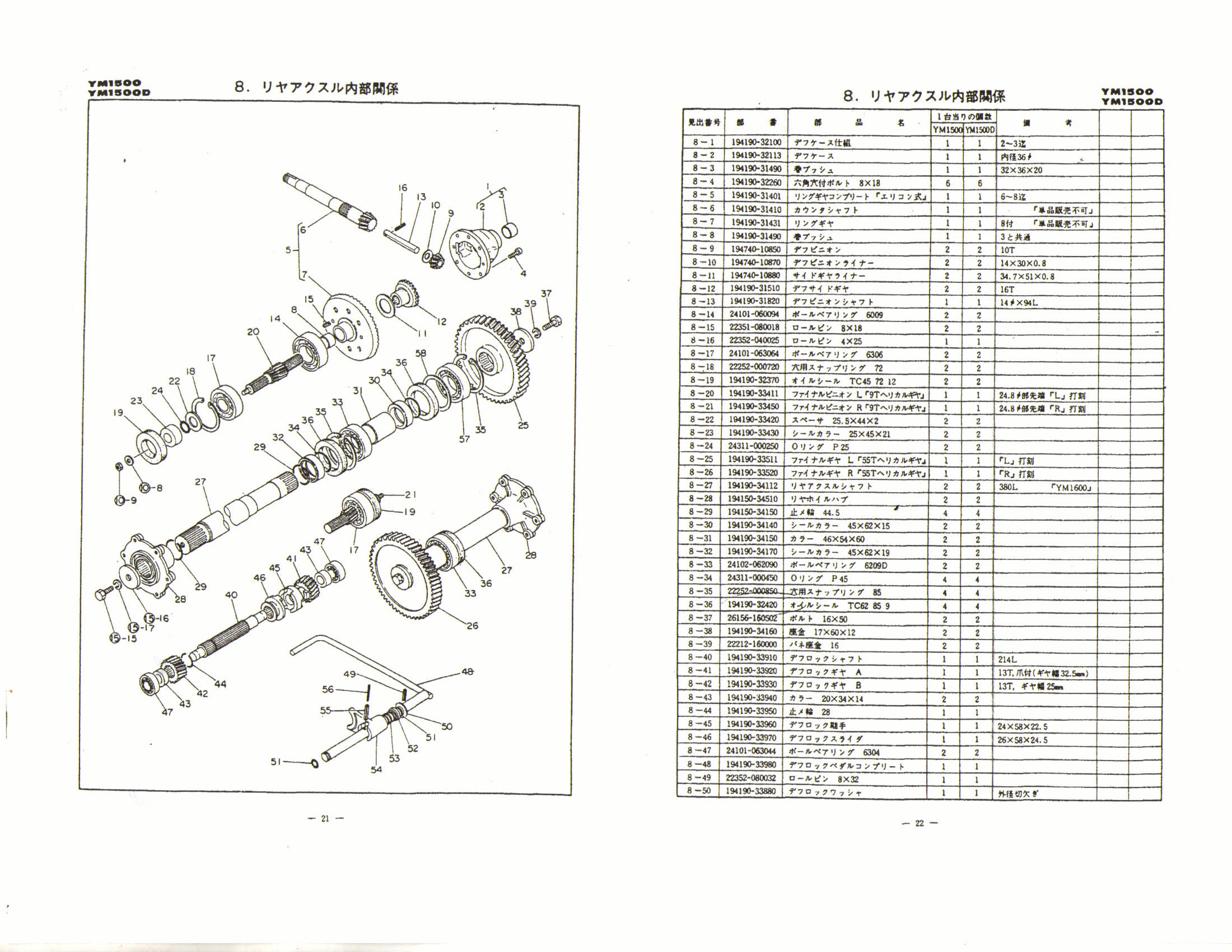

I'm doing my best to find parts, but can't make heads or tails of the parts diagrams. I know I need a seal (part number unknown) and the collar as the collar is rusted. I don't know what else I may need while I'm in there.

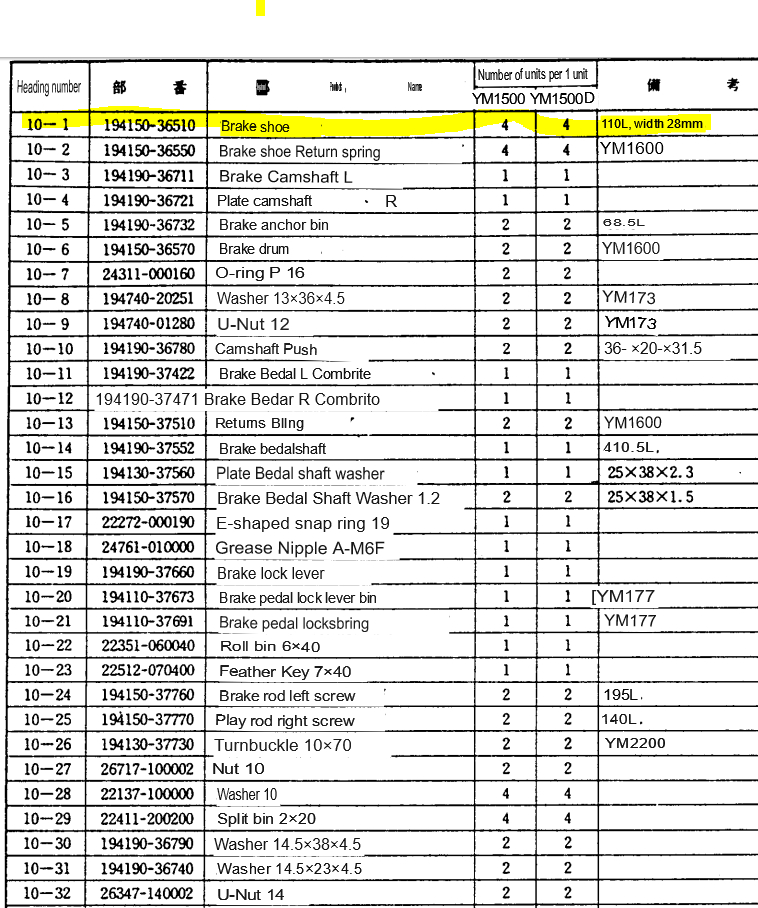

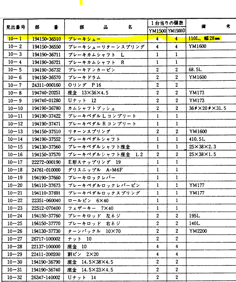

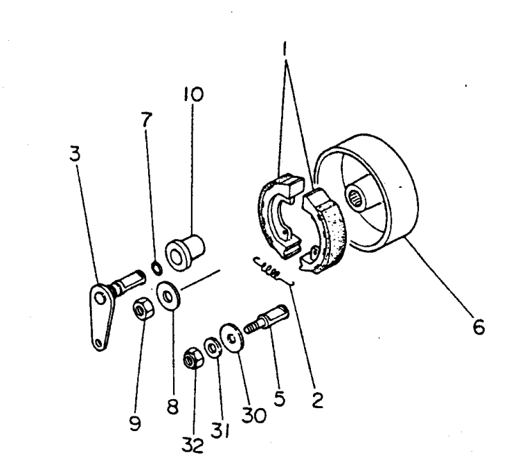

Rear brakes are in Figure section 10. So, all of the item numbers will be prefixed with the number 10.
So, 10-1 are the brake shoes.

I seen the Red/Grn parts on the 1500 decades ago was crazy. Just came up the value of this site! This could be interesting but I think your get it straightened out. Only brakes thank goodness!! It looks like I can find pretty much everything on the Brakes Axle and Rear end. The Axel collar Red 1500 Fredricks AC-4150 Org.# (194150-34360) Grn. 1500 Axel collar Fredricks AC-1500 Org. (194190-34170) No doubt a difference?
