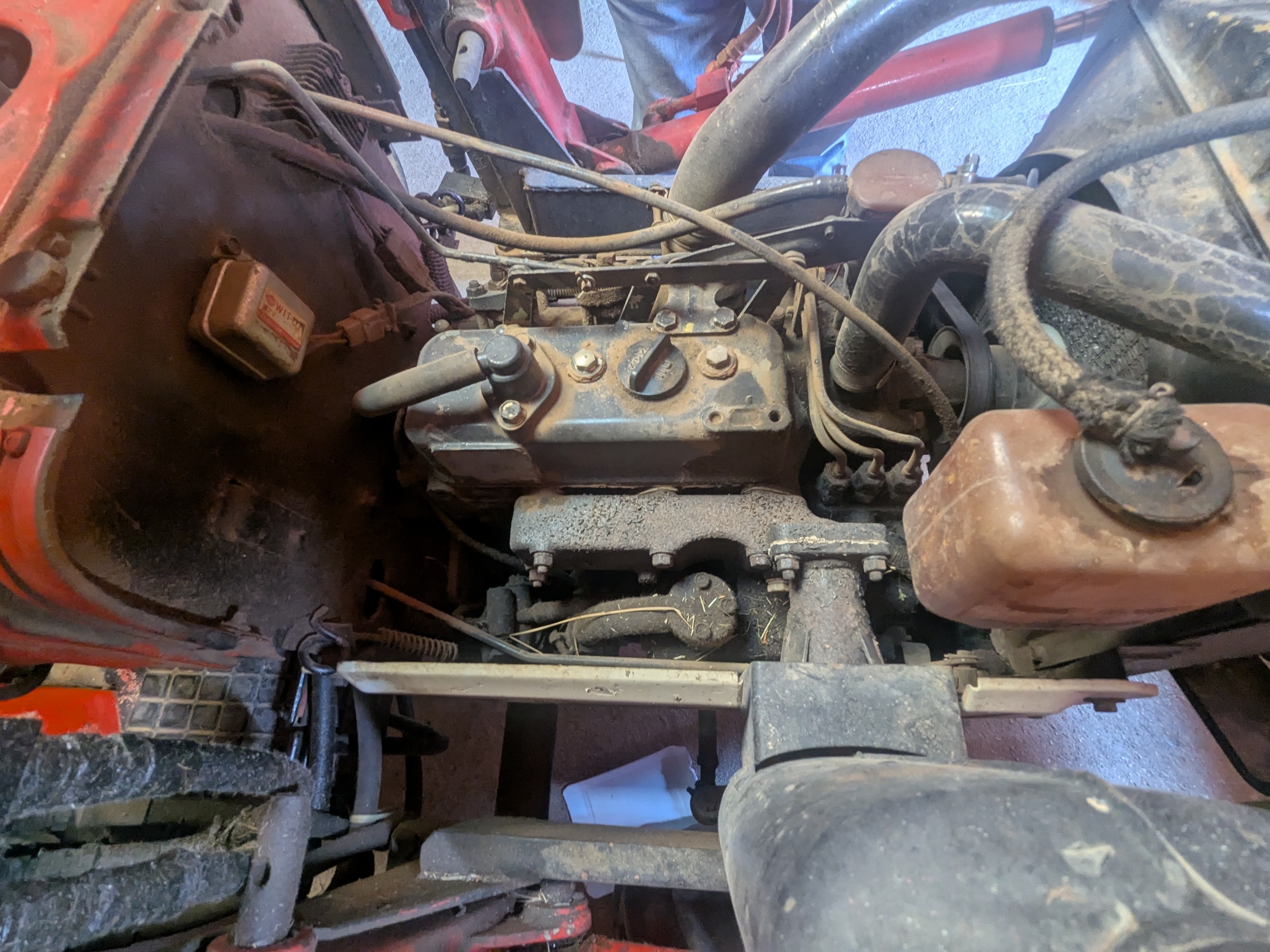

Is it a power shift or geared transmission?
This weekend I'll take photos of everything and upload them to clear up any doubts. I can't tell you if it's powershift or geared. My mechanical knowledge is very basic.
   / Oil leaking from brake dust cover #23
A photo of the engine plate / tractor identification plate would help.
Is there a possibility that the equipment might be different in Europe vs the US?
All the best,
Peter
   / Oil leaking from brake dust cover #24
We need the engine ID plate. This will tell what you really have.
I'm very suspicious of the model ending in DT. The D means 4WD and the T turbo. There are no turbos on models less in the YM series of a YM2500.
I've seen models ending in A, B, D, F, M, R, S, T and Z.

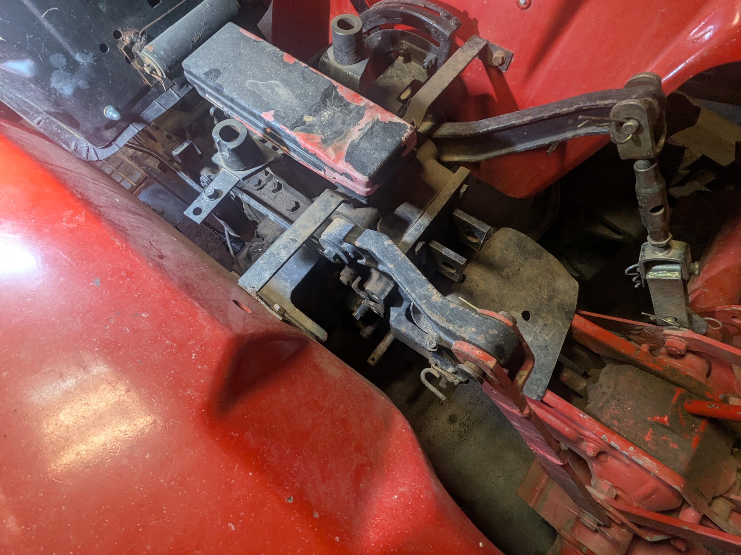

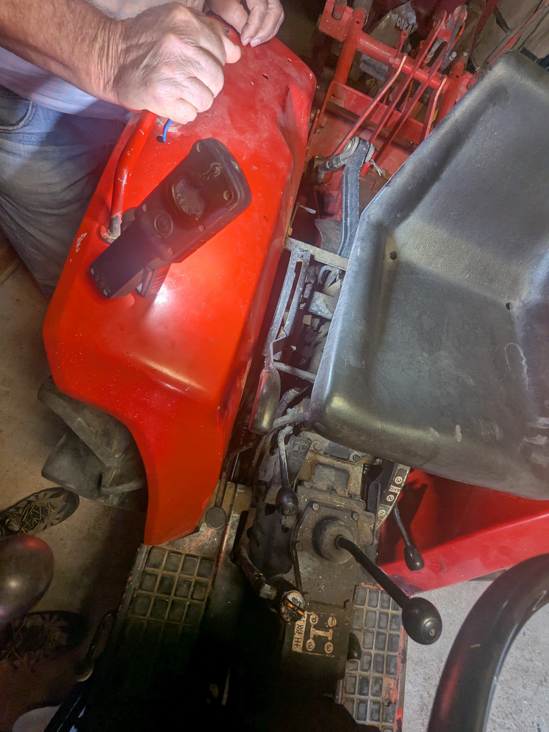

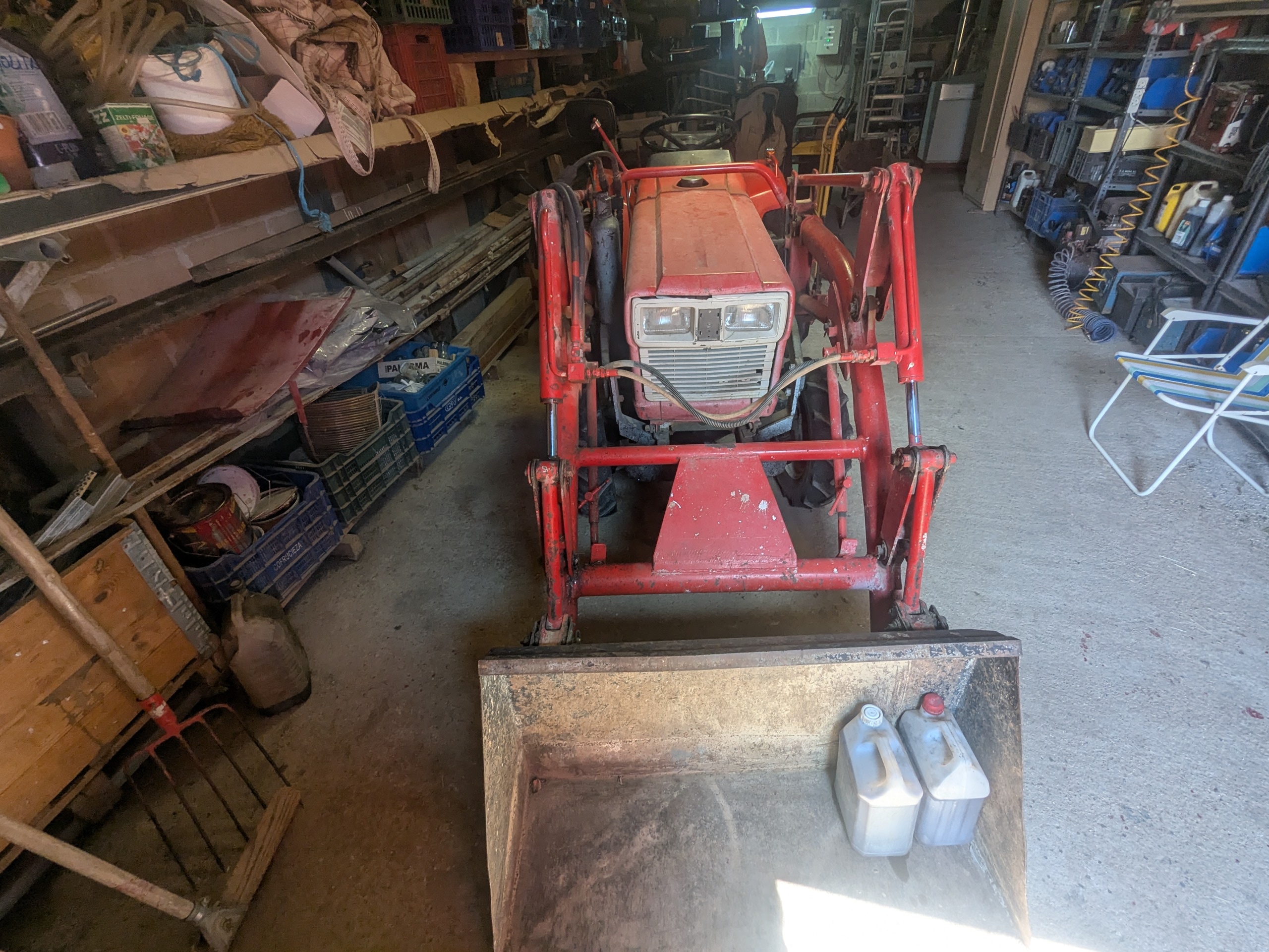

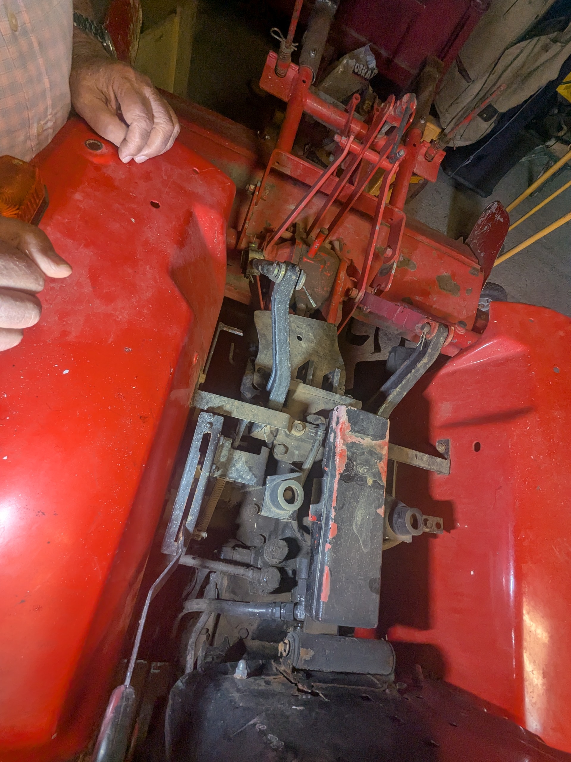

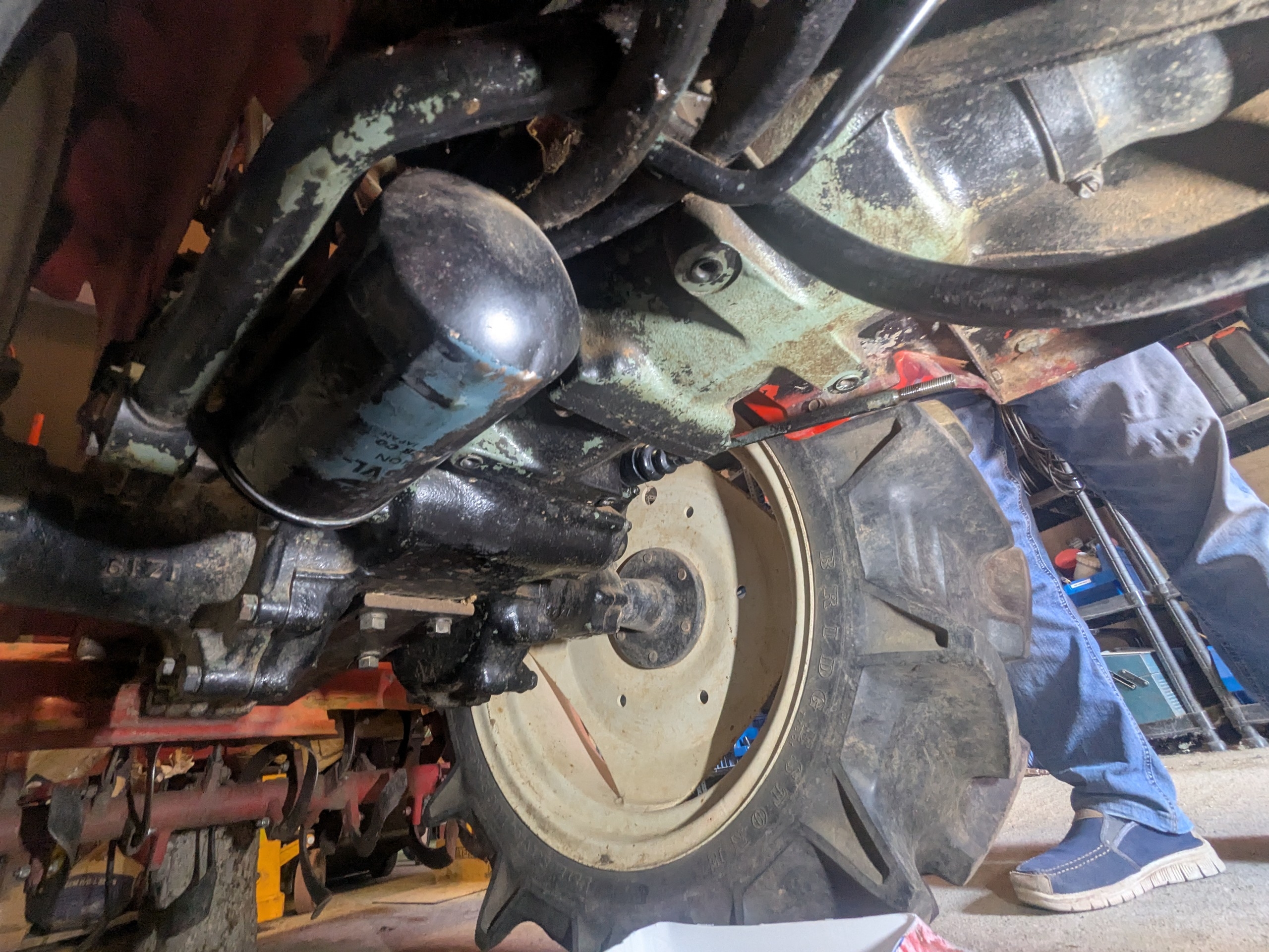

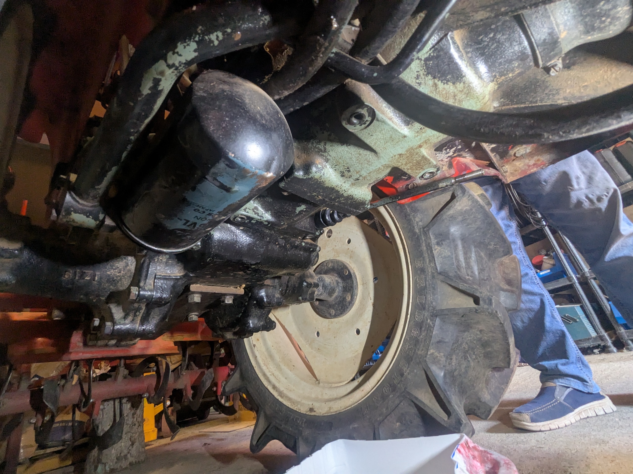

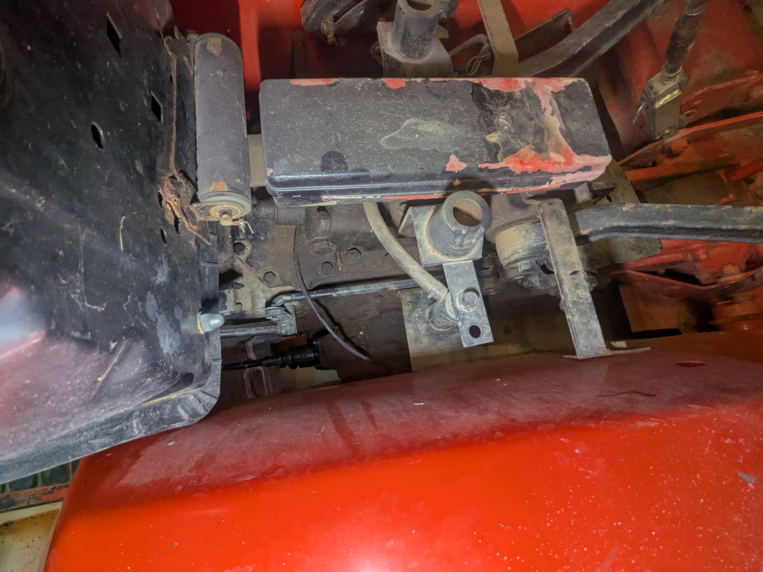

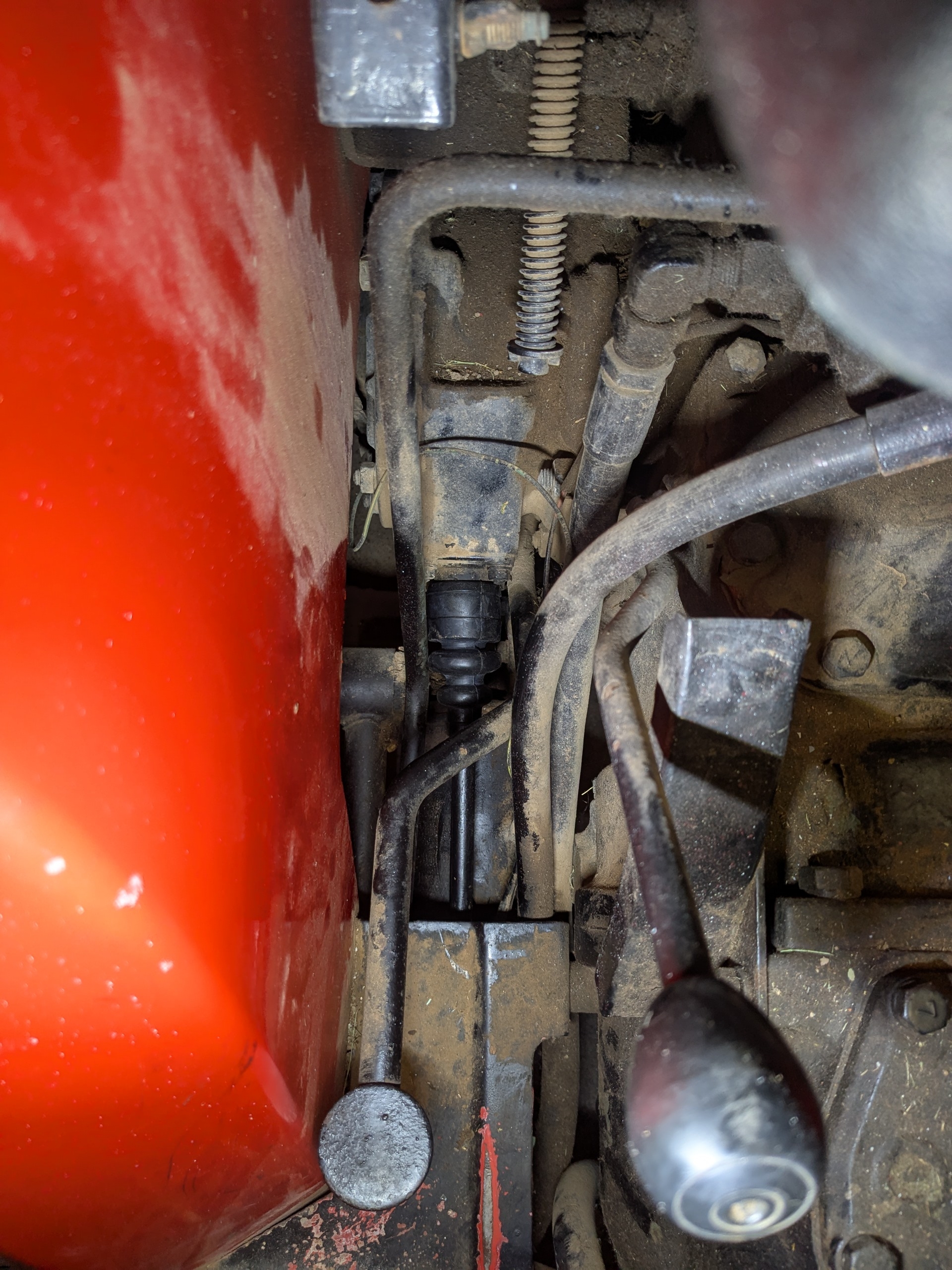

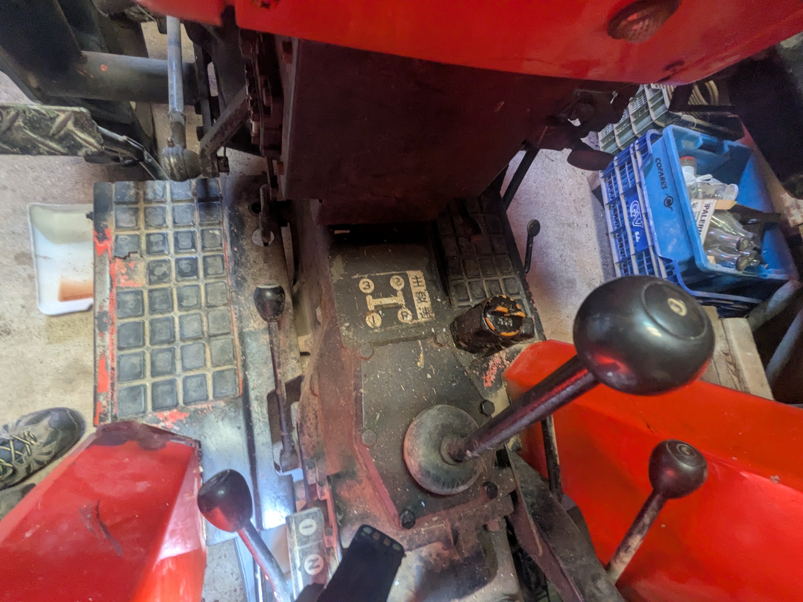

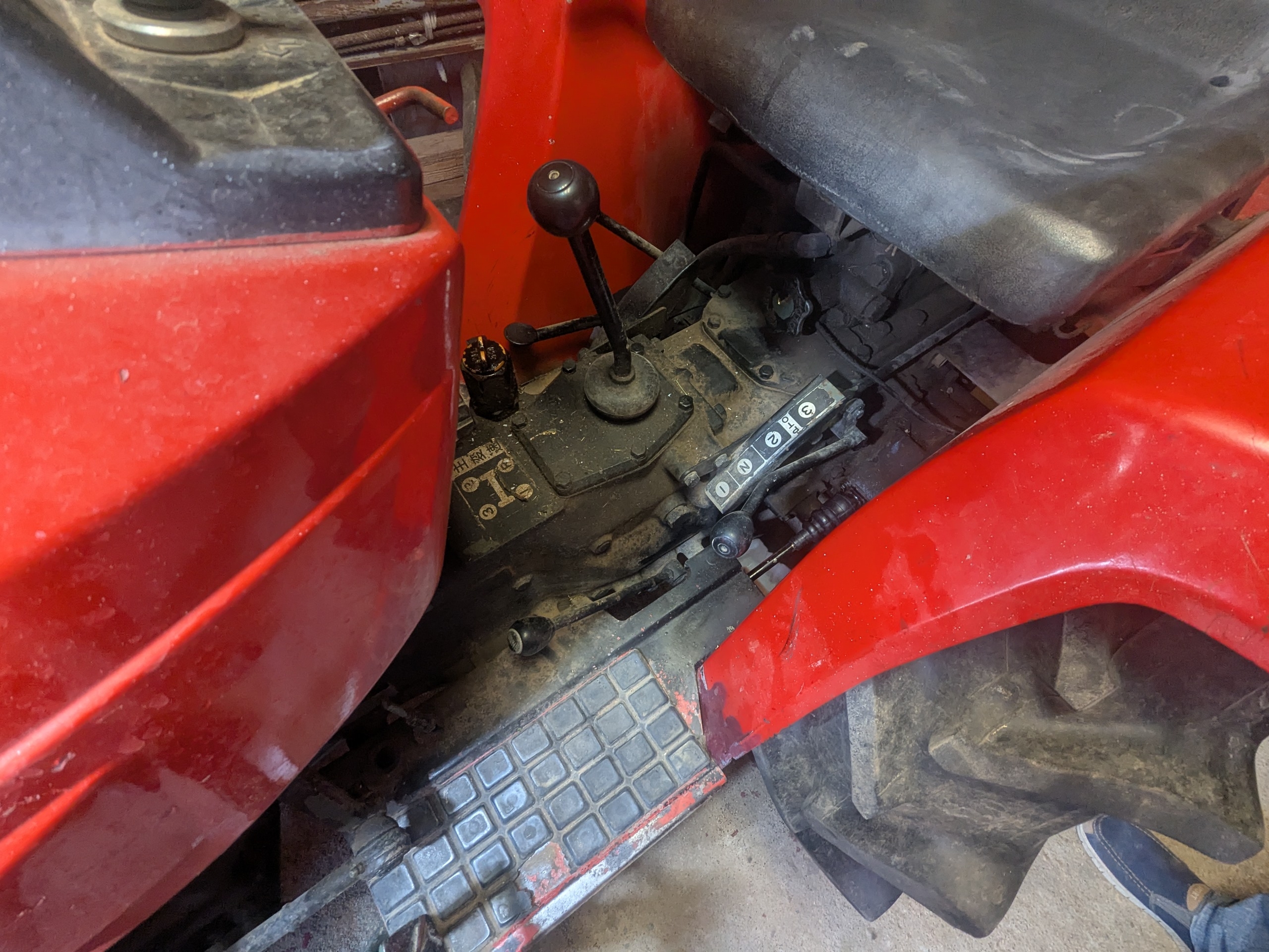

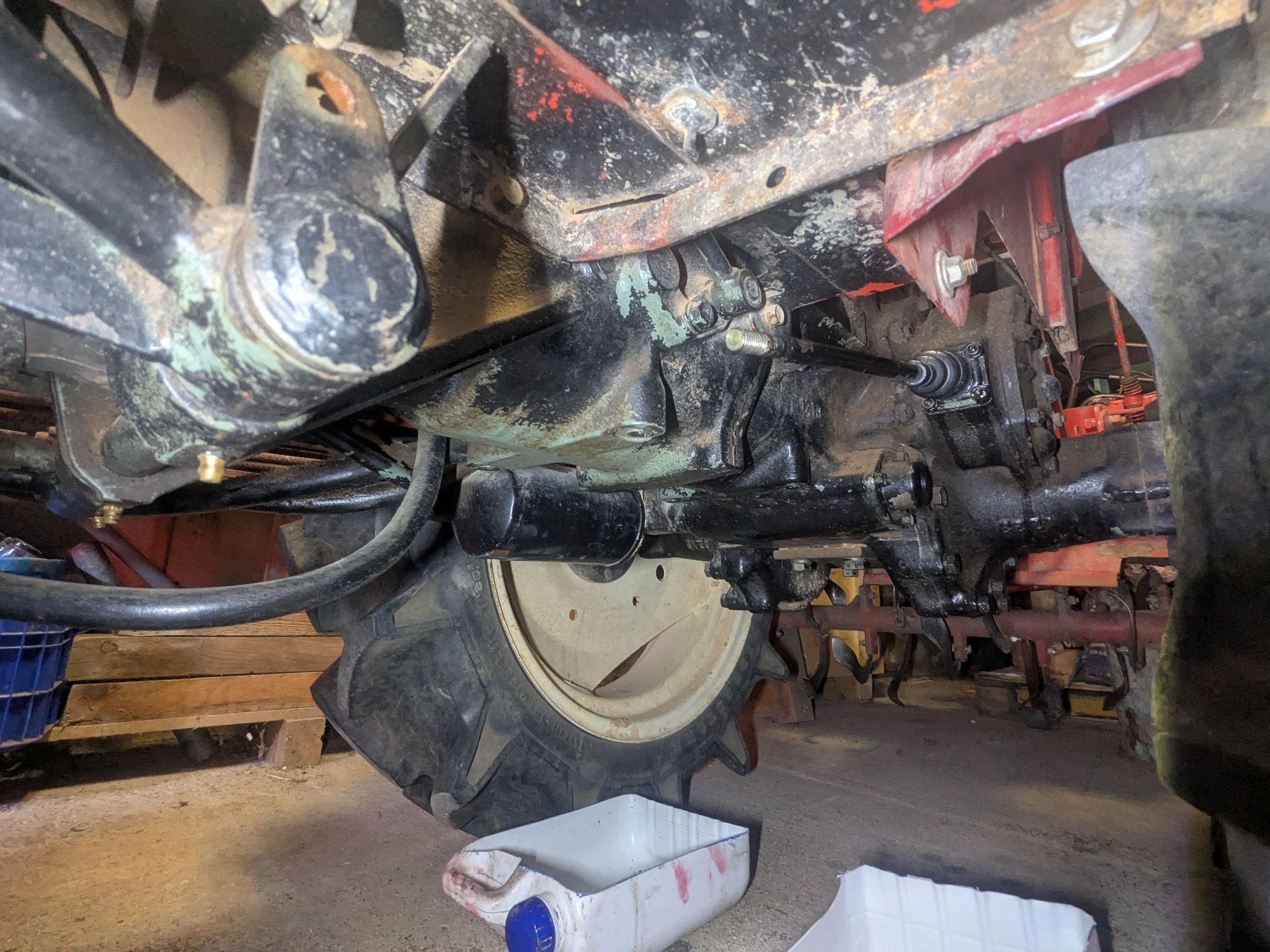

these are the photos

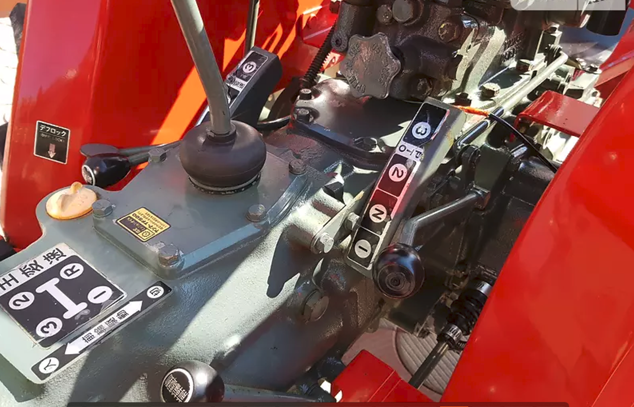

   / Oil leaking from brake dust cover #27

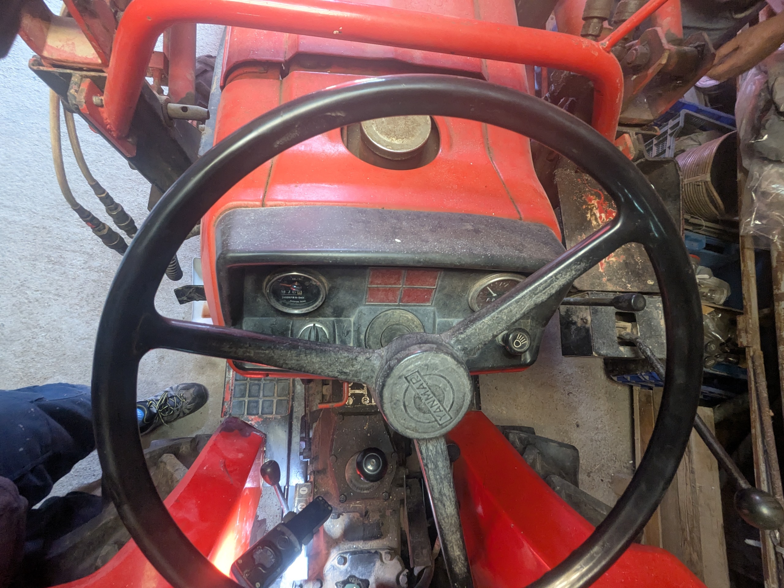

I am thinking you have a1602D.
Agree.
YM1610 has PowerShift. The floor shifter has 3 speeds. (No-clutch shifting).
That photo shows a shifter with 4 speeds. (Manual transmission).
Both have another shifter on the side to choose a range.

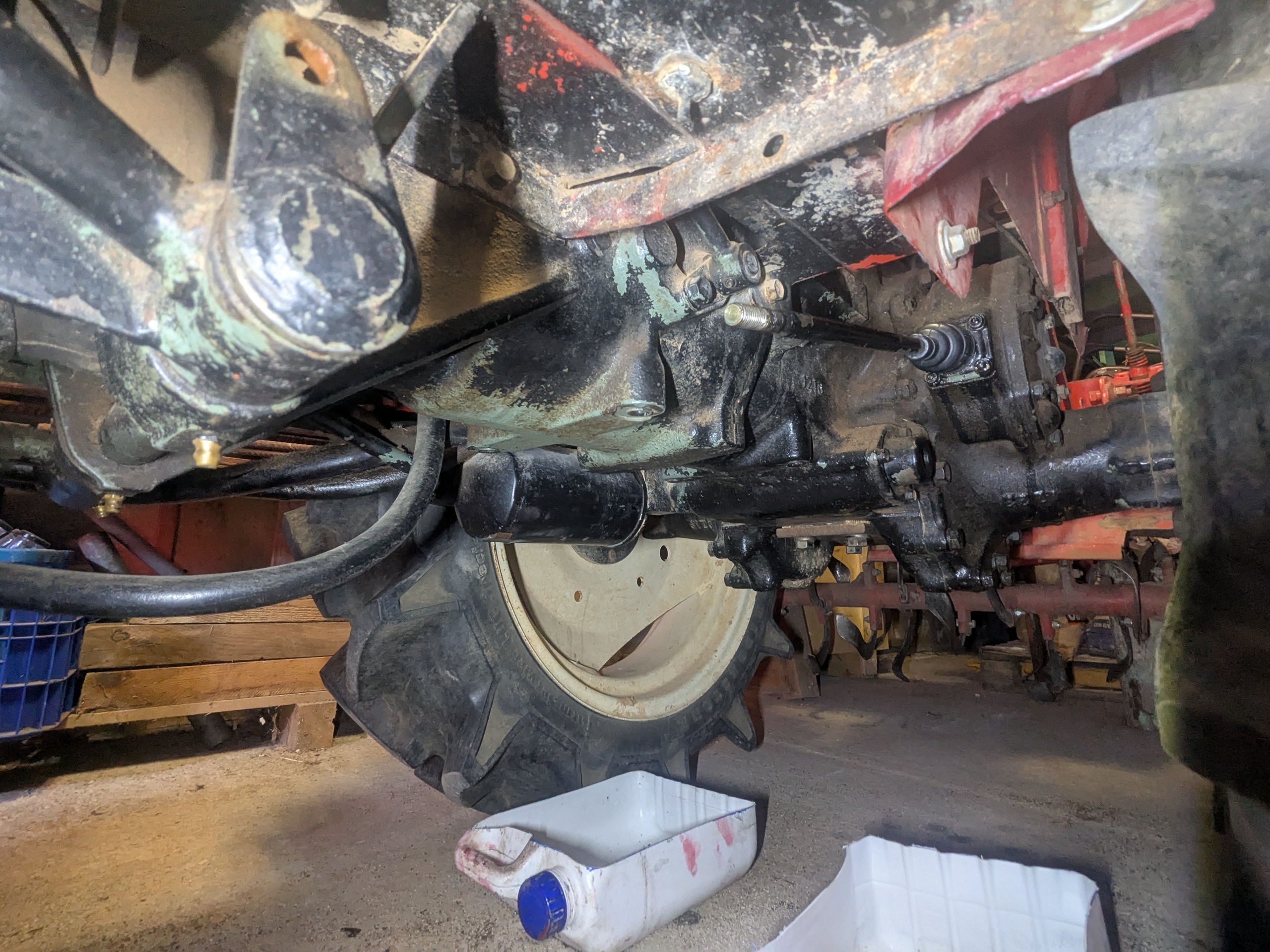

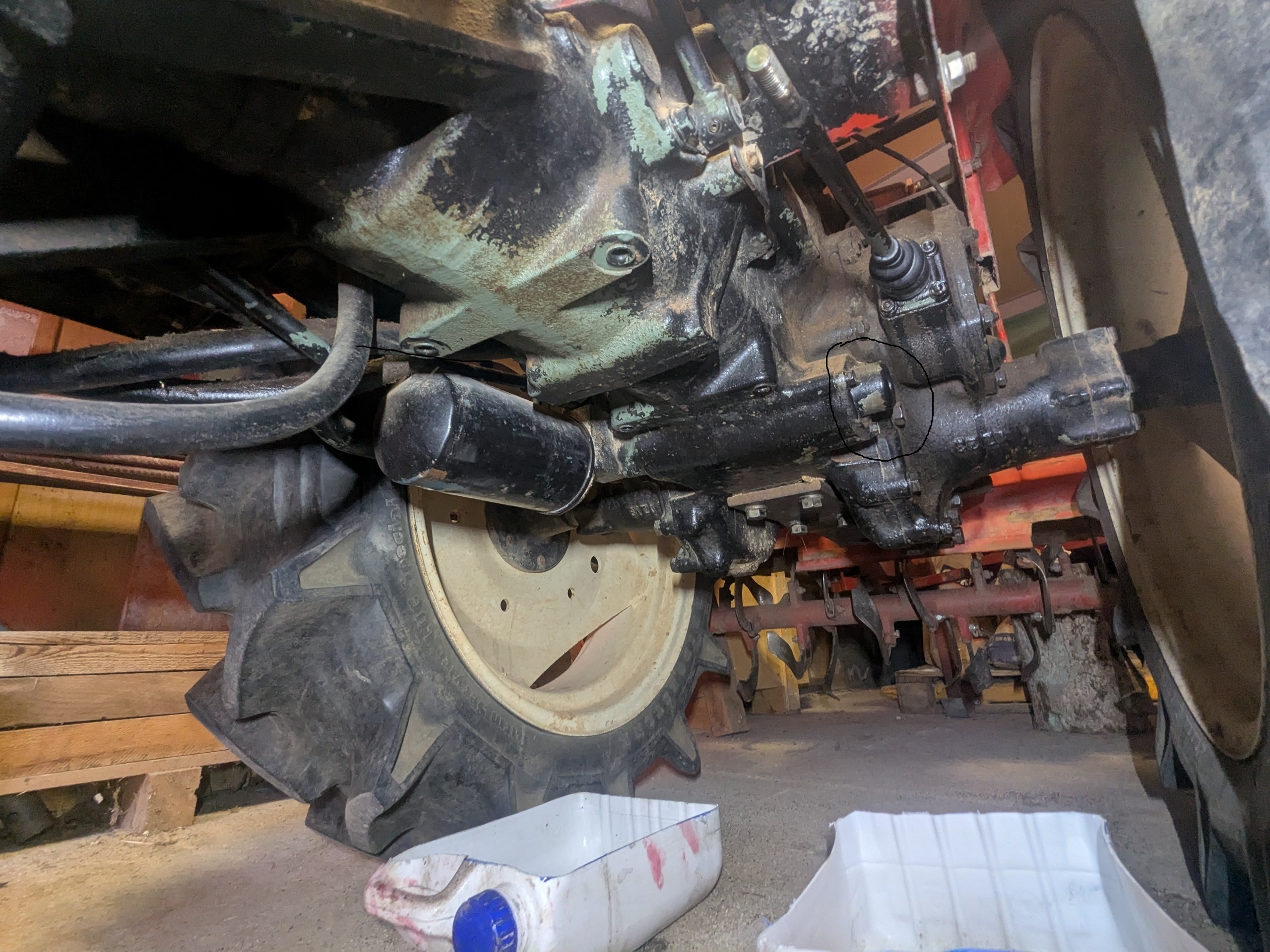

Okay, so what procedure should I follow to refill the oil?
What oil should I use to refill it?
Should I change the filter in the photo?
Should I add some kind of detergent oil first to remove impurities before adding the final oil?
What kind of oil would that be?
   / Oil leaking from brake dust cover #29

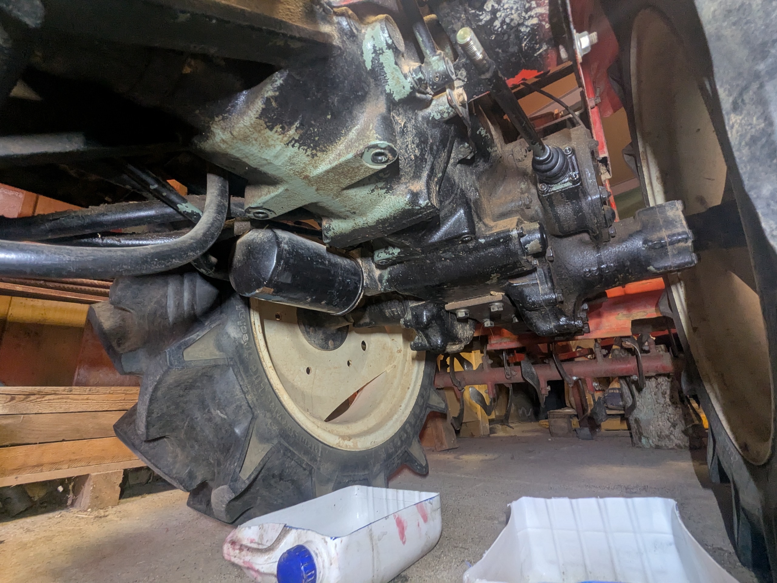

What condition was the fluid in? Any idea about last fluid/filter change? If not then yes, change both.

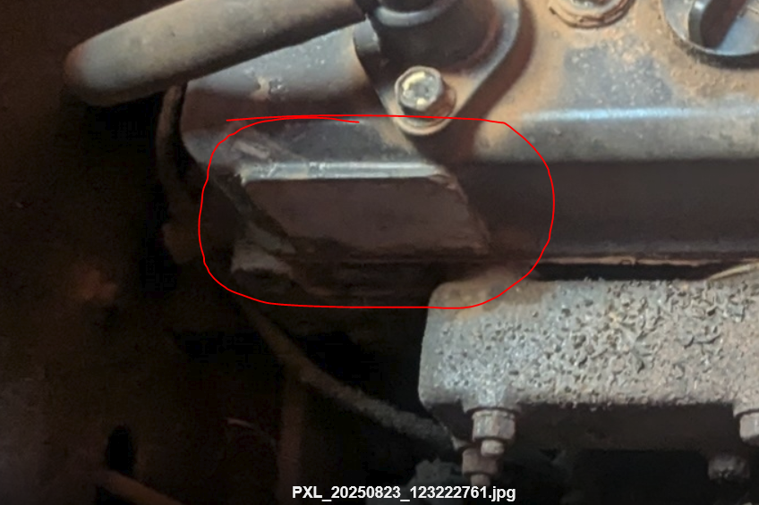

I do not have access to a 1602 parts manual but here is what I think. I circled what I believe might be the flange that covers your internal suction screen. That screen would need to be cleaned. If no knowledge of last screw on filter change then it likely should be changed. No idea what condition your used fluid was in so I can't really advise a flushing. If everything was pretty clean looking I probably wouldn't do any flushing. A universal transmission/hydraulic fluid is recommended. No idea what you have access to in Spain, maybe Maverick will help you with that.

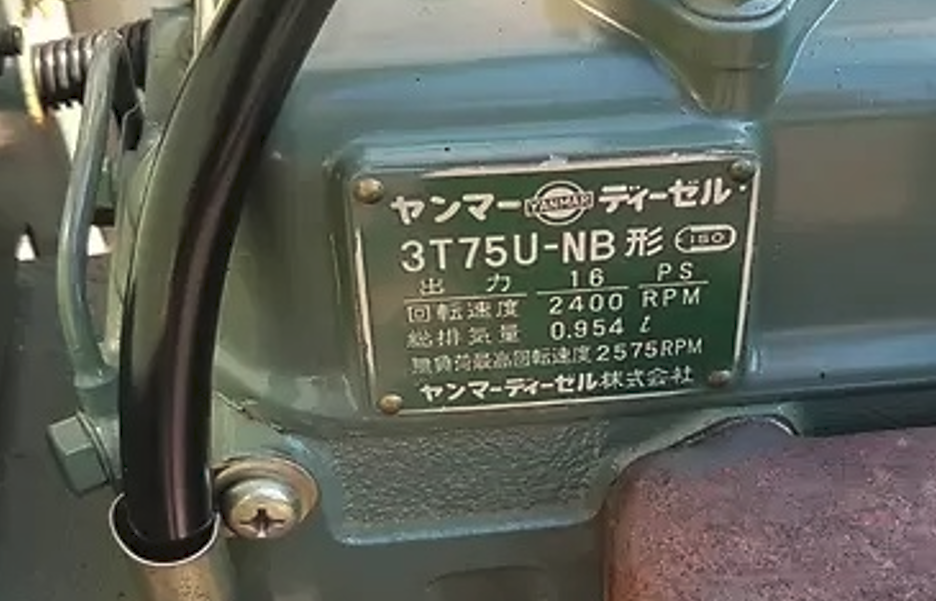

OK, after looking at all the photos, this machine is mis-marked.
This a VN imported machine.
The engine ID plate is exactly the same as a YM1602D.
Your image,
A Fredricks restored YM1602D, like @winston1 pointed out,
Your layout of controls by the seat 100% match a YM1602, not a YM1610 nor a YM1601.
Your image,
