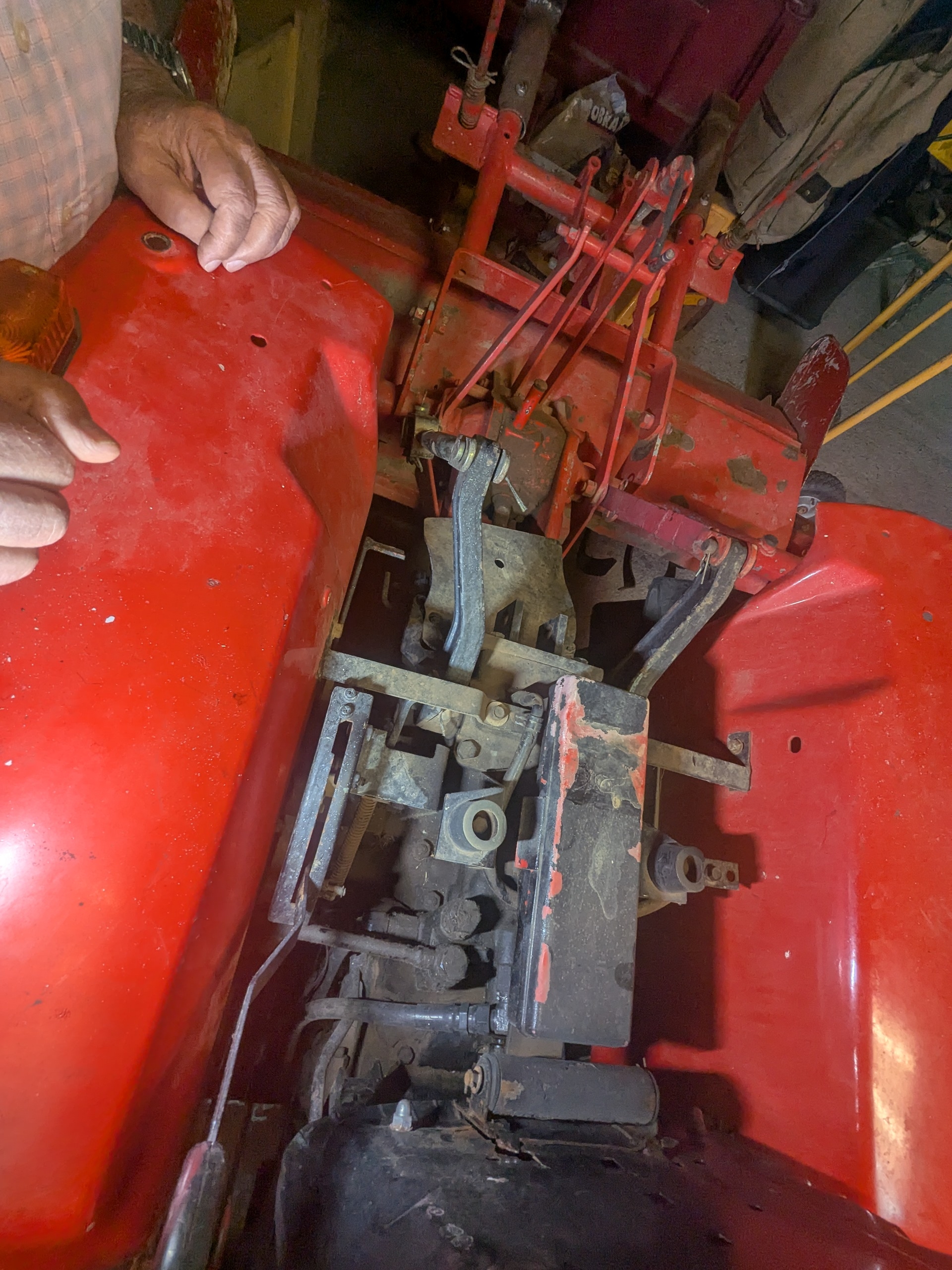

these are the photos

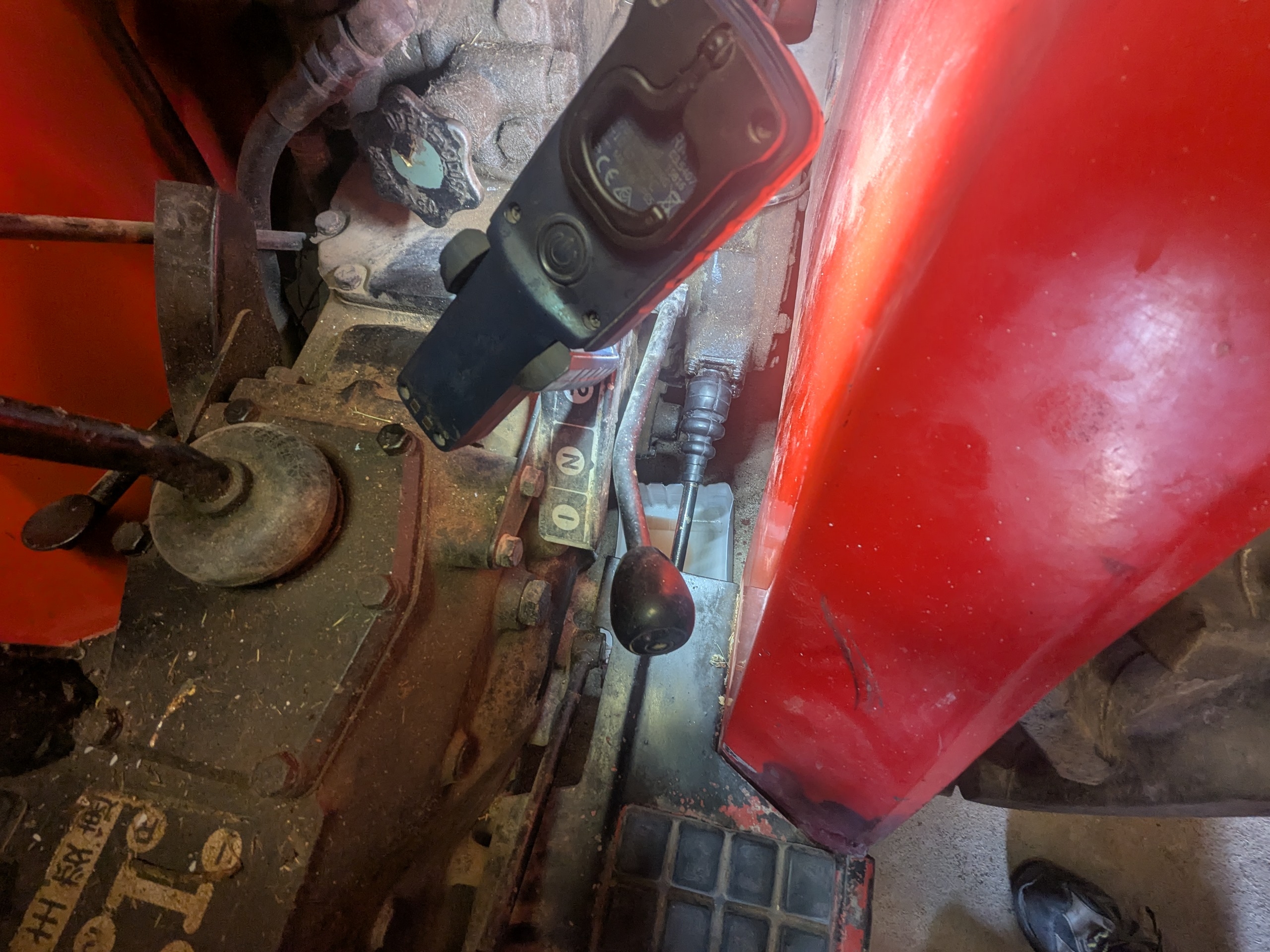

   / Oil leaking from brake dust cover #27
I am thinking you have a1602D.
Agree.
YM1610 has PowerShift. The floor shifter has 3 speeds. (No-clutch shifting).
That photo shows a shifter with 4 speeds. (Manual transmission).
Both have another shifter on the side to choose a range.

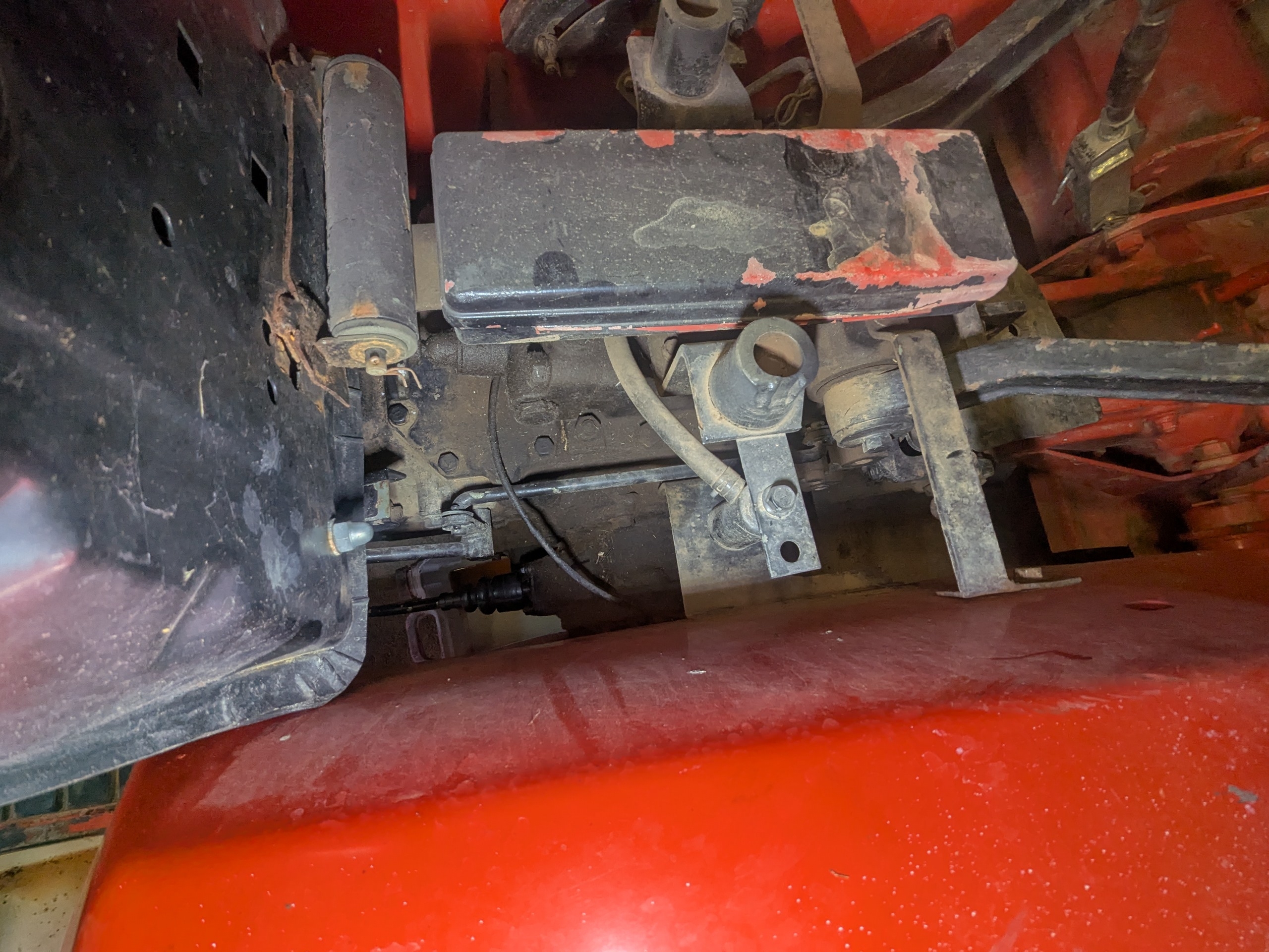

I do not have access to a 1602 parts manual but here is what I think. I circled what I believe might be the flange that covers your internal suction screen. That screen would need to be cleaned. If no knowledge of last screw on filter change then it likely should be changed. No idea what condition your used fluid was in so I can't really advise a flushing. If everything was pretty clean looking I probably wouldn't do any flushing. A universal transmission/hydraulic fluid is recommended. No idea what you have access to in Spain, maybe Maverick will help you with that.

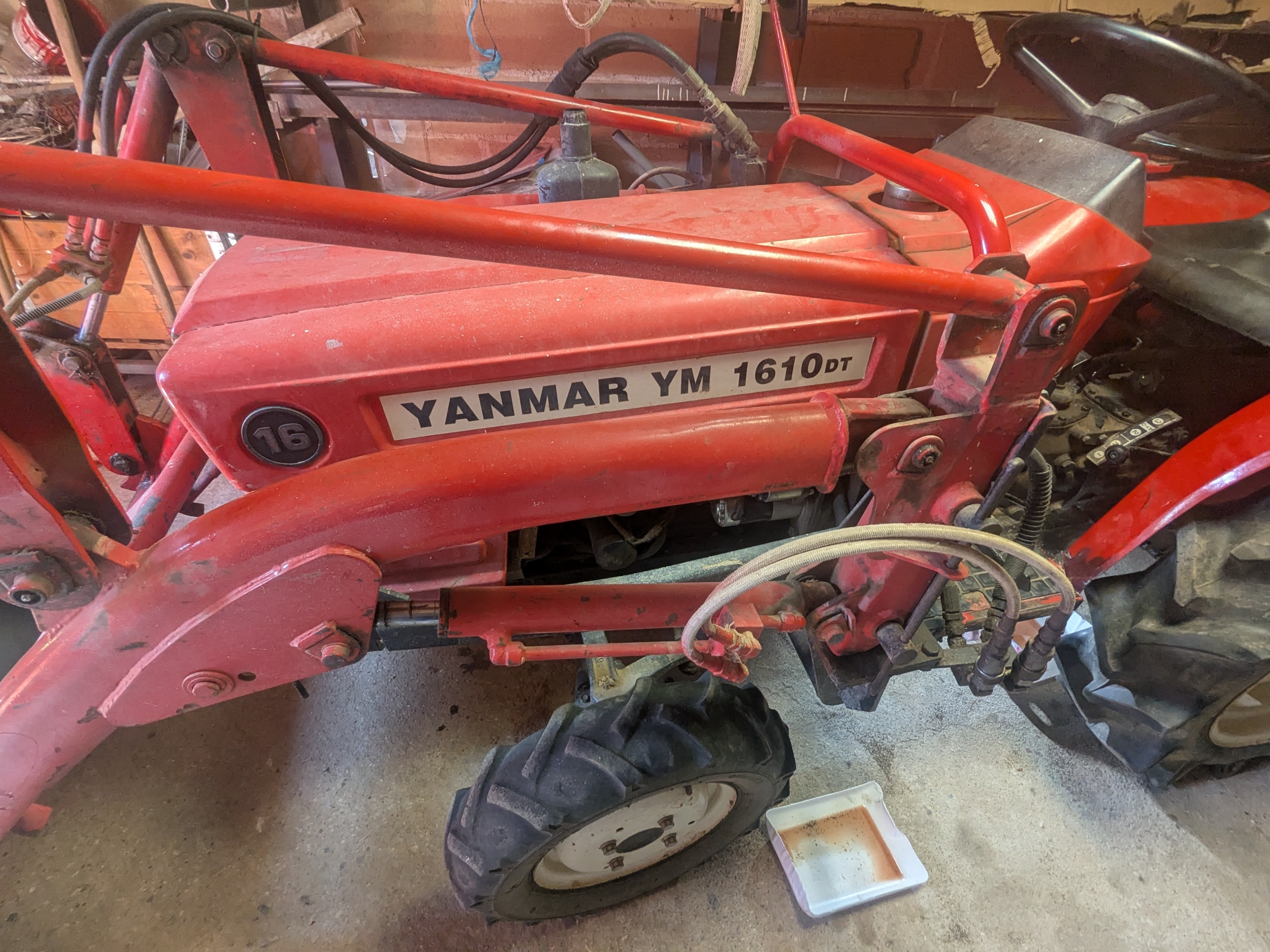

OK, after looking at all the photos, this machine is mis-marked.
This a VN imported machine.
The engine ID plate is exactly the same as a YM1602D.
Your image,
A Fredricks restored YM1602D, like @winston1 pointed out,
Your layout of controls by the seat 100% match a YM1602, not a YM1610 nor a YM1601.
Your image,

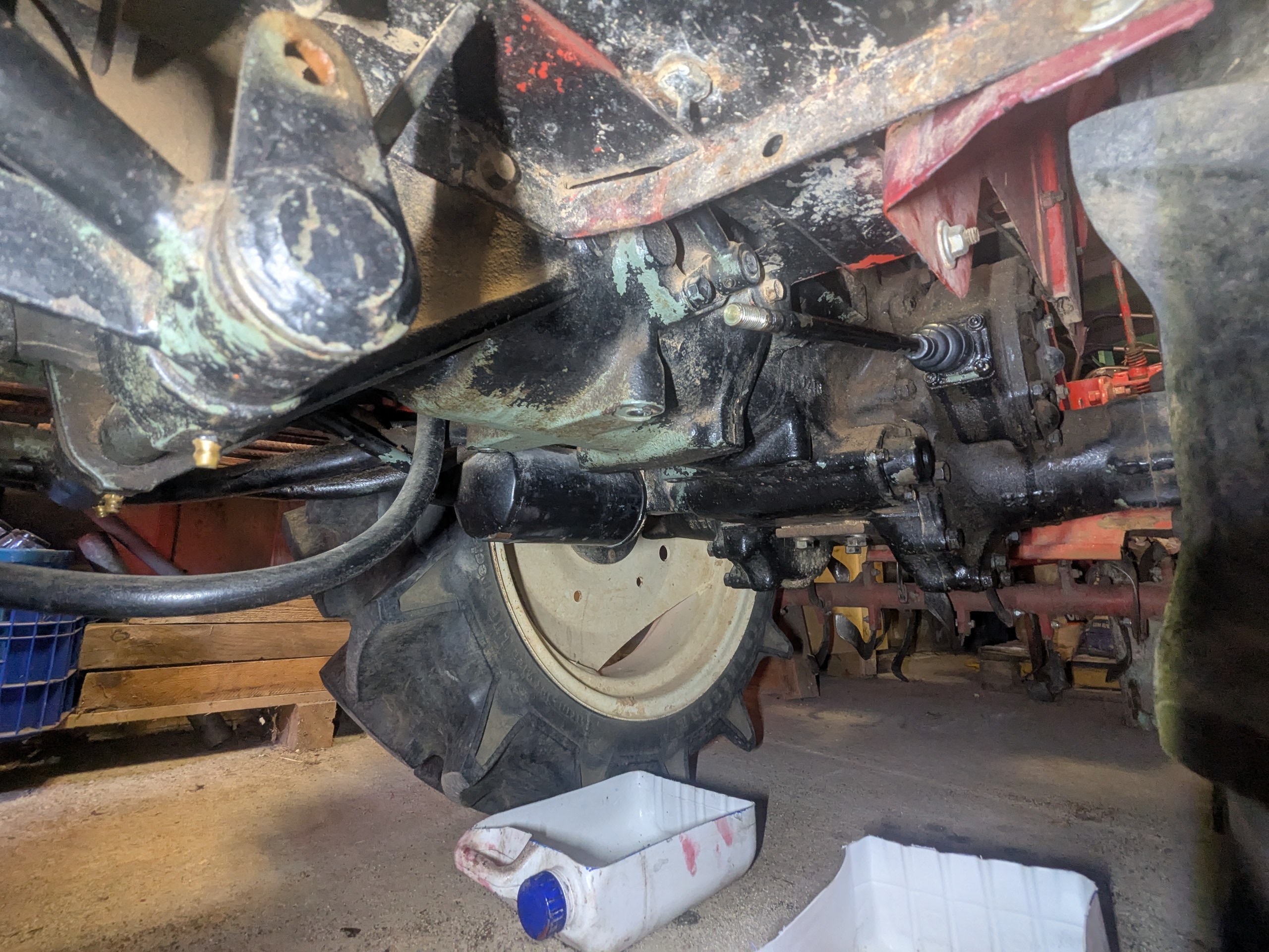

I removed the filter you mentioned and cleaned it.

I also removed that filter thinking it had the reference number written on it, but it's completely painted over, so I can't see the reference number.
Can you tell me the filter reference number?
What system do these two filters I removed correspond to?
   / Oil leaking from brake dust cover #35
the strainer and spin on or both for the transmission/hydraulics. This is the filter I used on my old 2002D. I have no way of knowing whether it would fit your 1602D or not. I can only suspect it would. If you could compare the part # for the 1602 and 2002 you could know for sure. Just make sure you get a filter with a good flow range.
