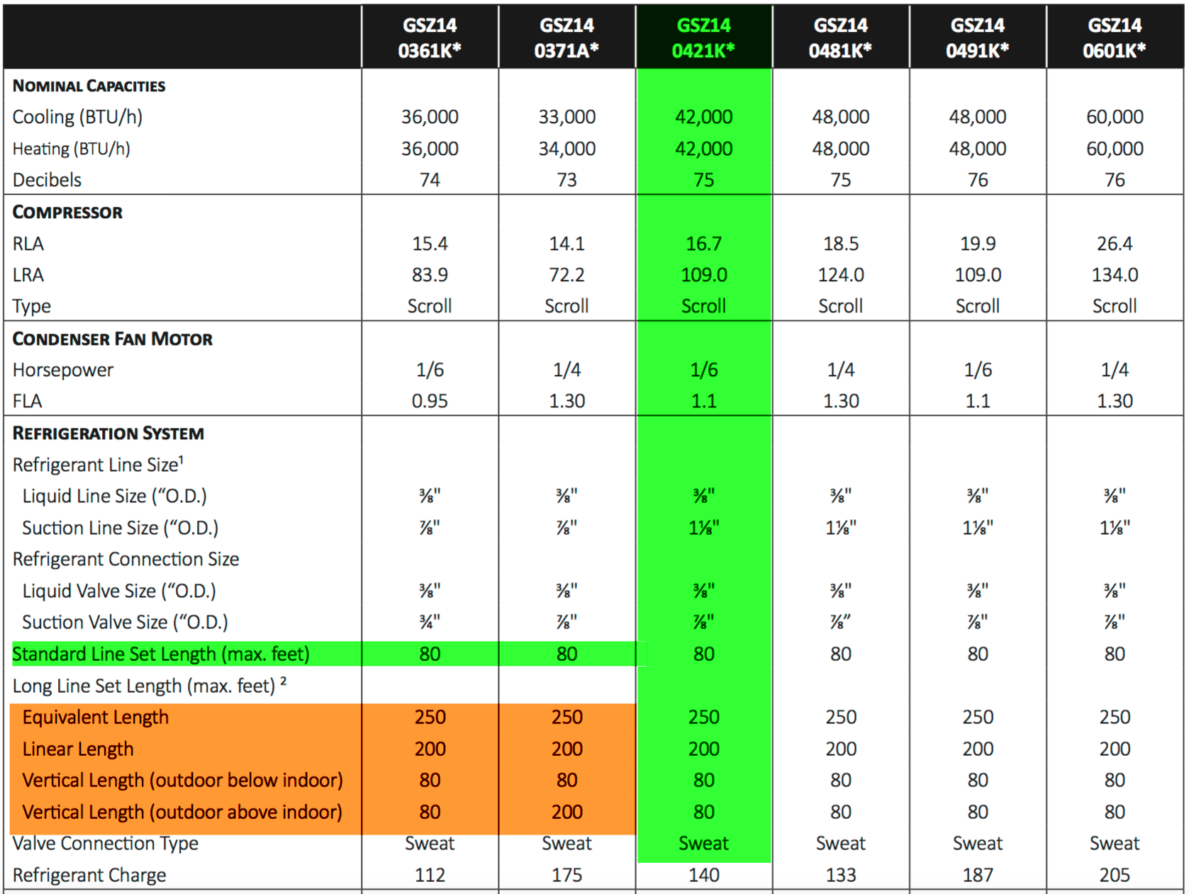

Our 13-14 year old Goodman HVAC system has a leak. The HVAC guy was out today, and since our unit has the older refrigerant, we need to have a new condenser and evaporator. <sigh>
Long story short, the condenser unit is a good 65 foot run to the evaporator which is not efficient but there is not much we can do about it. Will adding more insulation around the refrigerant line help increase the system efficiency?
Thanks,
Dan
The only question I have is who told you 65' decreases the efficiency?
1 - 65' is a drop in the bucket per system capacity loss
2 - Don't know of anyone who can give you the AHRI efficiency rating of a 65' line set run.
3 - My one line set is 76', with a 24' vertical rise, been in for the last 8 years. No complaints on my end.
You're in NC. Code for line sets in NC is 1/2" insulation on the suction line, which is more than adequate IMO.
FYI, I'd charge $6,300 for a base 3.5 ton 14 SEER heat pump (new line set, pad, drain pan, whip, disconnect, primary and secondary float with with new pump), which would include a 10 year factory backed 10 year labor plan on the equipment (any ductwork modifications, pricing would go up). So, is $5,800 high? For the info you've given, I'd say no IM professionl opinion:laughing:
