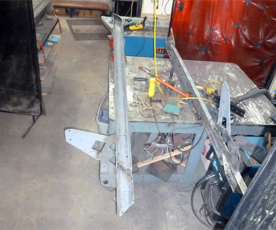

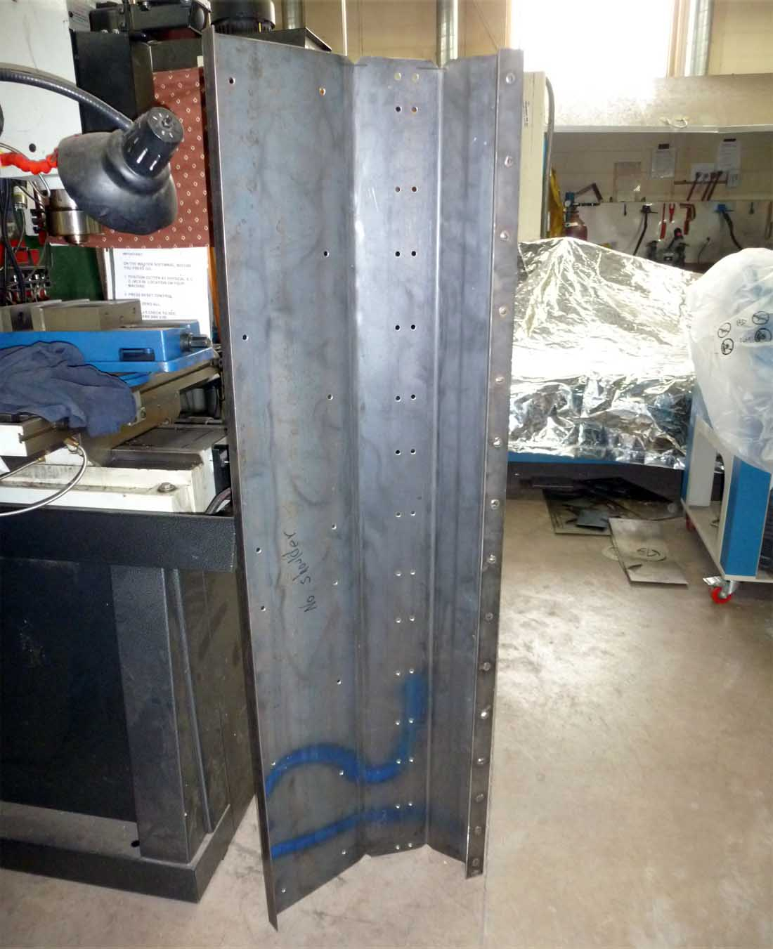

As promised, I was in school today and some work was done on this implement.
The cutting frames are made from 2x3x1/4 angles and will have cutting teeth mounted on them.
This is the mian frame which was painted and ready to go out the door. Lots of plastic needs to be mounted which will take time before a test run can be made..
Late today, this frame was moved into the paint booth. This holds the harrow teeth and might be done :oops:, nonetheless, it will get painted on Tuesday.

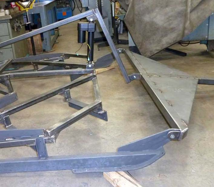

I've got the harrow frame and main frame in my work shop now to get plastic and various parts mounted. Might even get that portion tested today. No actuators involved. :)

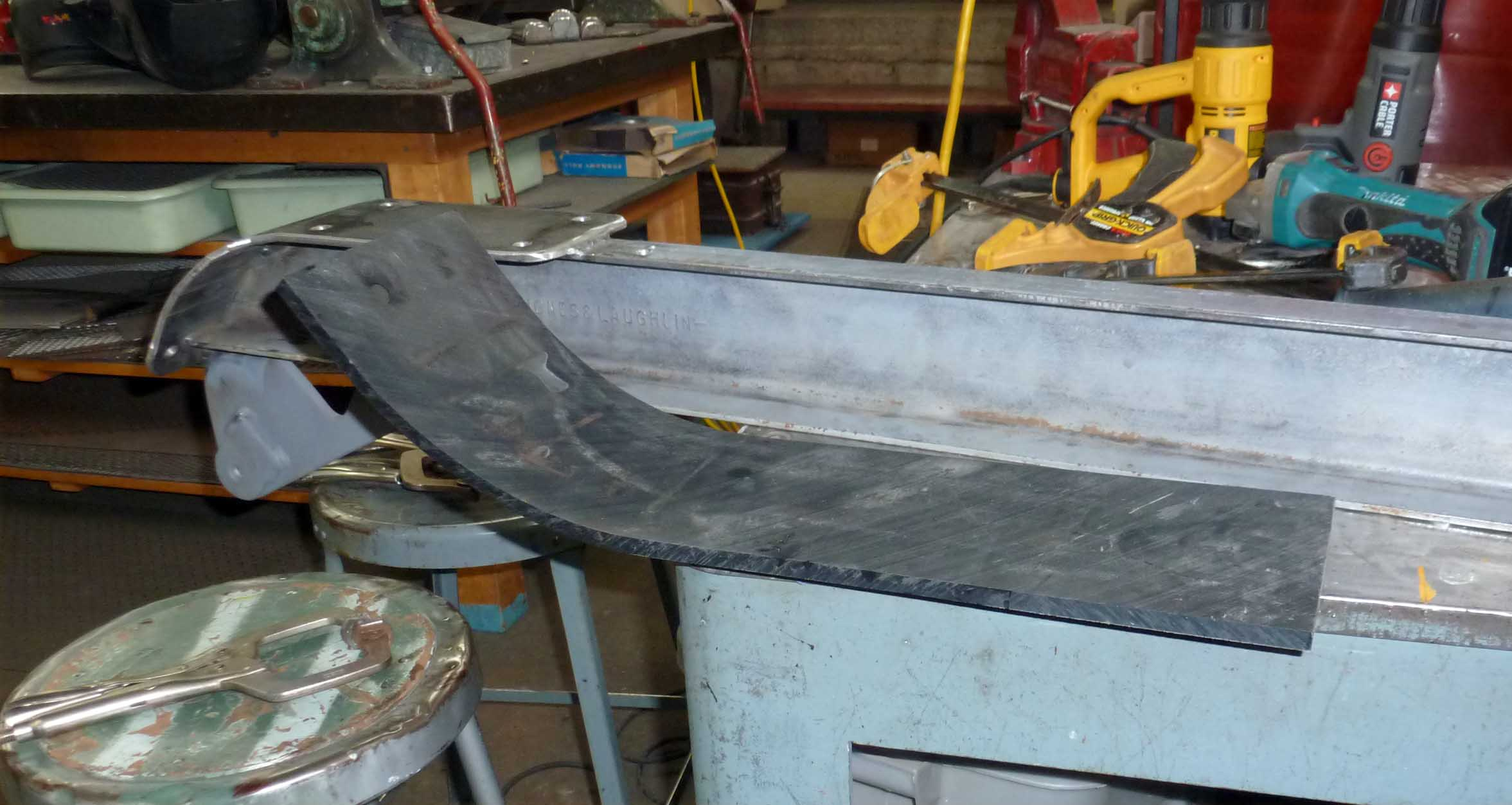

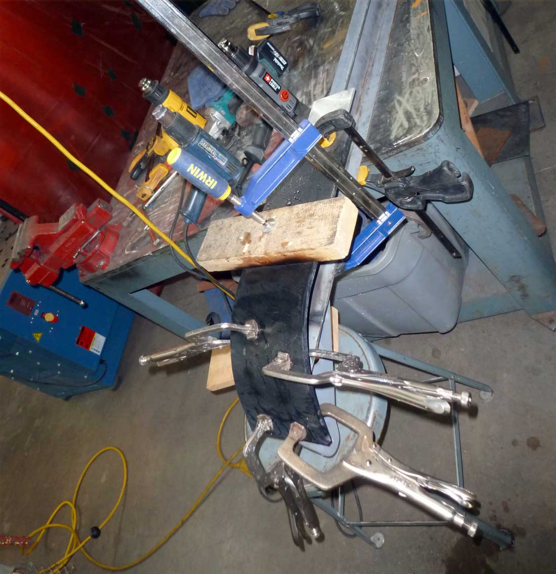

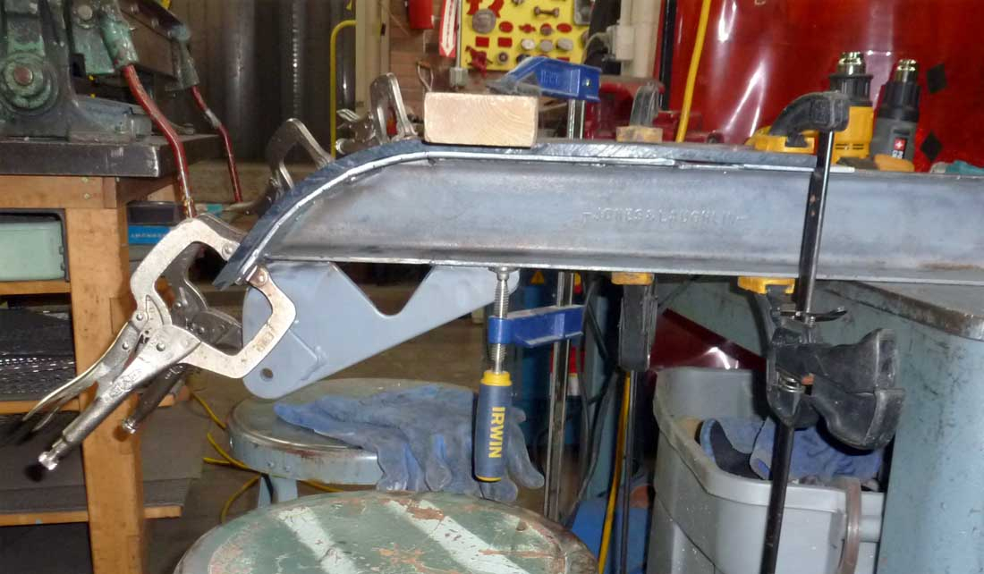

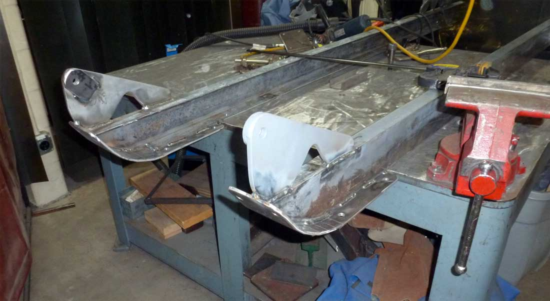

I moved into a shop at my work place and got the drag assembled enough to give it a test run Saturday morning. Its the harrow frame and teeth of course that will be tested..
Shoes covered with 3/8 HDPE.
Da frame and harrow teeth.
In this pic you can see the skags were installed.
