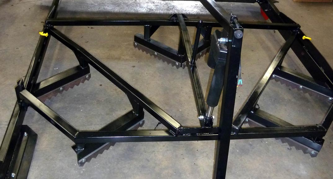

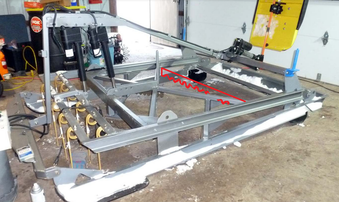

-snip- It seems to have good snow engaging points to rip up the hard pack and also the weight to make those points do what they are designed to do. Its hard to tell by the pictures, so correct me if I am wrong, but the only issue that I could see being a problem in these conditions is the snow engagement points are not/can not be adjusted to extend below the level of the skids.
All teeth including harrow ones, can be brought down well below the drags shoes, or the bottom of the frame. In the case of the harrow springs, they'll just bend backwards but they'll still be scratching the surface much. For the cutting teeth, if you keep pushing them down, the actuator will simply lift the drag frame right off the snow. You may have noted the tooth frame has a weight peg so I'd be adding bar-bell weights to it, if trying to cut into hard a surface. This does require HP to do and the reason I'd not purchase another work sled. This is not the 1st drag I've constructed so we've got much experience with scratching of hard snow. Hope that helps

This is how groomzila looks today. :LOL:
/ XC drag build #165
Very nice. Love the linear actuators.
/ XC drag build #166
You have a lot of experience building and using groomers, so my guess this one is where you want it.
That said, would adding a blade across the frame (about 2" higher than the front scarifiers) have some utility to spread the snow laterally and add some useful weight?
Again, that is a pretty slick. (y)

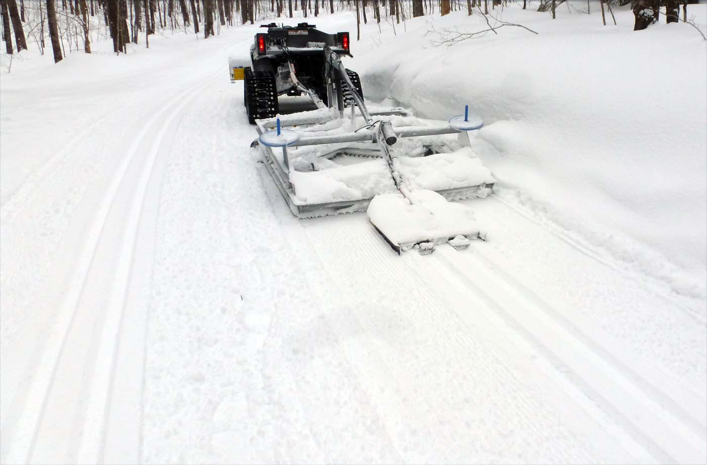

Any updates, or videos in use?
/ XC drag build
#171

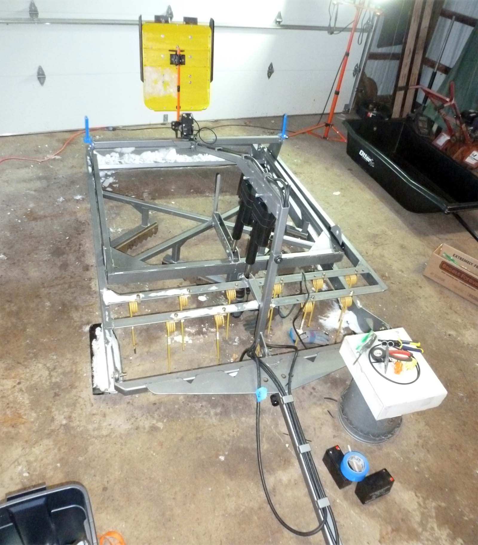

Well, it has gone into service but its not really done. Wings have not been added and a few other minor details uncompleted. I was out this am doing some modification to it in the field. Our grooming season is coming up on the end.
/ XC drag build #172
  • Polaris is healthy again?
  • Wings function/location?
  • What tweaks do you anticipate doing before next season?
Looks like it works well.

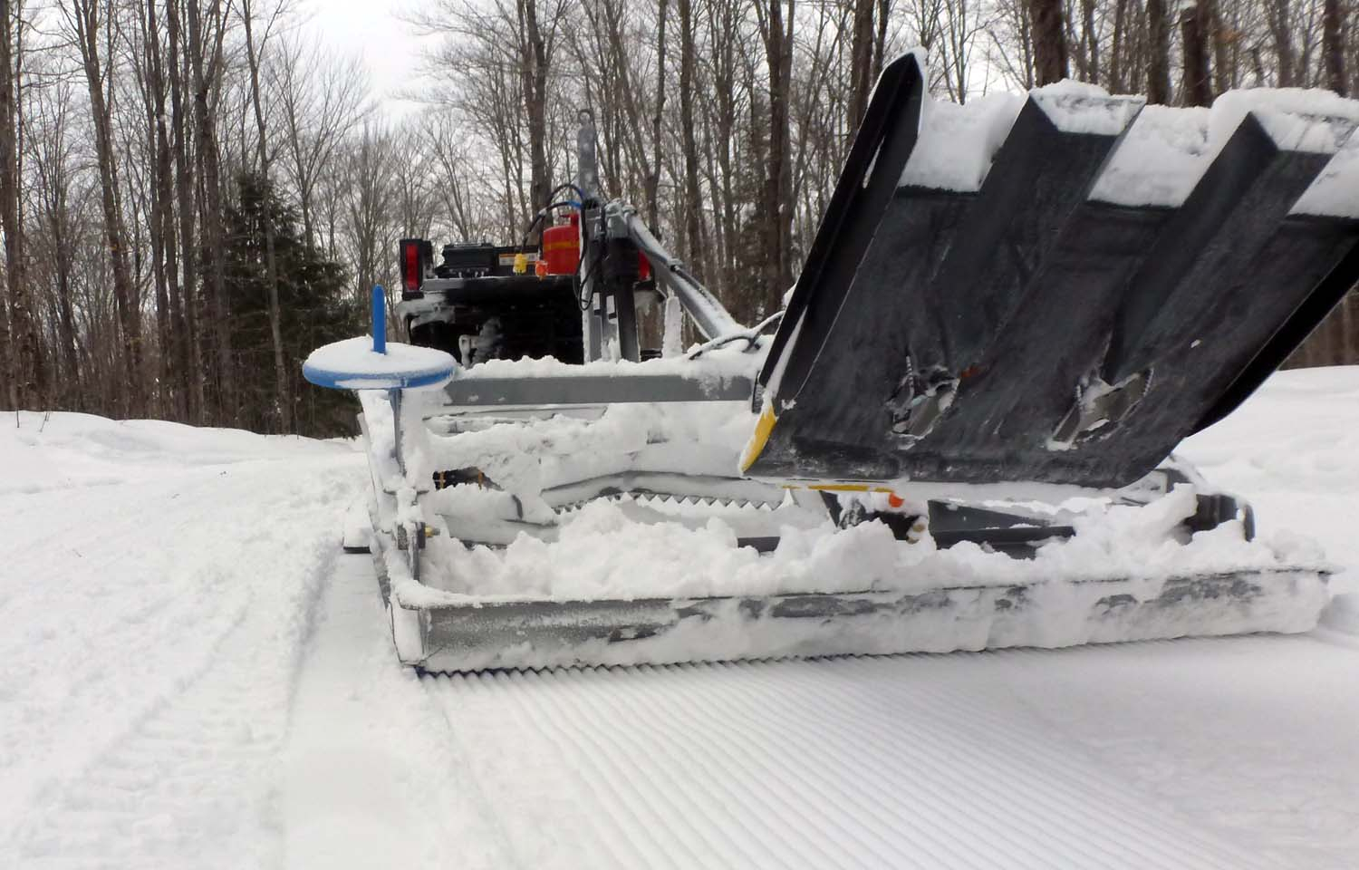

The Polaris still misses at times. We are still trying to master its cause. May be low battery when winch is used.
The wings are flexible have comb and weights on them. These make the edge of the trail more skiable. See pic below of what they look like. Its circled.
Build the 2nd one.

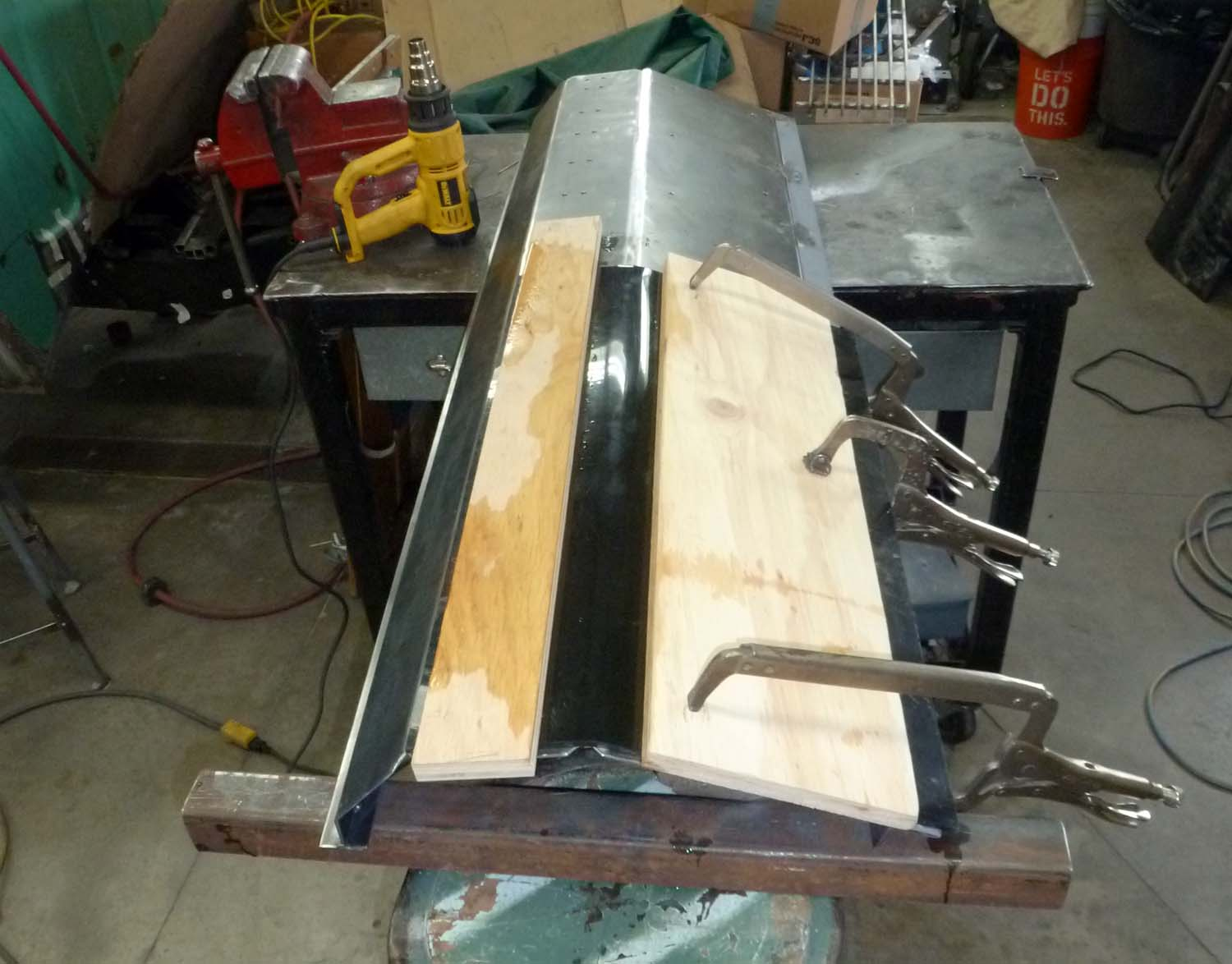

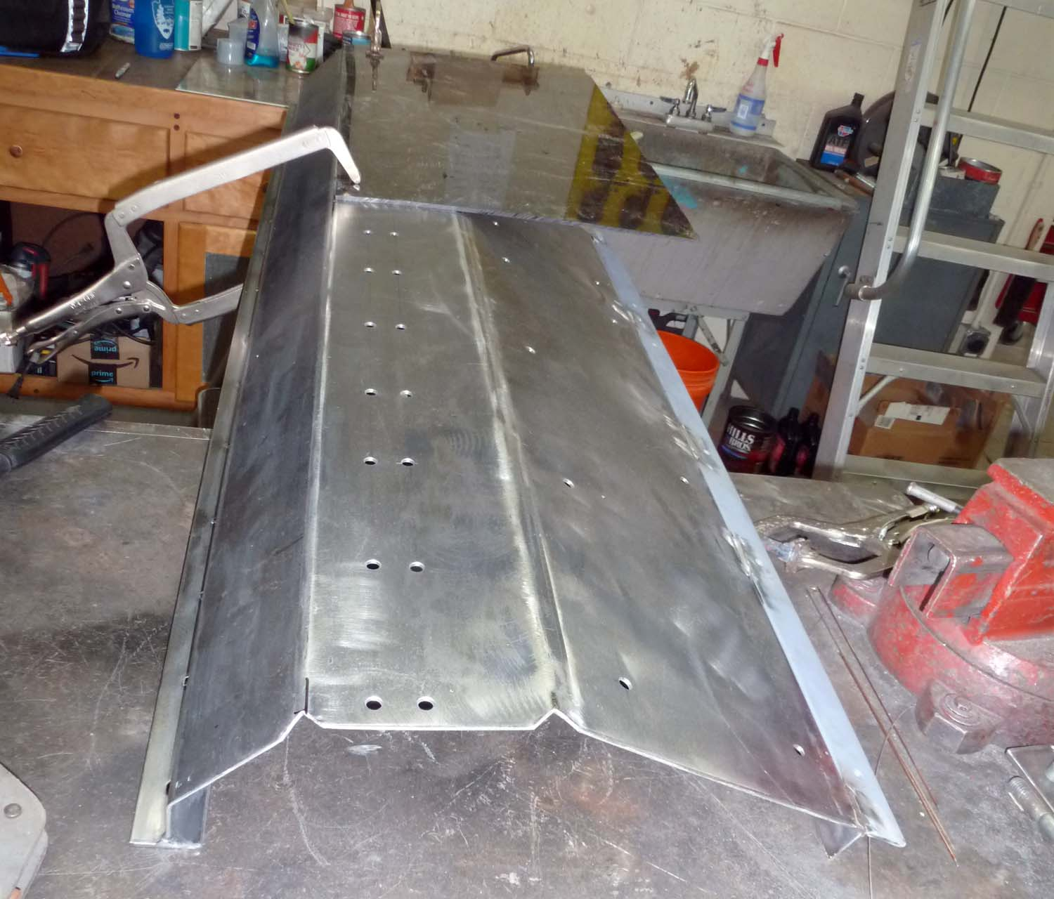

Did you heat it to bend it?
Looking at the holes in the plate, I assume you are going to use countersunk flat head screws/bolt to secure it to the plate.
/ XC drag build
#176
Yes Dennis. You could break it but I don't have a break that large and the radius is very large. I used three 1500 watt heat guns to get it warmed up.

Why put the plastic on the pan like that? I’d think the aluminum pan would slide just as easy? I suppose the plastic would help with damage from rocks etc
/ XC drag build
#178
Plastic has a much lower drag coefficiency than steel or aluminum. Friction with Aluminum is actually quite high. Plastic also has less tendency to stick and freeze to water and this is why most most implements today are built with HDPE. (what makes contact with snow)
