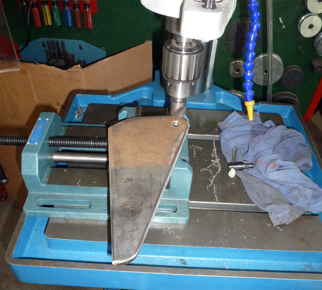

OK here is some work I got done yesterday and for you machine shop connoisseurs, I'll include pics of the machines used. This 3/8 plate will hold all cutting frames on, so it will see a great deal of stress. On the 4" channel, I drew the profile of the pan. The little plates bolted on its top are 3" tall and will be the pivot points and welded onto the ends of the 3" channel that create the cutting frames. The 1 and 1/4 hole on the side of the plate is a tow location if you need to tow this implement out backwards. This plate will see more trimming before its segment welded on.
Another pic of this setup.
Now making those little brackets you see that will be welded on each side. They are 3 x 3 x 1/4 angle but they will be trimmed down.
Punching out .5 holes for the pivot bolts.
Drilling them out, one size larger than .5. (I can't recall the drill size)
Kerfing the holes with a 90 degree chamfer.
Not shown is the cutting off and rounded them off. All edges were sanded off.

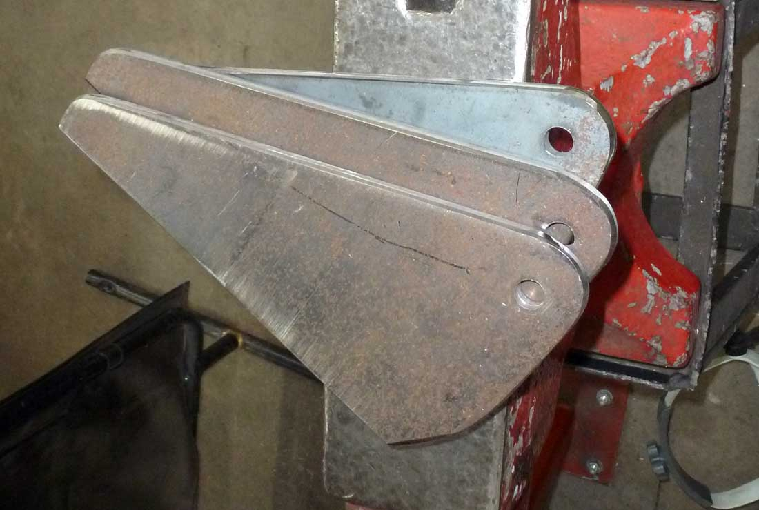

This shows the anchor for the cutting teeth and the bracket that will be welded to 3" channels. Its all made from 3/8 plate. There will be two on the bracket held by the same .5 bolt.
The pan got its reinforcement flat welded to it. The pan is 14 gauge and the flat is 3/16 x 1.5". Any guesses why I would plug weld it on?
This shows how the pan will be welded onto the 4" main frame channel.
Here is the anchor tacked on to the frame!

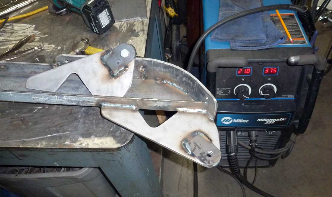

#49
Work done this week. This is the mian frame and I cut off the ends to give them gradual roundness. I used a torch to cut these over the years but this time, I tried a battery powered band hand held bandsaw. Worked fine!
After its shoe base and hitch attachment was welded on. The base will be where the plastic skis are bolted to..
My O35 wire welder settings.
One side is done!

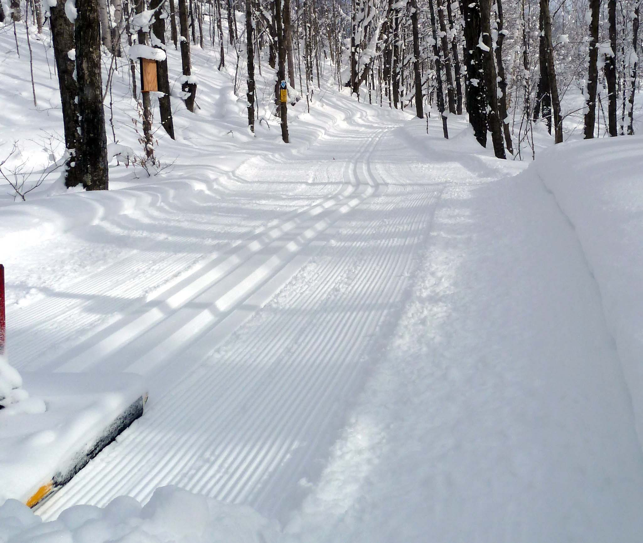

I'm awaiting for a pan from Yellowstone track systems. I already have one here but need another for the 2nd drag This is what they look like and run about $1600 each.

i don't wanna sound like a geezer but.....i will.
i took up x country skiing in 1970. it was just becoming a thing. wisconsin has long winters!
looking at the trails you maintain and the equipment they have now, what a difference, looks like they made some progress in 50 years.
Our skis were wooden that you had to wax and the "boots" were like very thin leather slippers with 3 little holes in the front of the sole that located on 3 tiny pins.
either the boots came off your feet or they twisted around so bad the boot became a turnaquette (stumped spell check with that one)
trails? the first guy in line made the trails, like a bull dozer. kinda like a flock of geese, every so often it's your turn to lead!
wanna get some exercise? go x country skiing!

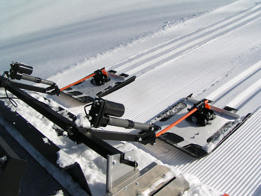

How the hitch will attach. Th holes in the ski plate are for mounting plastic skis. You can't see the rearward most one. These hdpe skis will be about 6" x 21" in size and what the front of the implement rides on.
