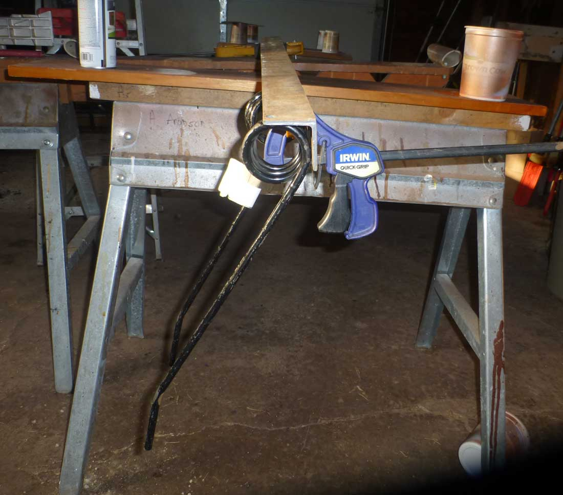

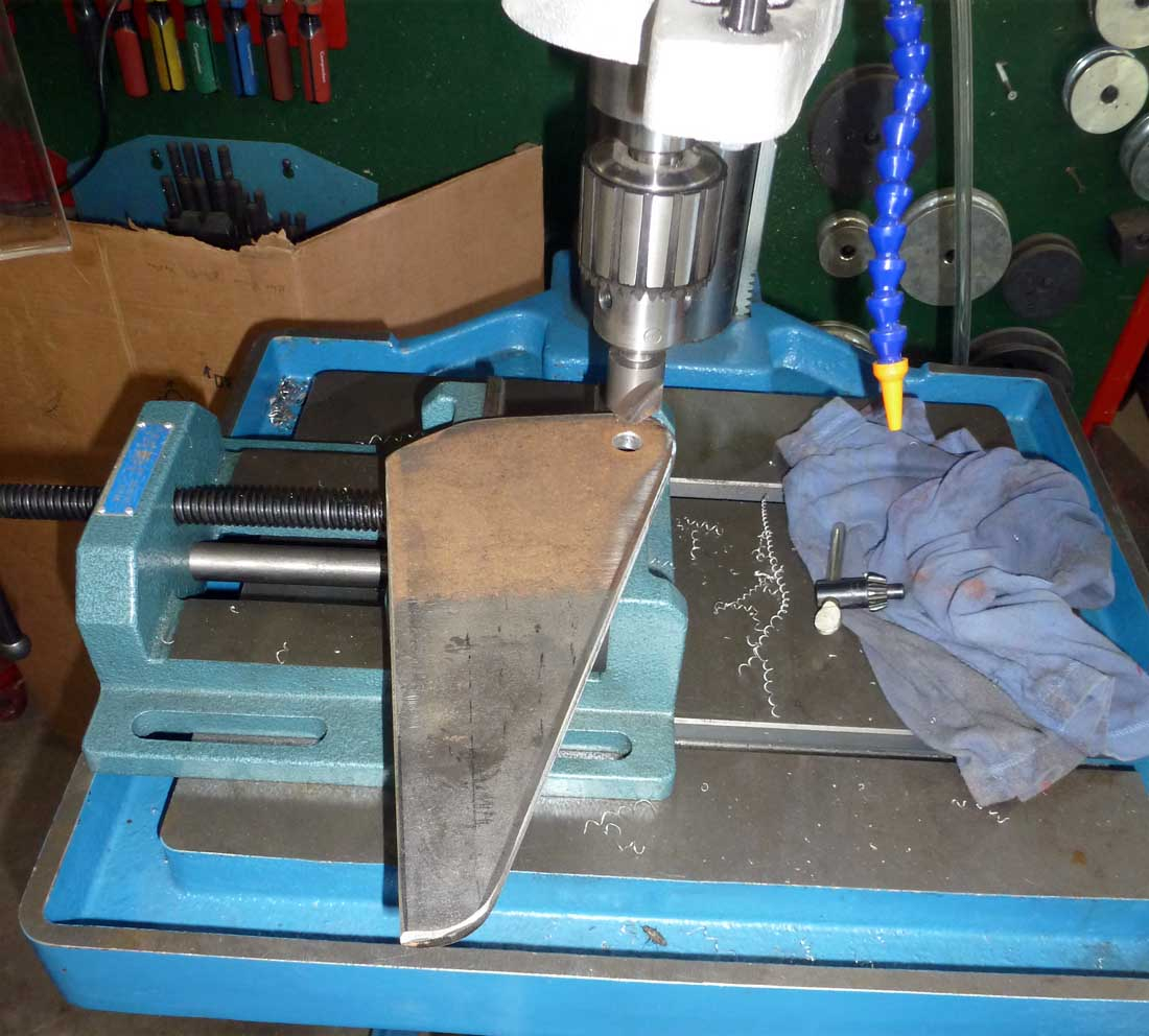

These plates will hold the hitch on and cut from 3/8 plate. In this pic I'm kerfering these 1/2 holes out.
I actually got more parts built that whats shown here :p.

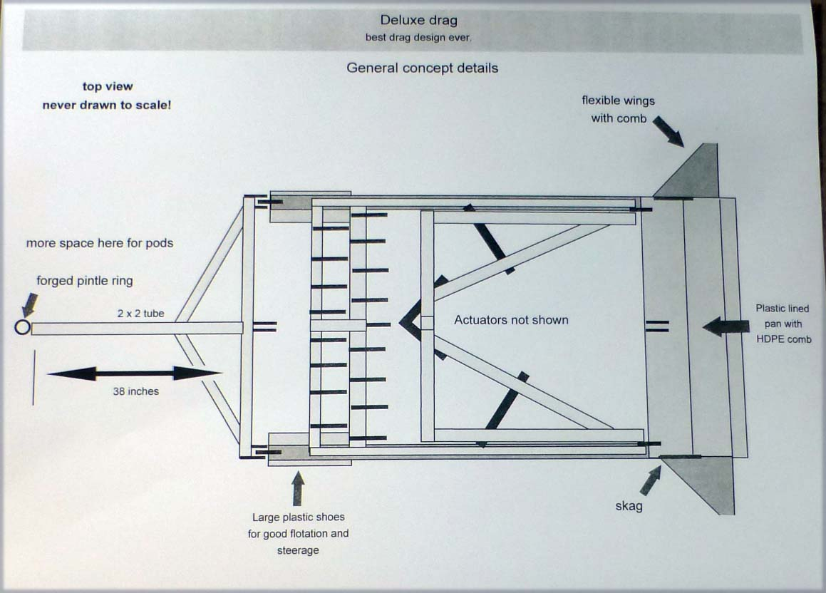

This print shows the pan which is on order from a local fab shop. This is in the back of the drag and holds the whole thing together, really.
In this pic of one I build some years ago, the pan is on the right.
