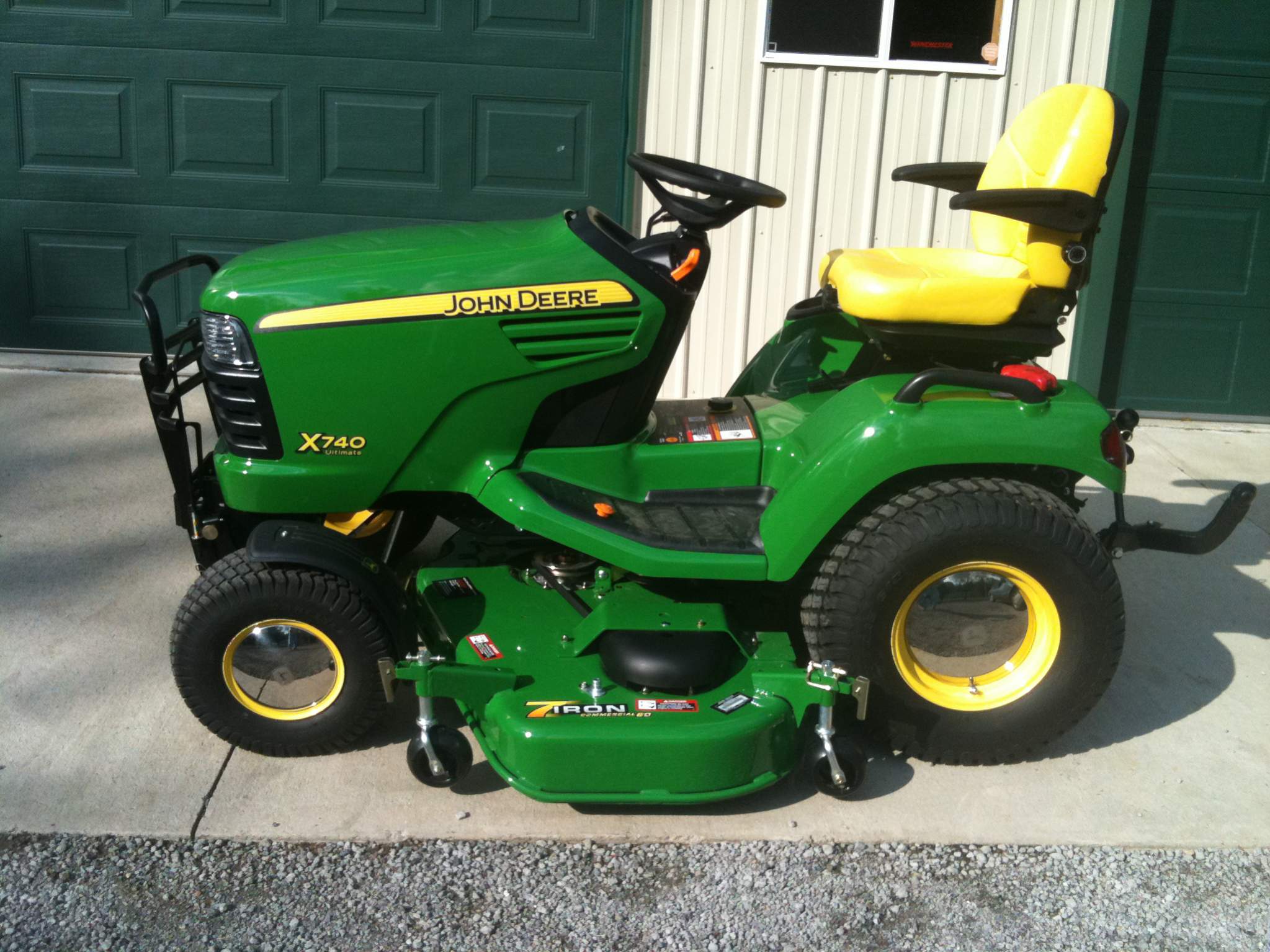

Your gonna struggle with that JD X500.I have a JD X740(diesel)and would not attempt it.
