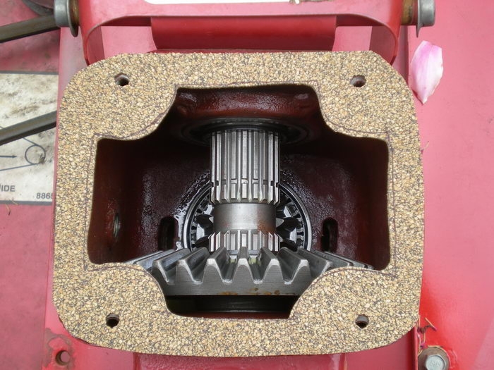

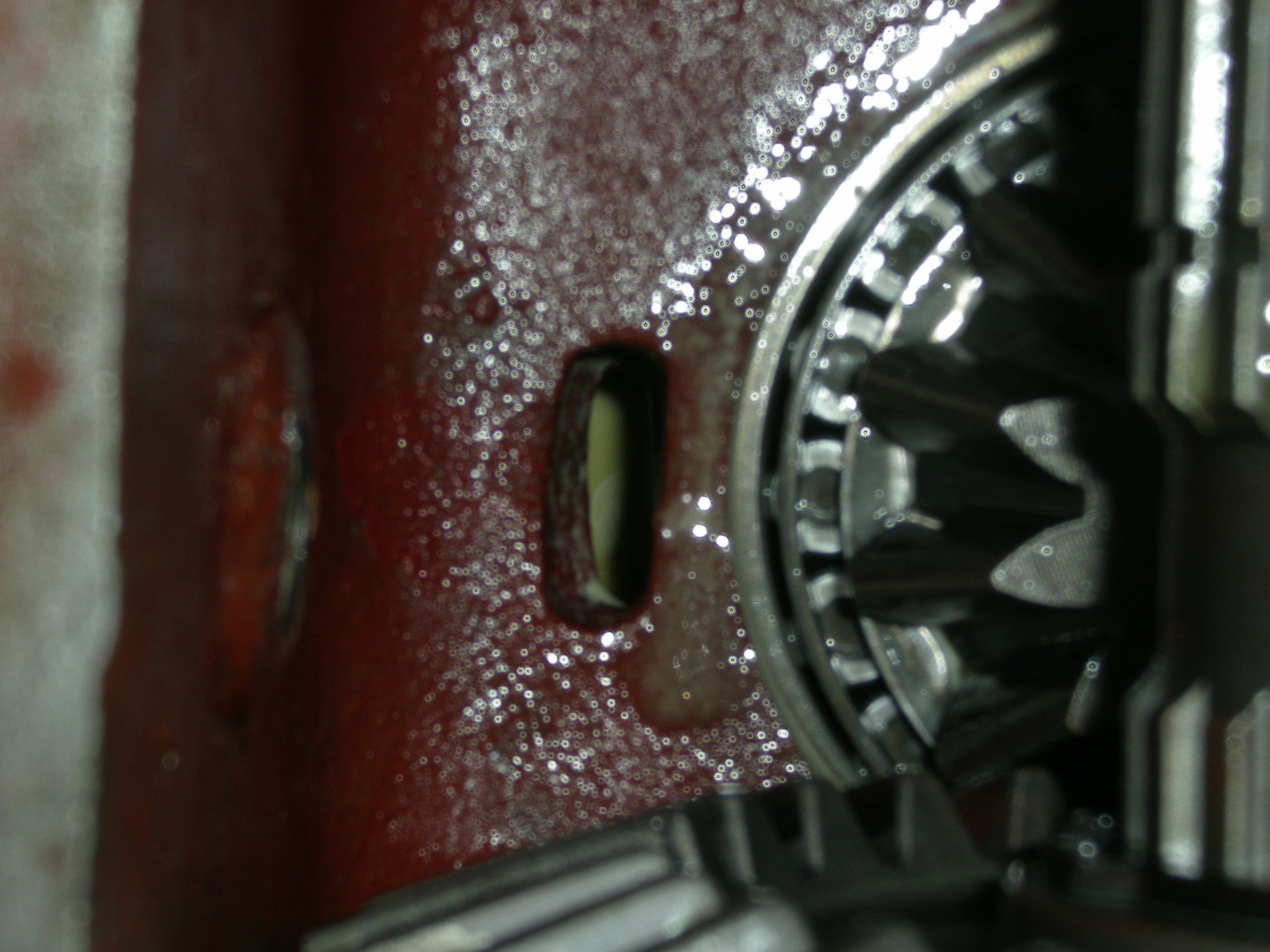

Photos of mine... the first time I changed it. I used a syringe to suck the water from the very bottom. Added a cork gasket, next time, I'll use a sealer.
