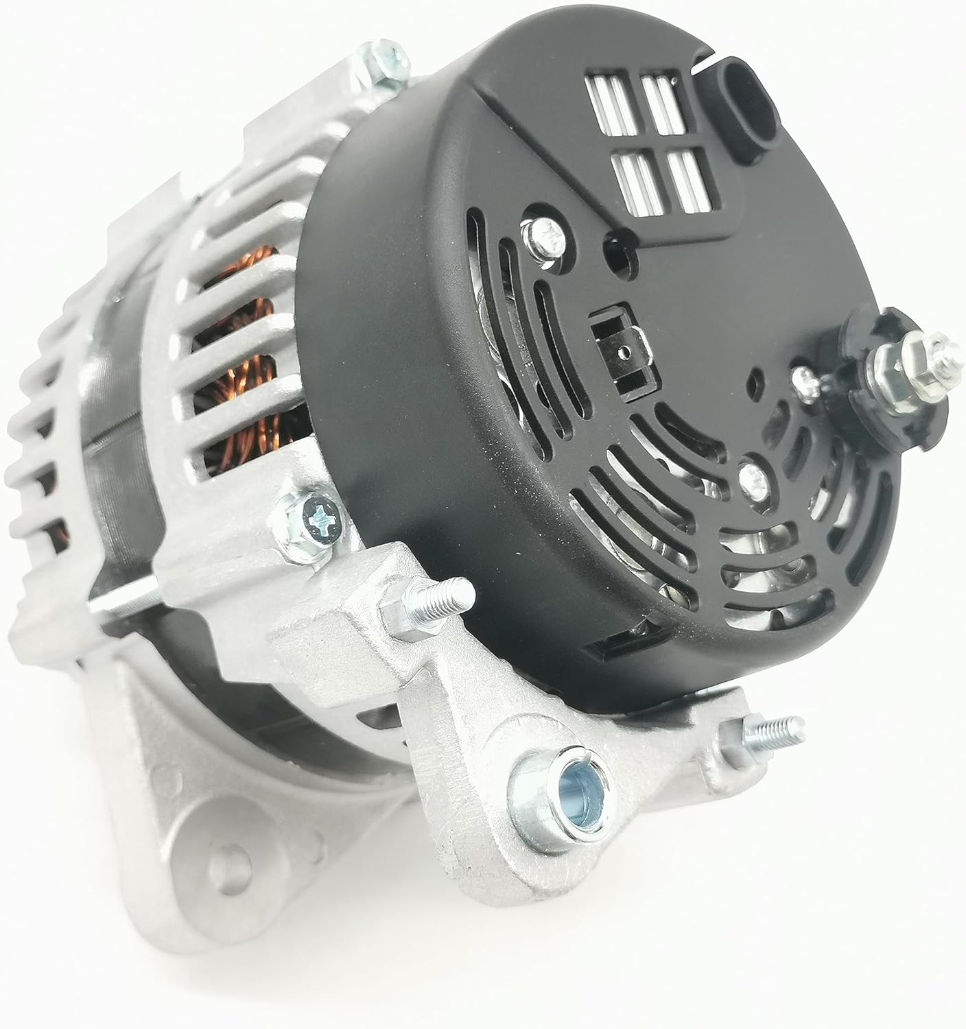

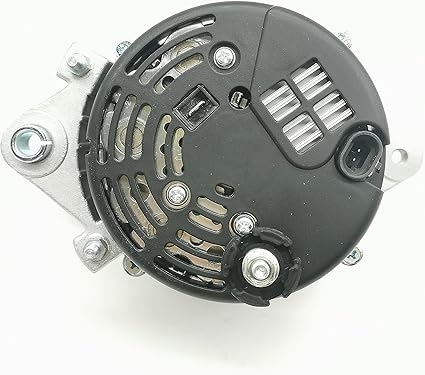

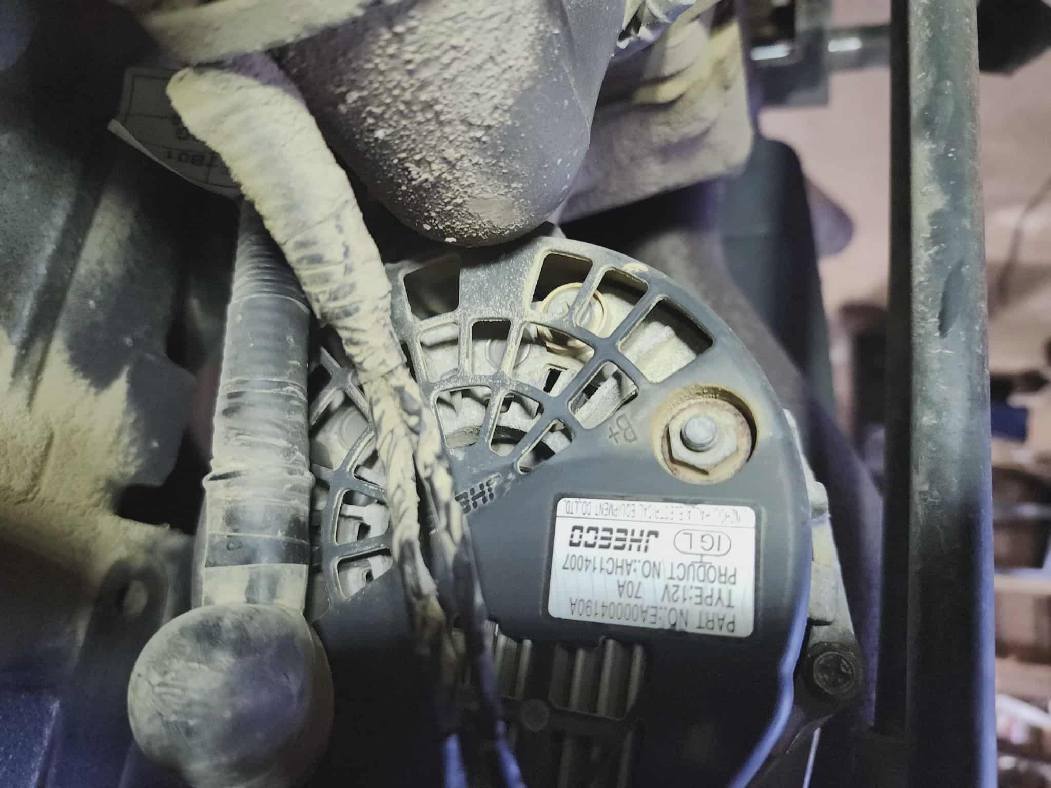

hi i have a 2018 x1.45c McCormick the alternator **** to to bed dealer says it will be 1200 and change. but that alot of guys swap them out. just wondering if any one has done this ? it has 2 wire plug and a spade along with the battery lug. if it fits and bolts up i can change wire ends looks like this one i see them on amazon but not 100 percent it will fit and will it last

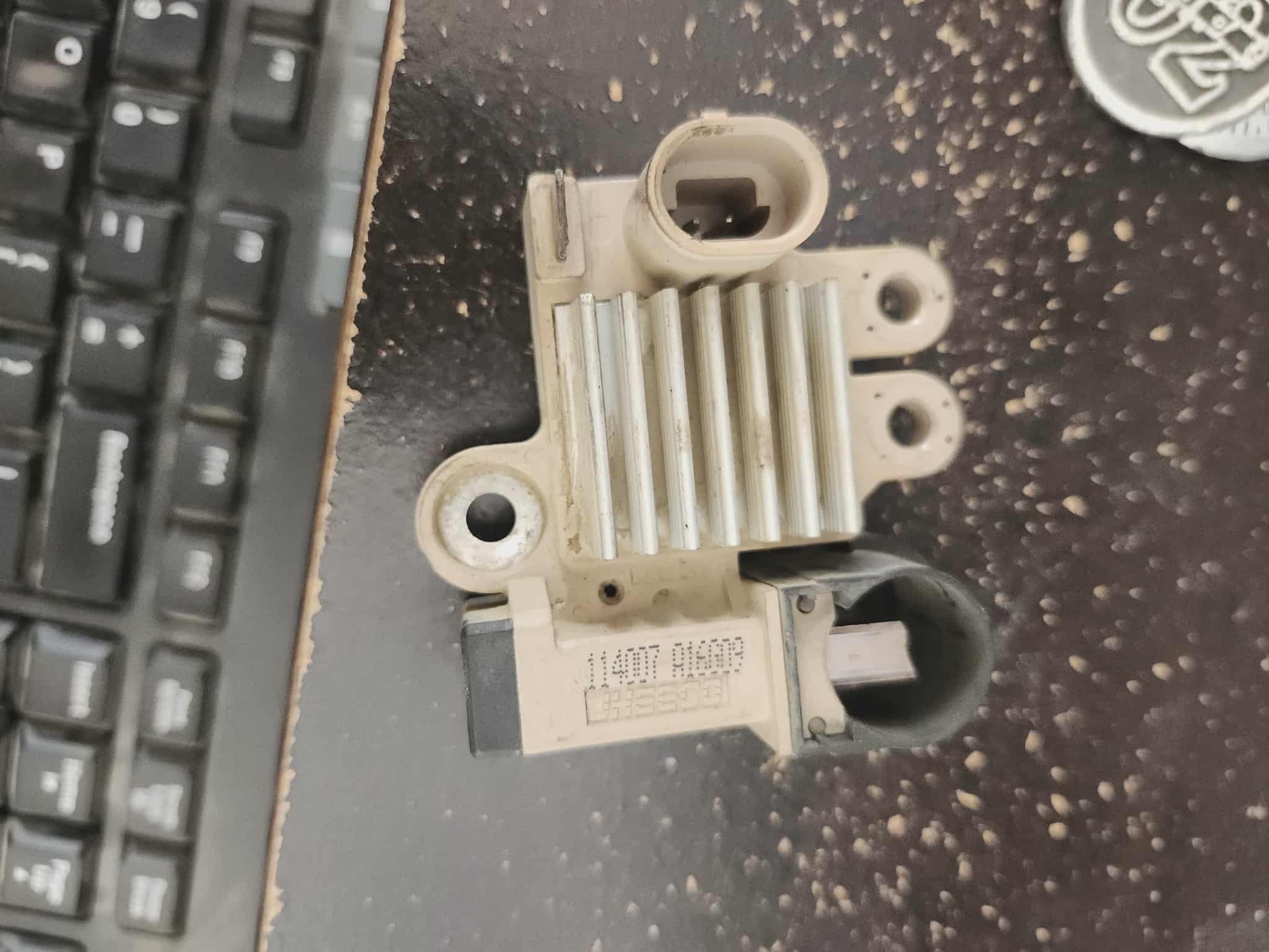

i could get away with a voltage regulator but i can not find one tried everywhere

On the OEM alternator, one of the wires on the plug is a signal from the ignition. The other is for the charging light. Then, depending on the model, there is a single separate brown wire, that is the signal for the tachometer.
The tachometer receives this signal to count RPM but also to signal the hourmeter to start adding hours.

i was looking for anyone that found aftermarket one that works i know what the wires are for. i know it is a branson 4520 i know it is the regulator. my problem is the only one i can find is on amazon shipped out of china. i see a bunch more but none have a pick of the back of it. i need the 3 wires plus battery lug. i read through the branson one it was beyond useless. warranty etc one alternator was talked about but no numbers. i spoke to 4 shops no one can get the parts or alternator. i was hoping for someone that has done it and the one they used. parts places don't stock a bunch nor will they open boxs all day to try to match it up.

i ordered this one and it fit and is working fine if anyone else has this problem
