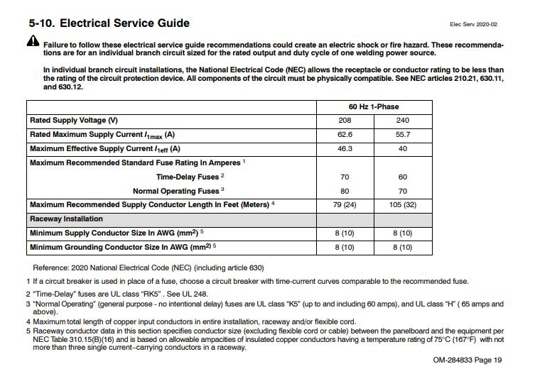

Absolutely not. You aren't qualified to comment on any logic I use or decisions I make concerning my own property. If I own an item that draws 50 amps and there's a chance I might need it in a given location, running an inadequate circuit to that location is a stupid decision.

I wonder why the code doesnt require a sign or why they think this is not a problem? Its been this way 75 years and not even a concern till the internet came along. When they invented these welders it was leagal,,, masters installed these by the millions with 10 cable to 50A range side of fuse panels.
They were installed by guys knew the difference between a plug and a recept. In todays world still done and under inspection usually by guys know the difference between 110 and 240.
/ X-cord for welder #74
220,,, 221,,, what ever it takes.
I'd wire it to handle anything I wanted to plug into it. Who wants to install a 240v circuit and not be able to use it?
This is about this statement and not about the guy that wrote it. These circuits are not designed and not intended to plug anything in them. We see this when the subject of adapters come up. I dont believe there is a legal adapter from 6-50 to anything else. There is one from 14-50 to 6-50 but none from 6-50 to lower currents.
I believe the only legal one is 14-50 to 30 travel trailer.
As I elude to the focus is so intense on what if,,, that other aspects are ignored. The as important and maybe more so because its kind of an ambush is that the equipment being plugged in to it is not designed to be plugged in to circuits with a higher breaker.
Guy makes a 50 to 20 and it now lets equipment that was designed to be current limited plugged on to a 50 breaker. The tool still draws the same current but is not fault protected. Its simply why they dont allow common 120 on 30A even if you use 10 wire in the circuit. Its why they allow 16 cords on a 20A, load limited by the appliance and not the breaker. In the case of xmas lights the modern ones add a fuse, the old ones did use more current but the wire had to be sized for faults.
