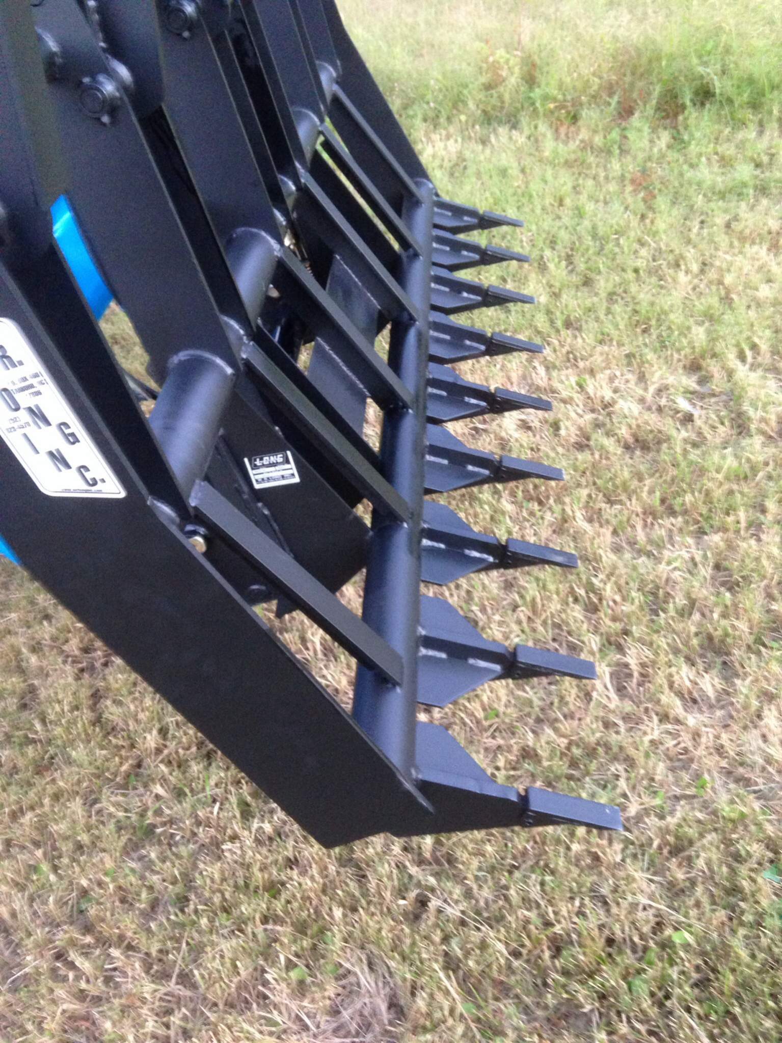

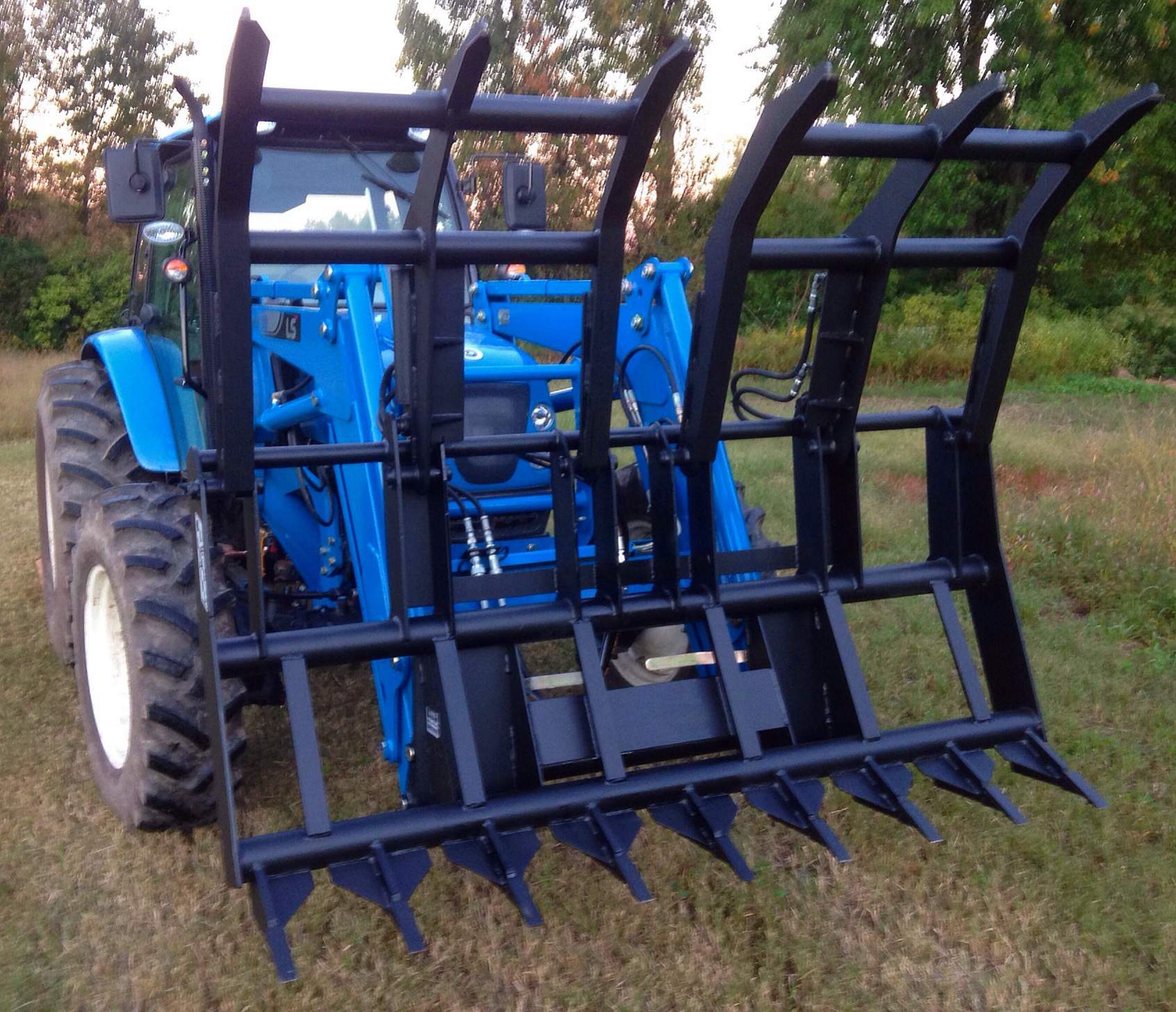

I ordered a WR Long RBGD 84 grapple a little over three weeks ago that is on the truck to be delivered this week. RBG
Was going to order the same style you are considering but after using a friends who has a tree service, went with the RBG series.
I think the EA version is nice, but a little small for your tractor. Good luck and I'll be sure to post a new thread when it arrives.

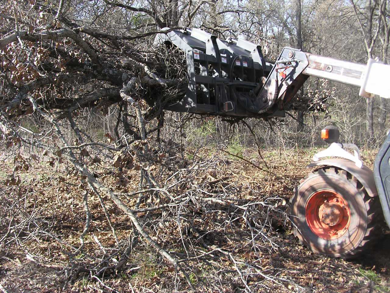

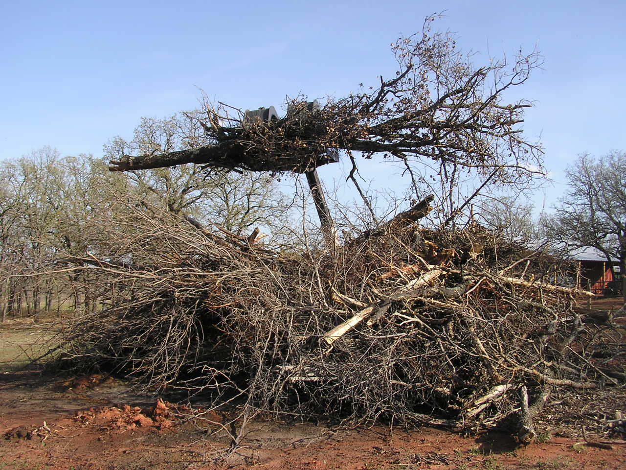

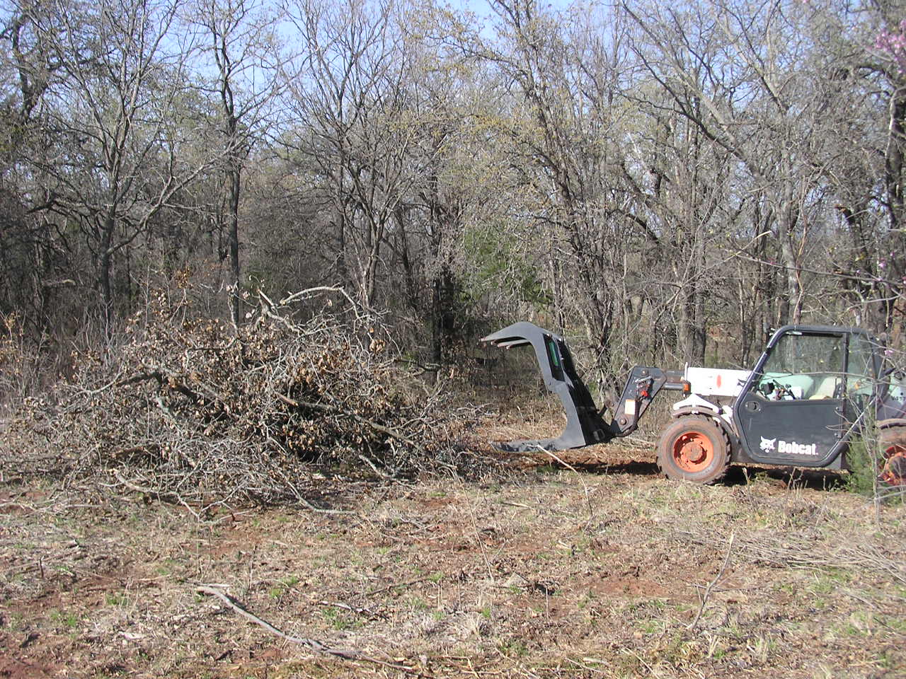

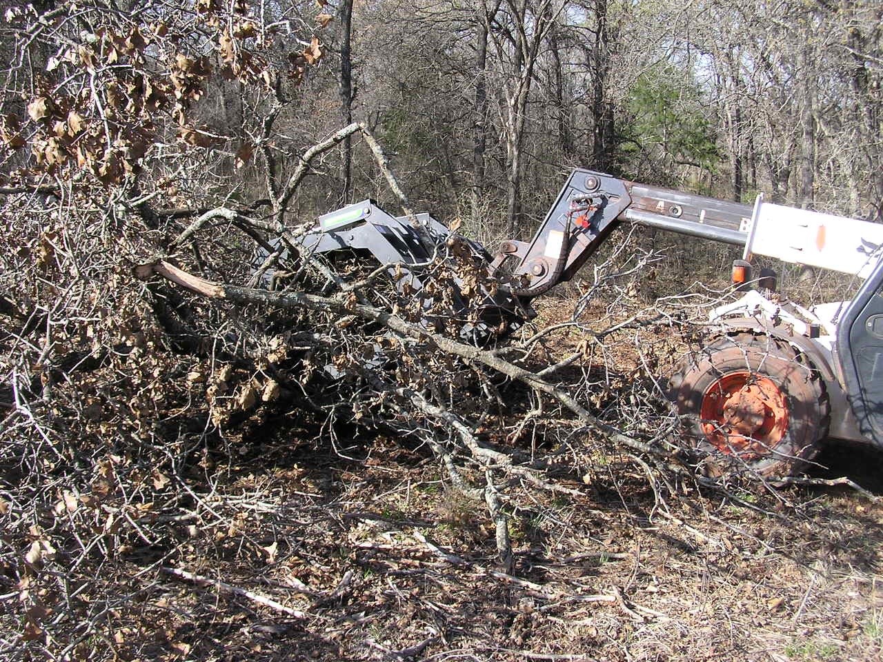

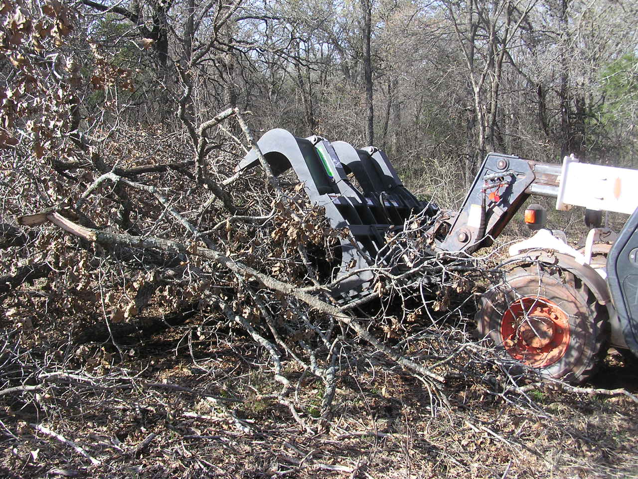

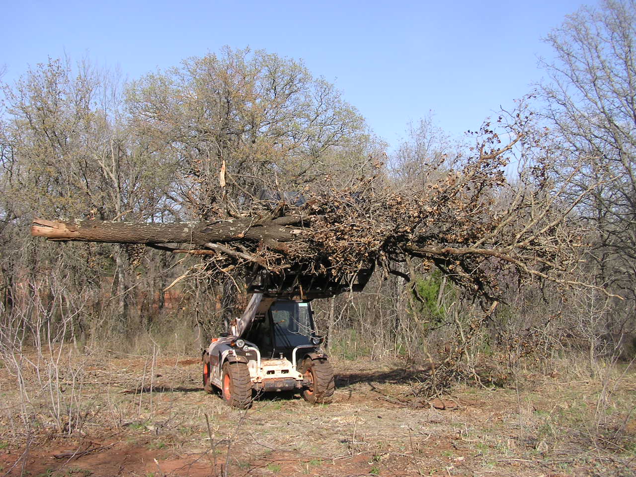

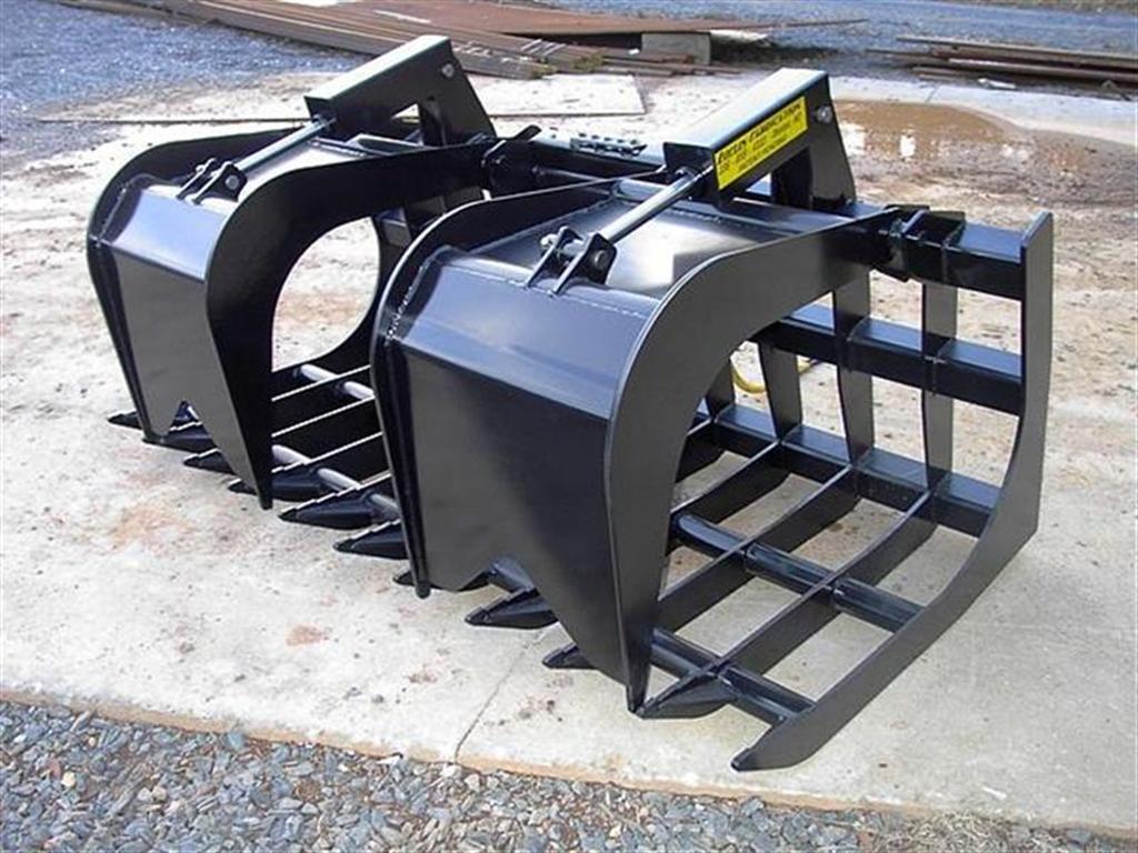

With that much lift capacity, you need the Monster Grapple:
Notice the high back that gives it a 51" high opening.

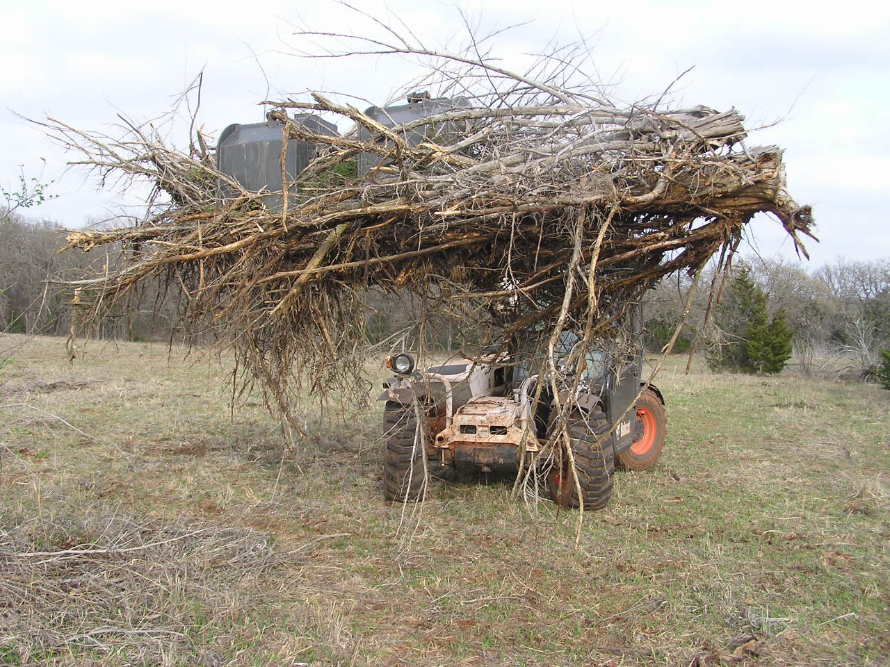

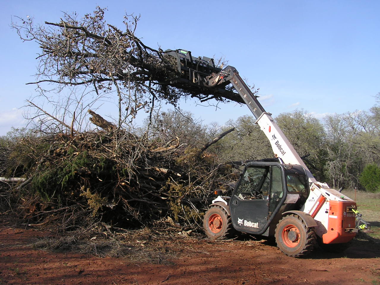

Mine is 6' wide. Making a burn pile.
Got it here: New Loflin Extrem Monster 72" 6' Grapple Root Rake Bucket Skid Loader Holland | eBay

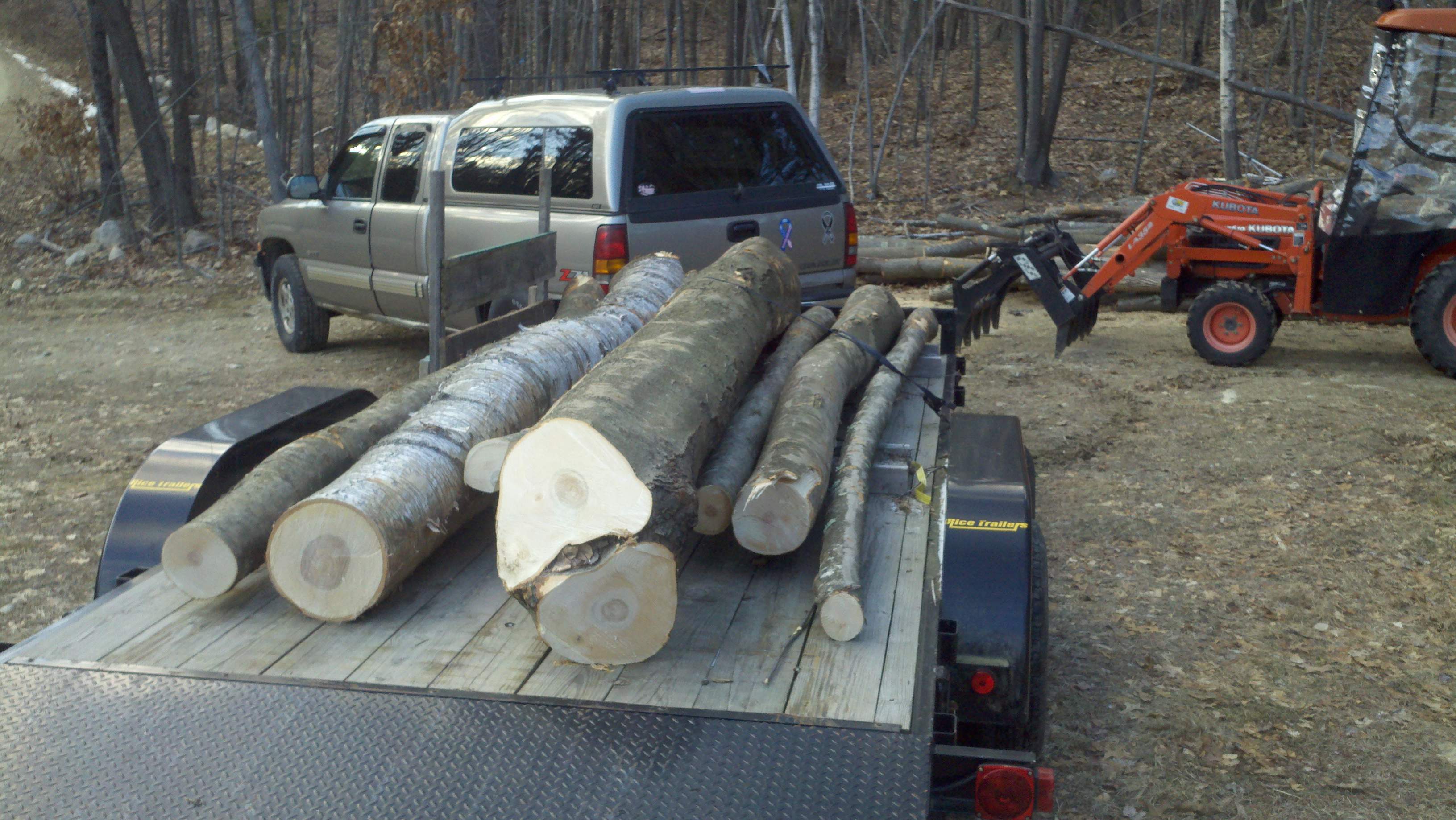

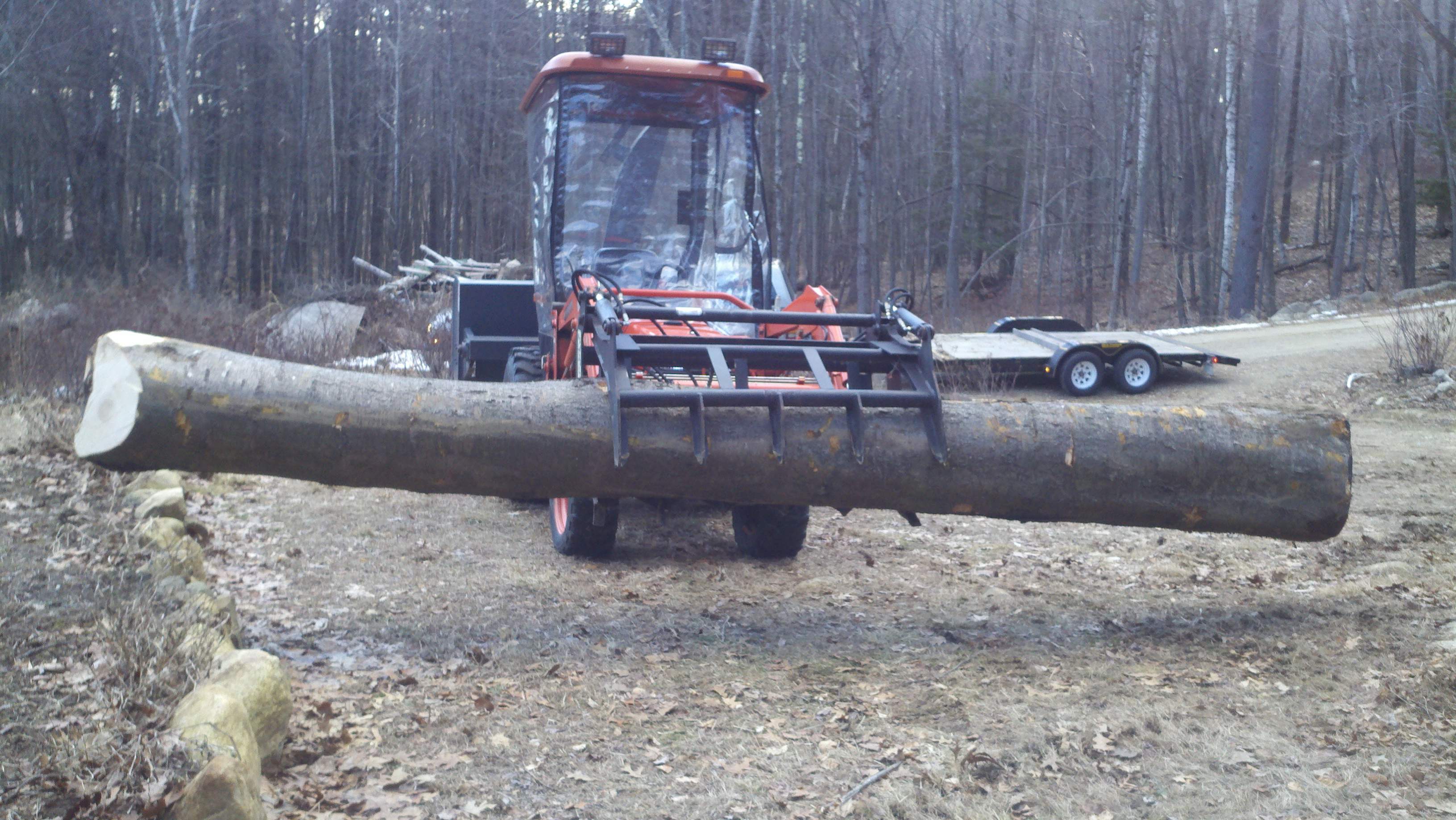

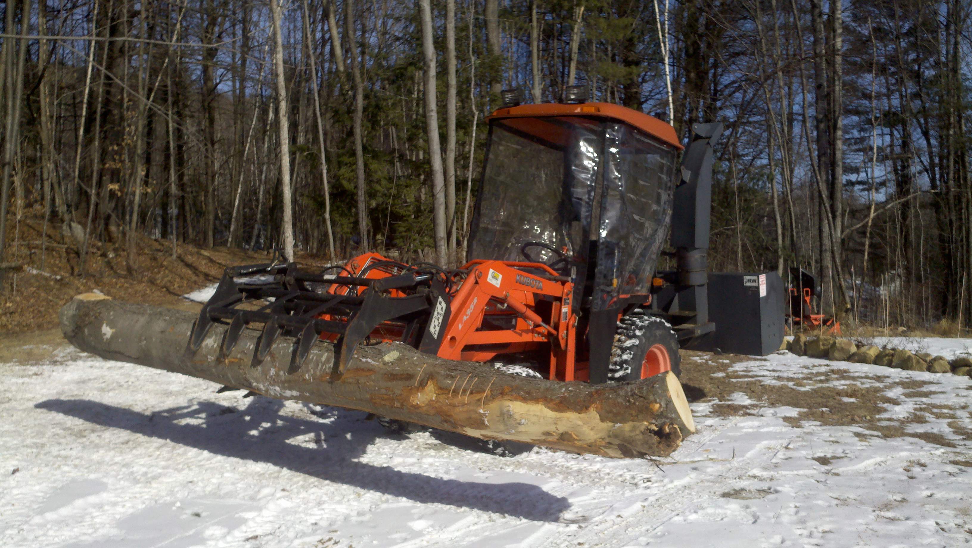

Here are a few pics from last January.
/ wr long or ??? for brush & logs? #11
HOW did you manage to lift that log with a 7610?
How big is/was it?
It looks about 10'x20"
Through my computer screen, I can hear every bolt/loader mount on that tractor screaming for relief. :eek:
I'm starting to lean towards that one too. Looks like it might grab brush better. Anyone tried both the RGB and the OBG and care to comment?
