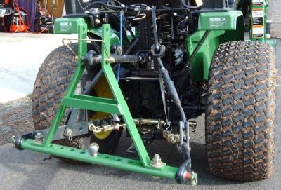

Is this what you want to do?
I bought the bars and the drawbar and pins, including another Cat 1 top link (not shown here) at TSC for $75. A friend who works in a machine shop bend and cut the bars and had a buddy fillet weld where they bent.
Here's the drawbar. Will show what it's attached to in the next pic.
Ralph

   / Would you buy new or convert old #7
Here's what it's attached to.
Notice the 2nd top link goes back to the tool. My friend just made a simple bracket to attach the pair of bars to the 2x2 bar on the tool that's being lifted.
Ralph

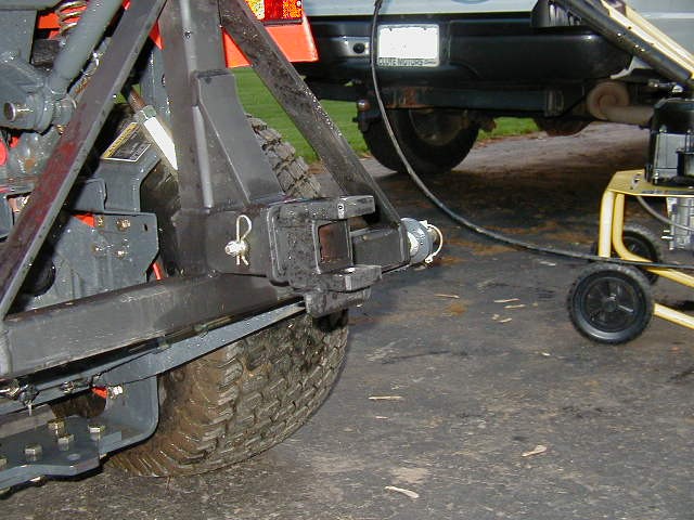

Madman,
The picture you show is my setup. I had the 2" receiver hitch built by a local fab shop from drawings I created looking at others. They charged me $75-100 if I recall. This included a normal 2"receiver for a ball and the 2" receiver for the sleeve hitch shown in this picture.
I have since modified it to have stops on both sides as the hitch was too sloppy. I was trying to use the adaptor for my yard trailer as well as the plow, but would only do for the plow if doing over and design directly to fit it.
It works well and in my opinion isn't worth getting a new one as you noted they are not cheap. I cannot speak for your other attachements, but if they are heavy duty enough I would definately keep them all.
If you have any more questions, or would like more pictures, let me know and I will try and snap them this weekend.
