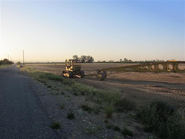

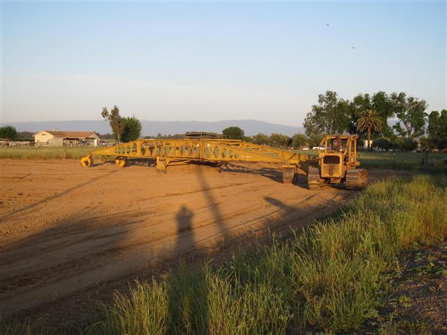

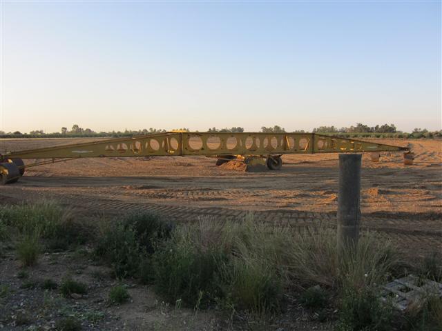

One of my neighbor's three 10 acre irrigated alfalfa fields needed to be leveled and resloped so it would drain more evenly and not cause excessive runoff into a neighbors olive orchard. Here's what he used for that job.
It's a D7 Cat pulling a giant landplane. Gets the job done really fast:thumbsup:

Very cool! I haven't seen one of those since the 70's, grading acreage outside the Ventura / Oxnard area near Pt. Mugu.

Are you sure those photos aren't about 50 years old? :)
All I've seen lately are large wheeled tractors pulling laser equipped scrapers.

all it is, is a motor grader. but longer wheel span and bigger blade / frame work. to deal with tractor / dozer pulling it.

Took those photos a few weeks ago. My neighbor also uses a large laser controlled gannon box for some field preparation work.
That field previously was producing alfalfa. After the work with the big landplane, he planted sudan grass rather that reseeding immediately with alfalfa since alfalfa is allelopathic (produces chemicals in the soil that are toxic to its own seedlings). The sudan reached about 3-4 feet this week so he mowed it with the Hesston swather yesterday (in 100+ temps, 10% humidity -- it should be ready for baling in a day or so).

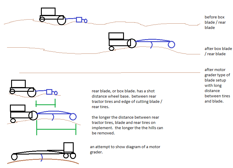

that would be nice as well. but... there is a difference. between that, and what i would like to have. to help remove the longer and wider valleys. ya a dozer or like with laser setup could possibly work. but *shrugs*
Yes, it would be too small and short wheel base for your needs.

Landplanes like this one are used a lot in the Great Central Valley of CA to prepare fields for irrigated row crops and orchards. Have been for nearly 100 years. What we know today as the Caterpiller Corp was formed by the merger of two CA tractor companies, Holt Manufacturing (Stockton, CA) and Best Tractor (San Leandro, CA). Both Holt and Best specialized in track-layer type tractors to tow huge ag implements like this humongous landplane.
