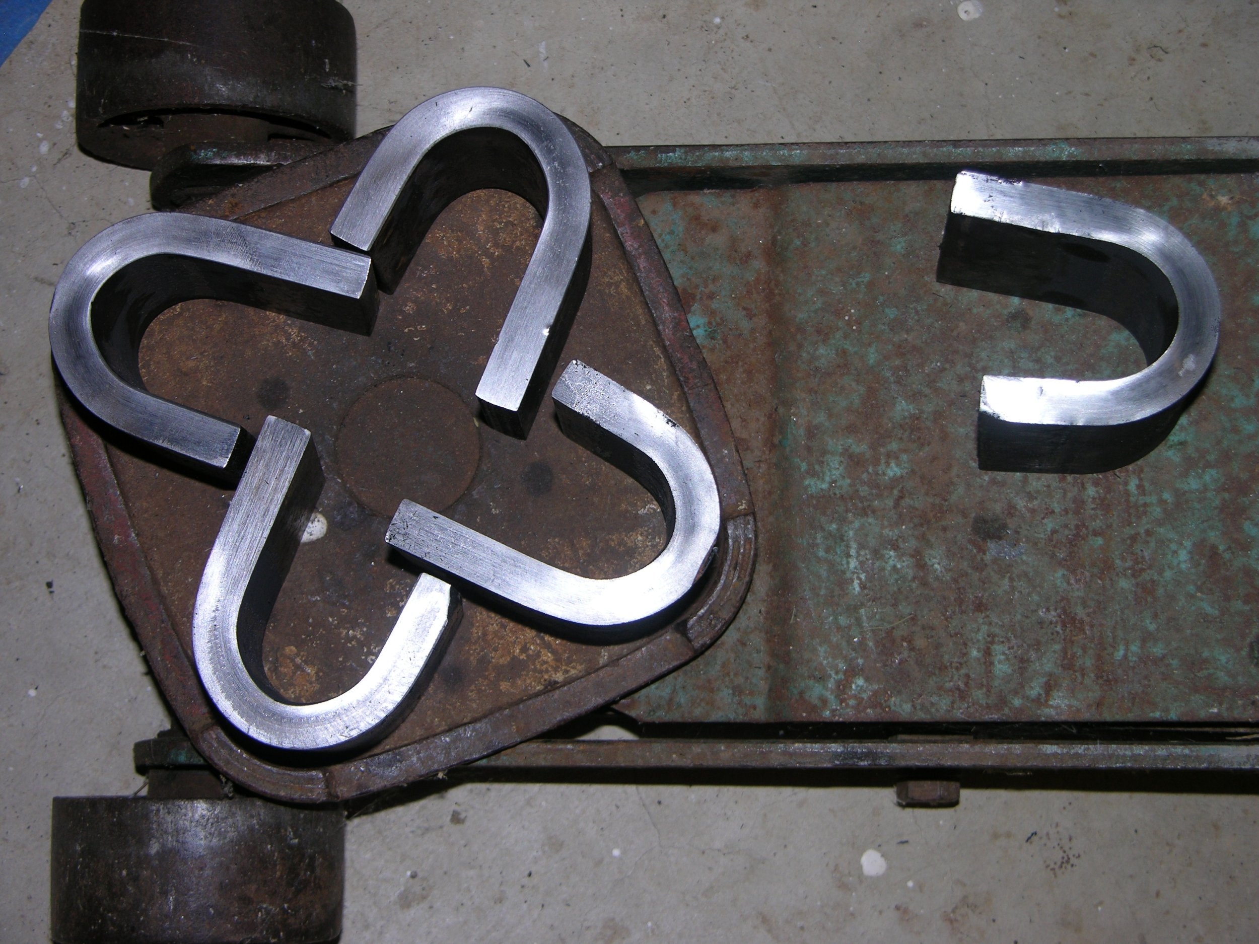

I agree - I keep .035 Lincoln L56 in both my MM252 and the MM211 - I've done everything from welding field fencing (14 ga.) to a pair of 10' gates made with 1" EMT (.058" wall) up to a bending jig for making U brackets from 1/2 x 3" for a QA system for my 580B (jig was made with 3/4" x 3 FB)
Can't find the pic of the gates, but with the .035 the technique was basically to light off on the emt for 1/2 second, then flick the wire over onto the fence wire just as you release the trigger - took me a couple tries before I quit making holes, even with a low setting:oops:
The bending jig was definitely a multi-pass, and the U bracket was all my 20 ton press could manage.
I do have the 30A spool gun for the MM252, and have used .023 in the spoolgun for a couple light projects, but I'm not much into "tinfoil" work - besides, .035 wire is usually less expensive per pound so another plus... Steve
