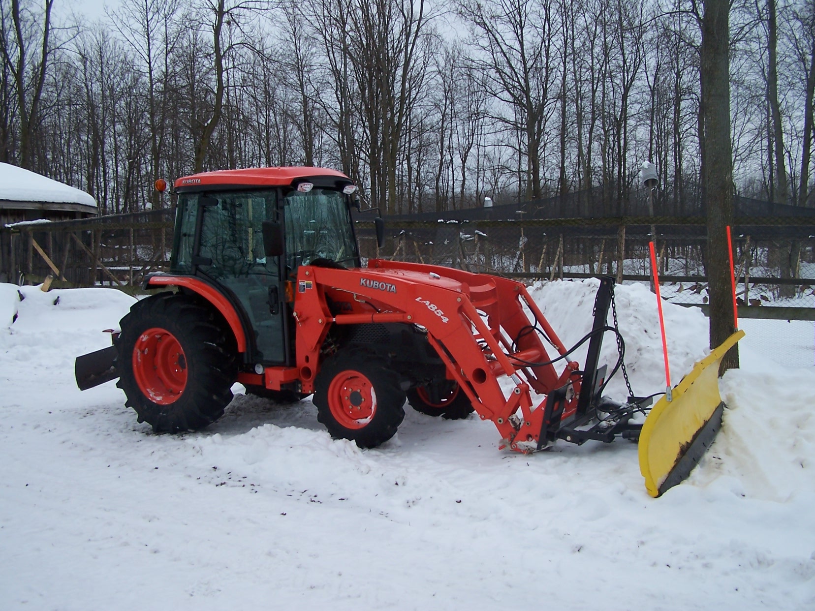

I have used a FEL mounted plow for four years.A converted (Curtis) truck plow.Mine is an eight ft.,you want at least a foot wider than your tractor for angle.A also run a seven ft.rear blade;this makes a nice combo.Make sure what ever you purchase has trip springs and that they work.I built my own..lots of ideas on TBN.My set-up floats on a chain,not the float for the FEL.

Here is couple of pics
I like your setup! Do you by chance have a closeup of the mounting system? Also, are those pheasants I see in the background in the first picture?
/ Winter is coming #9
Yes they are pheasant; I raise about 1500 per year.I own a small uplands preserve.
My set up looks a little different;I was going to add a boom pole when I first built it,that is why the vertical is so long.Just a skid steer adapter plate with pivot points so the blade can float on the chain.I find this works best for me.Similar to what would be used on a pick-up only no lift cylinder.I replaced the angle cylinders.The most expensive part was the hydraulics for the tractor(third function).

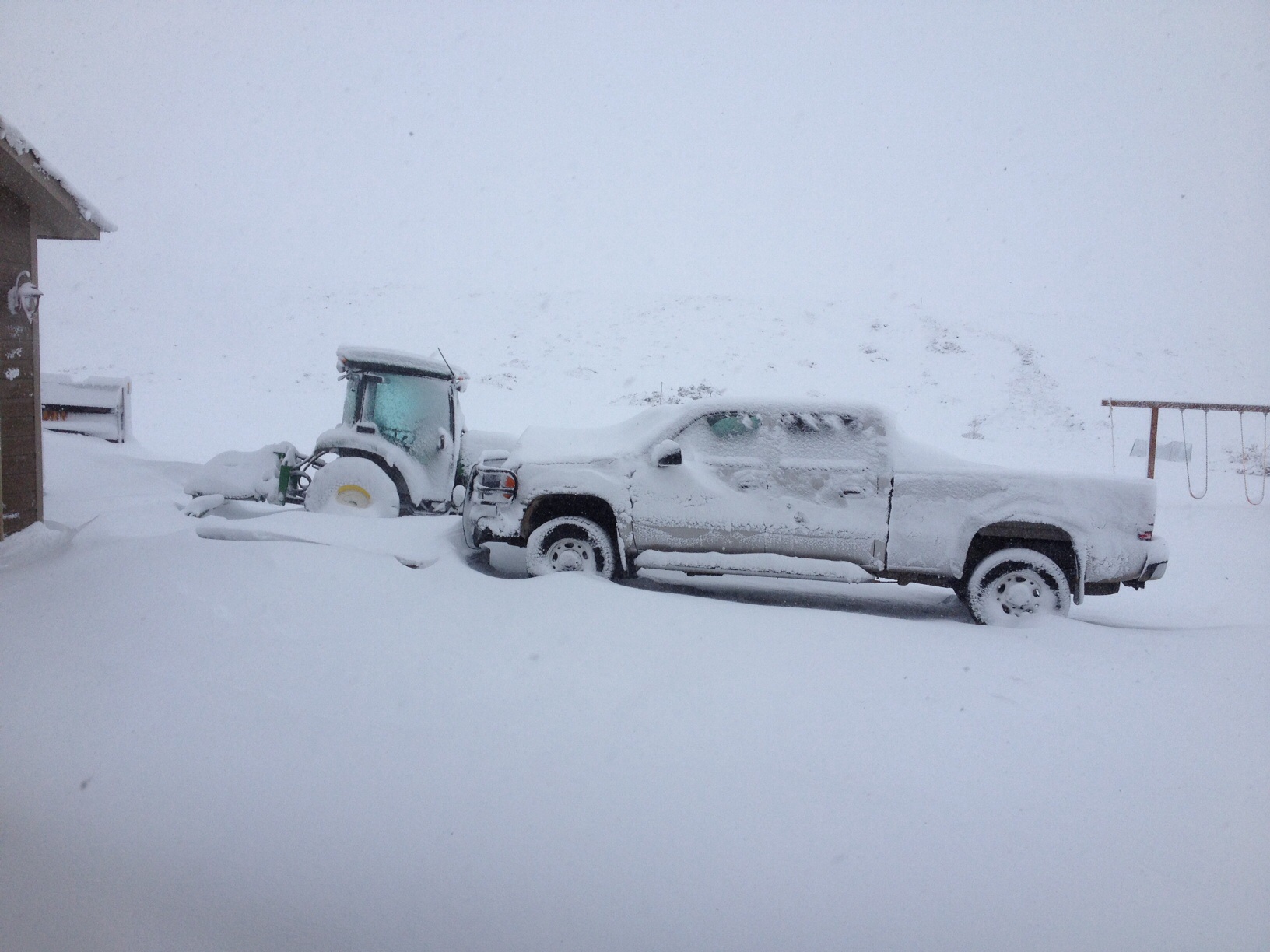

We too live in the eastern hills of CT. Have a 1400 ft dirt driveway,, Since day one, I use a power angle plow, 90" on a Case DX 45 cab tractor, with heavy wet snow, I found out trying to watch the weather reports and hit it half way through and go back and finish works great, I also mount St Pierre roller chains on the front,

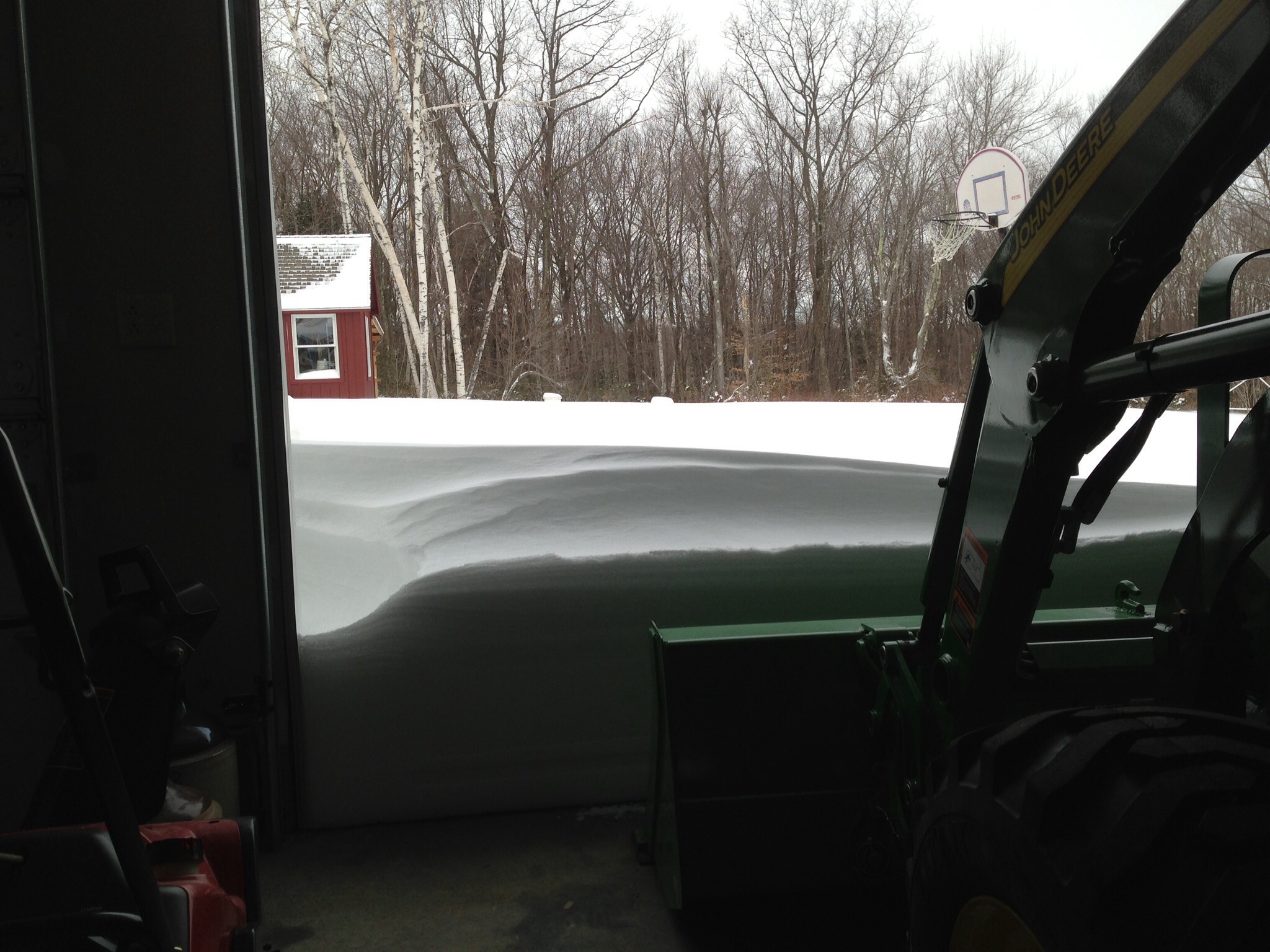

Winter is here for me. In the past I have only used a rear blade and the loader with bucket. On my new deere I am running a front frame mounted hydraulic blade and a rear hydraulic blade. This weeks storm was quite the trial run for it, and it really performed well. I need to fill the tires yet and invest in some front chains, but managed to clear about a mile and a half of 18 inches of wet, heavy, and drifted snow without. Ideally a blower would have been perfect for this storm, but my set up will do great till I want to afford one.

You can use the"float" on the loader(and a lot of people do) but you have the weight of the FEL+the weight of the plow pushing down.My plow is plenty heavy and I don't need/want this.It has two pivot points(low) and the chain is used to lift.
As stated the rear blade is used to clear garage doors ect.My front blade has skids and the rear blade will clean right down to the asphalt.I have R1's(AG) tires and no chains;loaded tires and have never had a traction problem.Total weight is about 7,000lbs.
