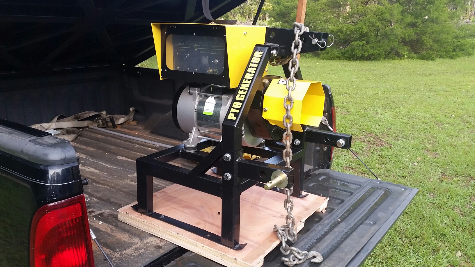

I just purchased a 15,000 watt made in china pto generator from Agri Supply for 1295.
Been running it for a while off and on today. It's all my little 855 can handle when I use the hot water heater. I leave all the 120 circuits on and alternate any 240 demands.

I am surprised your 855 has issues with the water heater,,,,
My 10KW generator (Miller welder) with 22HP doesn't even know the water heater, 240 volt deep well pump, and 3 fridges are on!!
I bought an 855 last summer,,, it seems like it has 22 HP,,,
It sure will power the 5' Woods RFM through a TALL (8 to 10 inches) lawn,,, (the rain has stopped mowing for long periods this summer)
My 18HP Cub Cadet with a 60" deck would never even consider cutting that grass,,, Hmmmmmmmm,,,,,,,,,,

The 855 is 24 hp engine with 19 hp pto. All I can say is with the water heater on it just will maintain 60 hz.
   / Winco PTO Generator #28
IIRC, an electric water heater element is either 3500 or 4500 watts,,,
most generators make that much with, what,, ~8HP,,, ??:confused:
Maybe your heater is wired to power both elements at the same time?
I know only one of my elements can come on at a time,,,
Possibly there is a defect in the upper thermostat?

Could be any combination of reasons. The least of which is the fact this is a cheap Chinese gen.
My water heater is an old 50 gal Rheem with two 4500 w elements running on a 30 amp breaker. I imagine they both run till it reaches temp.
I purchased and connected the day after the hurricane so all proper supplies were bought out. I had to rig it and back feed through the 30 amp dryer circuit.. Will get a proper switch mounted when parts are available. In the meantime I have to keep the main breaker manually turned off while connected and running.
Either way my 19 pto hp is undersize for this unit so power will be limited.
