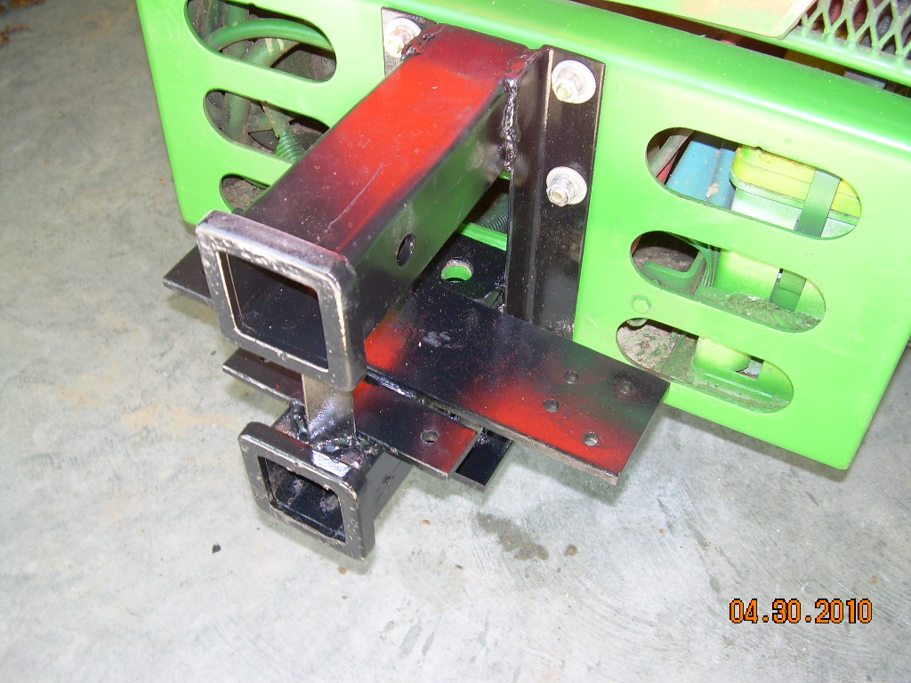

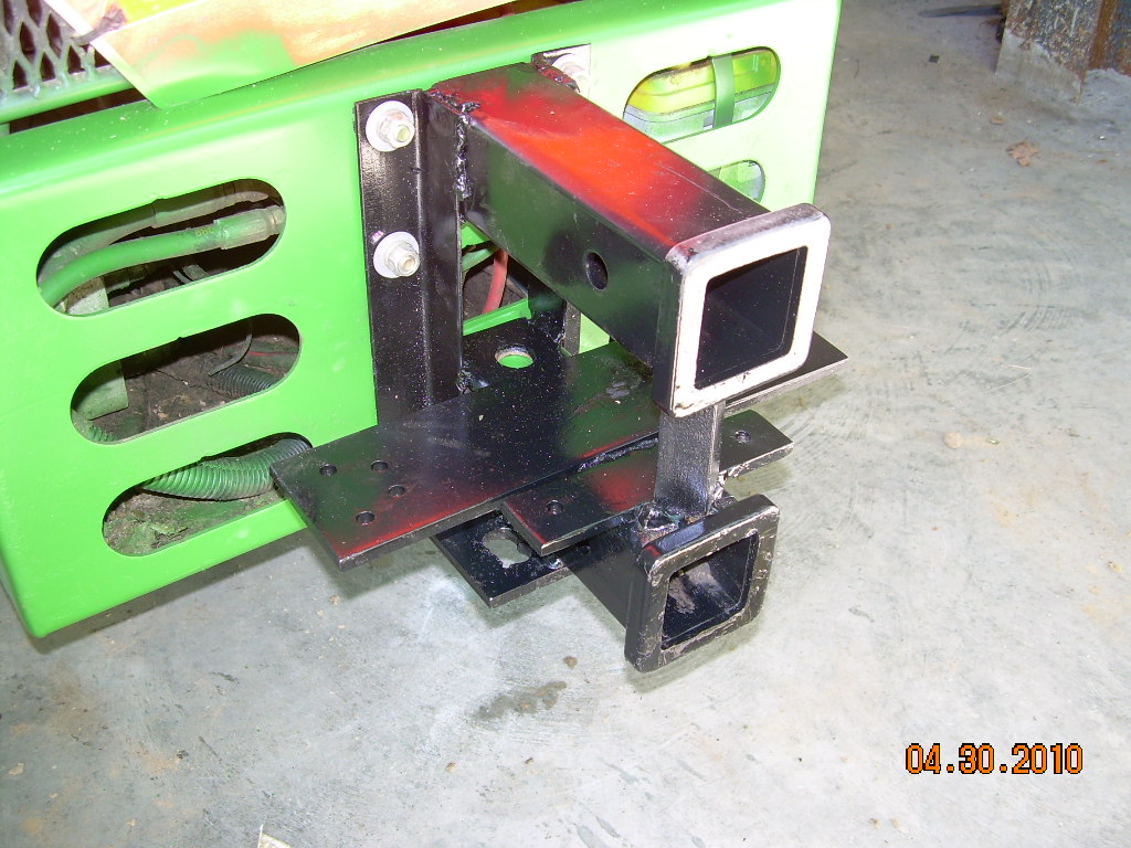

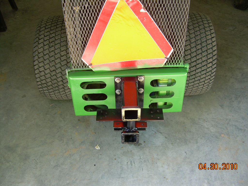

I took the machine out today with the winch on back. I did not need it, but it did not interfere with the use. I am thinking about shortening the two inch receivers. I will have to grind off the reinforcements at the end, and then weld them back on. The machine is very long the way is it. Suggestion here would be appreciated.
Nice job Bob! just a thought for you on how far the winch sticks out back...if you were to cut and reweld the 2" so the winch straddles atop your (top) receiver, you would both reduce the back extension and lift the winch even further...perhaps to the point that you could glance back and see it. kind of hard to explain but visualize a u shaped sort of affair (on its side). this way you could still easily attach via receiver
second thought would be ...you could reconfigure your brackets so that the winch would operate horizontally but the receiver connection could be vertical per 3238's suggestion. again, you would raise the winch further and reduce rearward extension... hope this helps

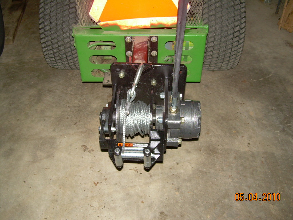

#49

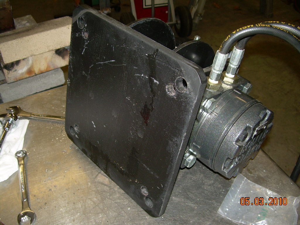

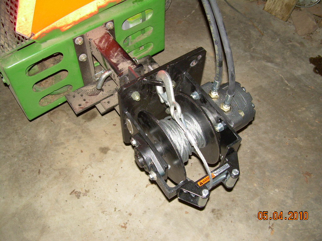

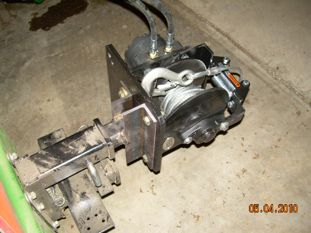

All of these comments got me thinking. Thanks for the suggestion. I decided to put a two inch receiver facing left, between the other two 2 inch receivers. So I now have three of these things on the back of the PT. I then slid the winch in from the left, just for storage. I don't think I would actually use it there. If I did I think I would need some more reinforcements. The whole assembly now sticks out about 11.5 inches. That's one foot shorter. I think I can use the other receivers with the winch going sideways. I think this is an excellent approach. We will give it awhile and see.
Again, the comments are very helpful and force me to think of other ways or maybe even use a comment. See pictures.
