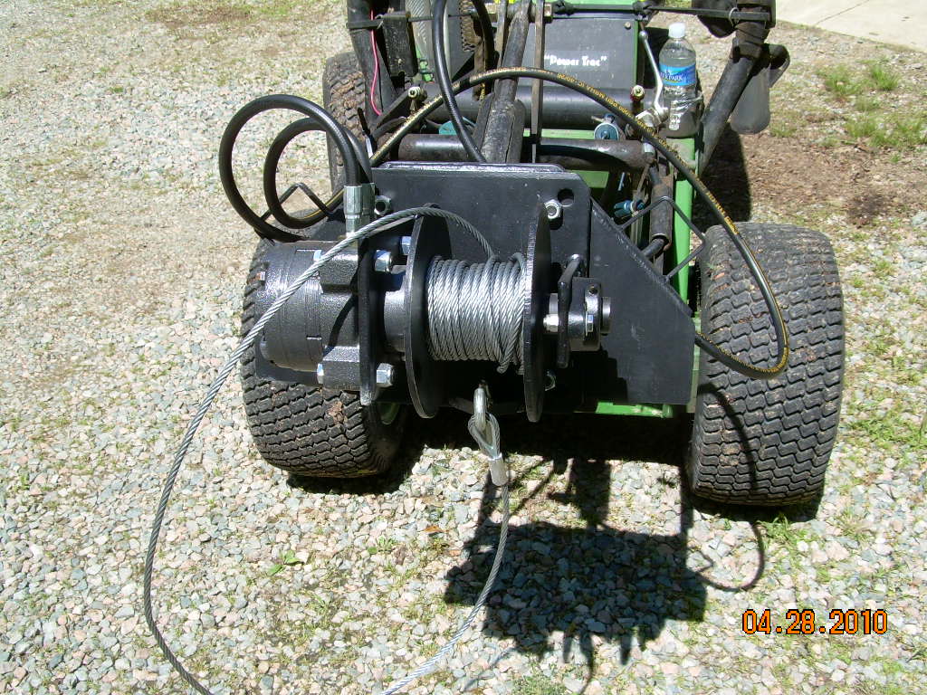

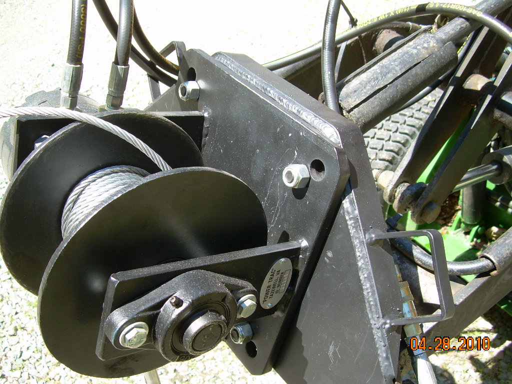

I got the PT winch for my 422 today. It pulls well, but I have a few issues and also want to be able to winch from the back. I don't have solutions for all of the issues. So I guess I will need some help.
I took a few pictures.
1. There is no freewheel mode on the winch. You have to hold the Aux PTO handle to winch in or out. I tried tying the hoses together with some fittings I had. This works, but you have to put a lot of force on the cable to overcome the motor. I really need suggestions for this one. On the picture on the PT web site the motor drives the winch through a chain. On the winch I got it is direct drive. I expect the picture is of the older winch rated at 5 tons, not mine rated at 2 tons. There may be enough room on the spool to unwrap the cable. Do able, but awkward.
2. I need to tow from behind as well as from the front. I plan to connect it to my 2 inch receiver on the back and on the front. I will save the quick attach plate for another project. The winch unbolts from the quick attach plate, so it should be easy to remove.
3. The winch is pretty heavy. The box says over 70 pounds. I expect it's closer to 100. Of course removing the quick attach plate will help.

OK.. Wait.... Direct Drive? What kind of motor are they using?
And 2 Tons? You expected a 5 ton?

The motor is reversible. Maybe there is some type of valve you can get to tie the lines together when engaged so you can free spool the motor? It would require a valve and probably two more hoses and fittings. Look around the surplus center website, or just give them a call and ask the questions. They are very helpful over there.

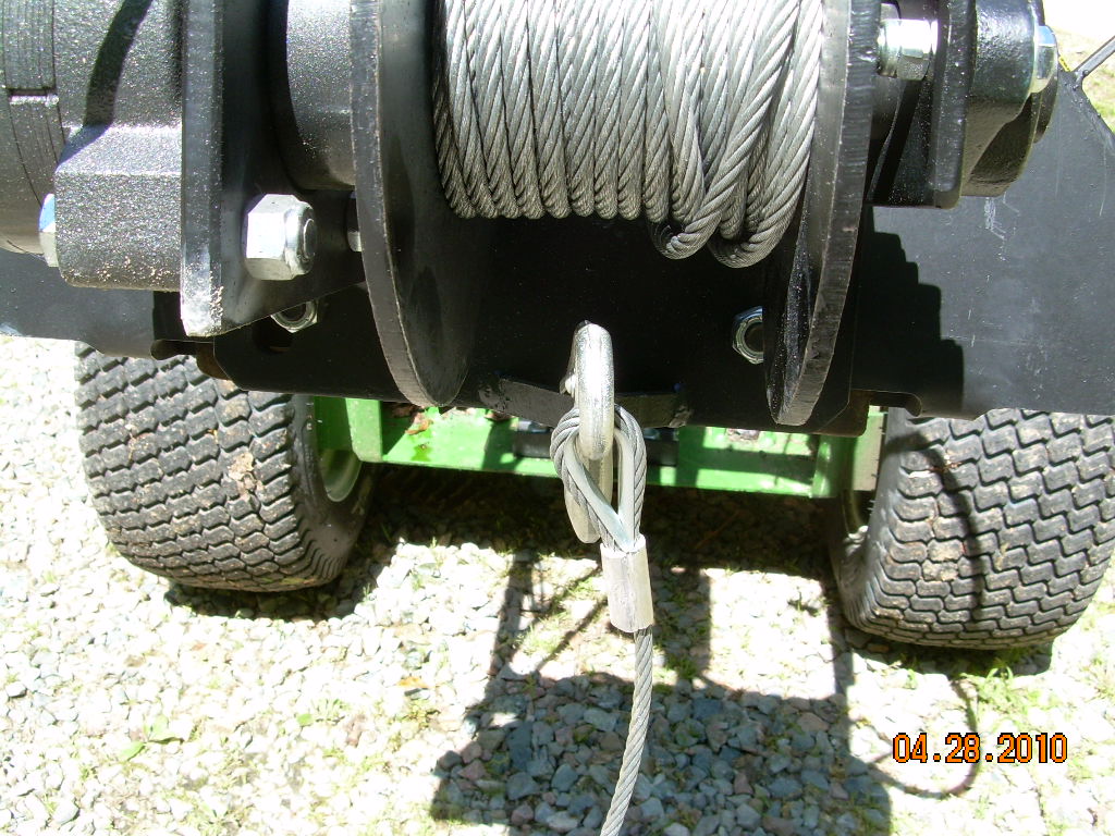

Boy, that's some big, stiff cable for 4,000 lbs. I'll bet it's the same cable that they put on the larger winch...
Looks easy enough to remove the QA plate, for sure...
One of my concerns would be the fact that there's no fairlead on it -- it could really make a snarl out of that cable if the winch isn't pointing directly toward whatever you're pulling...

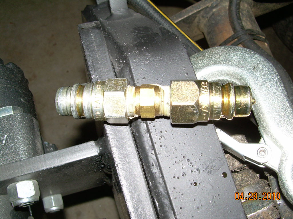

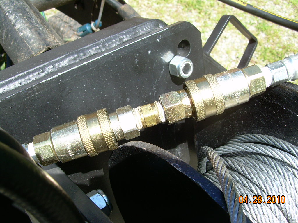

Moss, I put a coupling between the hoses to do what you suggested. I can now unreel the cable with about 100 pounds of force (just a guess). It would be easier to use a manual winch. If I put the bypass close to the motor it might help a little, but I don't think very much.
I sent a picture of the coupling. Two male connectors coupled together.

That cable is very big. I am with you, probably the same as the larger winch.
Would it make sense to put a fairlead on it? I am game if it is available and you guys think it is a good idea.

For cable pull out/freewheeling, you could attach a gate valve across the hyd motor, and open the valve when you want to freewheel the cable/drum.

J_J, I tried what you suggested for freewheeling and it works if you can pull on the cable with about 100 pounds of force, and it's slow. Just not very practical.

I got a fair lead from Northern Tools today. It was in the discontinued bin. After doing some research I can really see the need for one.
