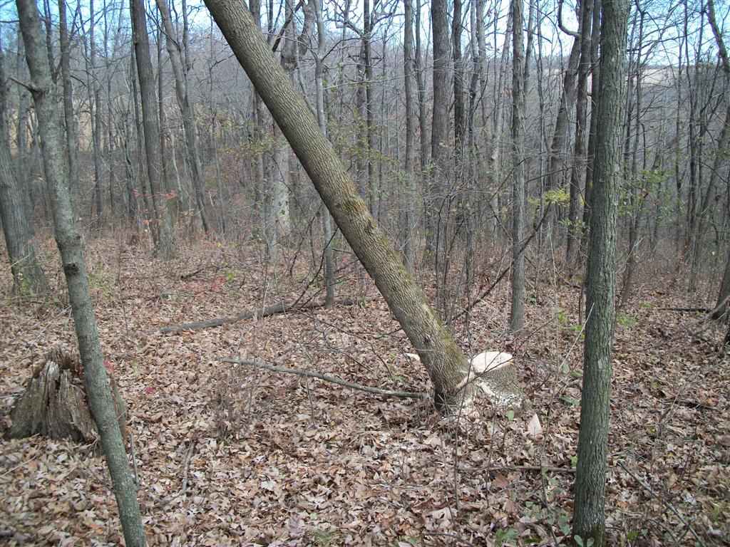

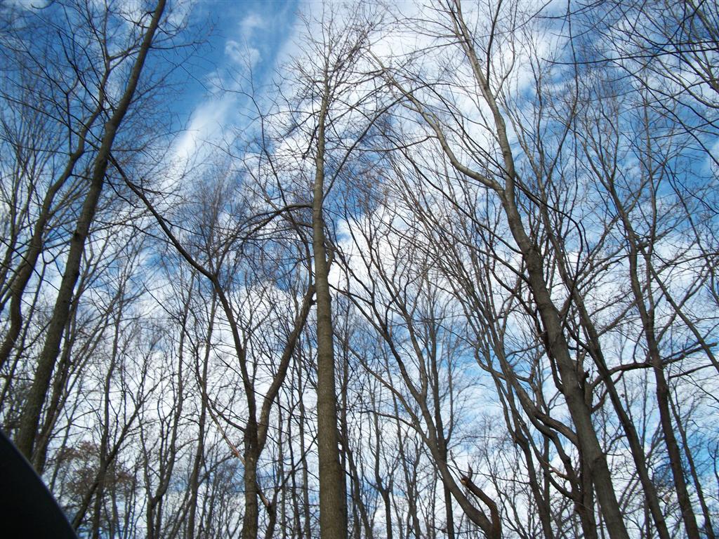

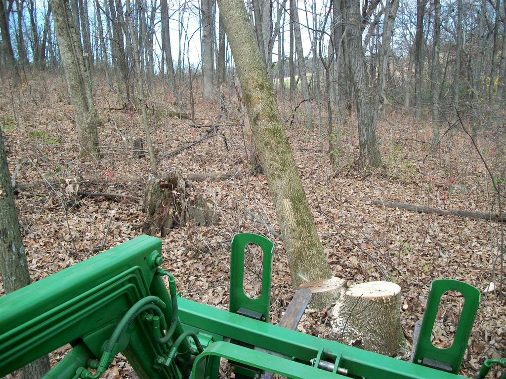

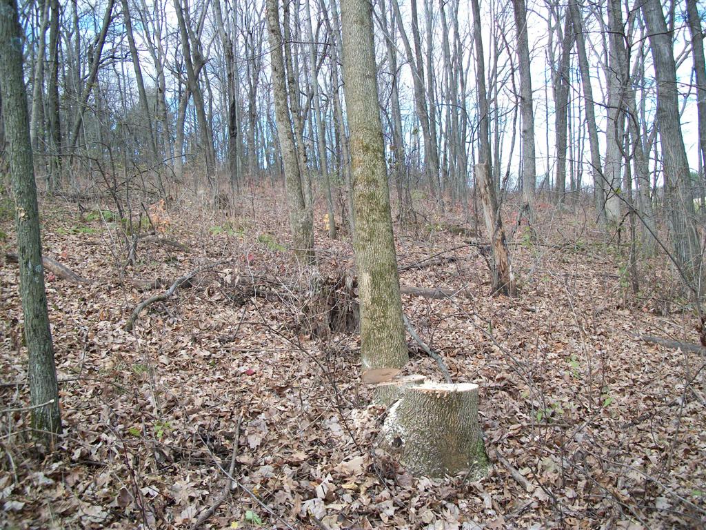

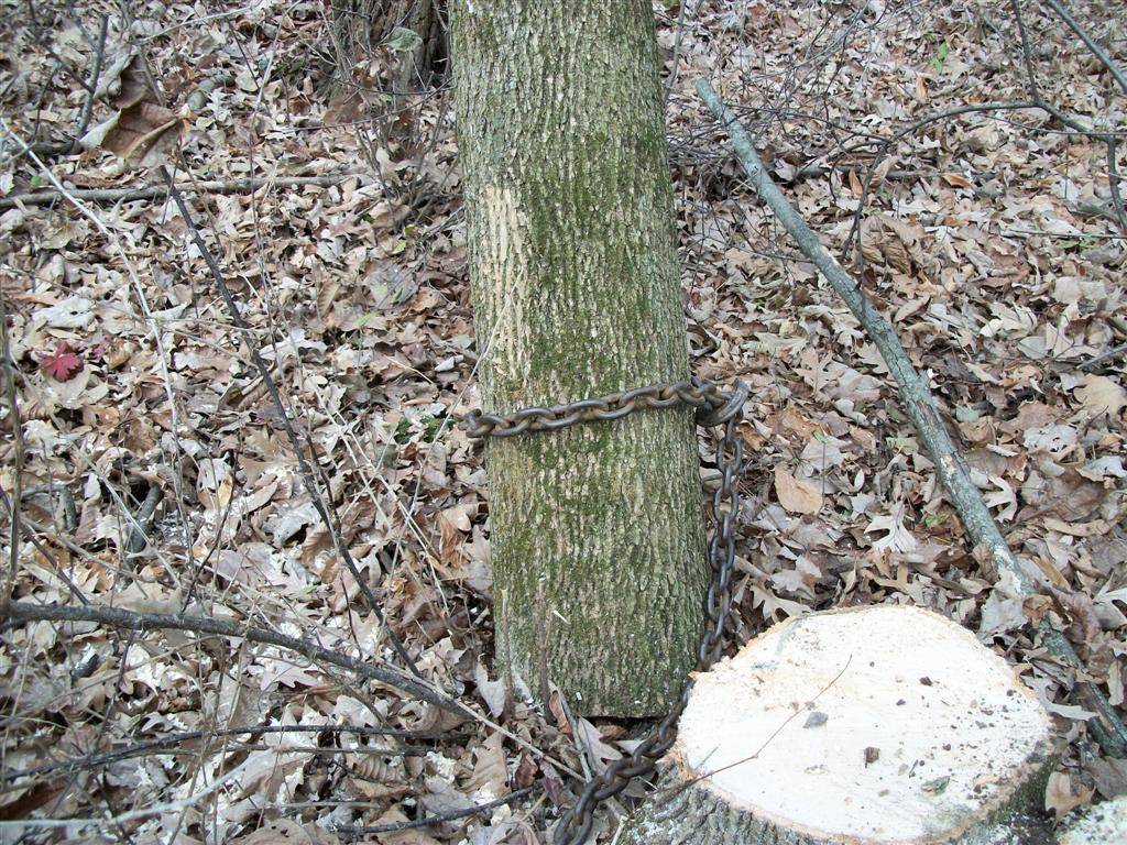

In the woods this morning cutting some ash trees, and one hung up (not enough weight in top to push down through the canopy). Took some pics of getting it off the stump (with forks), and pulled out of the crotch of the tree that was holding it with log chain.

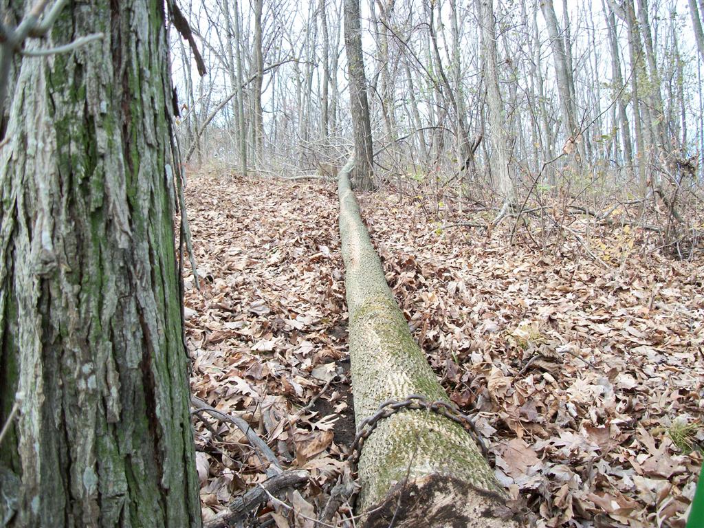

After pulling the ash tree out, it was bucked to 90" lengths to carry out on forks to log pile awaiting bucking to 18" and splitting (then stacked on pallets for drying).
