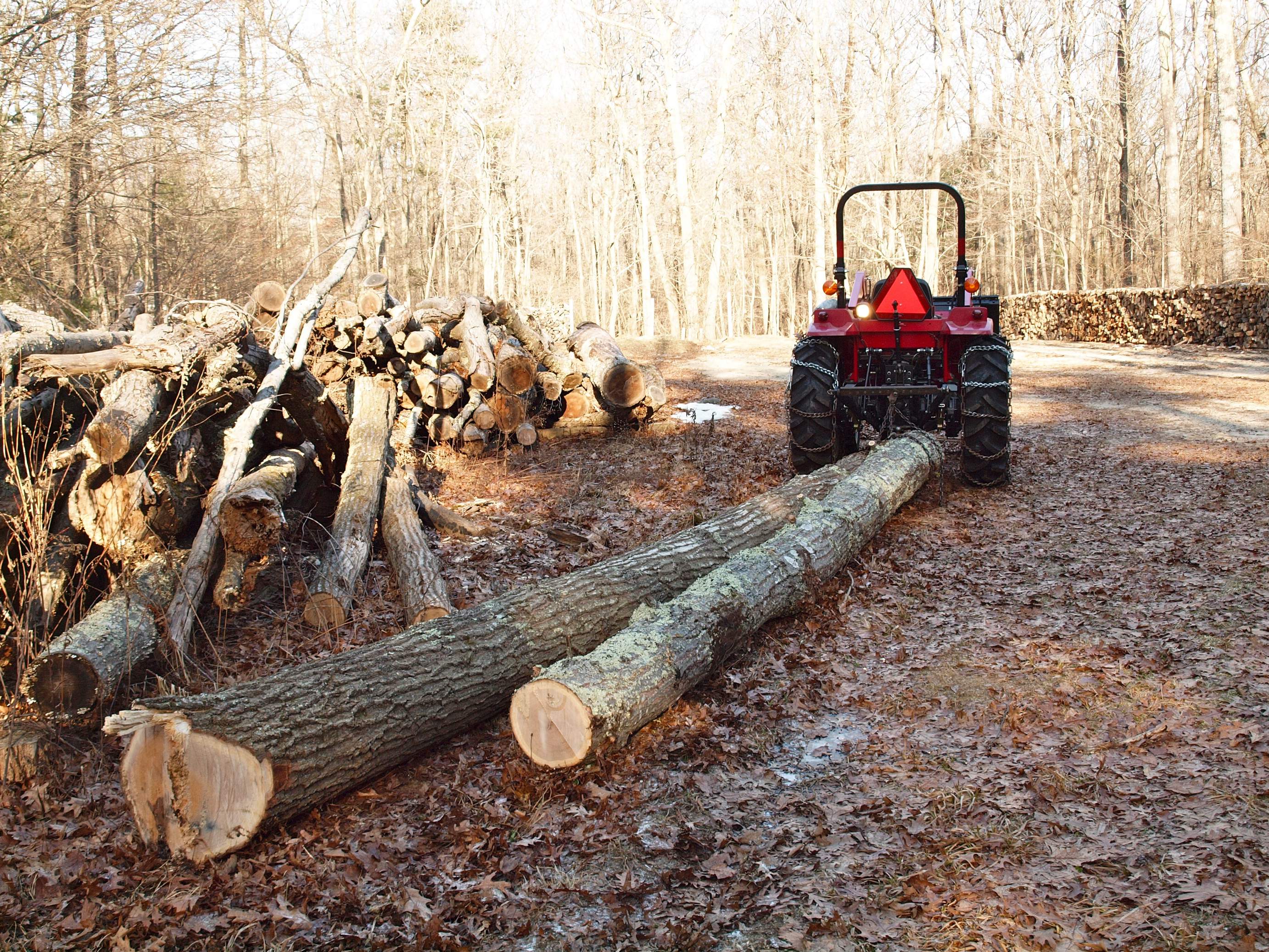

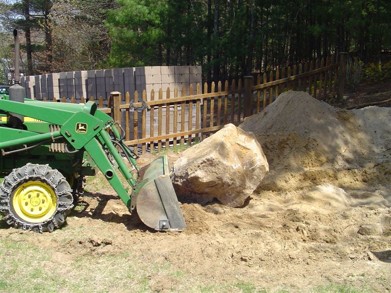

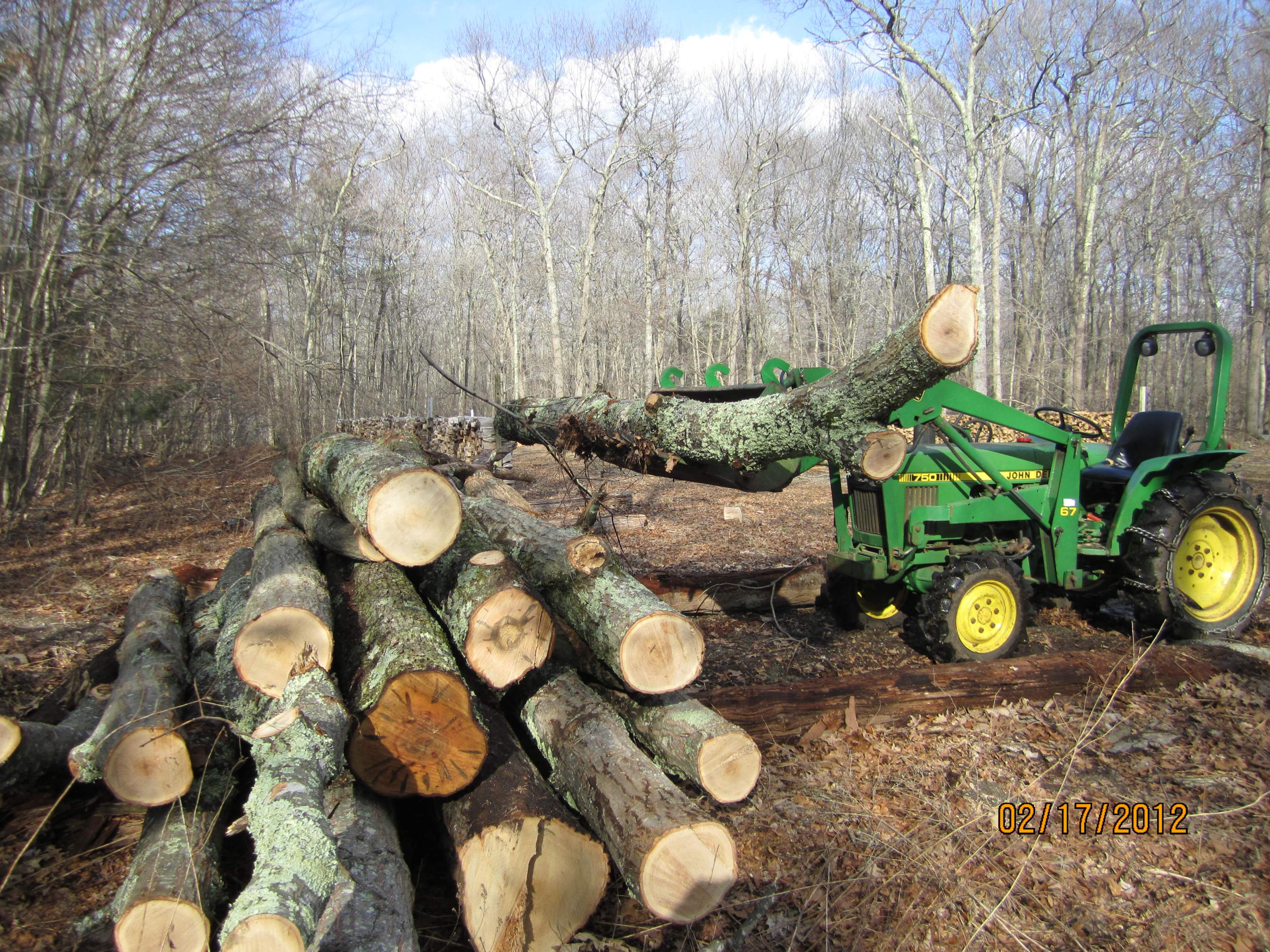

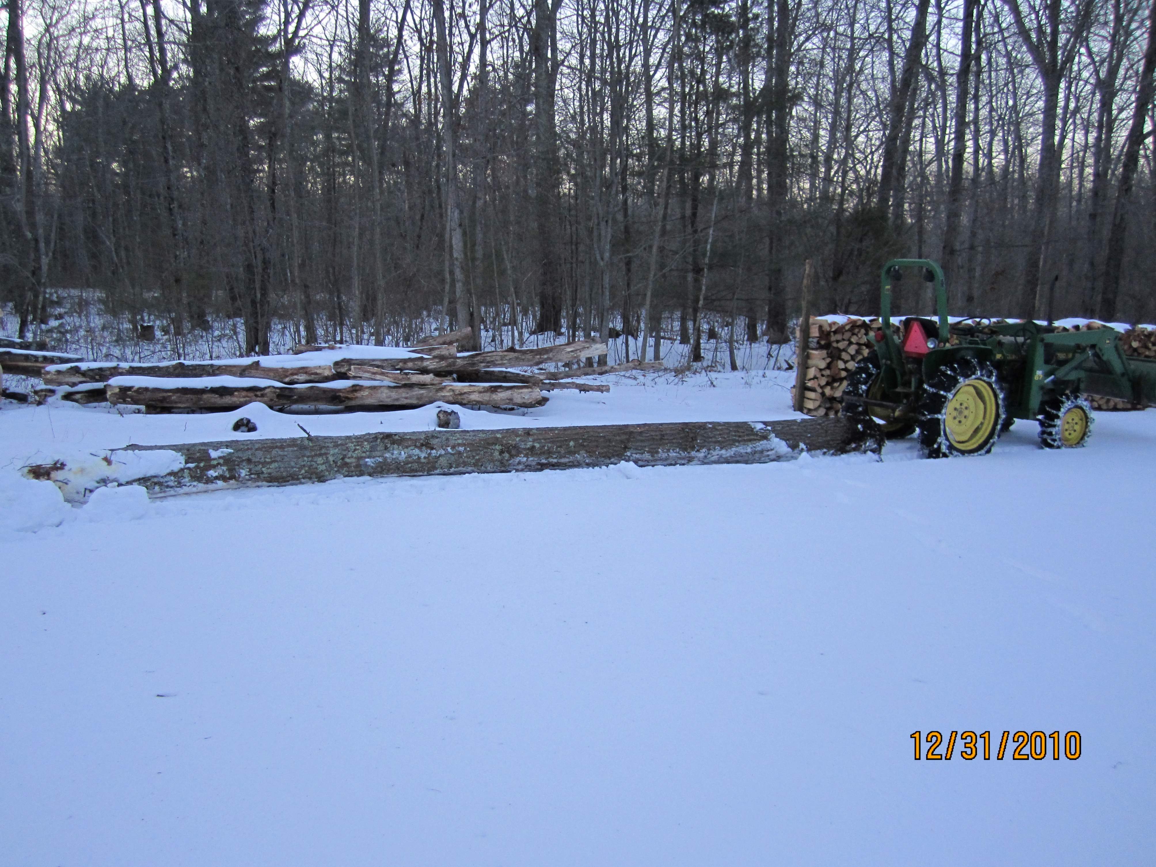

Heck, I made out with 17 hp for years. It is more about traction and weight. I never ran out of HP as I cut no grass. The 3016 I have now is 3 times faster than the JD 750 for logging. Not because of HP but because it weighs a thousand lbs more than the JD did and has taller tires for better traction.The JD would only pull one of these logs out of fresh cut oak. With the 16, this load is a breeze. The JD did a ton of work such as snow removal, logging, putting in a riding arena, digging out hillsides for retaining wall work. It even pulled out a Camry that was nose down in a ditch near my home. The 3016 would have made all these tasks easier.
