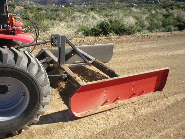

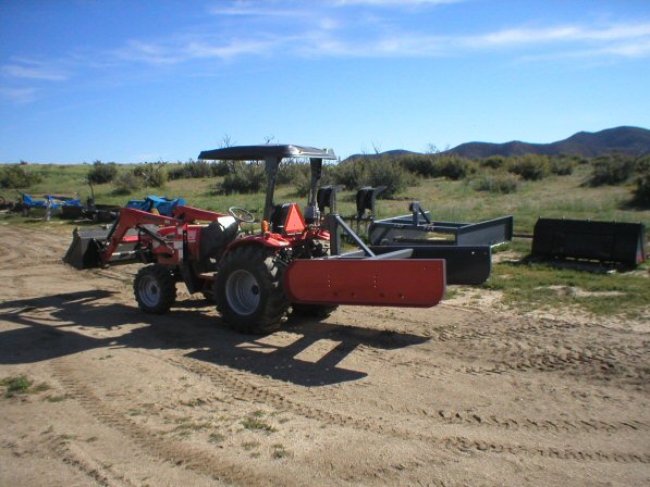

What elevation is your place at? I am not trying to steer you away from Mahindra, I have 2 of them and very happy with both. I would go with the 3616 myself unless you are up higher in elevation, then you really need something with a turbo and that probably means used. :(
Sounds like you are going to need quite a few implements to be able to get things done in a timely manner. The other consideration would be to go with a 4035 HST. Bigger machine, gets things done quicker, but probably out of the budget.
Down the road, you might want to get a LPGS to maintain that road. I have over a mile of road that gets used regularly and 1/2 of that is shared. I have 4 different types of implements that get used on it. (box blade, rear blade, LPGS and landscape rake) If I could only have one, the LPGS is the implement that I would have.

What is a LPGS?

I think it is land plane. Box blade is great for moving dirt and can be used for road maintenance. Land plane is great for leveling road (provide there are not embedded large rocks) but not for much else. I have both. I used to maintain our driveway with box blade but after I tried land plane I bought it and that what I am using now.

Land plane grading scraper. The picture. I personally would not even consider ANY tractor without a turbo at your elevation. You loose roughly 3% of your power per 1000' of elevation. So a 30hp tractor is only going to have less than 25hp :eek: at your place.

I disagree about a LPGS only being good for roads. I have used mine to even out acre sized areas many times. By far exceeds the capability of a box blade when the conditions are right.:cool:
