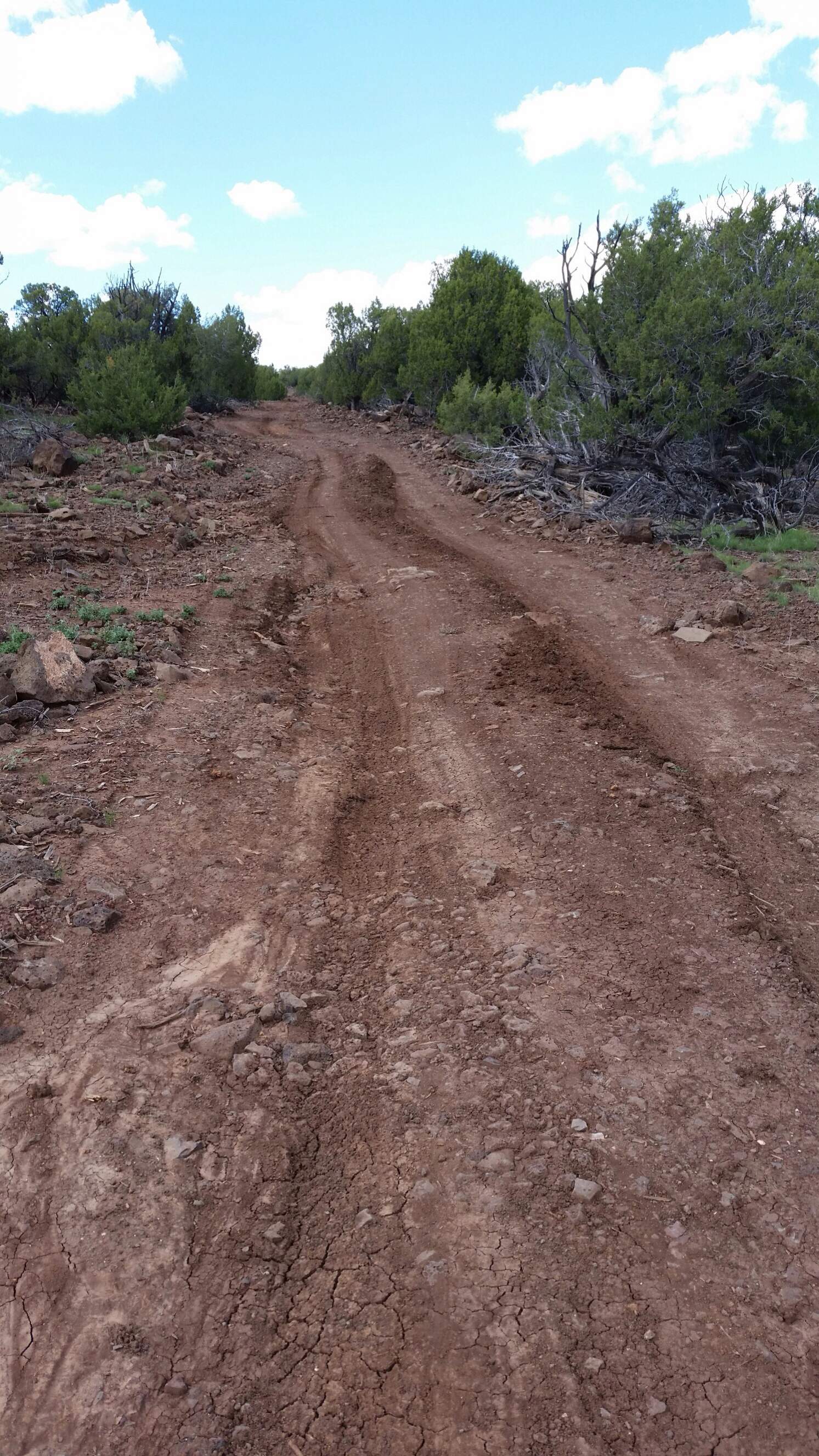

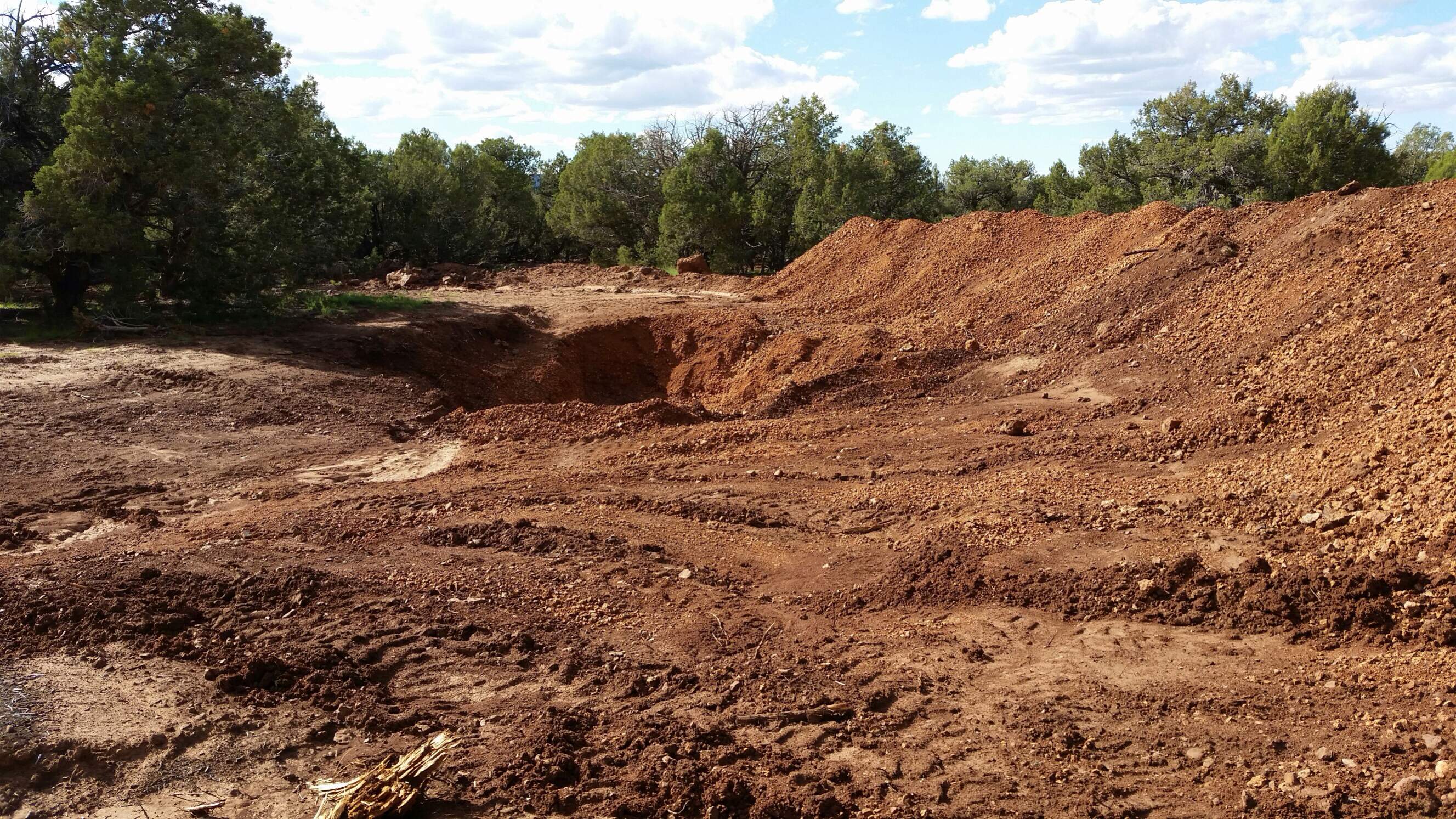

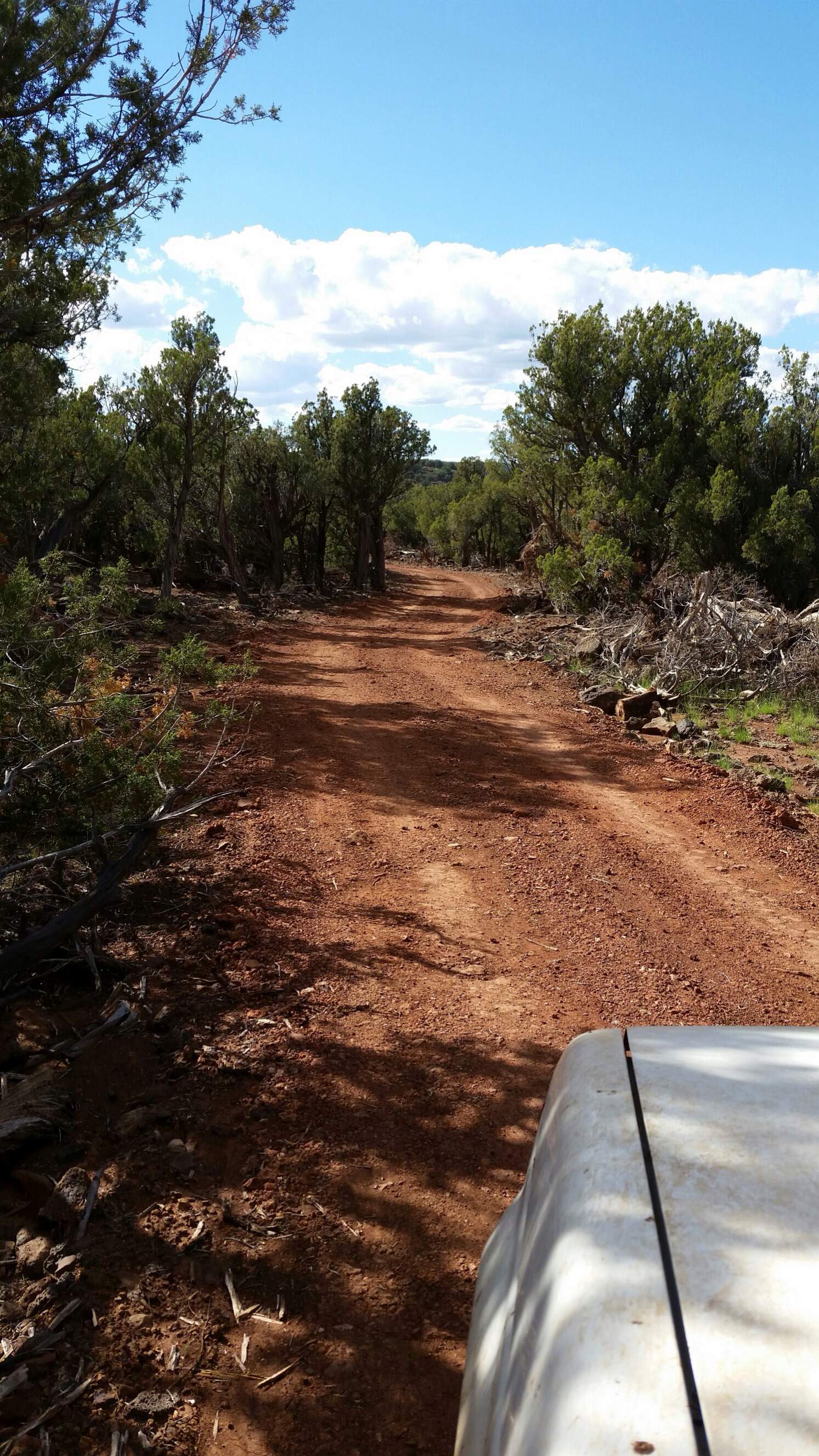

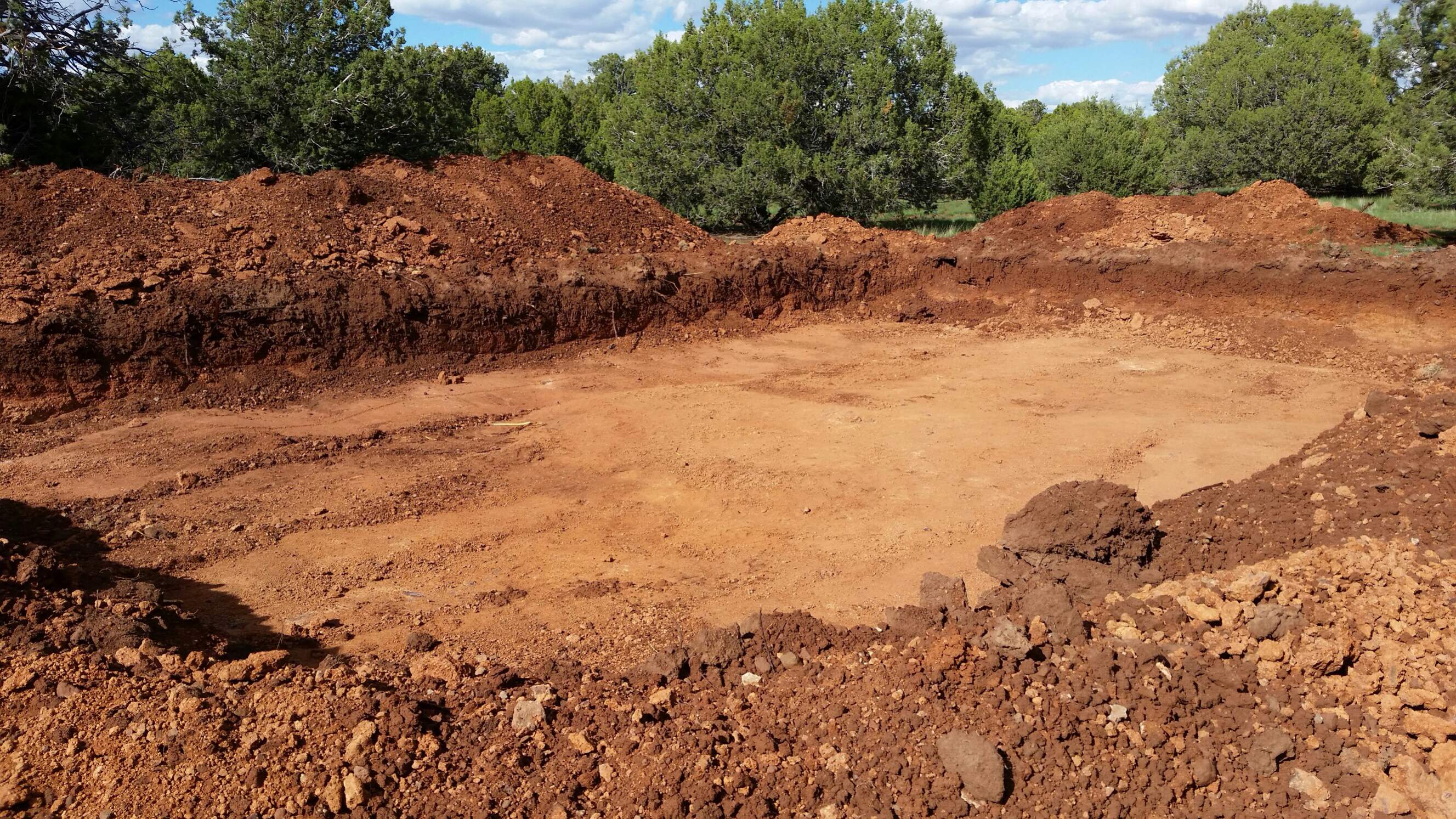

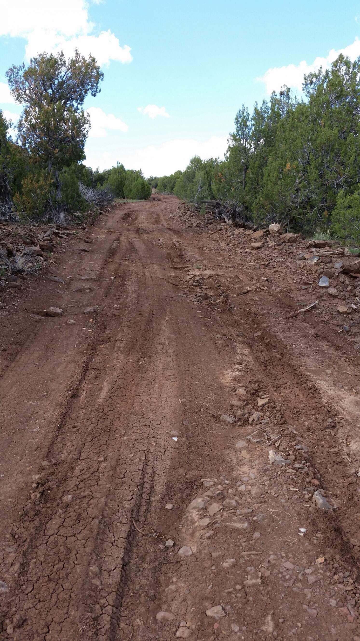

Here are some pics. The good the bad and the ugly. The rectangle hole is our pit greenhouse. I need to get that nice and level so I can start building it. The pond is a big work in progress. Looks like a cinder pit right now.
The road is a mess in many places and other places I just need to maintain. I need to dig a trench on both sides for drainage during our Monsoons. I also have to level out ground for our house and clear the ground in our orchard. That I believe just needs a blade.
I realize that bigger is better and easier and faster. However we have a budget and I do not mind whittling at the road and pond over time.
Bummed that there will be a noticeable difference with my elevation and the lack of turbo option with the 3016 & 3616, unless I can find an older one for sale. But, since I have never had a tractor before maybe I will not notice :D so stop reminding me :rolleyes:
