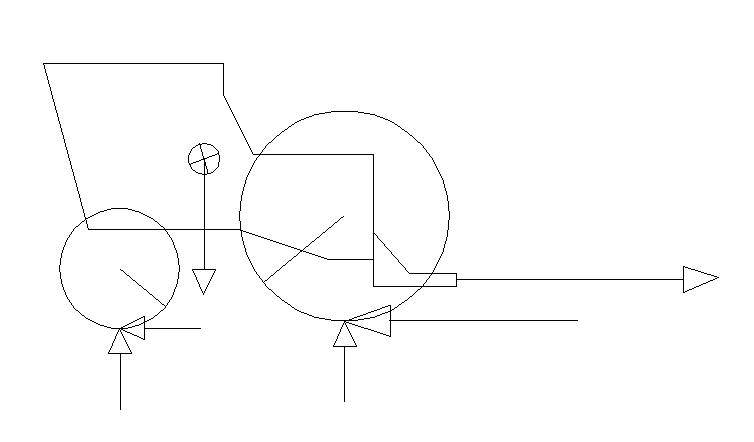

I want to say these discussions are a bit interesting. My background is Mechanical Engineering and Physics.
(Spyder, I see you just responded again. You strike me as having a handle on these things. That other thread about the 3PH "lift" capacity proved that to me in the end. What's your background?)​
Let me throw this out there to try to help with understanding... This can be broken down to a system of balanced forces and looking at the critical cases of impending movement.
The first illustration is of the only forces acting upon the tractor. Any question of the pulling action can be broke down into these components.
These forces are:
  1. Driving force on the tires, front and rear acting to propel forward, is a result of the axle torque of the machine.
  2. Drawbar force acting to oppose the driving force
  3. Gravity acting upon the CG of the tractor
  4. Support force on the tires acting to oppose the gravity force
That's it, nothing more. Talking about the torque of the axle just confuses the topic in that the only function of the torque is to produce the driving force on the tractors tires.
Now, look at the forces as they act about the pivot point of the rear tire contact patch (FXd). Sum the moments of these forces and that will tell you if you could get rotation. If the drawbar force is large enough, or more correctly the moment, the tractor will come to a point of rotation about the tire contact patch. Every force (it's moment) is trying to rotate the tractor counter-clockwise, except the drawbar force. Look at the drawbar moment as a function of the lever arm. The lever arm is always acting to rotate in a clockwise direction. Always. If the tractor is rotating, the lever arm is getting shorter and reducing the tipping moment.
This is the safety feature of a properly located drawbar; a longer and lower drawbar is quicker acting to remove the lever arm, and thus the moment.
You can move the "drawbar" force to a point below the ground to make a moment that wants to rotate the tractor onto the front tires. This is accomplished by a rigid attachment (3ph of appropriate geometry) effectively extending the machine to a point below the ground surface.
*Now the disclamer- this is not accounting for any theoretical dynamic transient situation where an axle torque could result in popping a wheelie, or a tire frozen to the ground :)
/ Why 4 Wheel Drive #94

/ Why 4 Wheel Drive #97
This thread has gotten real interesting and I always enjoy these types of debates:D
I agree with most of what spyderlk said and even some of what Jasg said.
After following this thread for a few days, here is my understanding of what everyone is trying to say.
Jasg: I think you are trying to emphasize that a tractor CANNOT flip backwards if hooked to the drawbar. I'll agree with this because it is true that the rears will break traction before a flip can happen, BUT...the fronts can come up a foot or so, as explained in one of the links with the remote controlled tractors. Which leads me to Spyderlk's position.
Spyderlk: Correct me if I am wrong but I don't think he's arguing the flipping of the tractor, rather the comment made about hooking to the drawbar putting downward force on the front end.
My understanding of this is that a drawbar, below the axle line, and a straight pull rearward, does indeed help to counteract the axle torque, but not stop it completely. It's about leverage, the drawbar is only about a foot below the CL of the axle. The tires are contacting the ground about 2' or more below the axle cl. The wheels have more mechanical advantage than the drawbar, therefor the possibility is still present to raise the front of the tractor. How far it raises is dependent on several other variables like length of drawbar, weight over front, traction, etc. In all reality, everyone knows that a tractor will break traction first, if hitched properly, but it DOES NOT add more weight to the front end, even if pulling in a straight line.
My conclusion is that traction, or lack of, is the only thing that keeps the front planted, not the hitch adding weight.
For sake of argument, take traction out of the equation. Say that the tires absolutly could not slip no matter what (like frozen, or poured in concrete), hook tractor to something with the drawbar, and put scales under front tires and see what happens. (This is just a hypothetical situation, I hope no one is dumb enought to do this)
