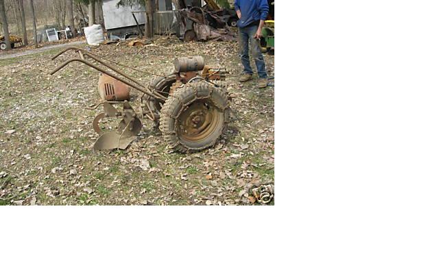

JasG, jagyzf, and SPYDERLK: I appreciate the discussion you guys have been having. It is as good a discussion as I have seen yet on TractorbyNet.
I think JasG and jagyzf did such a good job explaining it, that I am free to play with the problem mentally like a little kid instead of trying to explain. (I can't explain worth a darn anyway.)
SPYDERLK said:
"The tires apply force rearward and the axles apply the same force forward into the tractor body. Force resisting motion of the tractor [for acceleration or pulling a load] has effect based on where relative to the ground that force is applied. That resisting force is applied at the tractor Center of Mass [pretty high]for acceleration or when climbing hills. It is applied at the level of the hitch point when pulling a load at steady speed. Accel and/or a hill will still increase the tendency to tip back regardless of the hitch level because of the high COM."
Let's make the tractor simpler. A David Bradley tractor is actually a good model for the hitch attachment question.
This simplifies the COM issue considerably, and I hope it helps clarify the issue a bit. The center of mass issue is mostly gone, but the implement attachment issue still remains.
