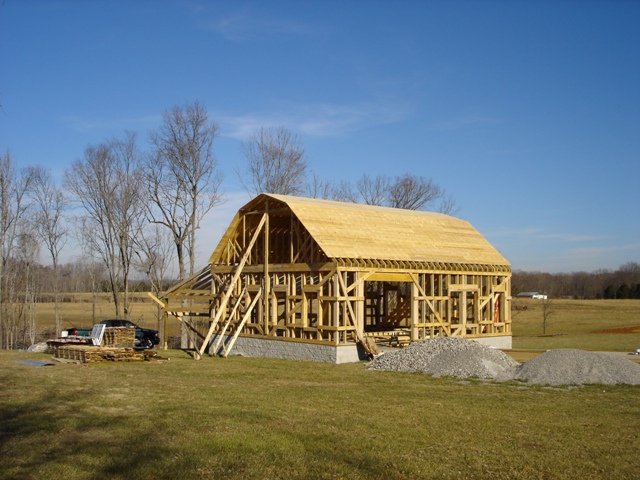

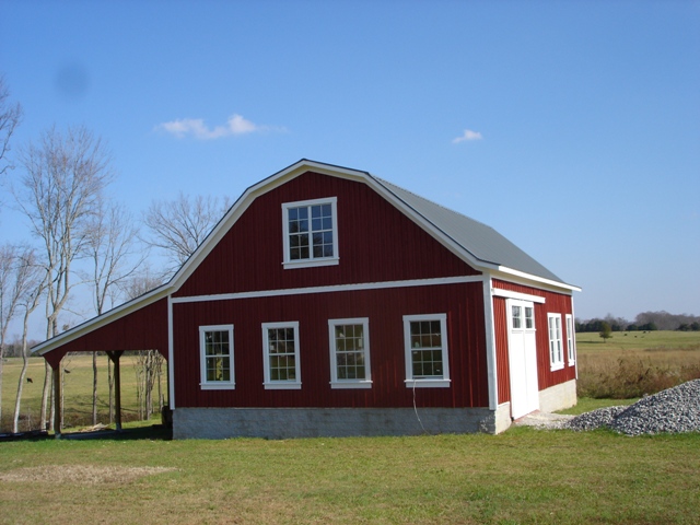

That's mine :)
Sorry if I deadeant post picture in the order I built it .

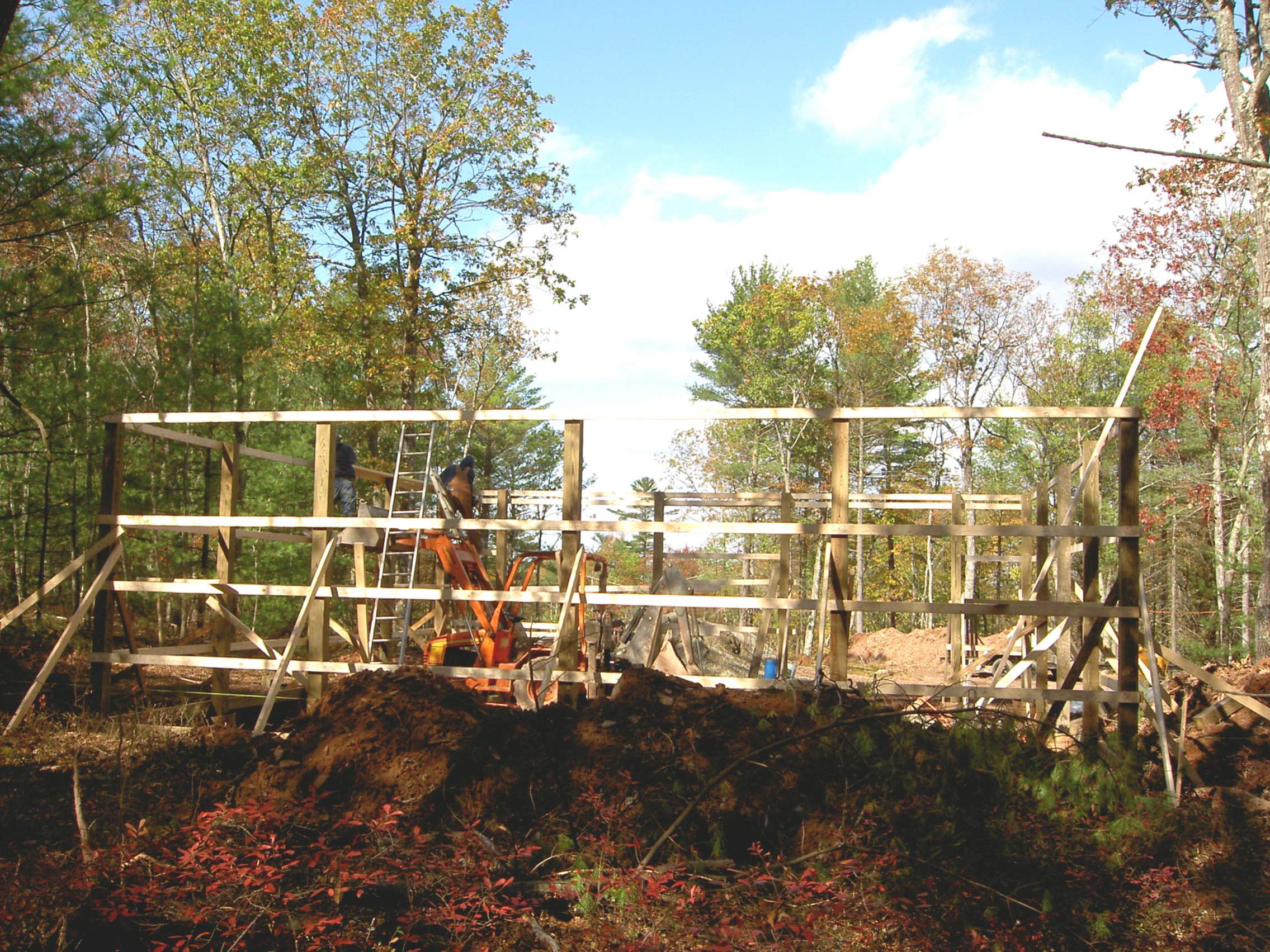

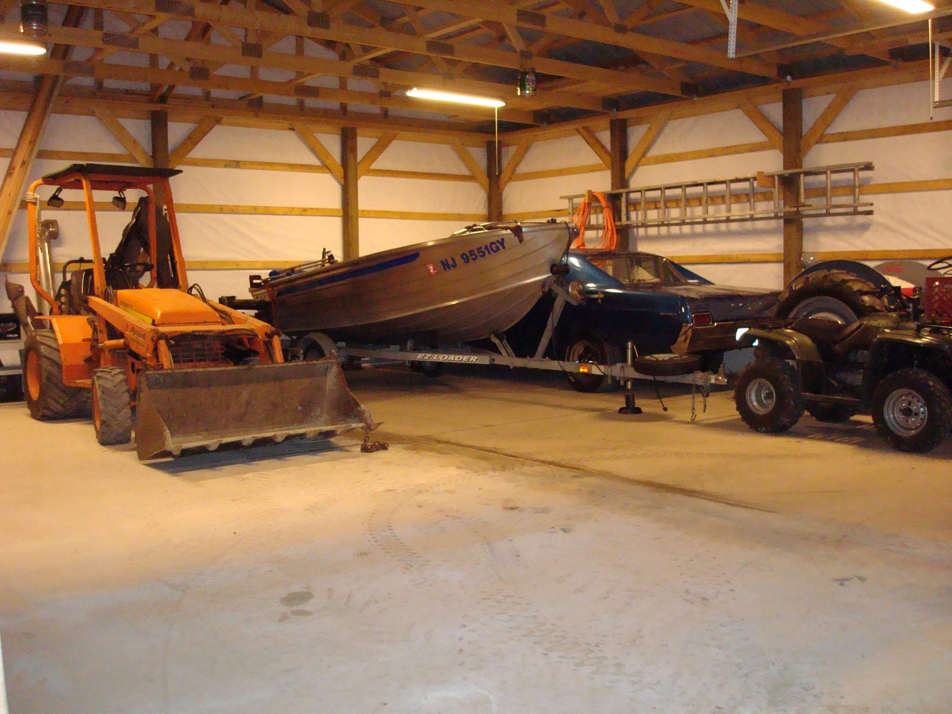

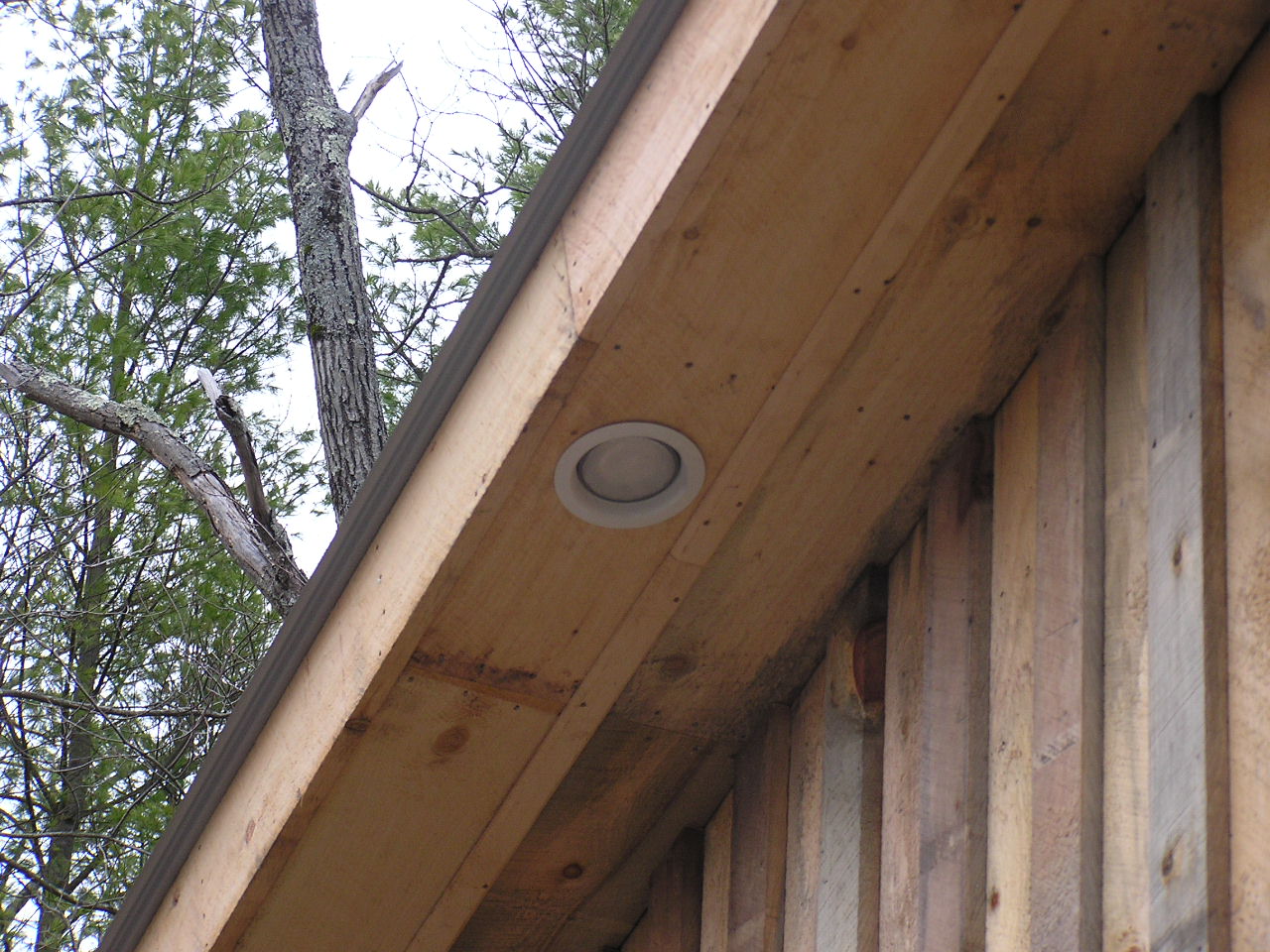

I may be in the minority here, but I say go for it. My wife and spent about 6 months and built every bit of ours by our selves. It's 32 x 40, 3 bay barn that I originally built to store our possessions while we built our house. It later got turned into my wood shop - fully insulated, electric, water, radiant heat in the floor. It is'nt that big of an undertaking, so long as you have time. Our time was limited to weekends and evenings, and we still had the shell up in about 3 months, and completely finished in another 3 months (with a year in between building the house). Here are a couple of pictures including a finished shot of the interior:D PM me if you have any questions and I'll try to answer.

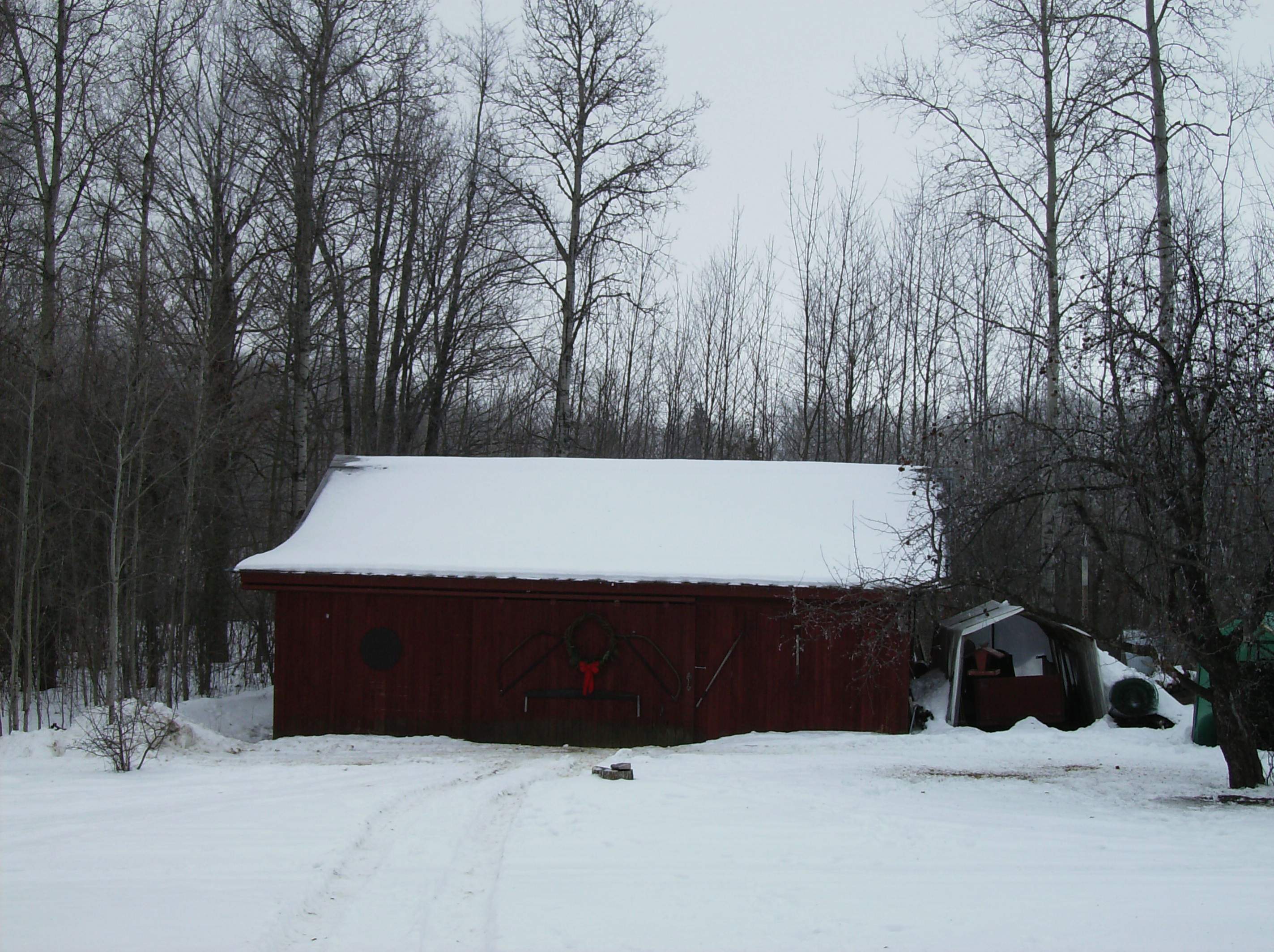

Great looking buildings guys. I made a small barn/shed when we first bought our place. It all started with some trusses and barn siding that I got cheap (really cheap) at an auction sale. .......
This is 32 x 32 and built with scraps (disassembled shipping crates from my work) and auction lumber. I had to buy some wood, but even the roof is used. It did take a long long time I do admit but I love buildiing stuff so I did not mind that. Also, we just bought the place and money was tight tight tight.
The whole thing cost me less than $3000 (to give you an idea all the siding plus more I still have in storage was $80. The trusses were $125.
Here is a winter shot to remind us all of what is coming!
NOTE: Errors I made. Roof on door is too low. Didn't put up a heavy enough header and had to go back and reinforce. Used tin on the roof will eventually have to be replaced with new.
