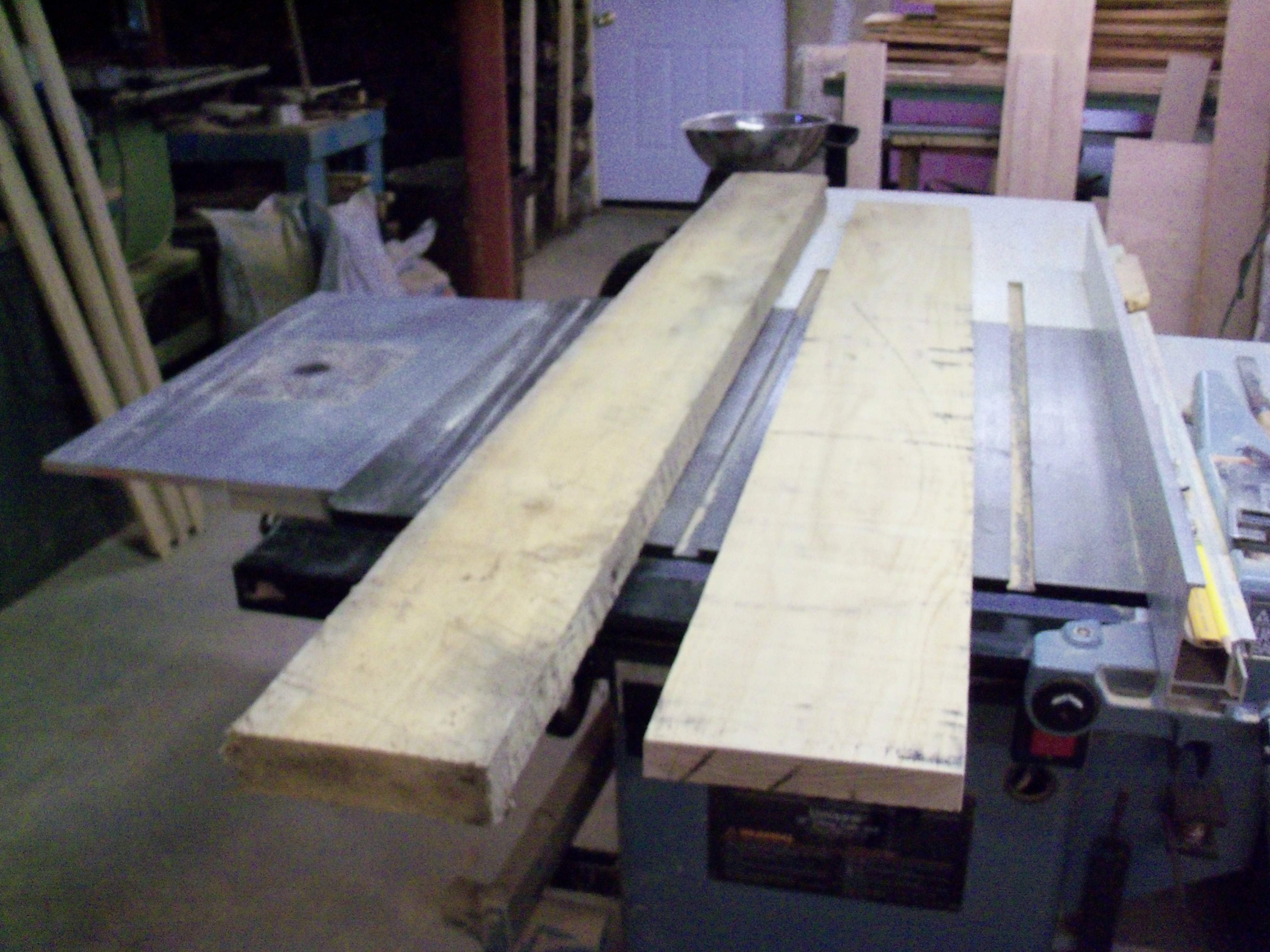

Knowing my rough dimensions, its time to go to my local saw mill to get things rolling. I like to purchase my lumber and then leave it in my shop a couple of weeks before I even start milling things up so it can acclomate to its new enviroment.
The trip to the saw mill is allways fun, but you have to have plenty of time to properly select your lumber, I never go when time is an issue...
Here is a picture of what the rough lumber looks like before I start milling it up. The board on the left is 8/4 stock for the legs, and the other board is 5/4 stock used for the top...

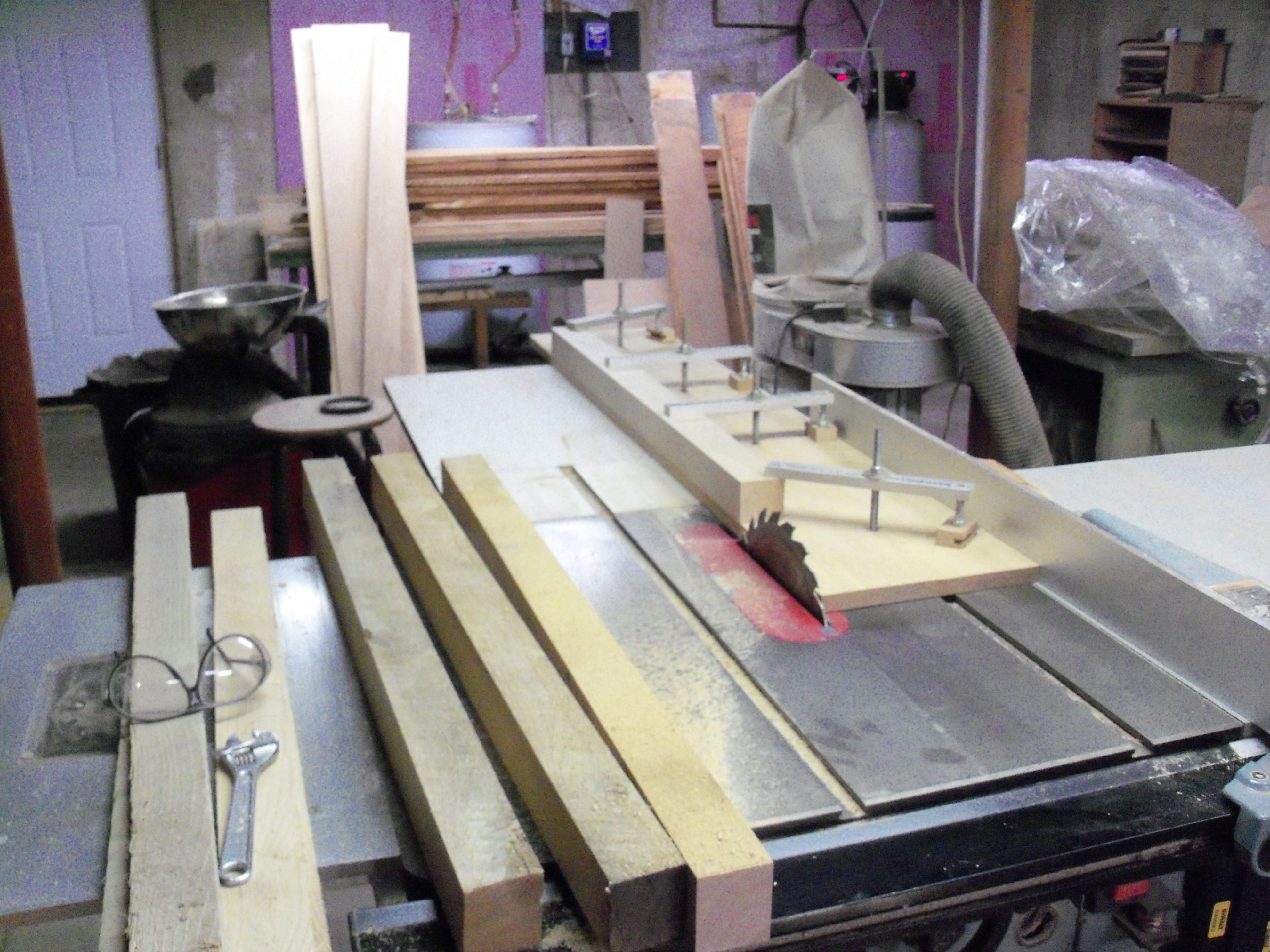

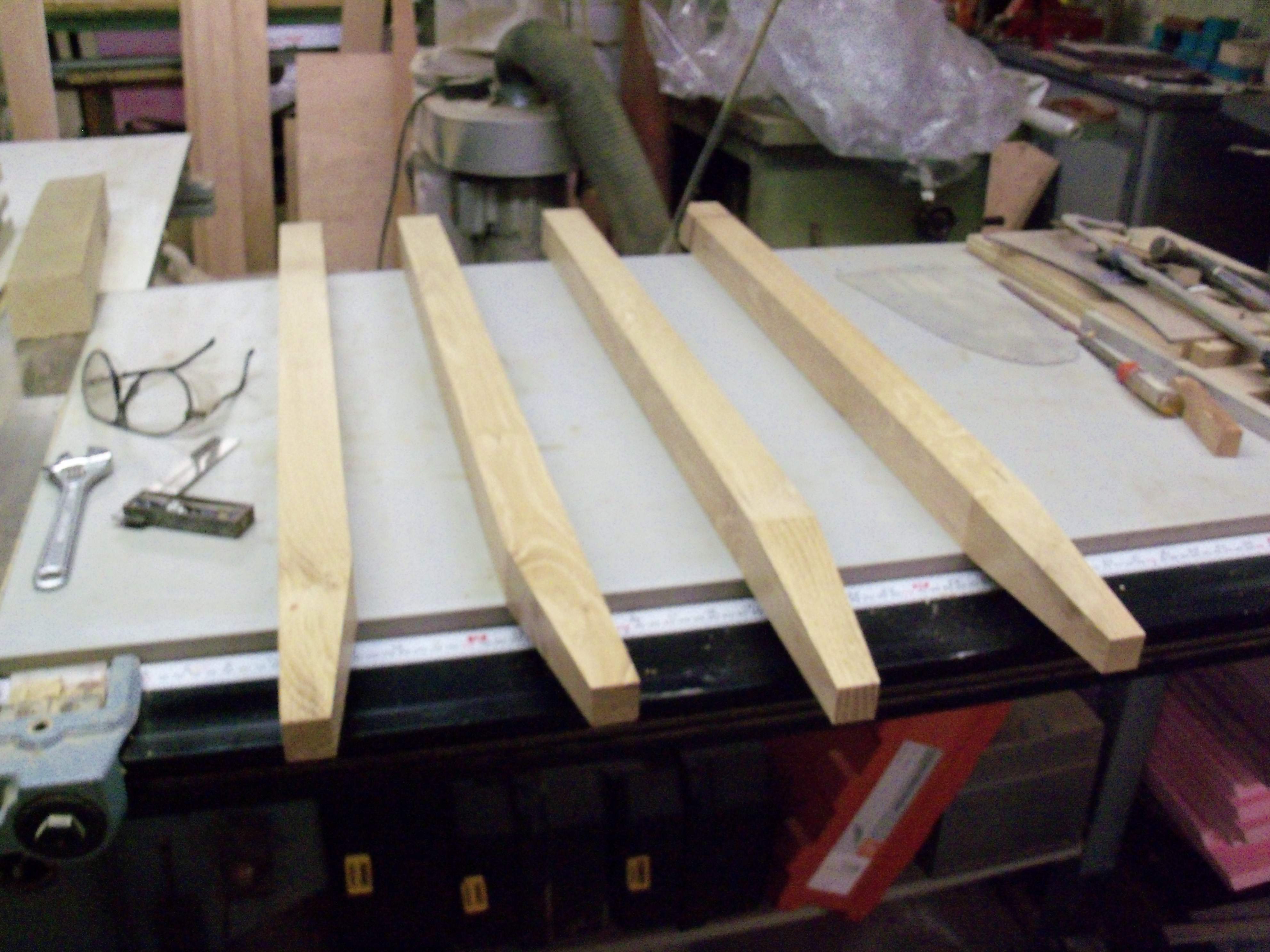

Anyway getting back to the table. I started rough cutting the stock for the legs. The finished dimensions will be 1 3/4" sq by 35 1/4" long. I rough cut the legs, 2" sq by 38" long to start and then get one side flat on the joiner, then I plane the thickness to 1 3/4" thk taking equal amounts of stock from each side of the leg. I then go back to the joiner and square the rough side to the previously finished side. And repeat the process over again to get my 1 3/4" sq.
I leave the legs a little long in case I get some checking on the ends, small cracks from the drying process. After getting the legs to the proper length, I made a taper jig, so that I can put a short ,7deg taper on the bottom inside edges of all four legs, 6" long.
You can see in the picture that I made a jig for the table saw so that I can start squaring up the leg stock.

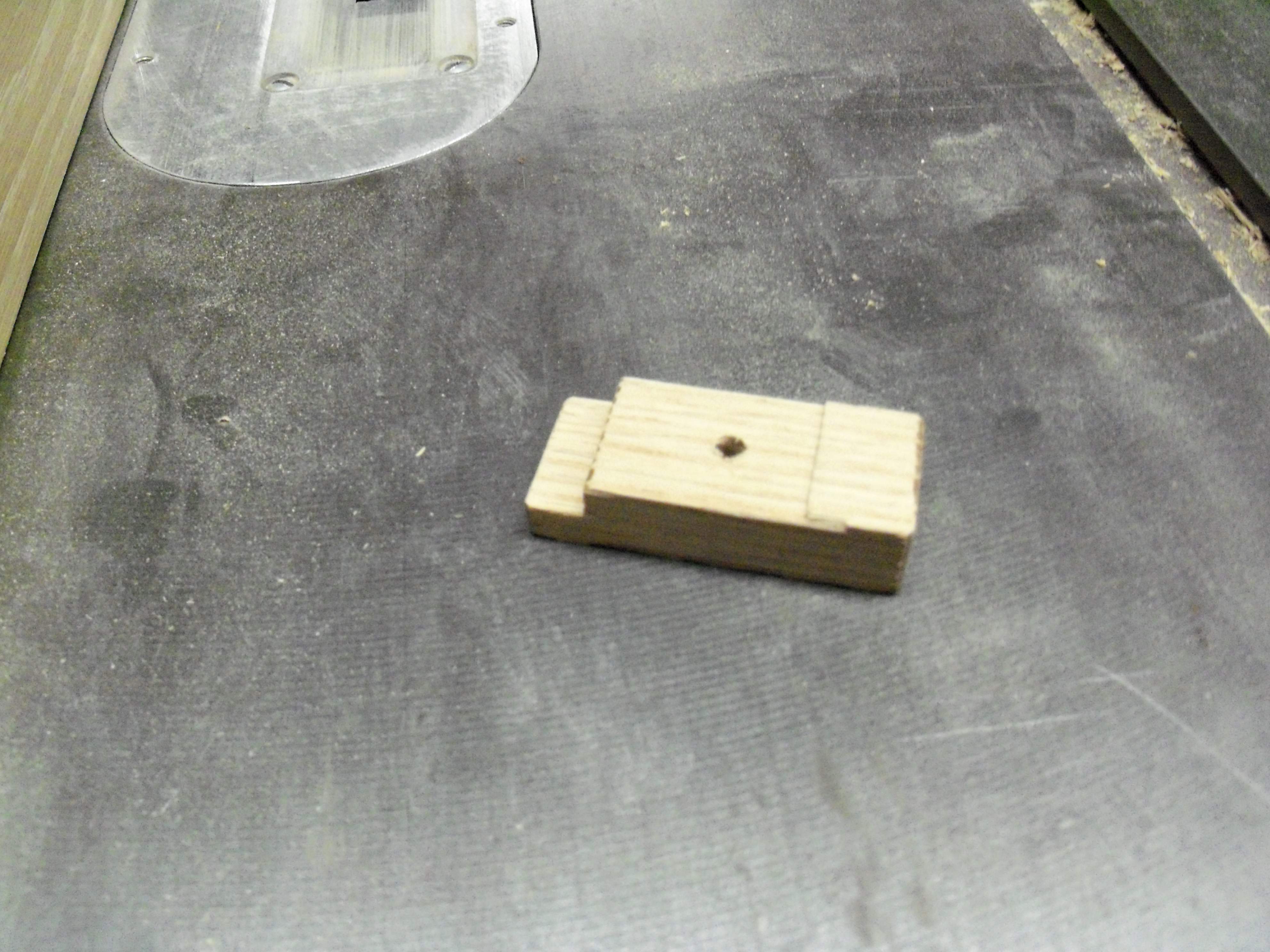

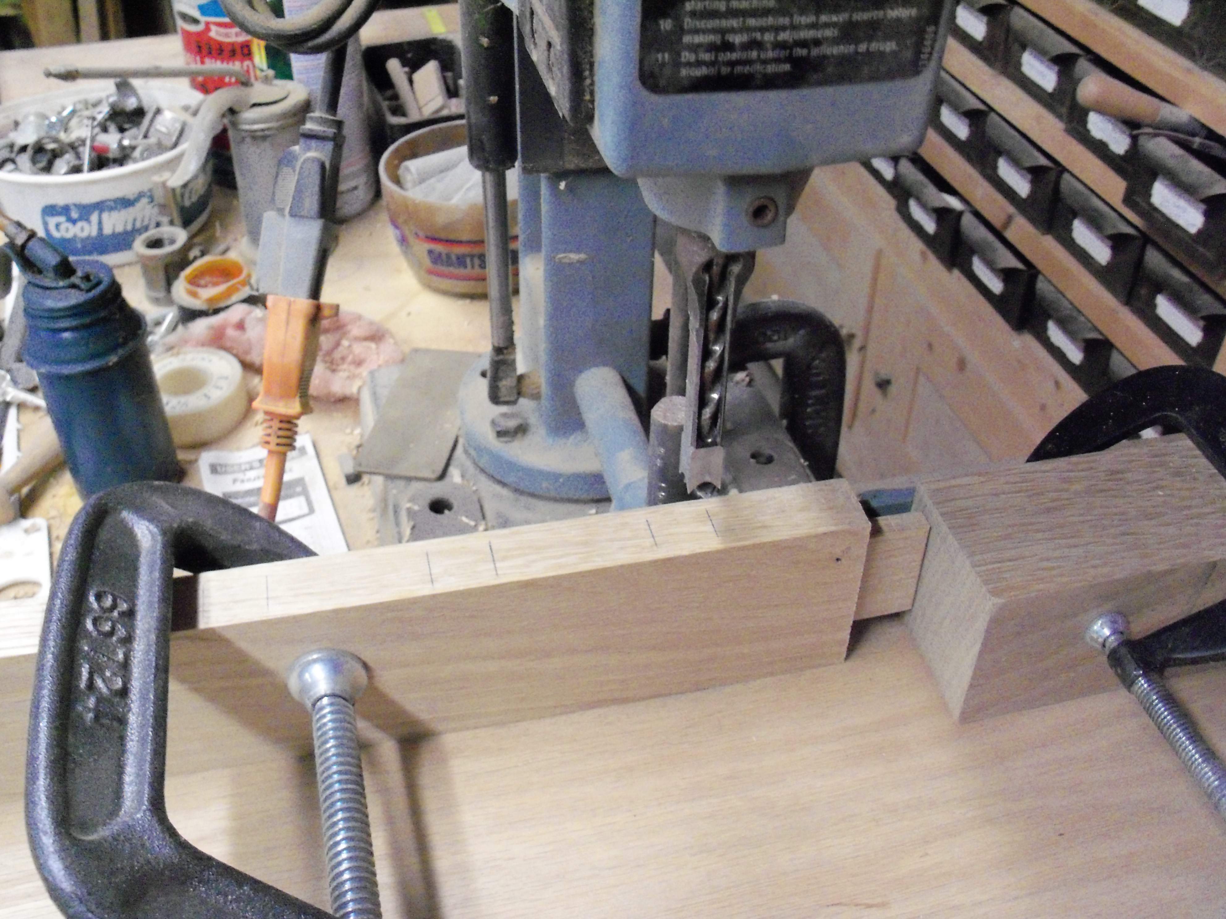

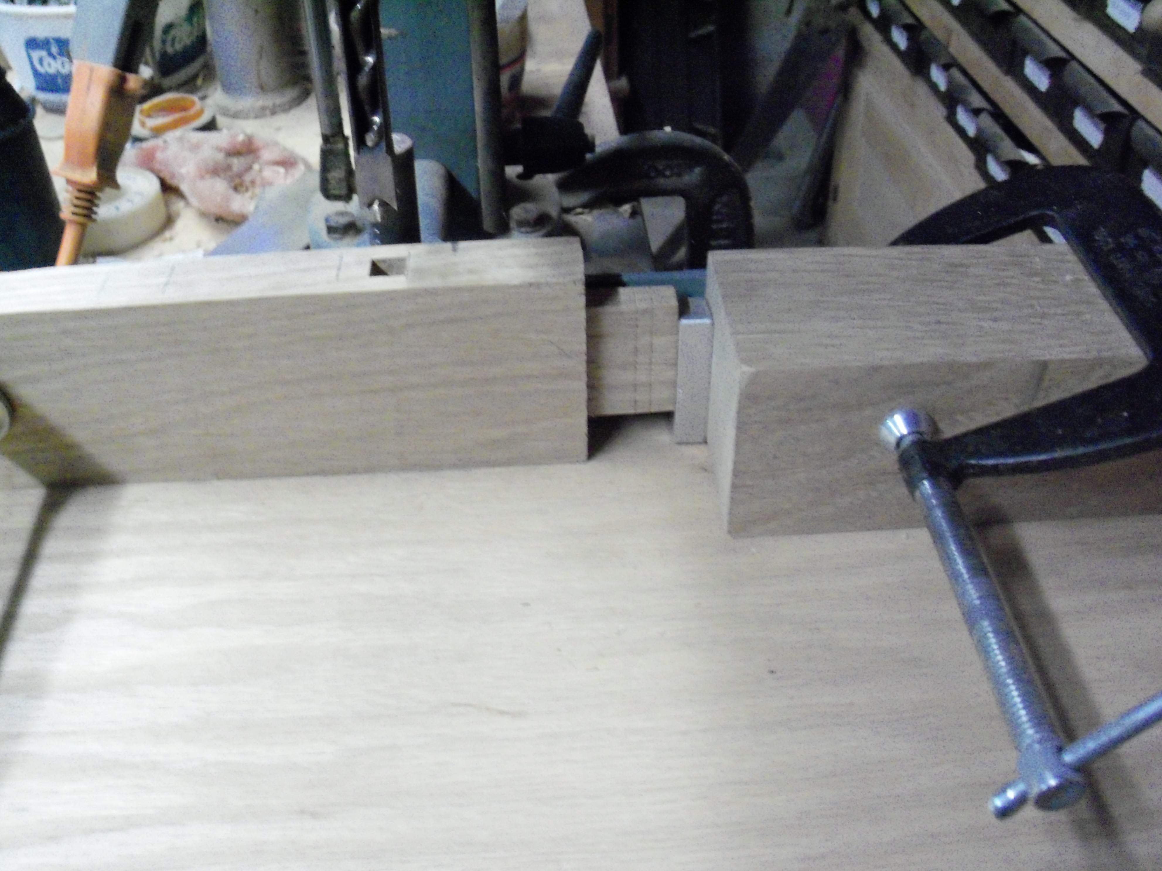

I used to cut all my mortises with a jig and plunge router for years but I finally broke down and bought a bench top Delta mortiser a couple of years back. As long as the mortising chisels are kept good and sharp, this little unit works great.
The rails are going to finish in thickness at 7/8", so I layed out the mortise locations, so that when the rails are assembled to the legs, I will have an 1/8" reveal between the edge of the leg and the rail.

I cant empathize enough on the importance of getting in the mindset of constantly using stops when trying to make duplicate parts. Whether they are table legs, table rails or cutting mortises, no matter what your doing, they all have to be the same length. This will make the project go so much smoother... :)

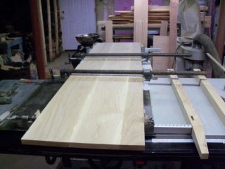

Heres the only picture I can find of the table legs with the mortises cut allready, sorry.
In this pic I had allready milled up the boards for the table top and glued and clamped it all together.....

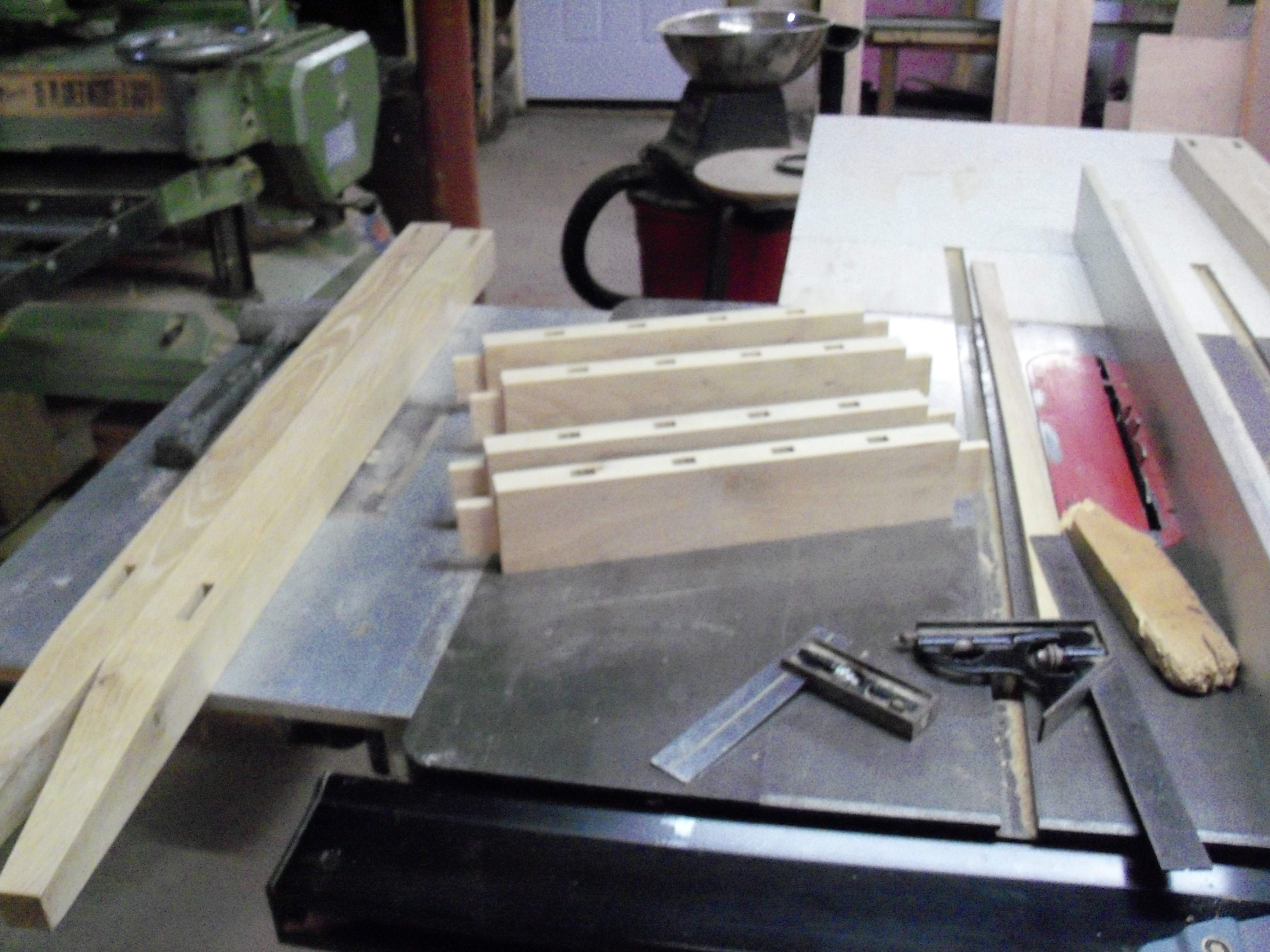

The first pic is the end rails, tenons done,and the four mortises allready cut in the top and bottom for the slats...

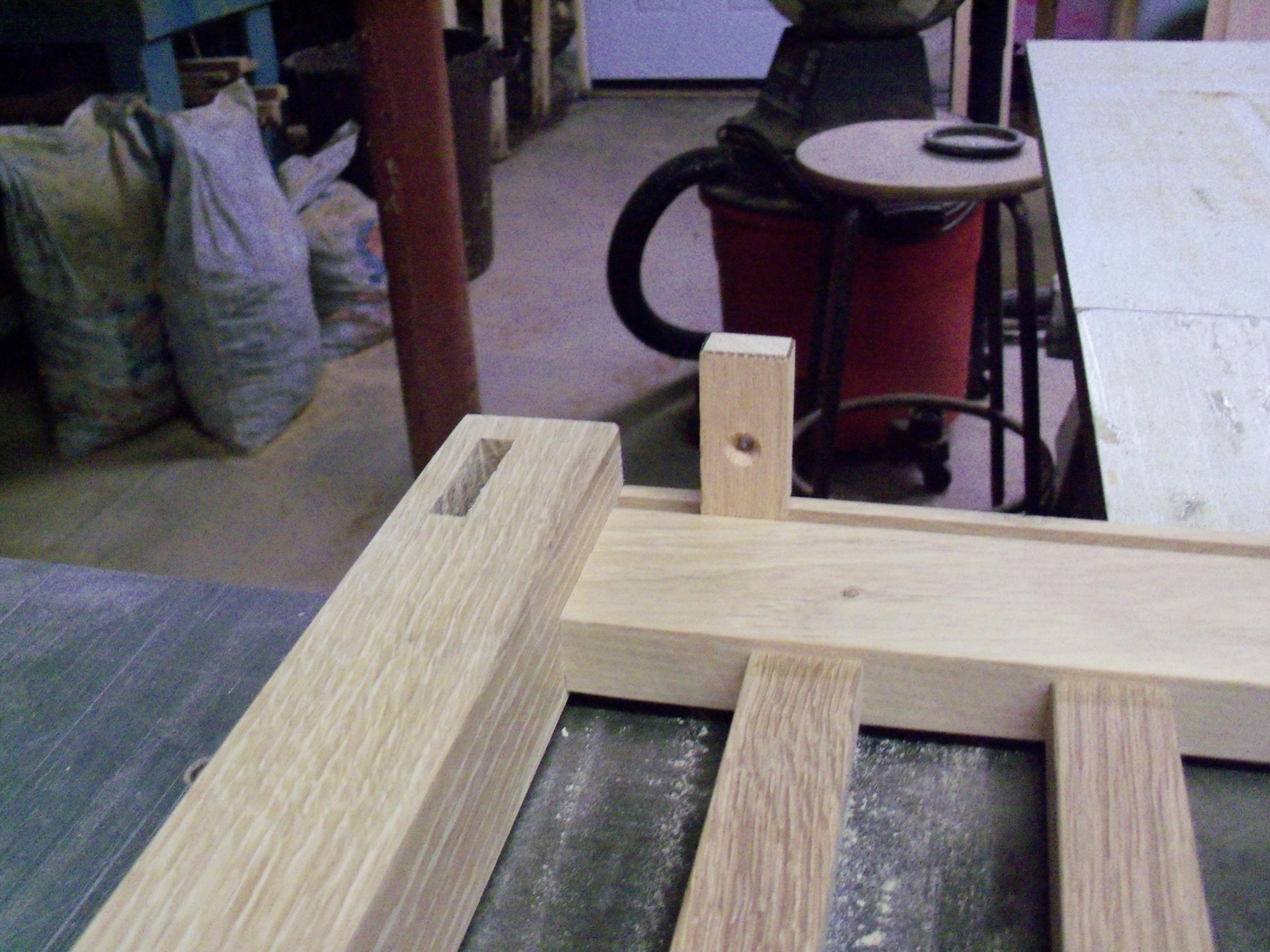

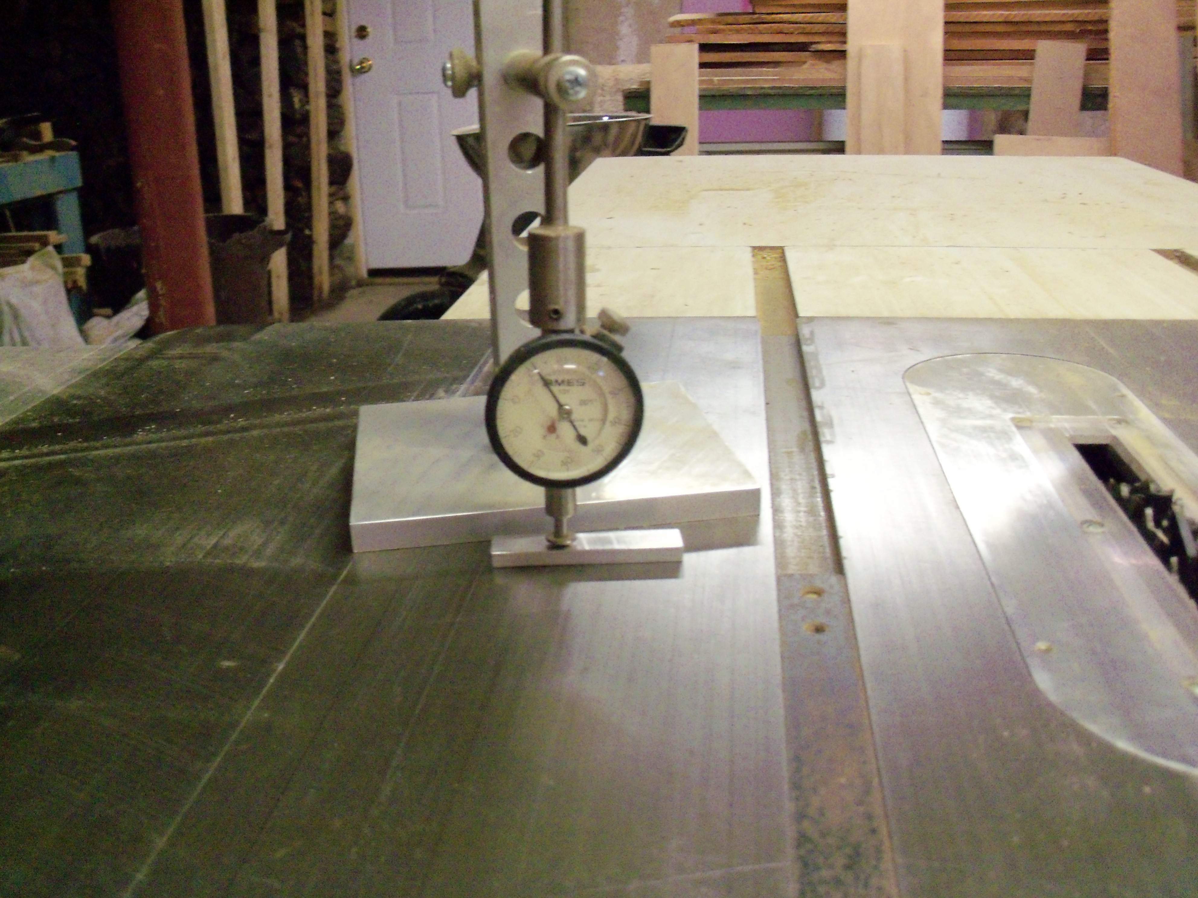

Im sure alot of wood workers use different methods when cutting their tenons. I like to use my dado set, I can set the height using a dial indicator and gage block, thats the old toolmaker coming out of me I quess :). But it works quite well and once I get the height set, I can lock the saw, and they all come out the same, I ususally leave them a few thousanths big and then use a rasp to fit each one individually...
Youll notice the alluminum throat plate in the saw, I made that when I was still working in the shop, I can remove that lexan piece for different widths of the dado set...

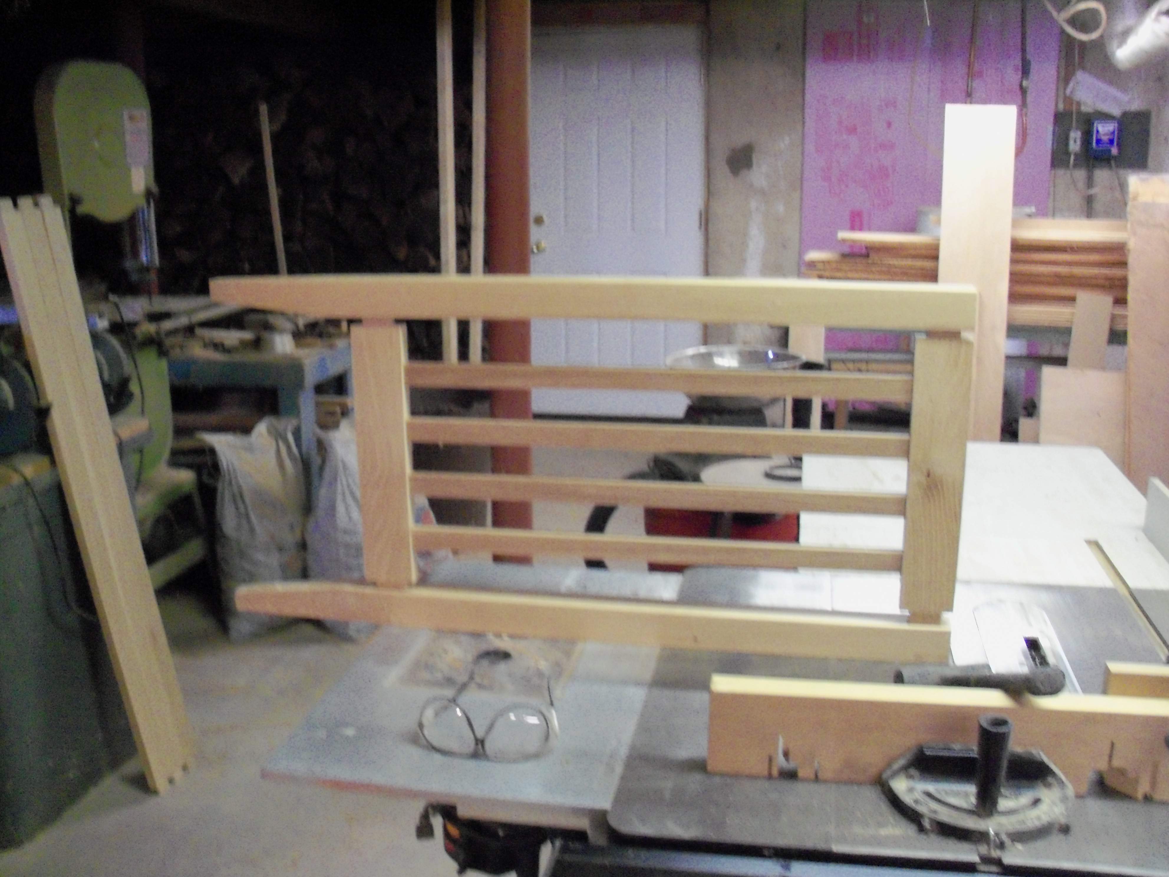

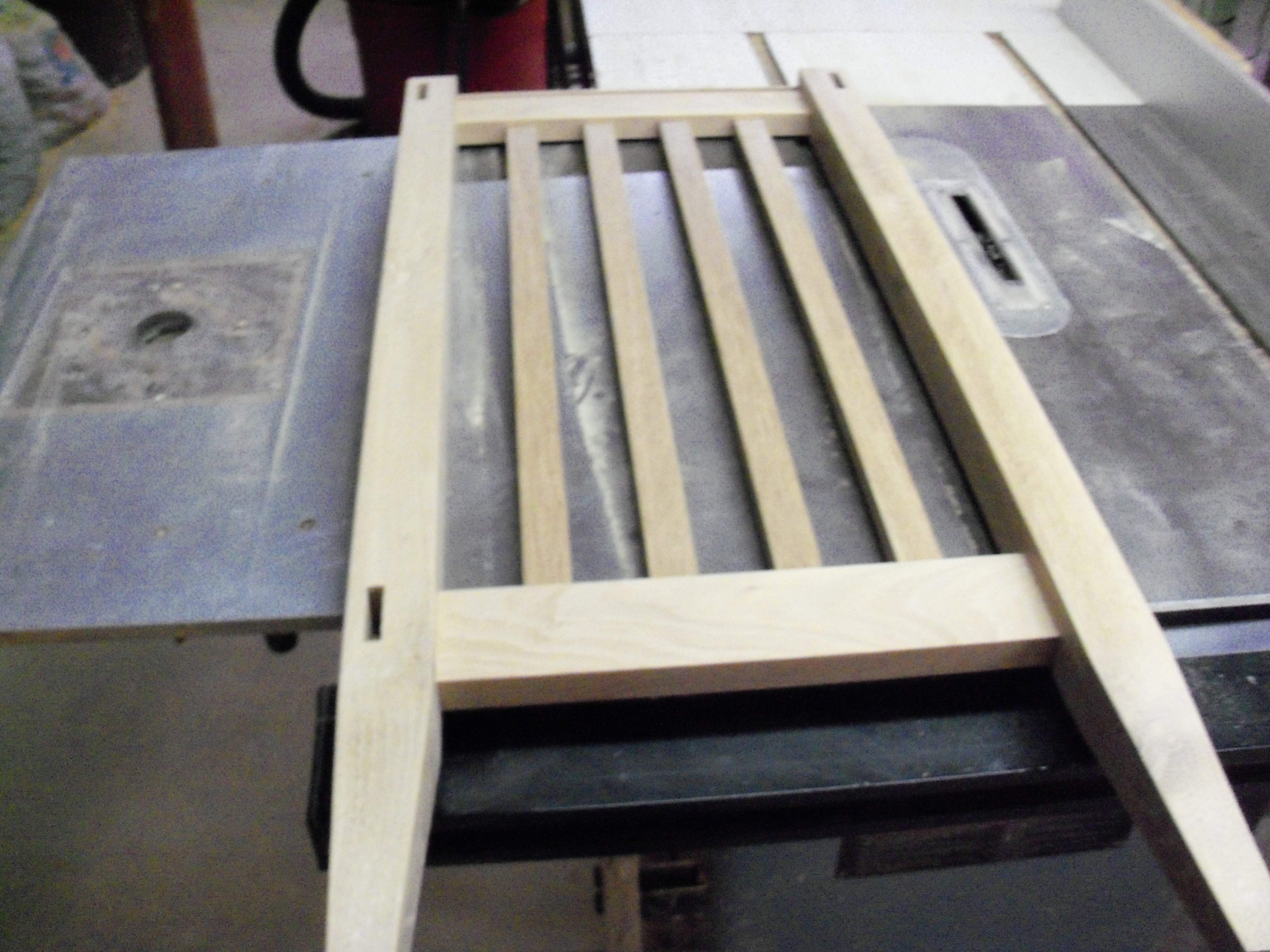

Here are a couple additional pics of the table ends...
The tenons have not been milled on the slats in this pic yet....
I forgot to mention that the table rails are 2 1/2" wide, so I went with 3/8" by 1 1/2" tenons on the rails, and matching mortises in the legs.
The slats on the table ends are 1/2" by 1", and I decided to go with 1/4" by 1/2" tenons on these pieces.

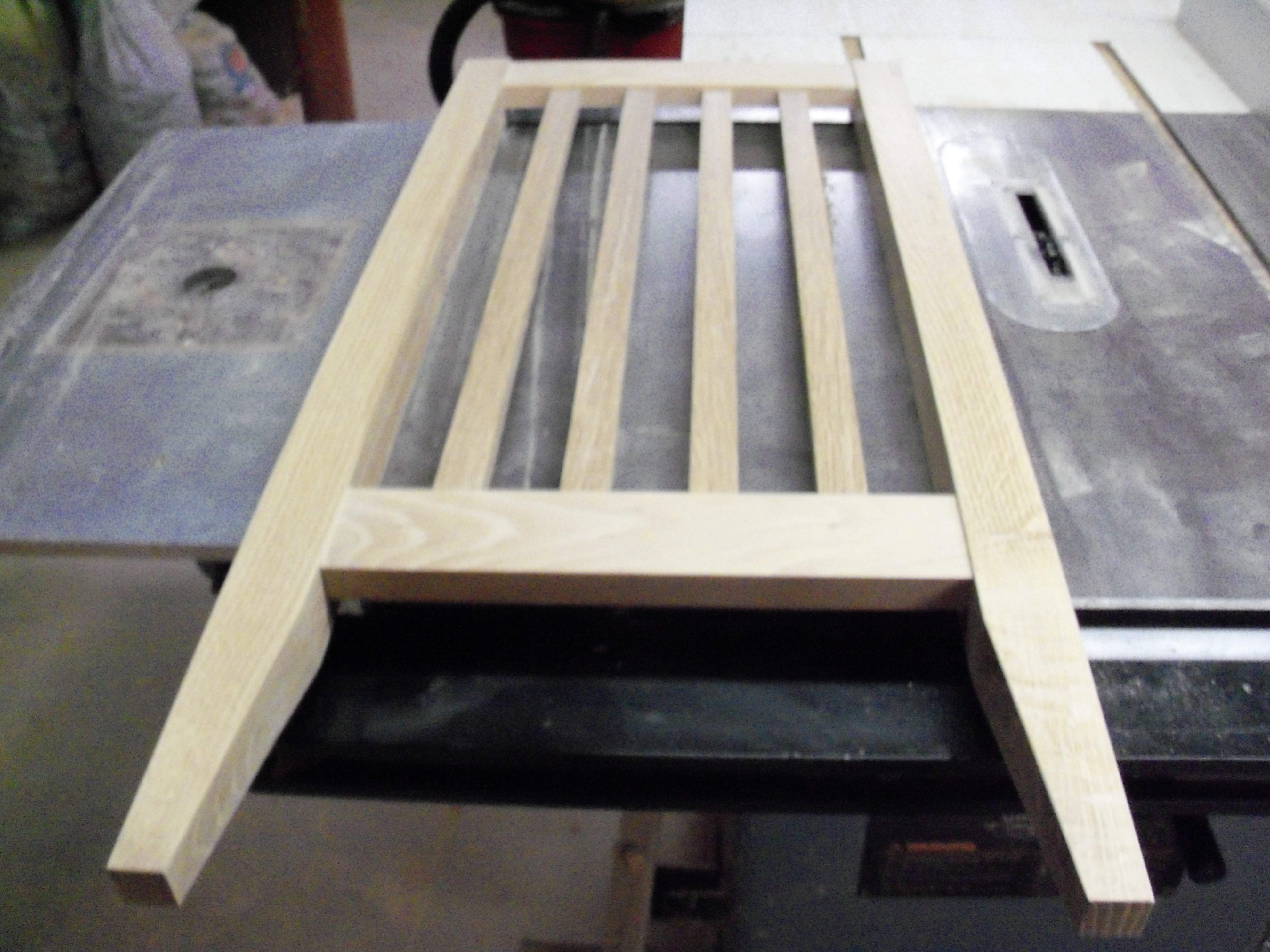

After all the parts were milled and fitted, I allways dry assemble and clamp it to make sure all the joints are done correctly...
Here is a pic of the dry assembly in process...

After fitting both end assemblies together, I pull everything apart, and pre sand all the parts. I dont get too carried away with sanding at this point because the parts will invariably get banged or scraped before the table is assembled as a complete piece.
You will also notice in the second picture, that I cut a 1/4" by 1/4" dado in the top rail. In the third pic is the clamp that will hold the table top in position to the base. The table top will expand and contract with the seasons, and by using this method of attaching the top it can move without effecting the structural integrity of the base...

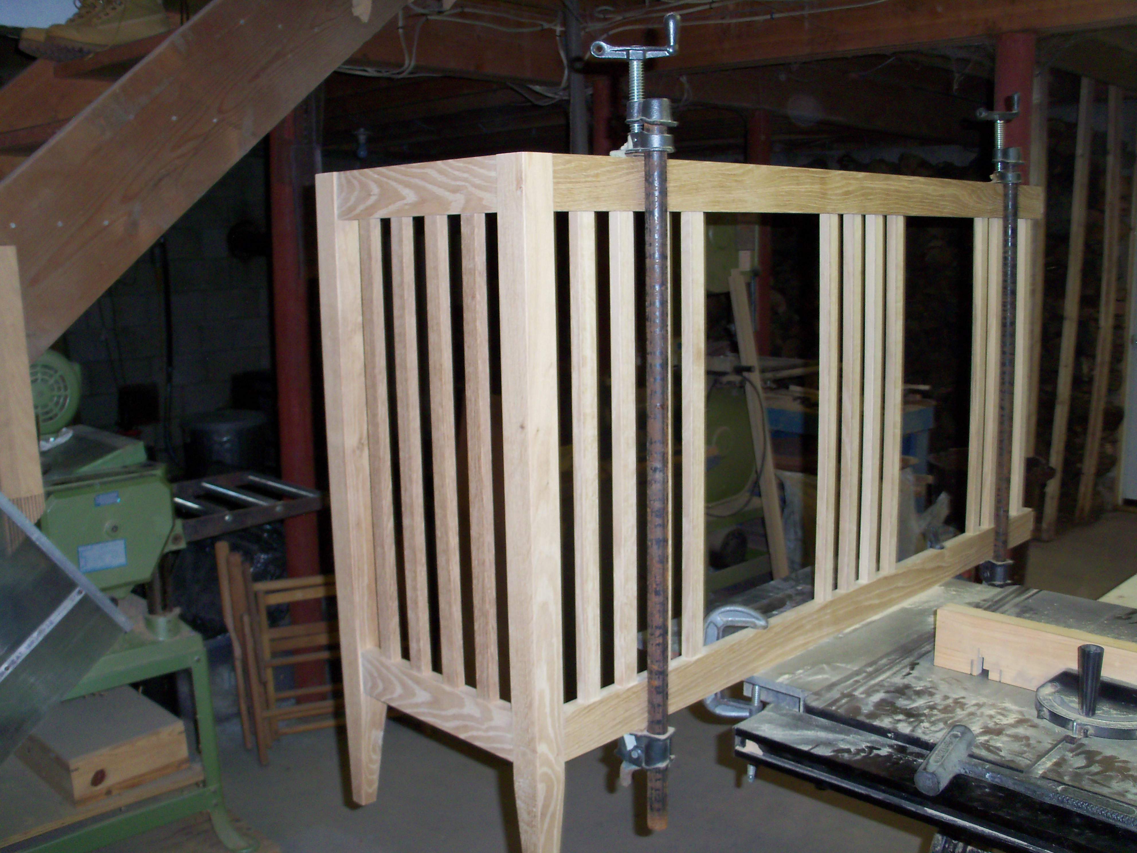

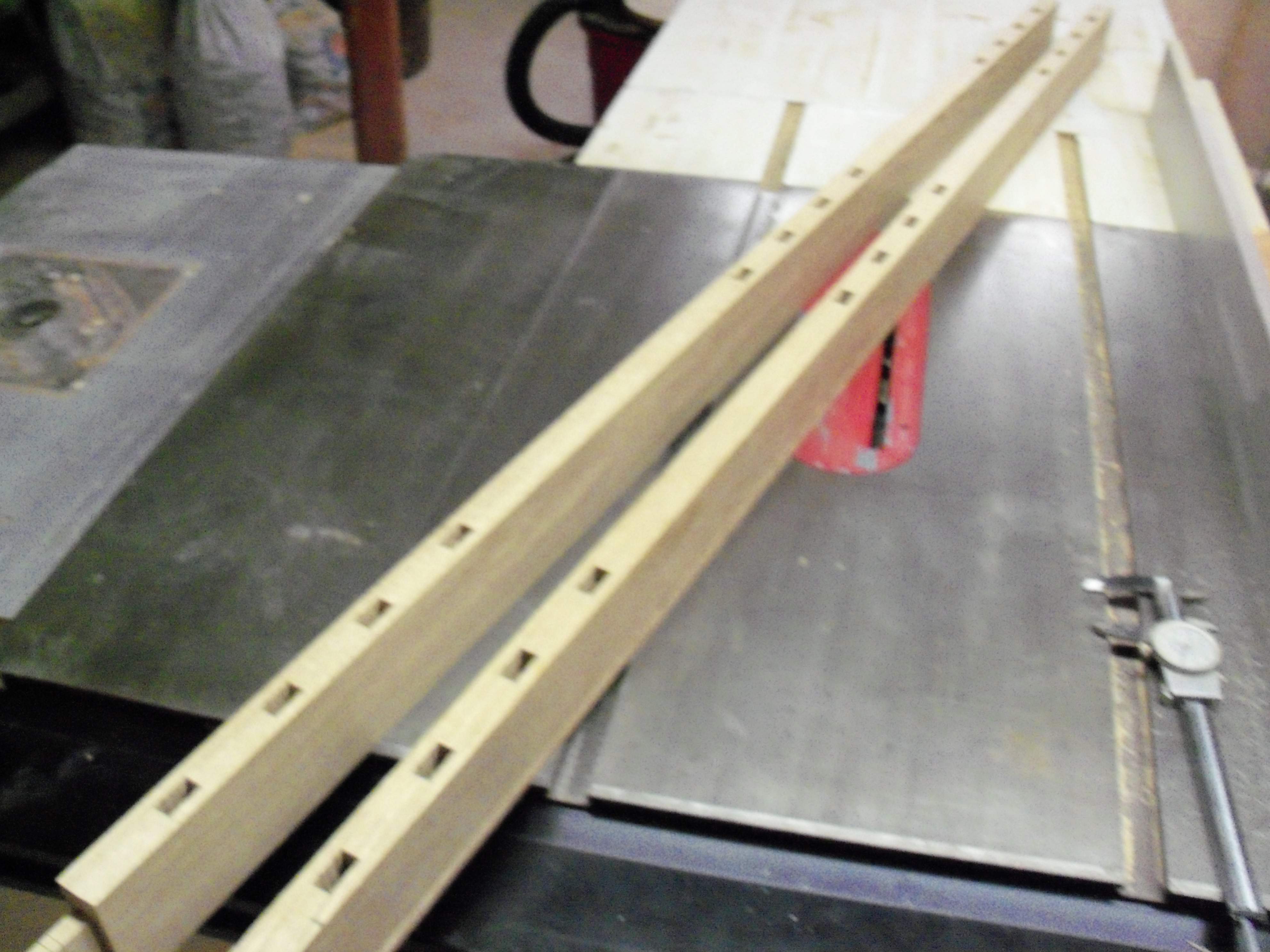

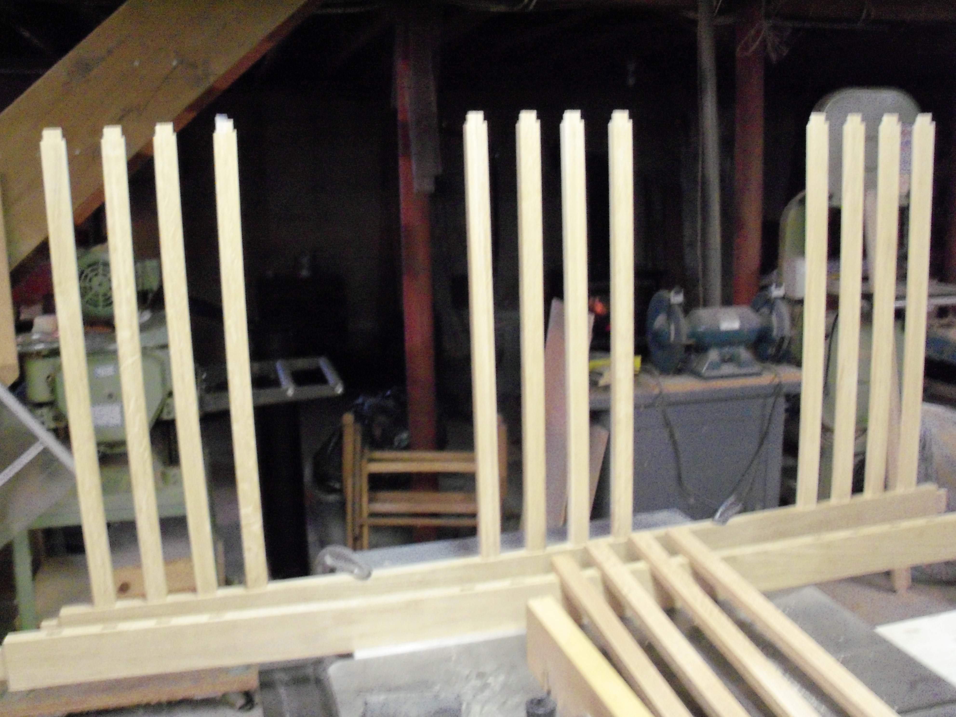

I had a chance to get some more work done on the table. I layed out the long rails between the table ends and cut all the mortices. I believe on a previous post I wrongly mentioned that the slat tenons were 1/4", sorry that is incorrect, they are 3/8" along with all the other mortices in this project ! They are 3/8" by 3/4", and all the slats are 5/8" by 1", which makes forming the tenons quite easy because all the relief cuts are 1/8".
I milled up the stock for the slats and mistakenly grabbed a piece of oak that didnt have the same coloring as all the other slats... So I had to do that whole operation over again, kind of a pain but the coloring difference would have really stood out like a sore thumb.....
I dont think I mentioned it earlier, but when I glued up the ends, I try to be very careful on the amount that I use. Excessive squeez out on the joints is a real pain to clean up, and really isnt necessary for a strong joint. If I do get a small amount, I use a dampened rag, and after the joint has a few minutes of setup time, I will use a single edged razor for final cleanup.
If your not carefull when doing this, when you attempt to stain your piece, the stain wont penetrate that area, making for a sloppy job...
I fitted all the slats in between the long rails, and then checked to see if the ends would fit properly. All table surfaces will get dampened lightly with a sponge to raise the grain, and then sanded once again. And then everything will be finished sanded. Im not quite to that point yet...
Here are a few pics to bring you up to date...
I decided to use three equally spaced slat formations on the back rail, rather than slats all the way across. If you recall, there will be three matching stools, so something to break up the monotony of nothing but slats...
BTW I forgot to mention that since the 1" side of all the slats are cut from flat sawn stock they reveal some very nive ray pattern, the photos dont pick it up but Im sure when the piece is stained it will standout...
