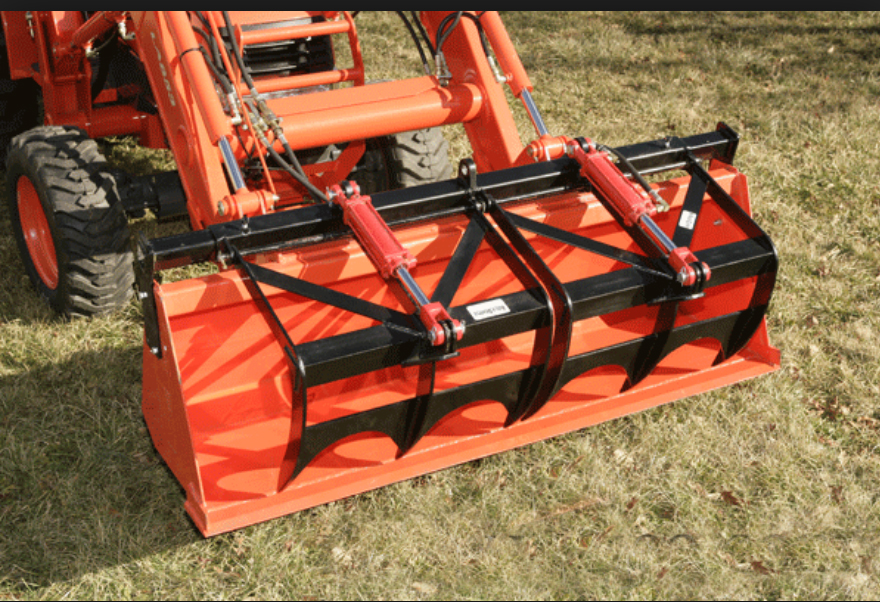

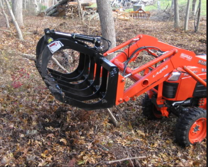

My brother uses a bucket grapple, it is not an add on, but has essentially the same function as an add on system and he really likes it as it gives him the convenience of being able to do a bit of dirt work if needed. I use a root grapple that must be replaced with the buket to do dirt work, but changing out is easy as my tractors rarely leave their respective farms.
Given your situation, a bucket grapple would be very tempting.

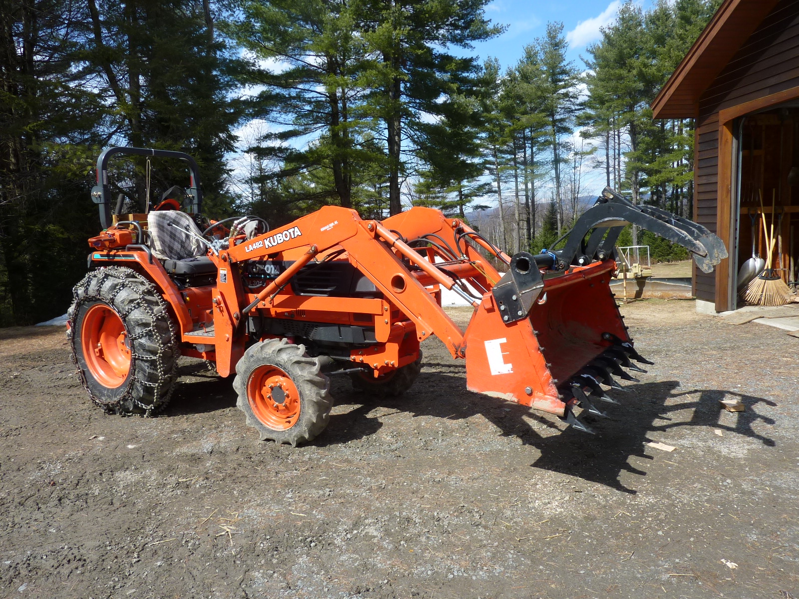

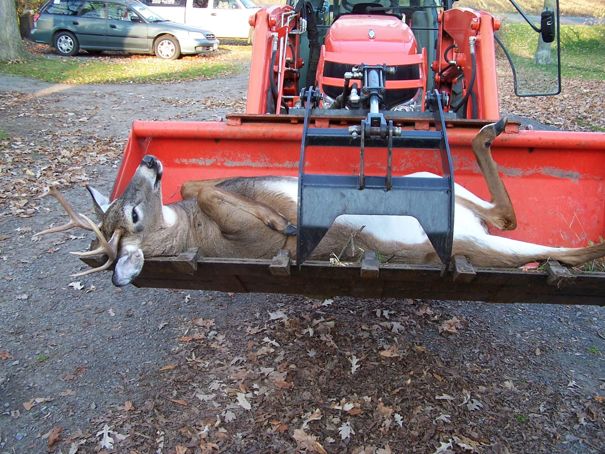

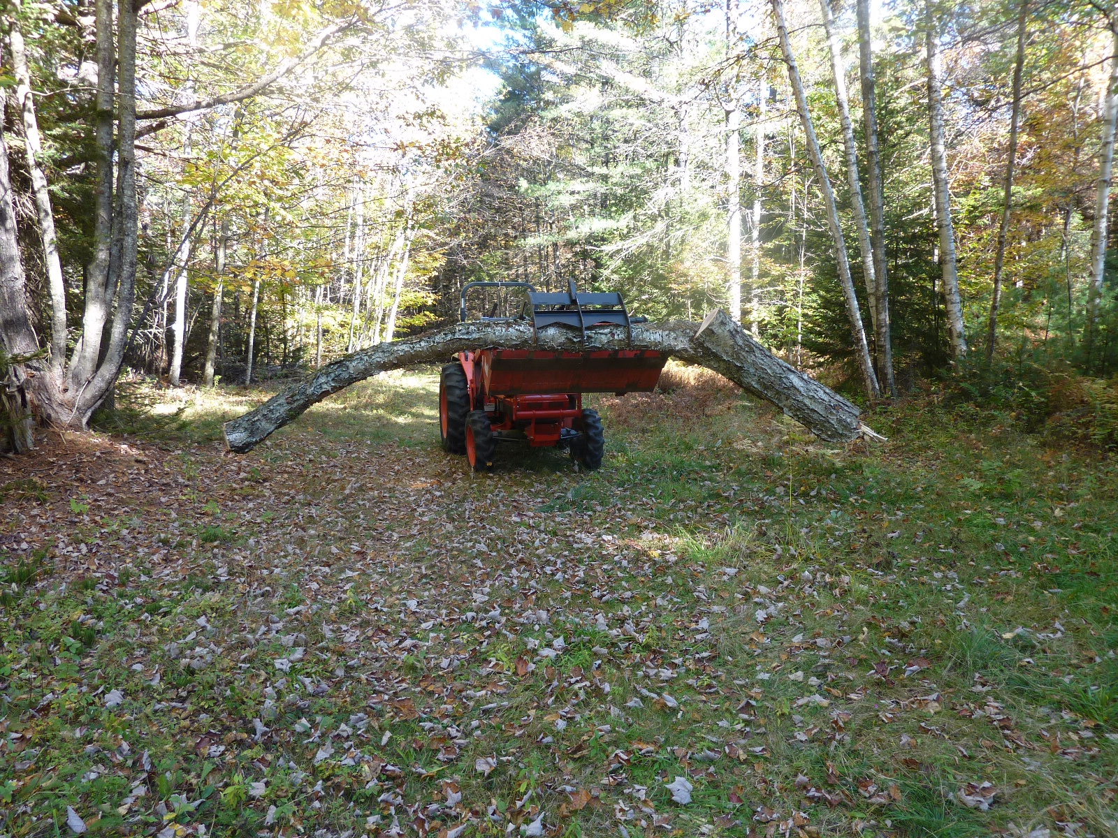

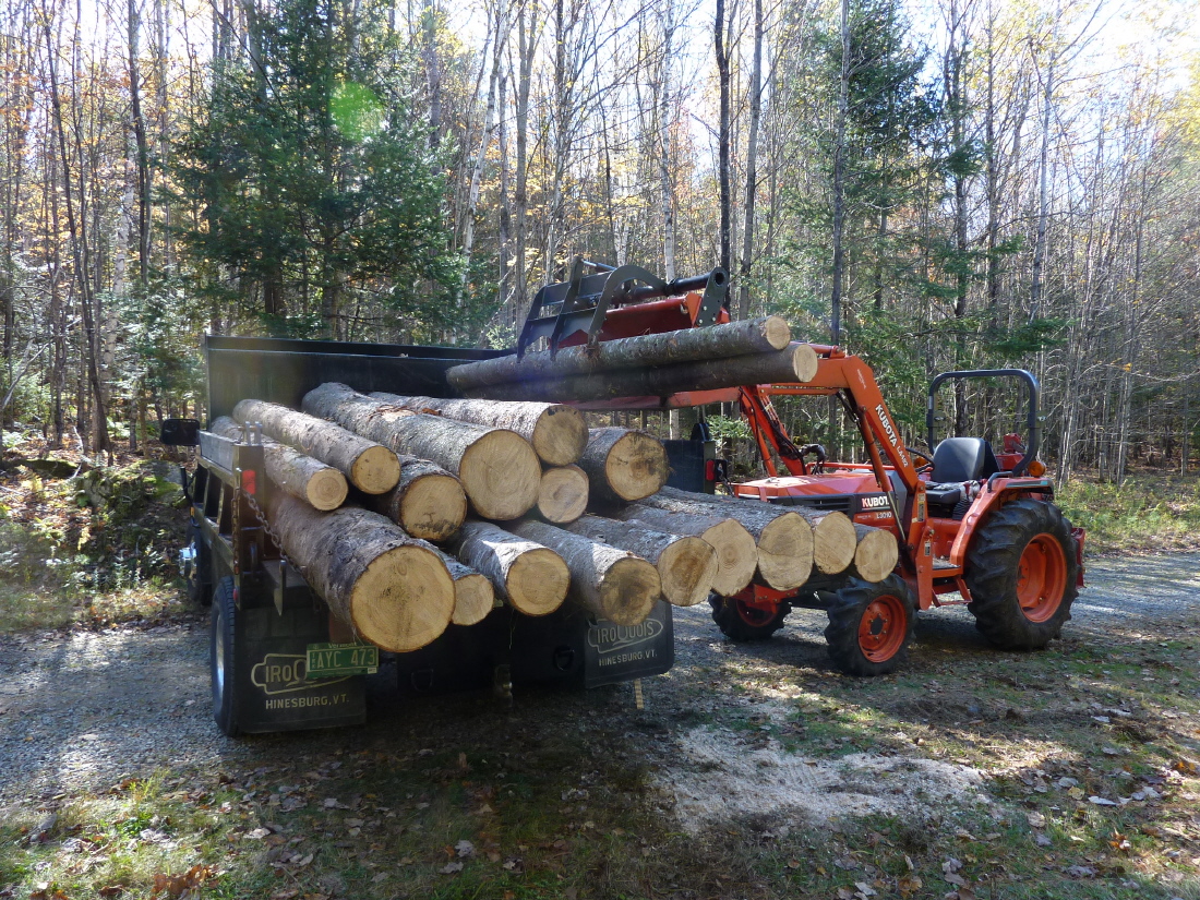

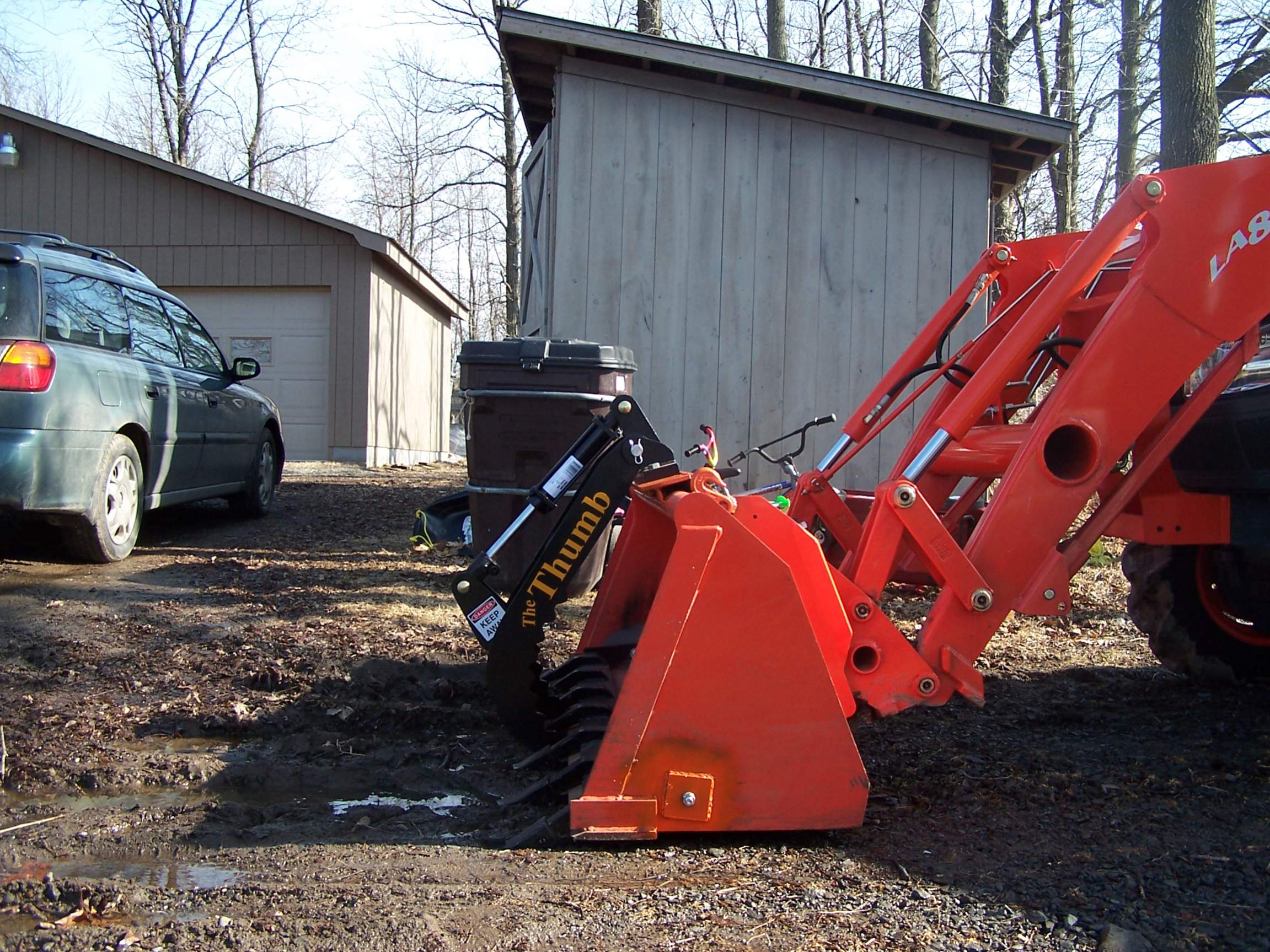

I use a Green's Machine Thumb and a tooth-bar.Works very well and the thumb comes off with four bolts.

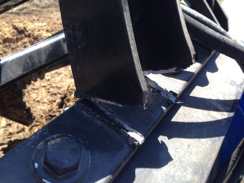

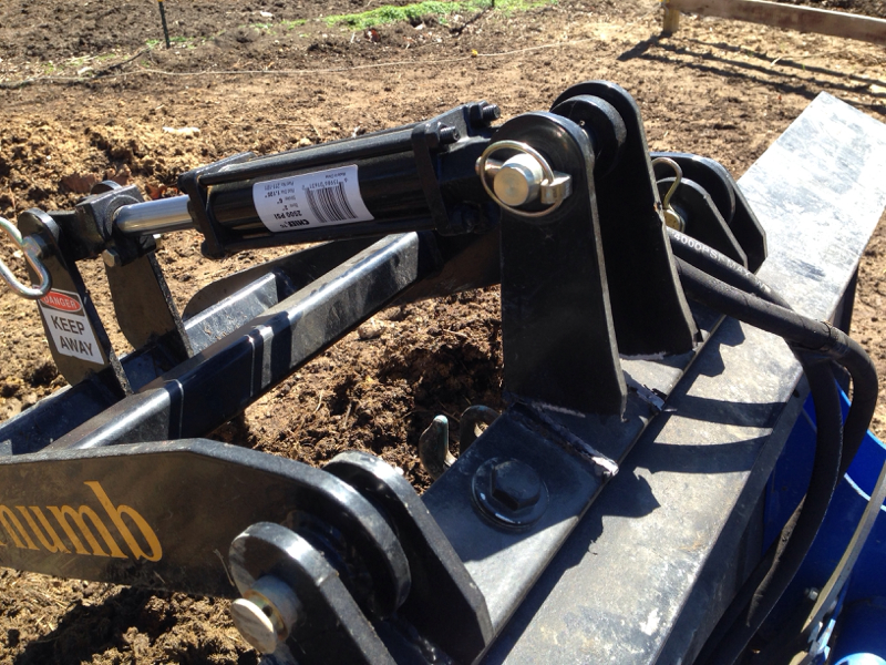

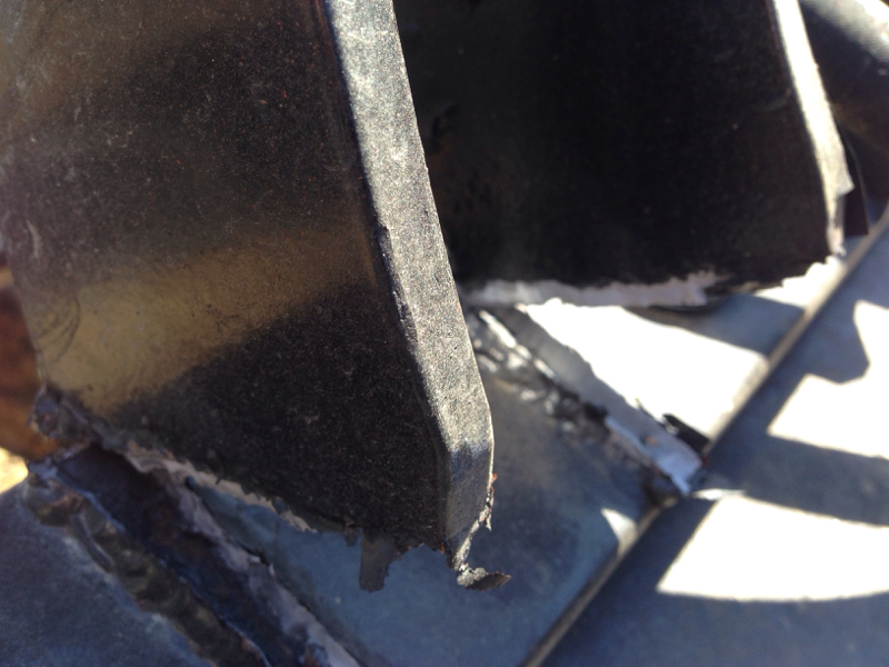

I also bought the thumb from Greens. I really don't like it on the bucket. When I was thinking about getting it someone said it was like picking up a jar with needle nose pliers. Well logs shoot right out of it. I have sims longer teeth to it but it doesn't help. Brush it does good.
Sunday I was backdragging with it closed and hung something. The claw snapped right off. I can fix it but I'm going to use it to make a grapple out of.

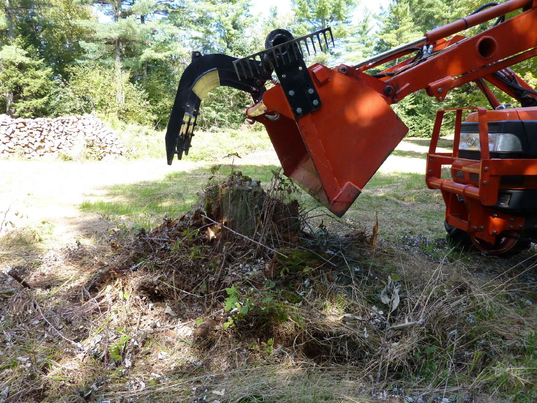

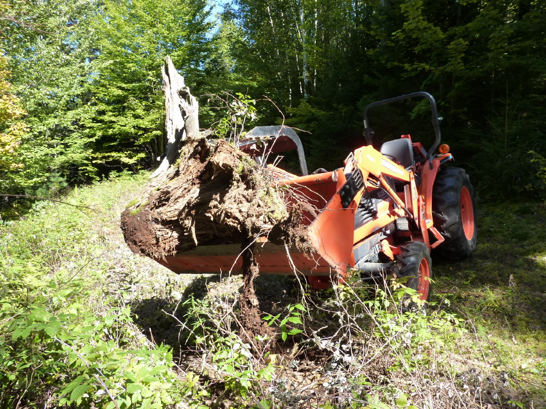

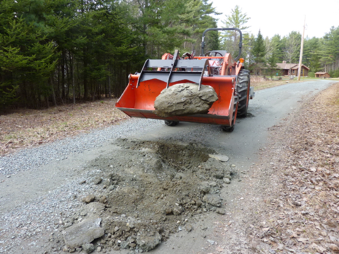

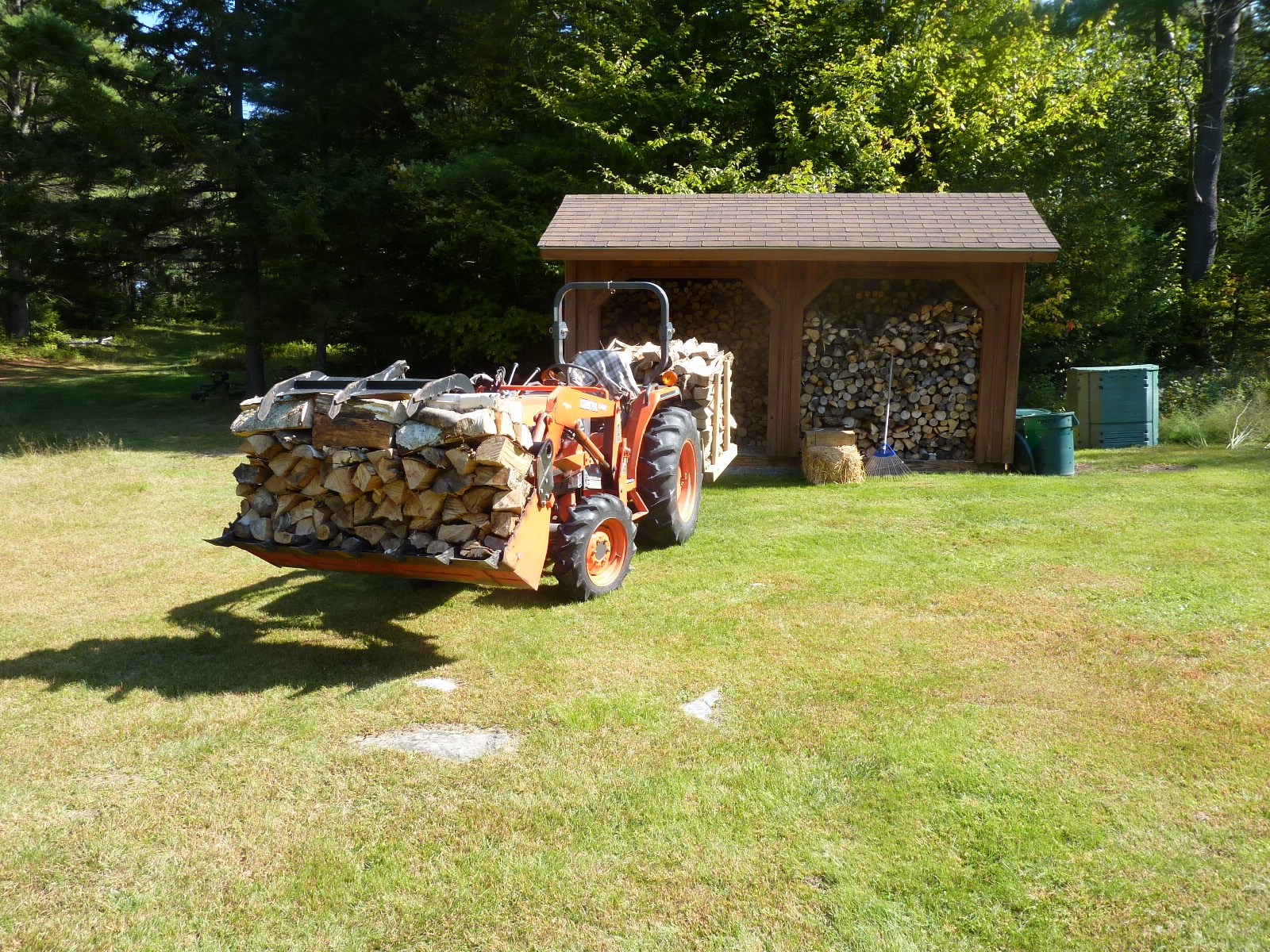

I have an ATI bolt on grapple - similar to the thumb. I had it for several years before I added the tooth bar. The tooth bar made it far better all around. Better at raking brush, going after rocks and stumps, and grabbing logs although I could do this stuff before I added the tooth bar. Much better digging too of course.
I like it because I always have the bucket and grapple with me. I can clean snow out of a woods road with the bucket then go to work stacking brush when I get to where I am cutting. Here are some pics of what I do with it
Sent from my iPhone using TractorByNet
Something doesn't add up.....
For the cyl bracket to break like that, it would require a tension load on the cyl which would mean pushing with the top of the lid with it partially open. The actions you describe would have ripped the front of the bracket.
Either way it sucks for it to have broken and certainly looks like a weak design. Penetration on that weld doesn't look too good either. They should have designed it with some bracing that runs down the back of the bucket
