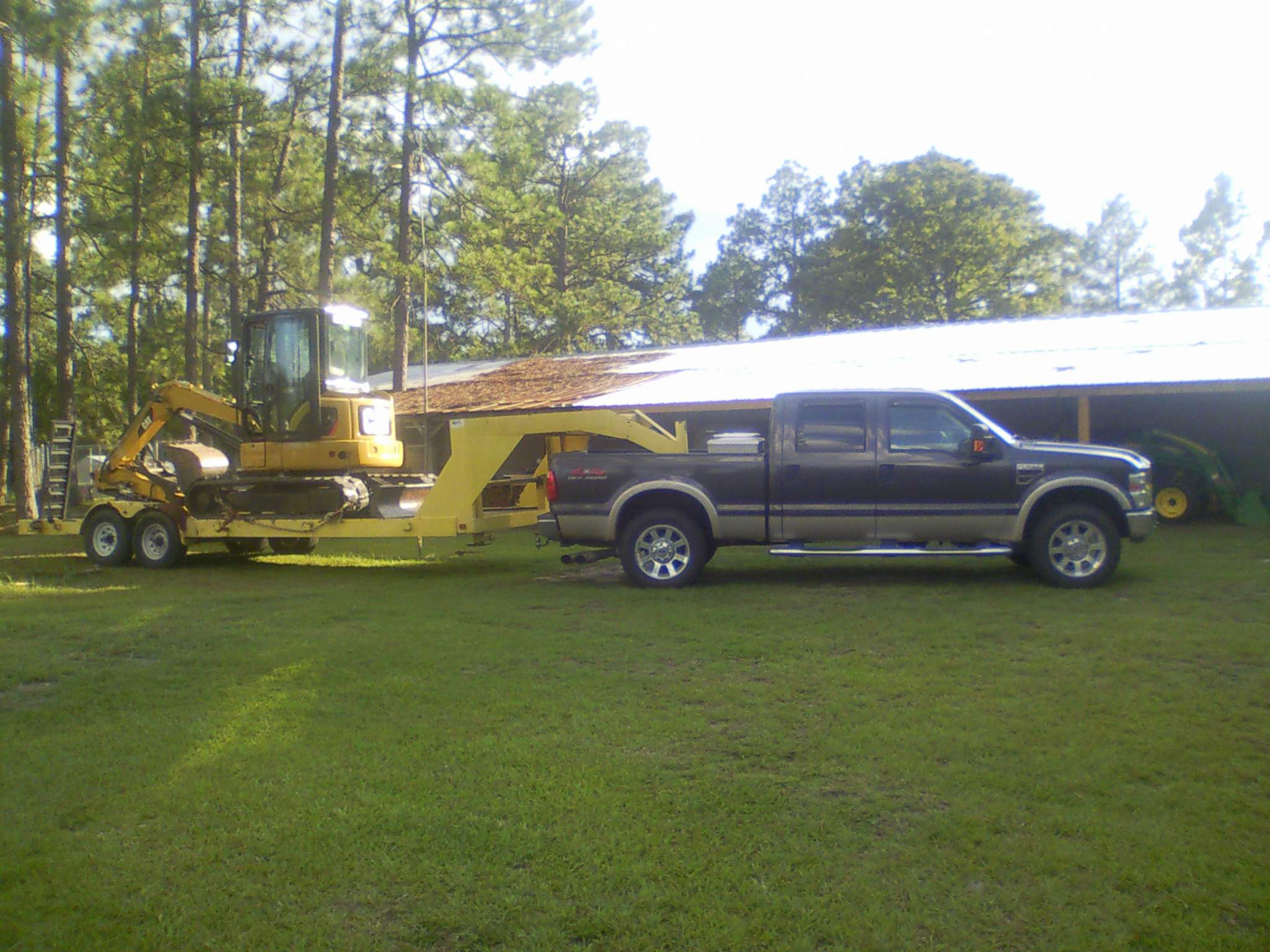

Need a new trailer and cant decide what to go with. Towing with an 08 f350 4x4 srw and the heaviest load is a cat mini ex 304 it specs at 10800lbs. Current trailer is between the fenders, 25ft, twin axle, single wheels, 14000lbs. Thought about tandem wheeled flat deck. But from my understanding even towing empty the total gcvw of truck and trailer isnt legal. Dont have cdls and would rather not have them. Everyone has a different take on the laws its hard to make a call. Last time I weighed the F350 it was 9500lbs. Any suggestions would be helpful.

I'm an ole country boy and not very smart but I'm having a hard time understanding why you need a new trailer based on what you said and that pic.
Nice trailer btw.
Is it because the gcvw is too much and you feel it will require a cdl? Is something wrong with the trailer? Or just want a new one. Nothing wrong with that.

That pic is very deceiving. This is an old trailer and needs alot of work. From different angles you could see that the fenders are both bent and rusting and need replacing. Trailer has been painted over looks like three times and badly needs sandblasting and new paint. Deck boards need replacing. And all the wiring is starting to erode and constantly giving a problem, need to be rewired. If I were only using this trailer right near home it would be fine. But I often need it off from home and would rather feel confident that its ready when i am. I could turn it into a restore project but i have to much of those already. At my age (44) a new trailer should last till I'm gumming food and wearing depends with little upkeep.
As far as truck weight, its been scaled at quarries and landfill. I have a ticket on the dash now from landfill with empty weight at 11840lbs towing 12ft carryon dump that weighs 2400lbs. Purchasing a new trailer is a large buy and one i dont want to regret. At these weights I know we are all getting into gray areas. Tandem wheels are more stable towing but pushes you past the gcvw of f350 cdl's or not. Right? 14000lb trailer should be fine with 20% tongue weight on truck, then its just flat deck or between fender. Never had a flat deck and dont like higher center of gravity but fenders do get in the way. Sure would feel good knowing I had 8 tires on trailer instead of 4. Just going thru my options. Thanks for the input

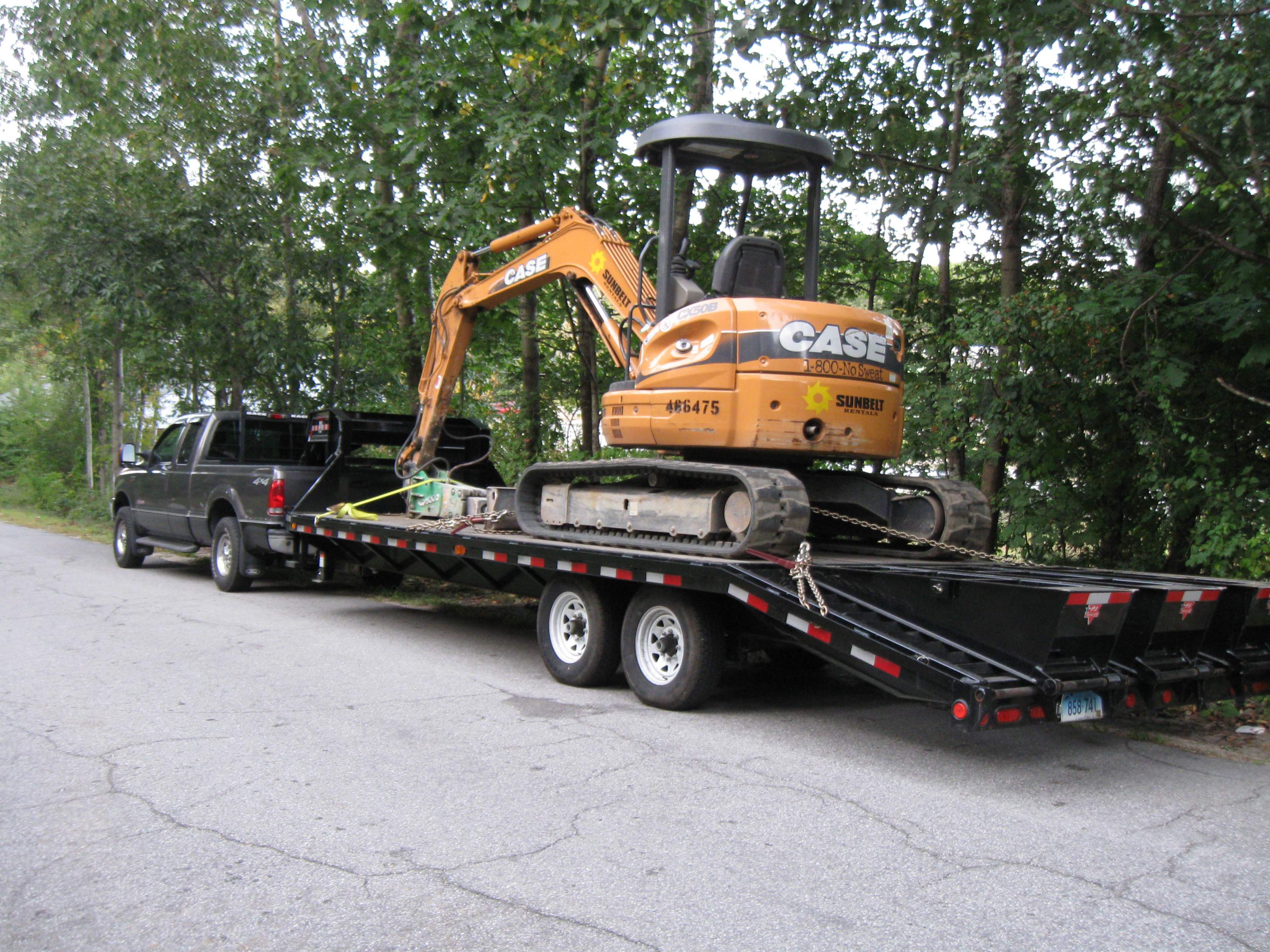

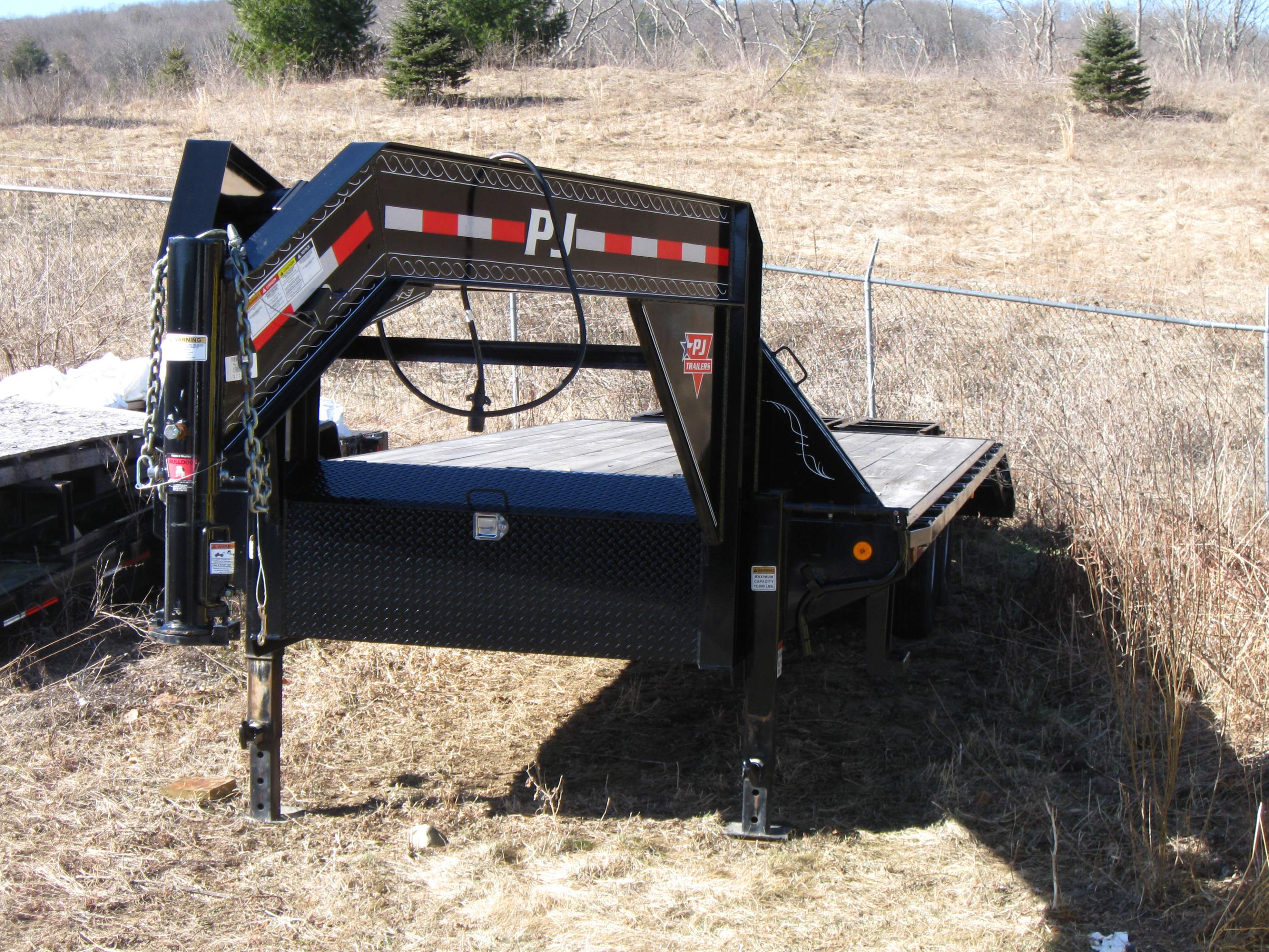

The stability of a bp deckover doesn't corralate to a GN deckover. I had a PJ 20+5 GN deckover with a 15600lbs gvw. The trailer was extremely solid and stable with any load I hauled. I had a 12k Case 50 with hammer on it and was able to spin the turntable of the mini 360 while on the trailer without issue. I doubt you need tandem duals with the loads you currently towing.

Greatwhitehunter, I wouldn't consider a bp. Really now down more to going with another GN between the deck or like you a deck over. My 304 cat is near your case at 11,000lbs. What does your trailer weigh? I can load my kubota 7040 or cat 304 so its got enough width. The fenders do sometimes get in the way when loading something like a basket of stone that you want to set over the axles to distribute load. Nice lookin equipment all the way around:thumbsup:

I wasn't suggesting a BP to you. Deckover BP's don't feel as stable with the higher center of gavity. The GN seems not to have those same physical traits.
The GN was 102" so I could put just about anything on it. It also had almost no load placement issues.
