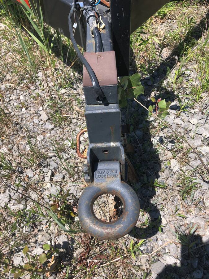

Has a channel in the front that currently has a lunett ring in it. Borrowed a pintle hitch from a friend to get it home, going to switch it to use a 2 5/16" ball, too much slop and clanking in the ring for my taste.

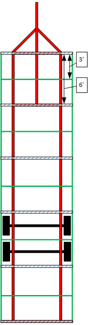

It is framed something like this:
Vertically from bottom to top:
Black is wheels/axles
Red is the main 3"x6" frame
White/Blue striped is the 3"x3" box tubing sitting on top of the main frame (front, first from the front and back have 3"x6" tubing under them)
Green is the 1x3 box tubing sitting on top of the main frame and going around the primeter.
What weight should it be good for with the 3"x6" main frame? It will be towed behind our 2002 F350 SRW.

I have never seen a travel trailer tongue setup like this one, it has a pintle hitch for one (and a 4 hole channel that it's mounted to), the channel is lower than the main beams, so it could not be used with a weight distribution hitch (unless the chains were a foot and a half long) and there are no marks where a WDH was mounted, or where propane tanks would have been.
I could see it as having been an enclosed trailer (like a big snowmobile trailer), but not a travel trailer.

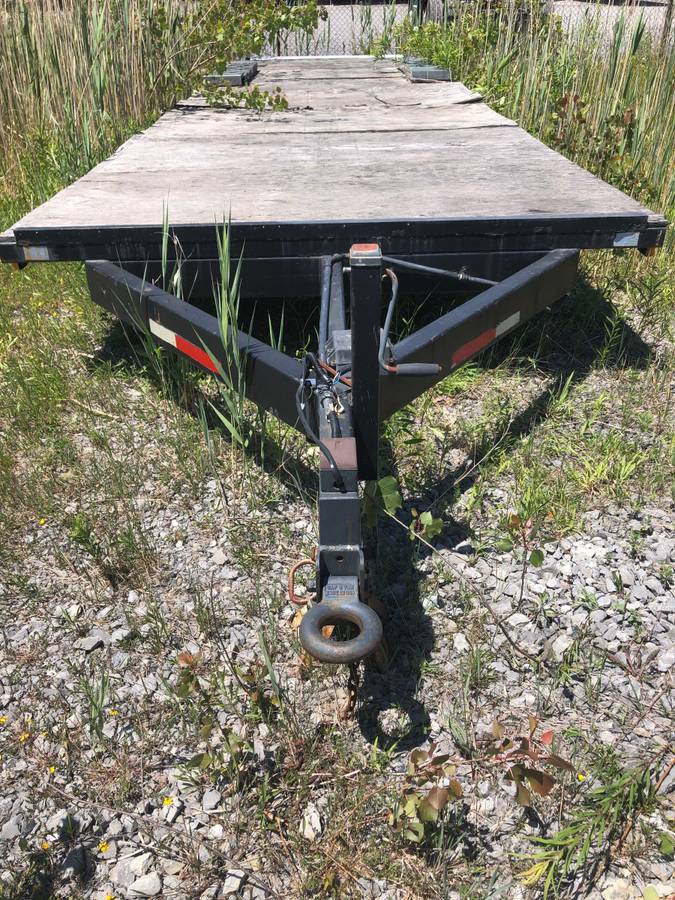

Could have been an office trailer, here are some pictures:

Aaron, That frame is light for a normal deck-over trailer but if you don't load is heavy, you should still be fine.

Yeah, I think you'll be alright if you keep the weight (within reason) over the axles. But that flooring might as well be tissue paper if you haul something heavy. I can't tell how it's fastened to the frame. If there's no sign of walls around the perimeter (holes, shadows, impressions, etc.), that floor was most likely thrown down by a previous owner. Can't trust that. I wonder what the tops of the frame members look like?

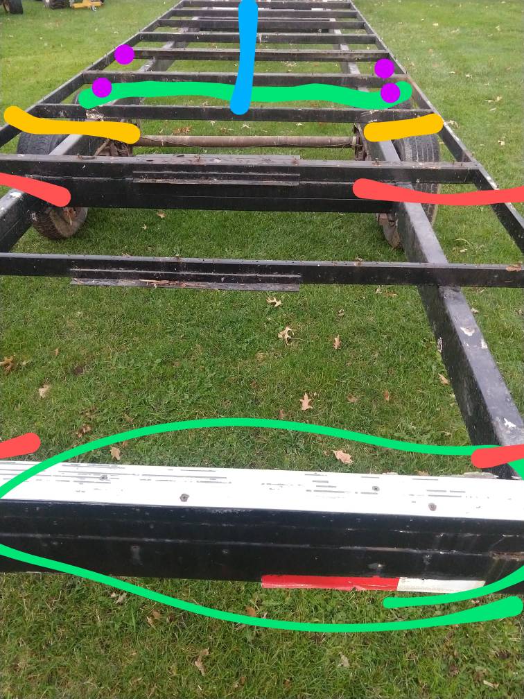

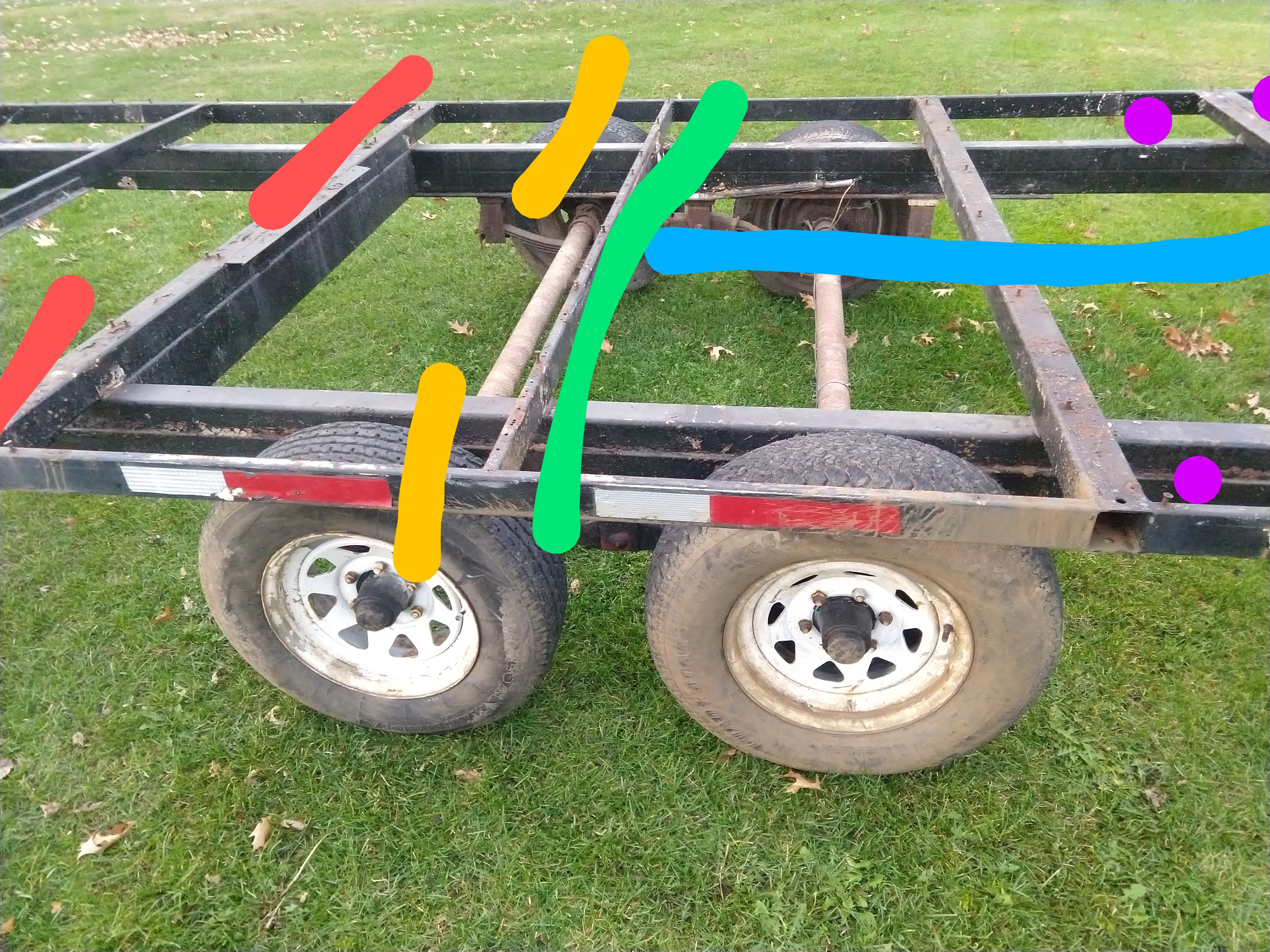

I plan to make it into a 8' wide 22+2 or 21+3 dovetail deckover.
I will finally use up the piece of 6" I beam that has been in the way in the shop for the last 4 years as a new center frame rail (in line with the tongue), then add in cross members (pallet rack beams of which I have a surplus).
Here is roughly what I am thinking:
Red is the new back of the trailer.
Purple is the new wheel locations.
Green circle is the current back cross member of the trailer which will go at the top of the dovetail (Green line)
Orange is the dovetail cuts (will actually end up on the other side of the 1x3 cross member).
