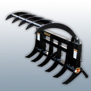

I thought a root grapple would be shaped like a root rake (on a dozer) with a grapple lid?
Root rake:
root grapple - Google Search
Root grapple:

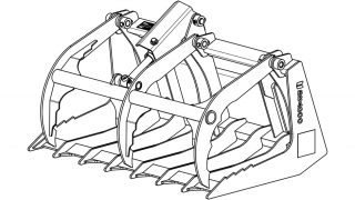

I think the best way is to refer to the two basic shapes. Both shapes are called root grapples by many manufactures.
Claw and clamshell are the same shape:
L bottom is the other basic shape and also called a root grapple.

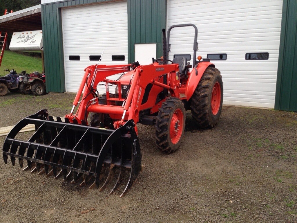

I bought this one from Anbo. Not cheap but its tough as nails. In 3 years of pretty hard use, I've only broken one hose. It is pretty heavy for my M7040.
   / Which Grapple Root or Claw??? #37
Yes, that Anbo is top of the line. I decided to go light on mine. Short drive to Denton to get it. I guess I'm fortunate to live in NC. Lots of good grapple manufacturers here in the state.

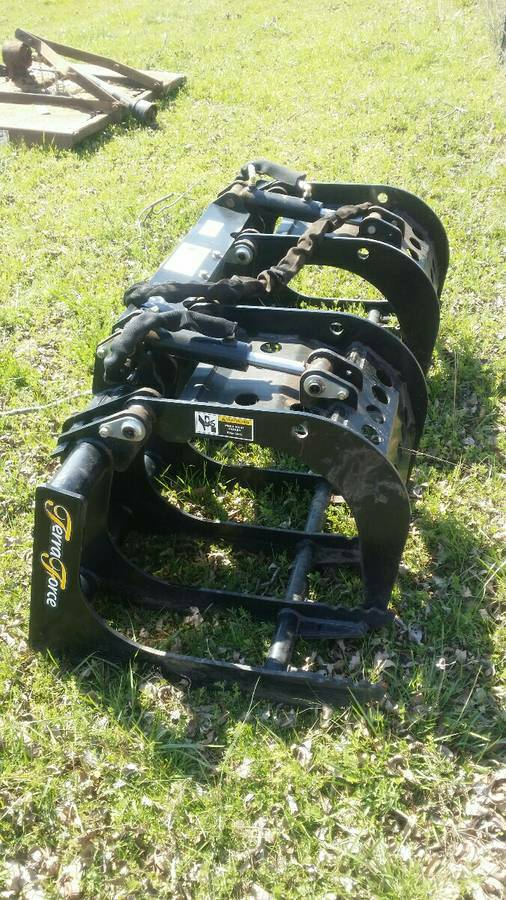

I found that 66" grapple locally and the guy wants $1250, anybody know anything about terra force grapples? Is it a good deal? I think the retail is about 1700, but that doesn't mean too much to me.. I like to find deals.
