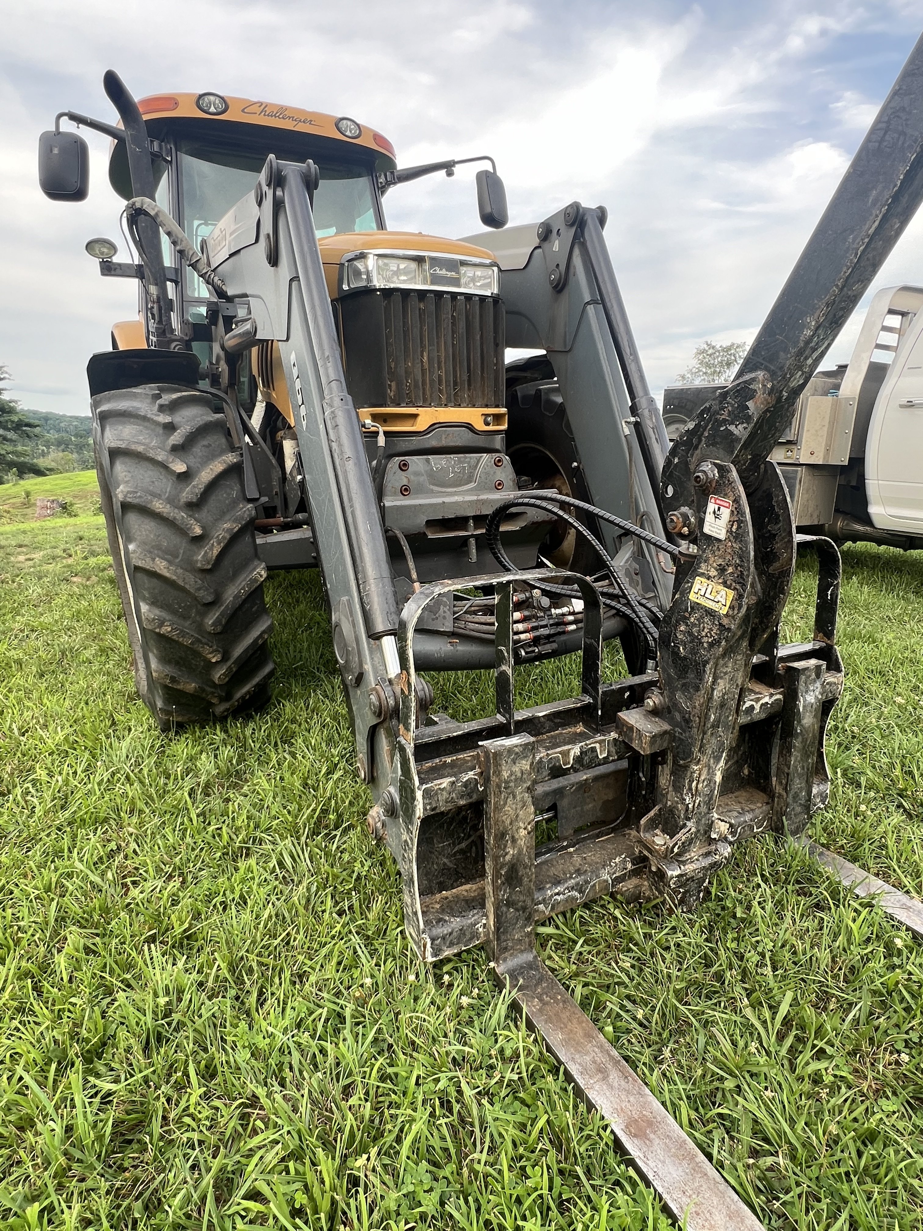

Get yourself an HLA catalog, or go to HLA on line. Canada or US made.
Very tough stuff. I swear by their attachments, not at them. Found at AG dealers all over.
Buy once, cry once.
What is that ? I have those same forks and just noticed the extra hole by the chain pocket and wondered what went there. You just solved that curiosity.

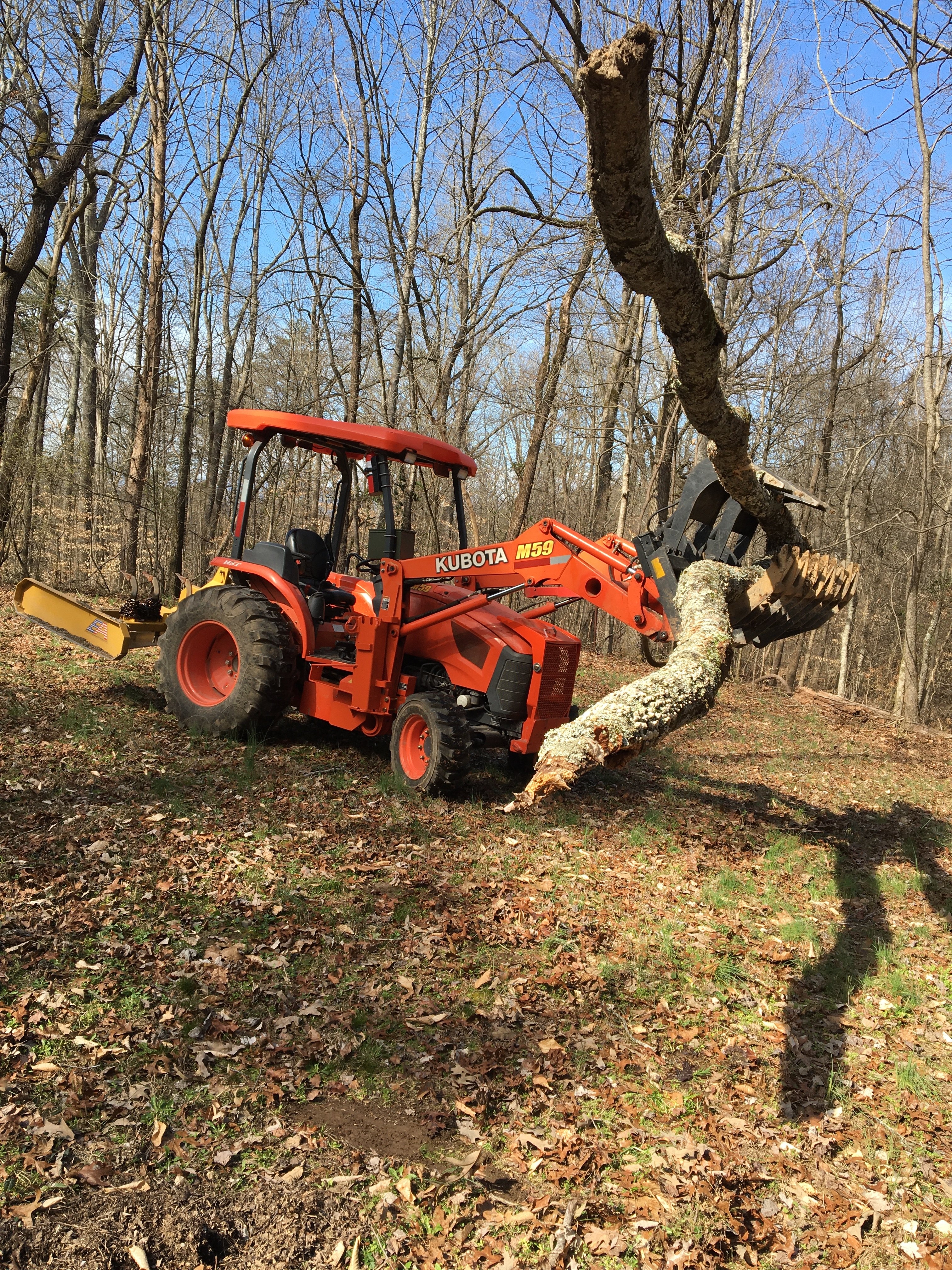

Most of the work I do with my grapple - moving large chunks of pine tree trunk and large rocks. I have obtained and faithfully use two weight charts I got off the internet.
Weight of basaltic lava rocks and weight of pine logs. Helps keep me out of trouble.
I do not like that feeling - when the rear tires begin to lift - rather than the load in the grapple.
