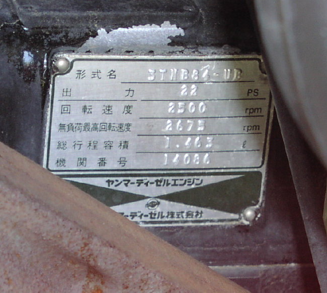

I have a YM2210D. The ID plate on the engine identifies it as a 2T90. When I found that parts for the 2T90 engine did not fit my engine I was directed to look for an engine ID tag on the fuel injector pump. The ID tag on the injector pump identified the engine as a 2TR20. Further inquiry revealed that this engine was from a YM2000 and could be used as a direct swap with the 2T90 utilizing the YM2210D air filter and intake.

Just purchased YM1700, on the clutch side of the motor is 2TR17-07951.?? New to Yanmars and i've tried to figure out exactly what i got. It's recently refurb. Under the left hand side below pto lever, on trans. is stamp into housing ym1700 10196.?? i'll have to look at Jap. tag on motor in daylite. I get 2=cyl; t= tractor, after that i'm lost. But will search for answers. TXS
/ Which engine is in your Yanmar #130
That's all the correct stuff for a YM1700.
Chassis [model] ym1700, [sequential build] #10196.
Engine 2TR17 [engine model name, which indicates 17 horsepower measured at PTO], Engine serial # 07951.
Yanmar's numbers don't all start from zero, they start a new series sometimes at a major upgrade.
If your receipt says you bought a YM1700, all is well.
