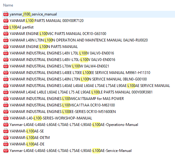

I have lots of Yanmar L100 manuals for free. What one does he need?
- Parts Manuals
- Shop Manuals
- OPS and Maintenance Manuals
All on the YOTG,
   / Need advice on regulator for Yanmar L100 10HP diesel generator #5
I suspect #s 1, 4, 5, & 7 would be a good start, given that he has an L100V6E, and is using it in a fixed speed industrial use. (Manuals 7 & 8 look the same from here, but I did not download them.)
