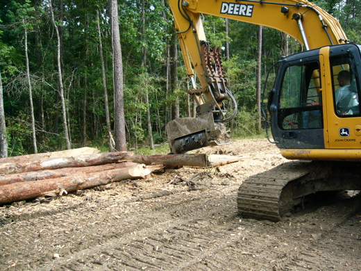

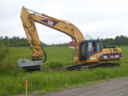

Regarding mulcher rotation, I understand what some customers we've heard here mentionned: by going top backwards, you throw some possibly hazardous projections much further away in front of you. That's not a problem if you're alone far out in the woods, but it might be a concern for pedestrians or drivers if you're closer to roads and houses.
Having said that, the guys that run our excavator-mount models use both direction while working. To better understand, from the operator's cab on a standard excavator, you would see the drum rotating counter-clockwise. So here's what they do:
1. Using the swing, they do a first pass from right to left, at maybe 2 or 3 feet above the ground. This clears the vegetation cover and reveals the rocks that might be underneath.
2. Then, swinging back from left to right, the go closer to the ground with the nearer-end of the brushcutter almost touching it. They then clear the rest of the vegetation, avoiding the rocks by using the bucket cylinder.
So, on the first pass, you're working basically as you would be on a skid steer. Rotation of the drum is seen by the vegetation as being from the top down.
On the second pass though, you got it, rotation is then seen as bottom up (is that the right expression? Correct the French Canadian if not :) ) What is interesting when they go on their second pass though is how they use the bottom-up movement to pick-up material that is on the ground and suck it into the rotor.

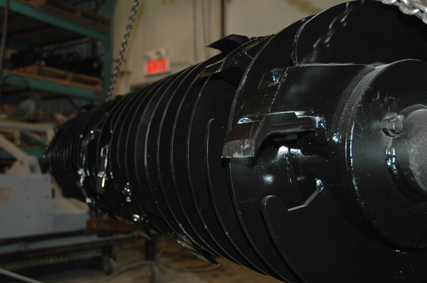

If you mean jammed as in intentionally jamming the rotor to test relief pressure setting, then what happen is just that: not able to turn, the motor will go in relief.
If you mean jammed as in inadvertently jamming the rotor with a piece of wood that get stuck between the back of the drum and the tub, well, to be honest, this is unlikely to happen. If you look at the picture of a rotor, you'll see those rings that limit the size of bites that can be taken. So before a piece chunk of wood can get into the rotor, it will have been chipped in small parts... (Again, fellow competitors, that's part of our patent. Please invent something else. :D )
But if that was to happen, if you happen to jam the rotor with a piece of wood, then, you're right, you can shut down the brushcutter and have it "manually" turn backward on the ground to free it.

Yes , being jammed with a piece of wood is what i was meaning . That is a cool looking rotor , i can see now the reason the rings are on it . They would act like the hydraulic infeed rollers on a wood chipper , holding the timber back while the cutters do their thing gradually feeding the timber in and stopping the rotor from becoming bogged down , good thinking .
