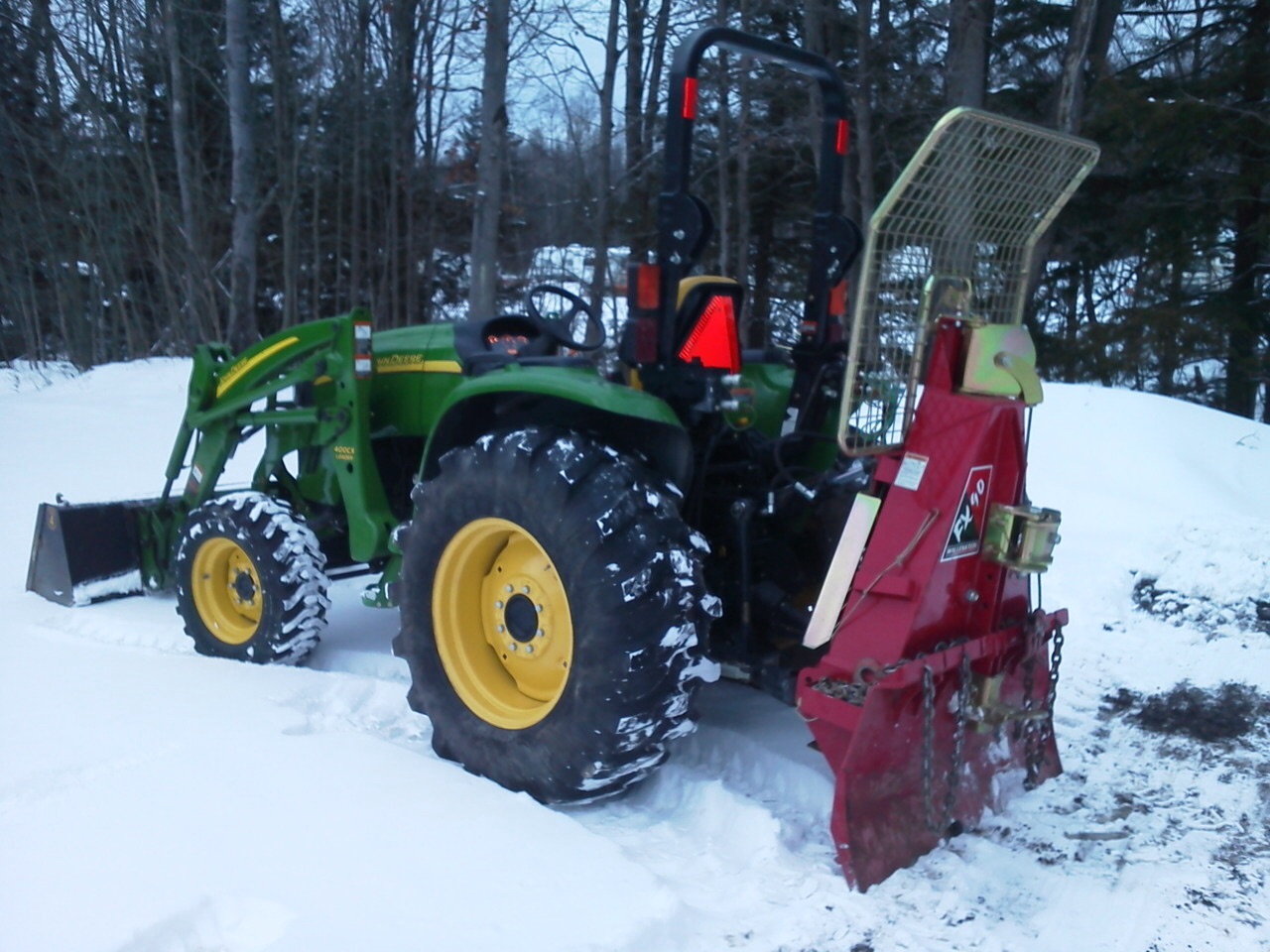

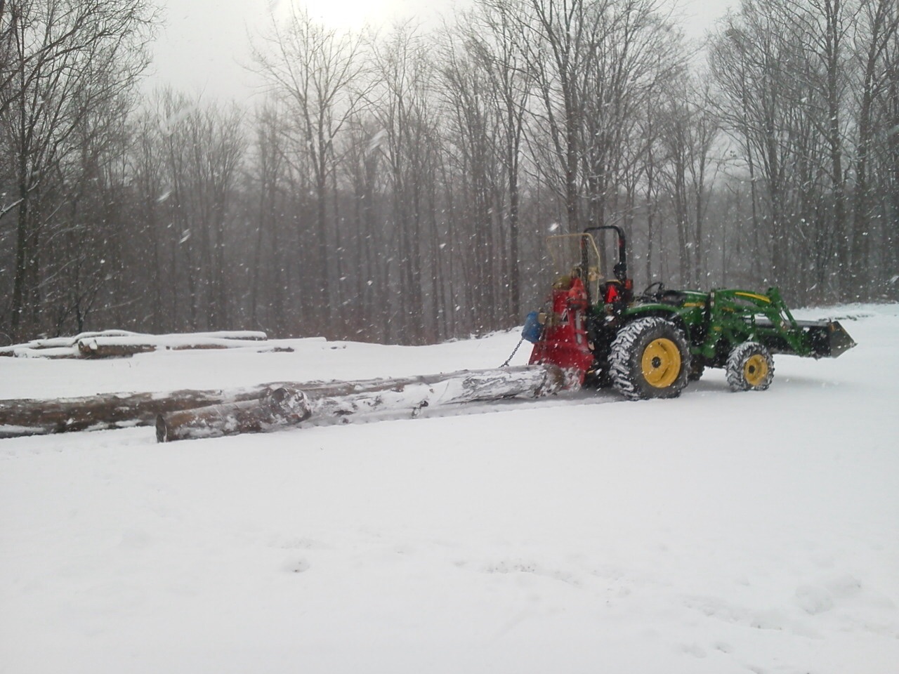

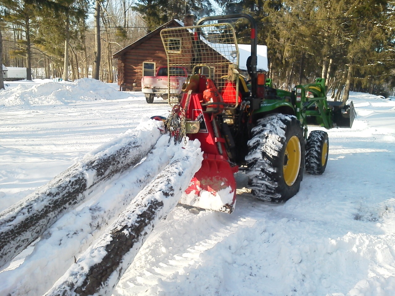

I have been using an fx90 on the back of my 4720 john Deere , it seems vey well built, this is not my winch it is a friends that is lettin me use it for this winter. There are 3 different tractor dealers within 15 minutes of me that sell walenstein and only one around that sells farmi. I've have no experience with a farmi , but I've been told the safety screen is an added cost and does not come standard like the walenstein, and I also don't think the farmi has a a mount to hook a trailer like the wallenstien , I could be wrong on this, but I am also going to look into this more. When I return this winch back to my friend this spring I am going to be purchasing my own. Hope this helps you with your decision

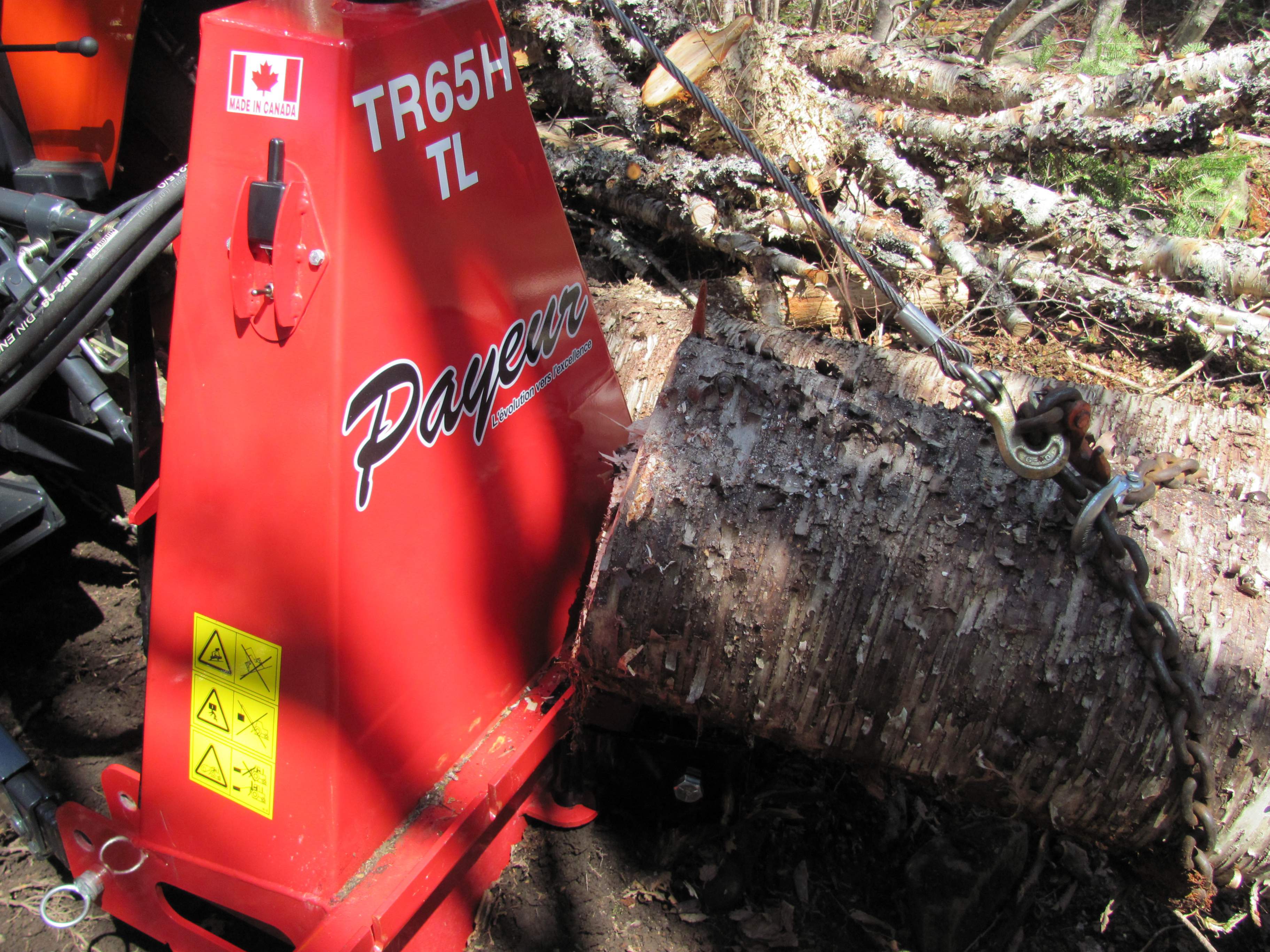

Forestry winches | Les distributions Payeur
This is a Canadian company, they build several models both hydraulic and mechanical.
Seeing where the CDN dollar is right now, $.80, it may be very attractive for a US customer to buy.
I have a TR65H model, hydraulic, with a wireless remote and it is a great unit, rugged built ,Canadian made.

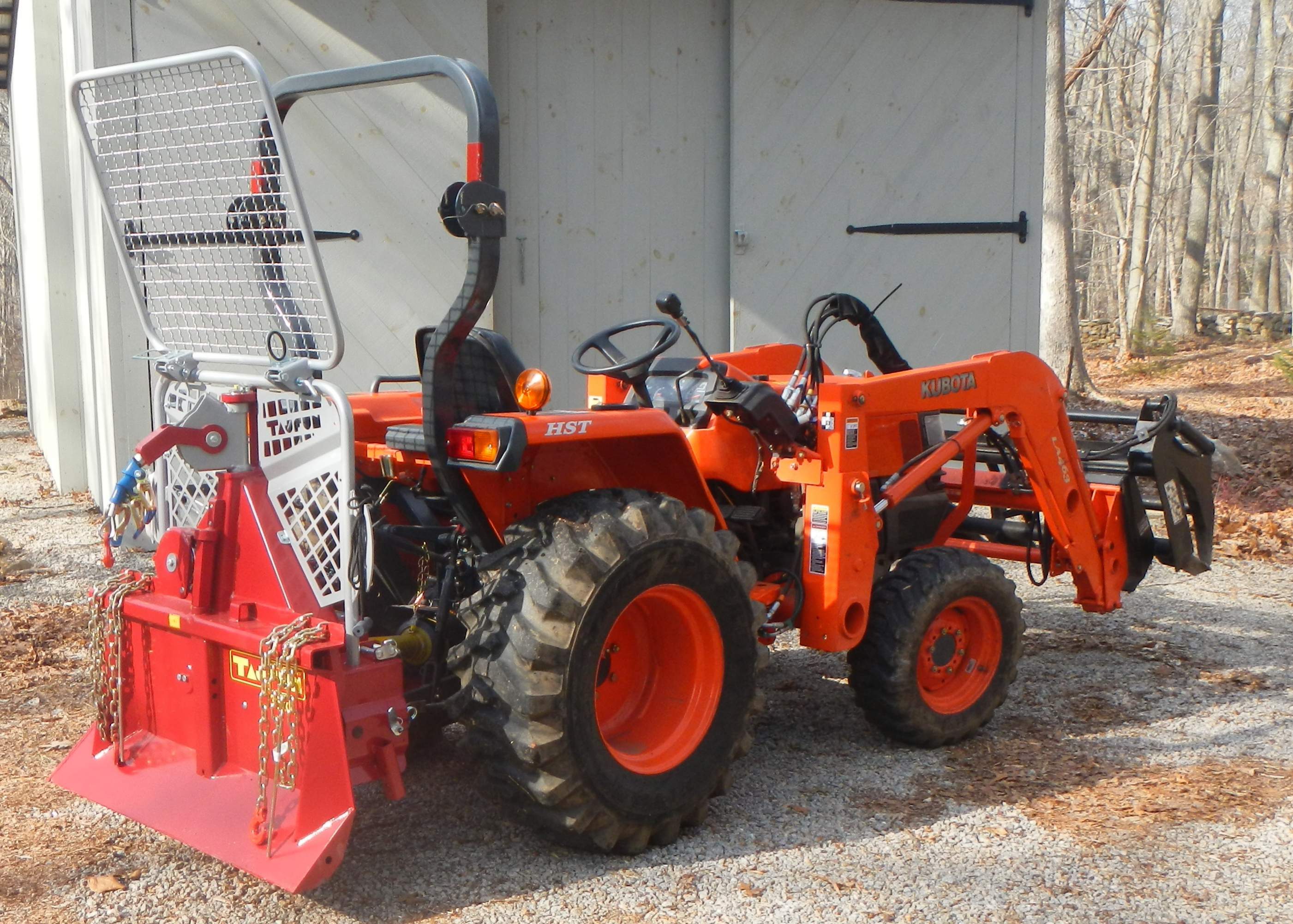

/ Which 3pt log skidding winch? #17
Got a Tajfun EGV-35A and been very happy with it. Has 200' of 3/8'' cable which is great for snaking logs from hillside so tractor stays on level ground.
