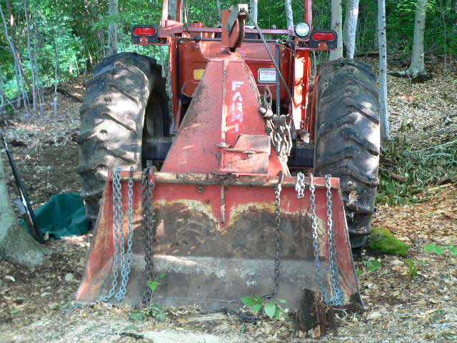

I am the proud owner of Gordon's old JL601 (Farmi). I had it for about a year or so and a bud asked me to help pull a huge Deer front end loader out of the mud. Everything was going fine until the input shaft bearing race let go.. WOO!
I don't know how old the winch was, but I was clearly abusing it!. Anyway, I pulled apart the following afternoon, got the make and serial numbers off ALL the bearings, cross referenced them on the internet to Timken and a few days later put the big lug back together again. I have put up about 150 cord of with since I have owned the winch, all felled on my property. It is reliable, rugged, and ugly. I love the big brute!
I do chain up the stubes rather than skid them attached to the cable. I don't like the logs flopping around when I am skiding them and chaining them to the winch frame solves that issue.Farmi says the lower block is to be used for skidding when doing so on the cable. I find I use the lower block when winching a particularly heavy stub as I believe it reduces the stress on the top link, putting more load into the dozer blade down force.

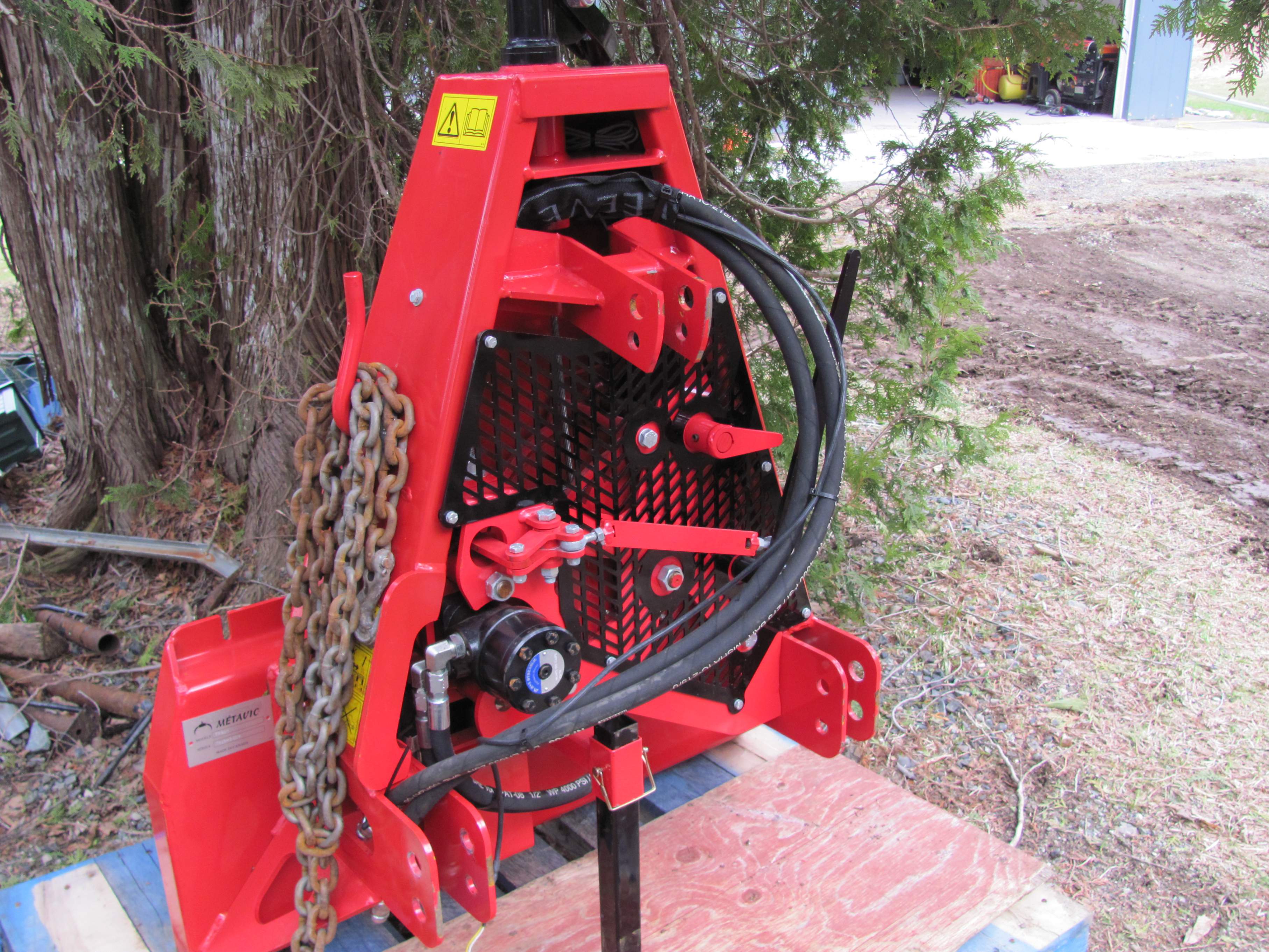

I have a TR65H model, hydraulic, with a wireless remote and it is a great unit, rugged built ,Canadian made.

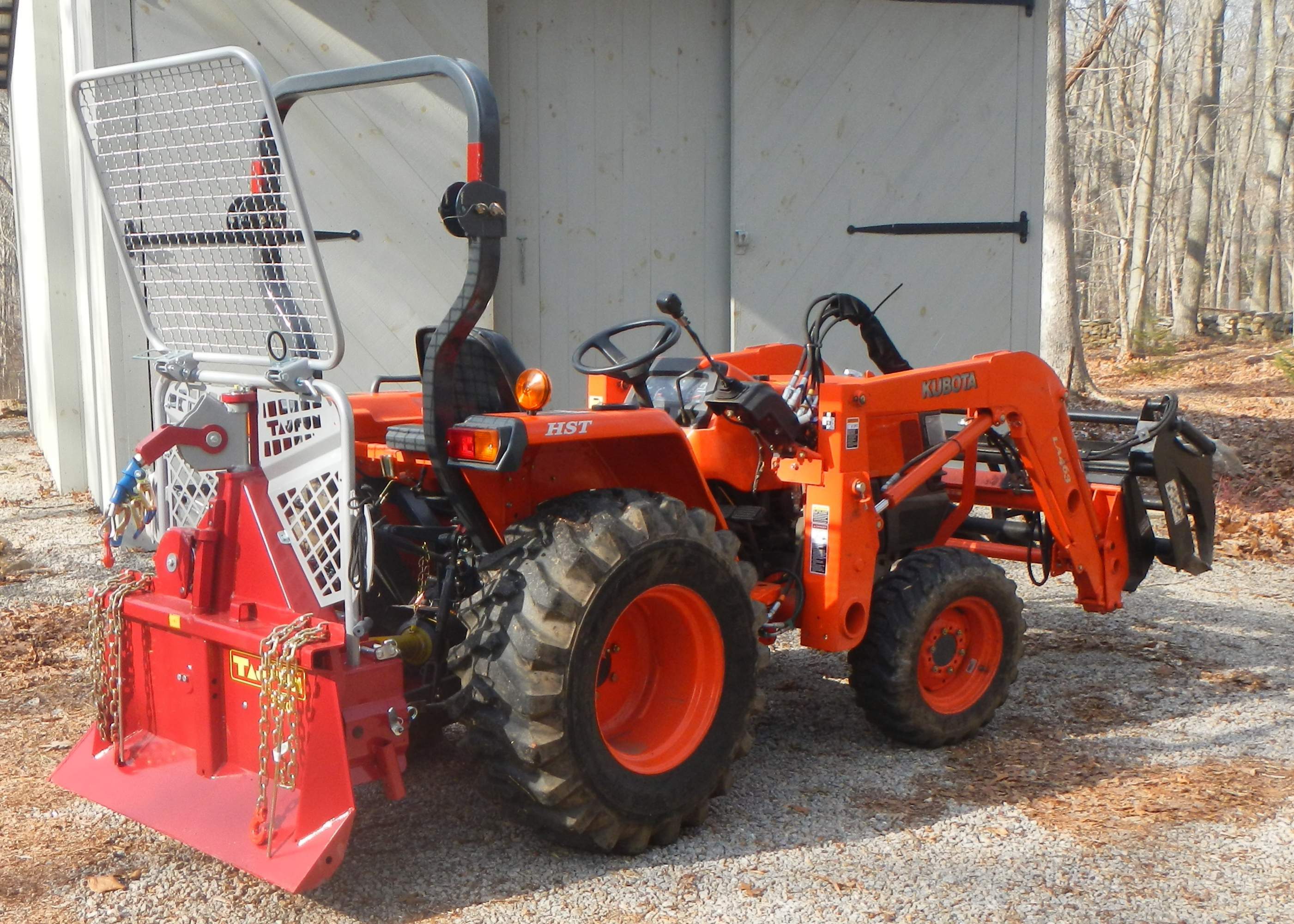

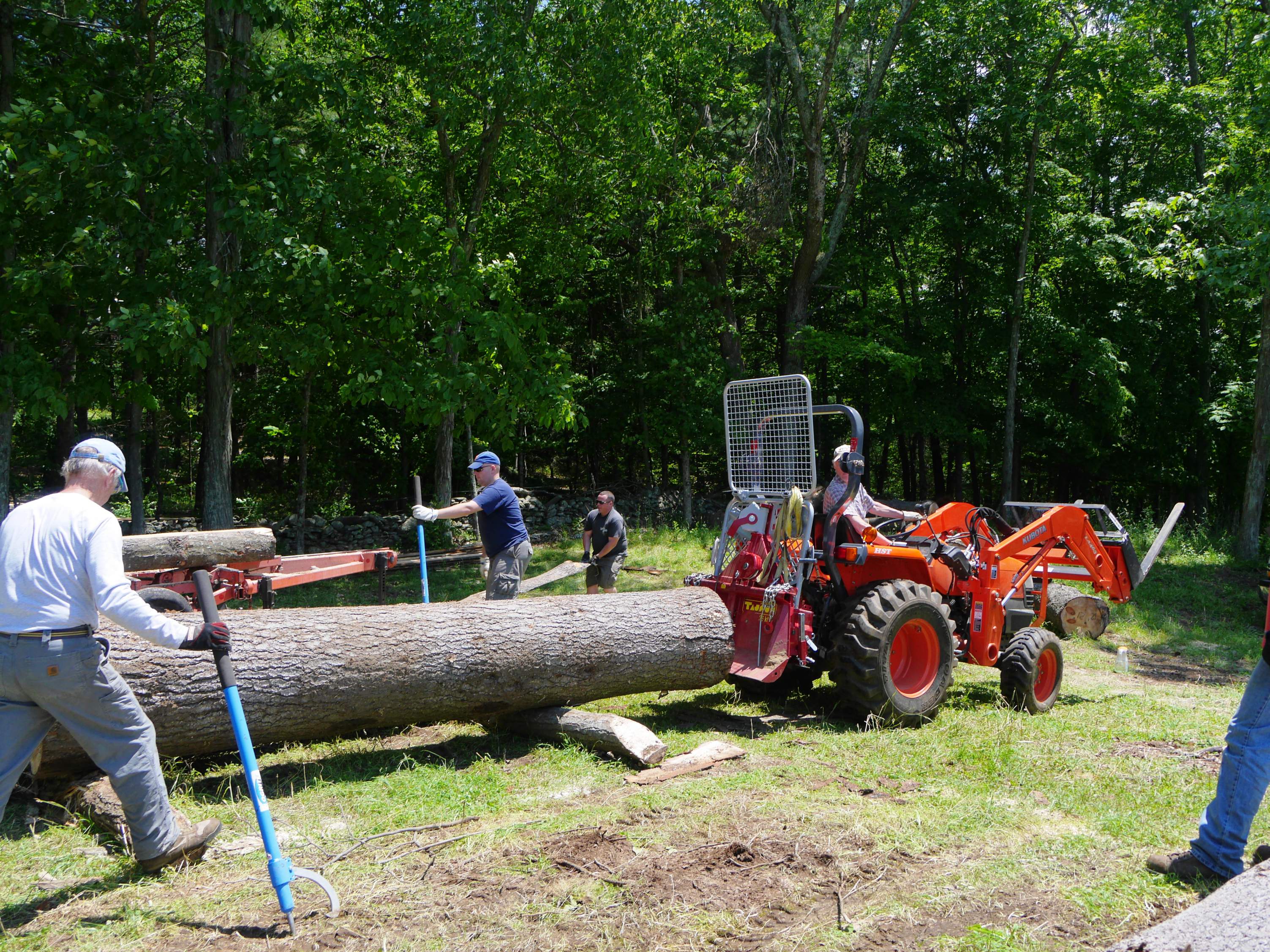

Got a Tajfun EGV-35A and been very happy with it. Has 200' of 3/8'' cable which is great for snaking logs from hillside so tractor stays on level ground.
