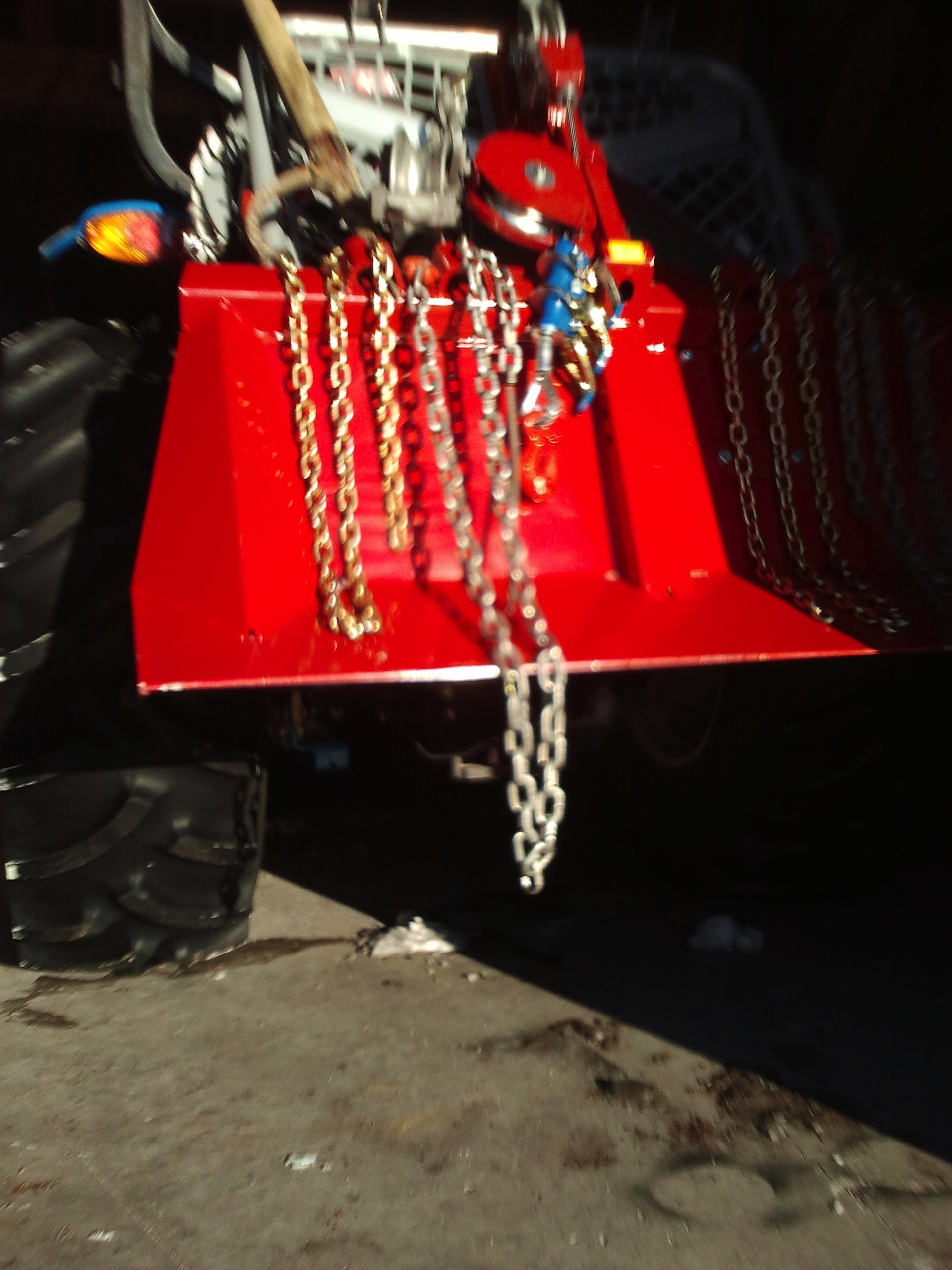

   / Which 3pt log skidding winch? #39
That's a great looking rig, SR - bet you can move a mountain of wood in a day!
