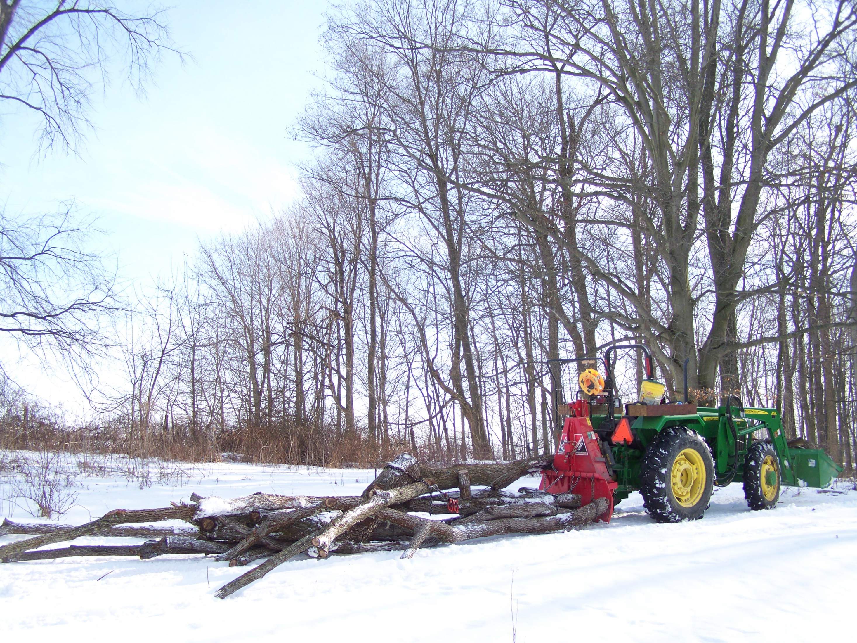

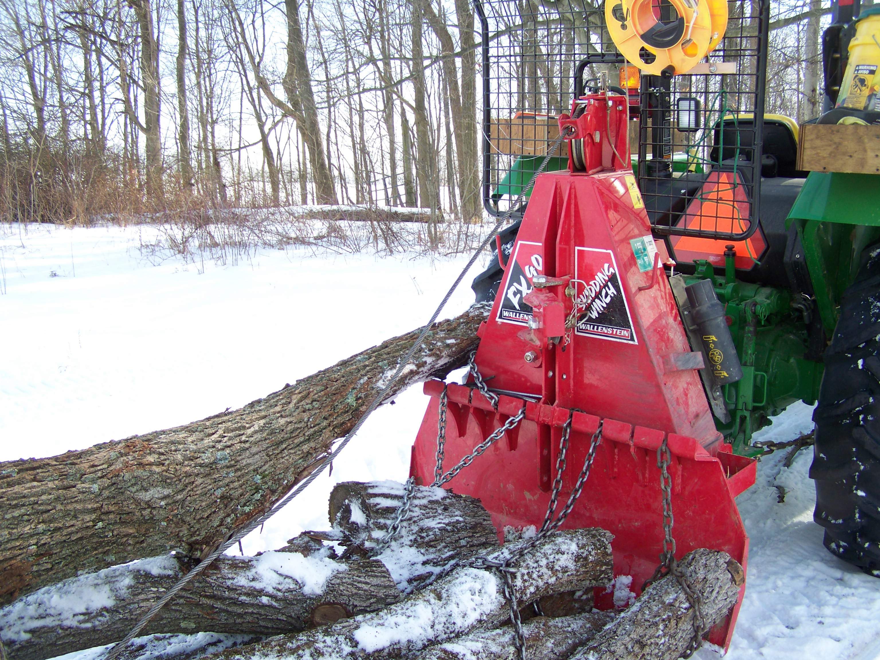

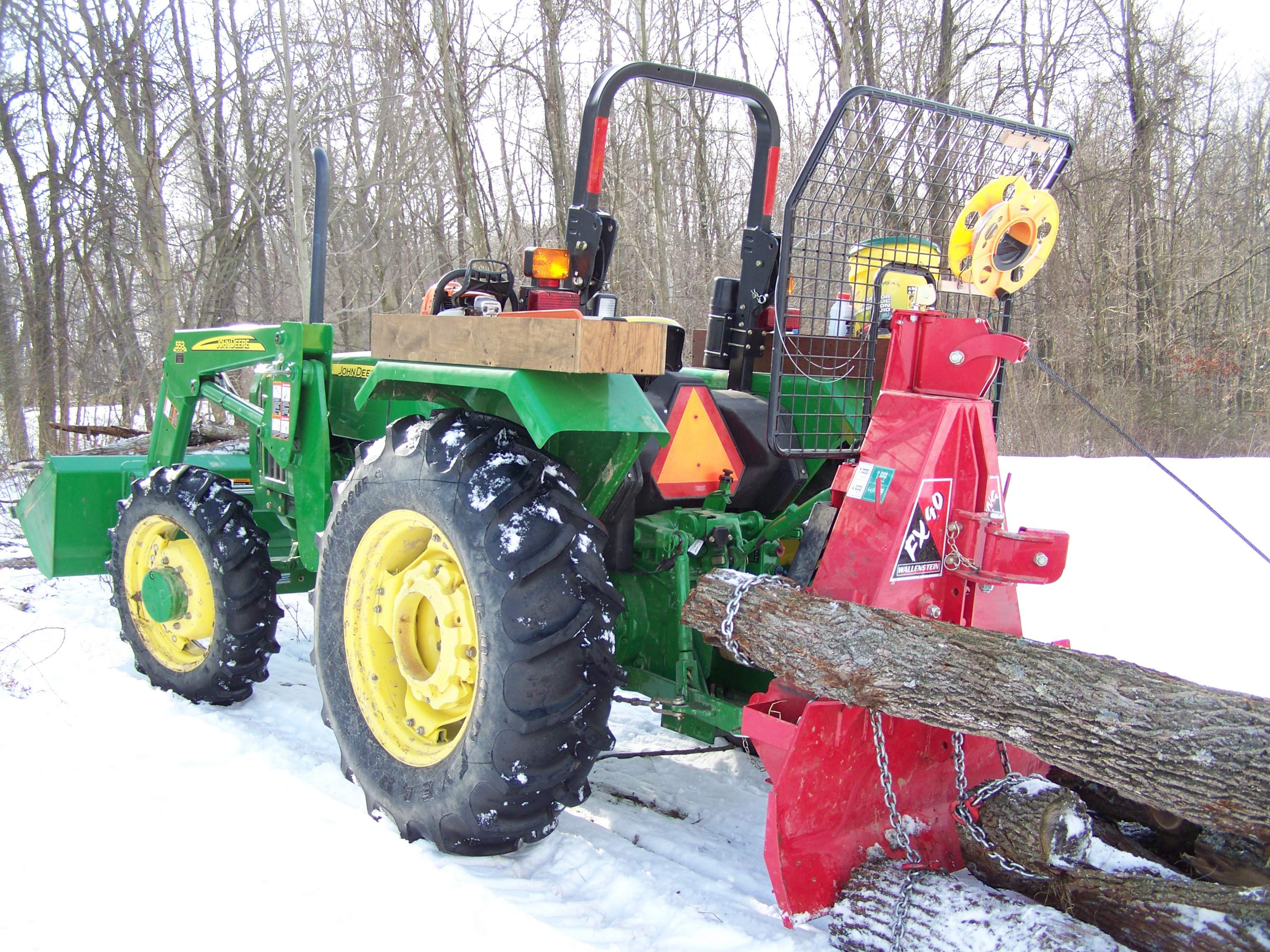

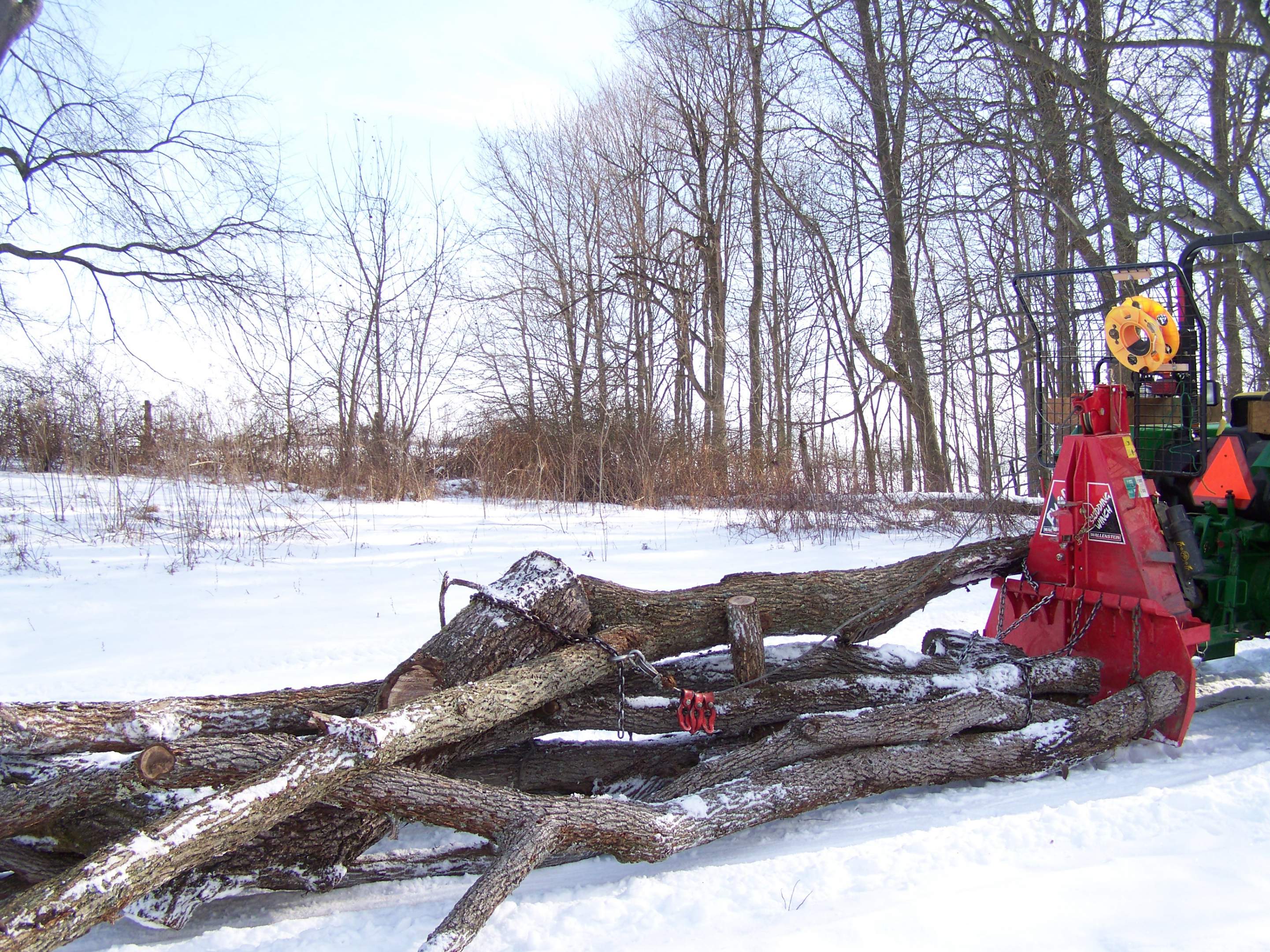

Wallenstein or Farmi - did a bunch of research on these ( among other brands as well ) before I ended up purchasing a Wallenstein FX90. For the most part there is not that much difference between the 2, I thought the Farmi was a bit higher priced. One of the kicker features for me on the Wallenstein was the trailer hitch.
Another very important factor is the weight of the winch, and whether you have a FEL on your tractor or not. When I first used my FX90, I had it on a John Deere 3020 ( 70HP, 7500 lbs tractor )with no front weight. I figured the tractor would be heavy enough to make up for the lack of front weights, but on my very first hitch I hooked up 4 twelve to fourteen inch locust logs, and when I tried to start off the front end of the tractor raised up a couple inches! I added 400 lbs of weight, which enabled me to skid enough logs to make it practical. I used this setup until July 2014, when I sold the 3020 and bought a John Deere 5203 with 4WD and a FEL. The 5203 is smaller and lighter (56 HP, 5000 lb tractor ), but it will pull as much or maybe more than the 3020 did, partially because of the weight of the FEL ( never had the front wheels off the ground ) and partially because of the 4WD.
Winch size - don't think I would want to go any larger on the 5203. On the MF1742 you would probably be best off with the smaller FX65 (don't think it has the rear hitch though) or the or maybe the JL351.
Below are a couple pics of the FX90 in action.
