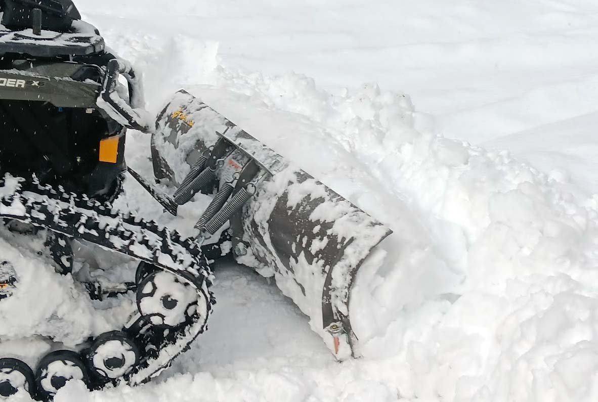

The "abrasion resistant" stuff is no more than that. A little resistant. If you're not ever going to use it, then UV stabilized is a plus. I don't worry about that and go with a low cost straps and replace them every two years. In this photo the poly strap is black and attached near the springs bottom.
